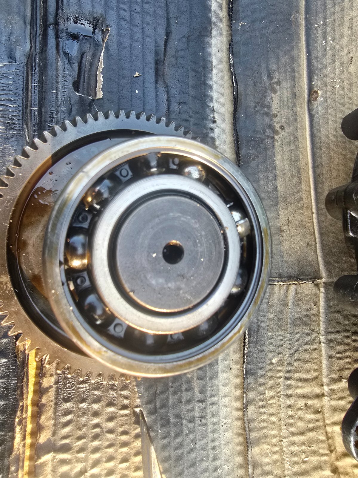

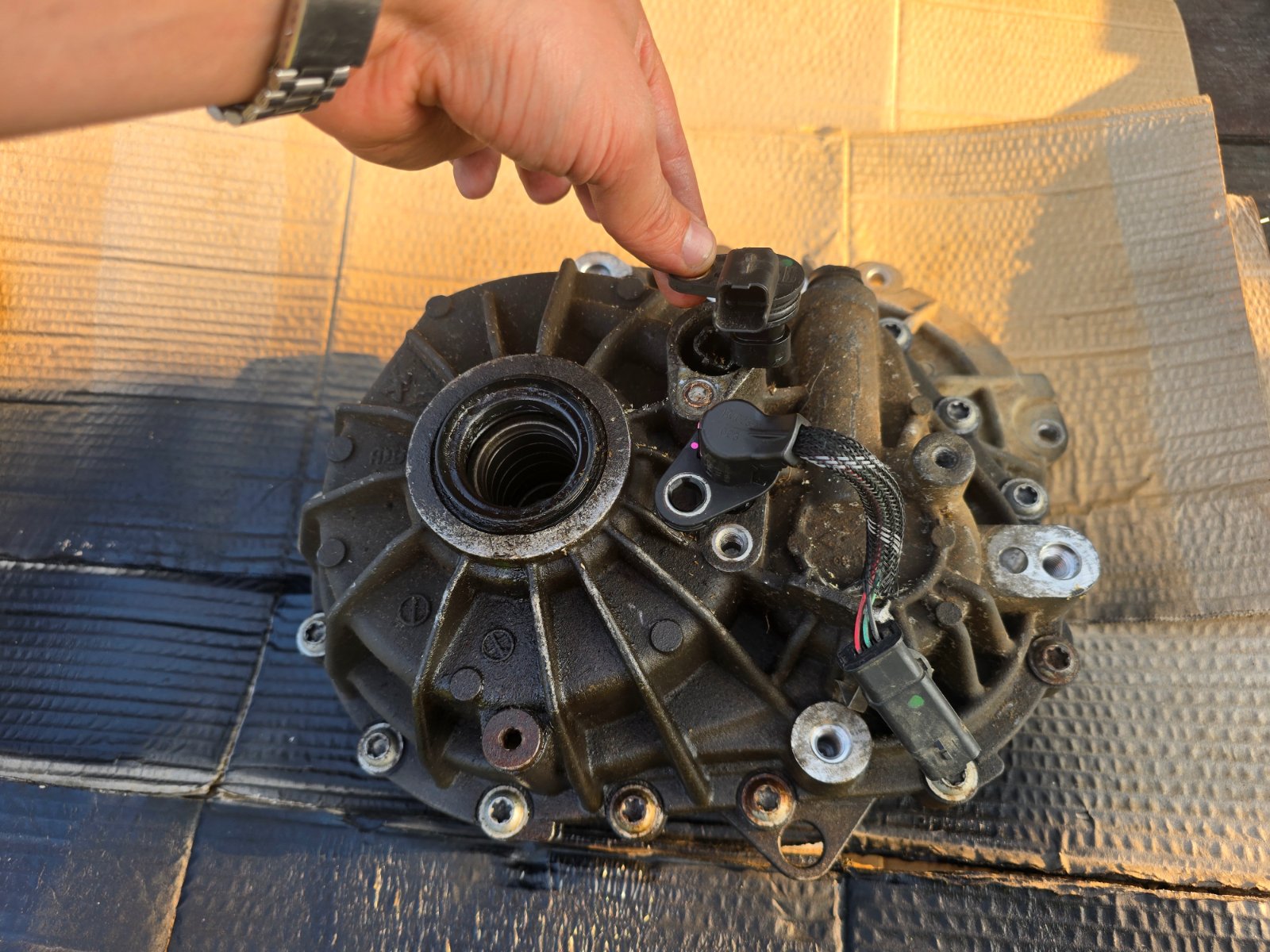

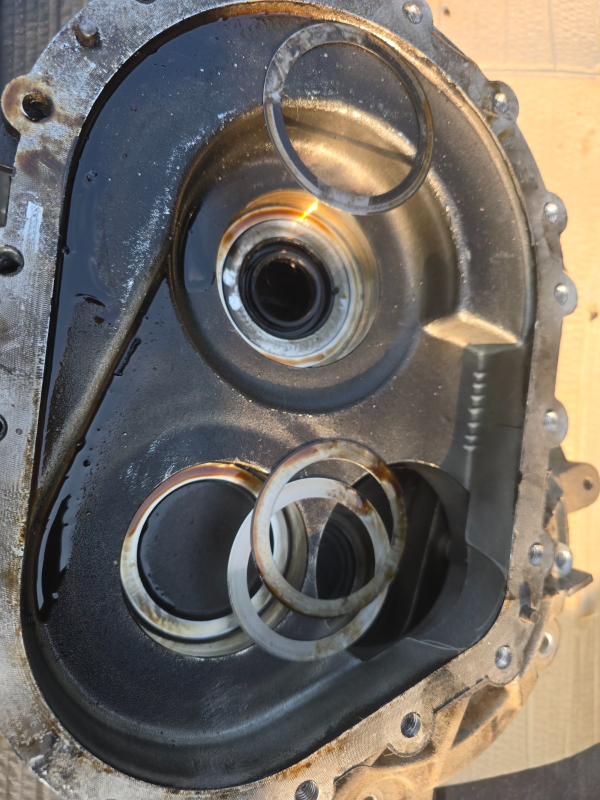

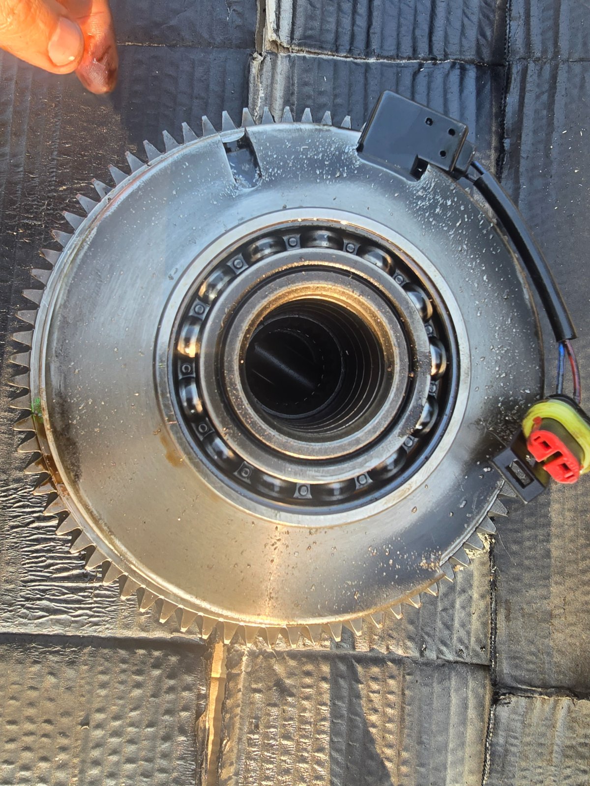

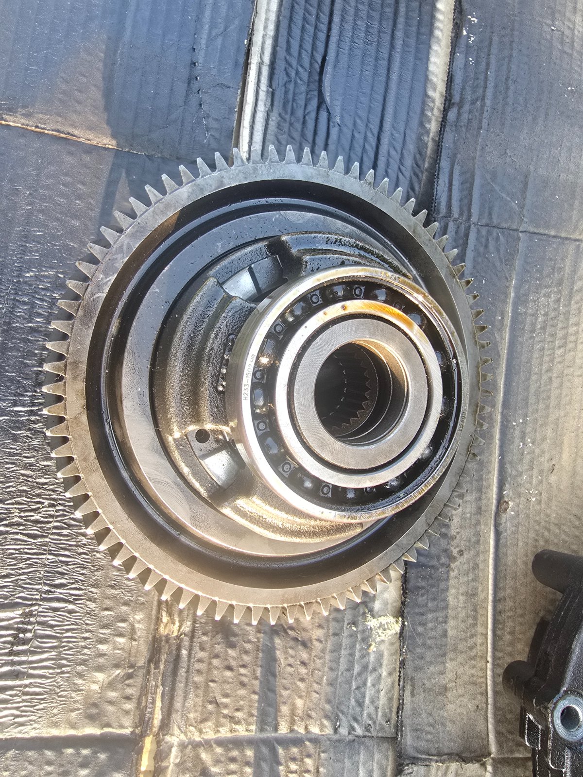

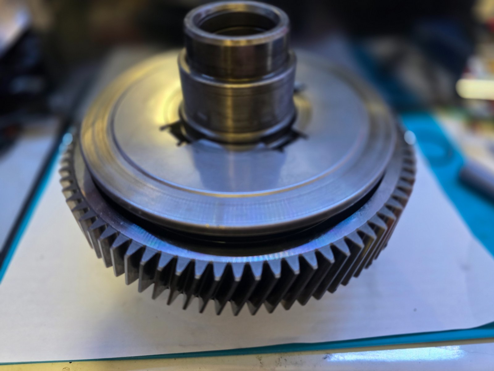

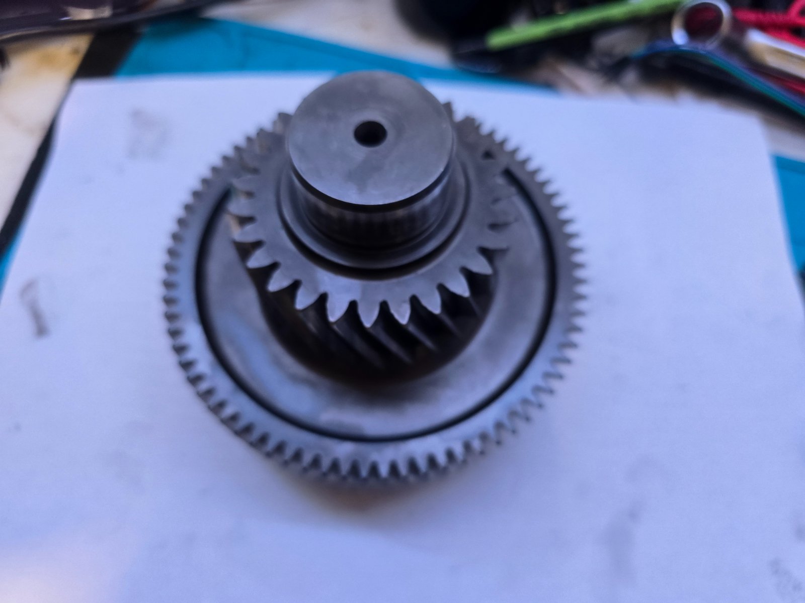

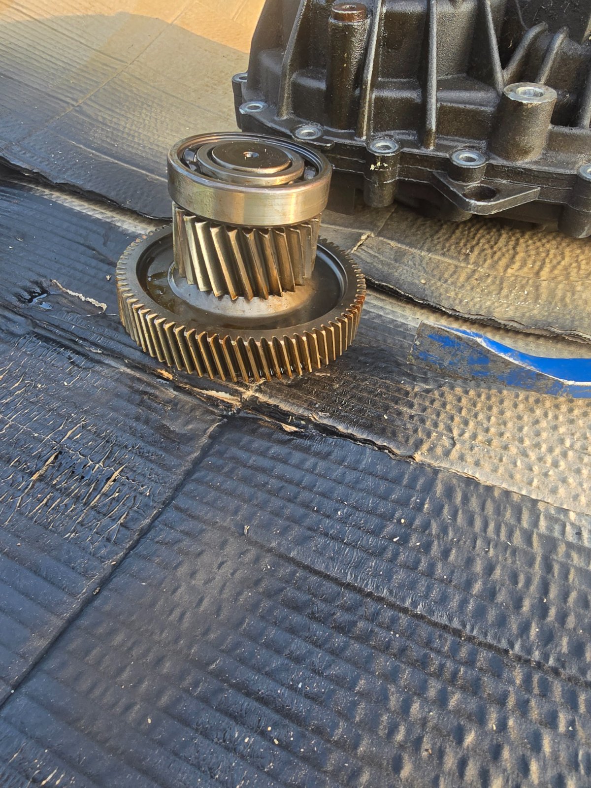

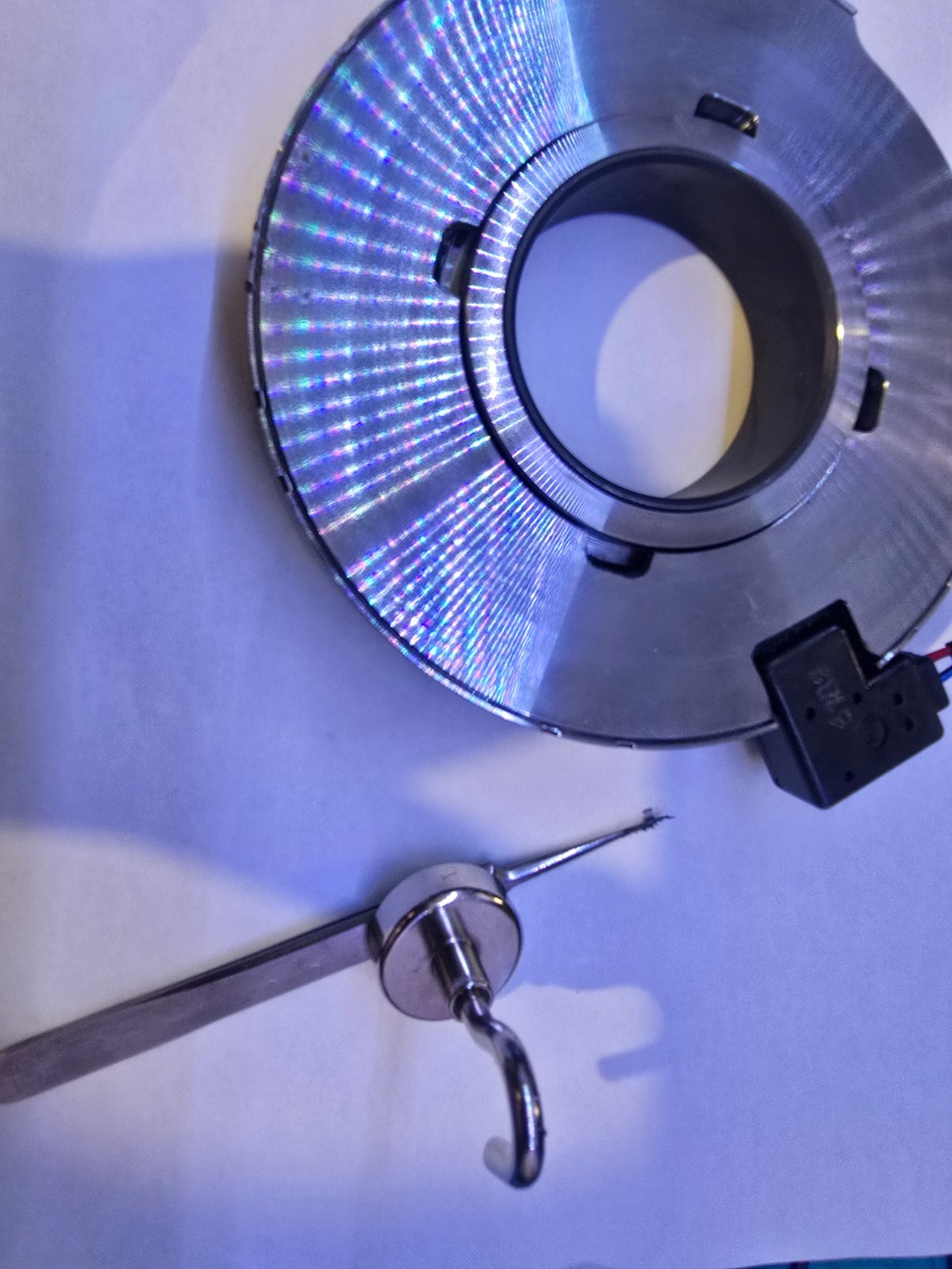

Differential contains 2 gears:
1. Electromagnetic Clutch - bearings are already removed: 2. Reduction gear - it's between electric motor and electromagnetic clutch: Reduction gear is easy to clean. Problem is with Electromagnetic clutch - there are tones of metal pieces

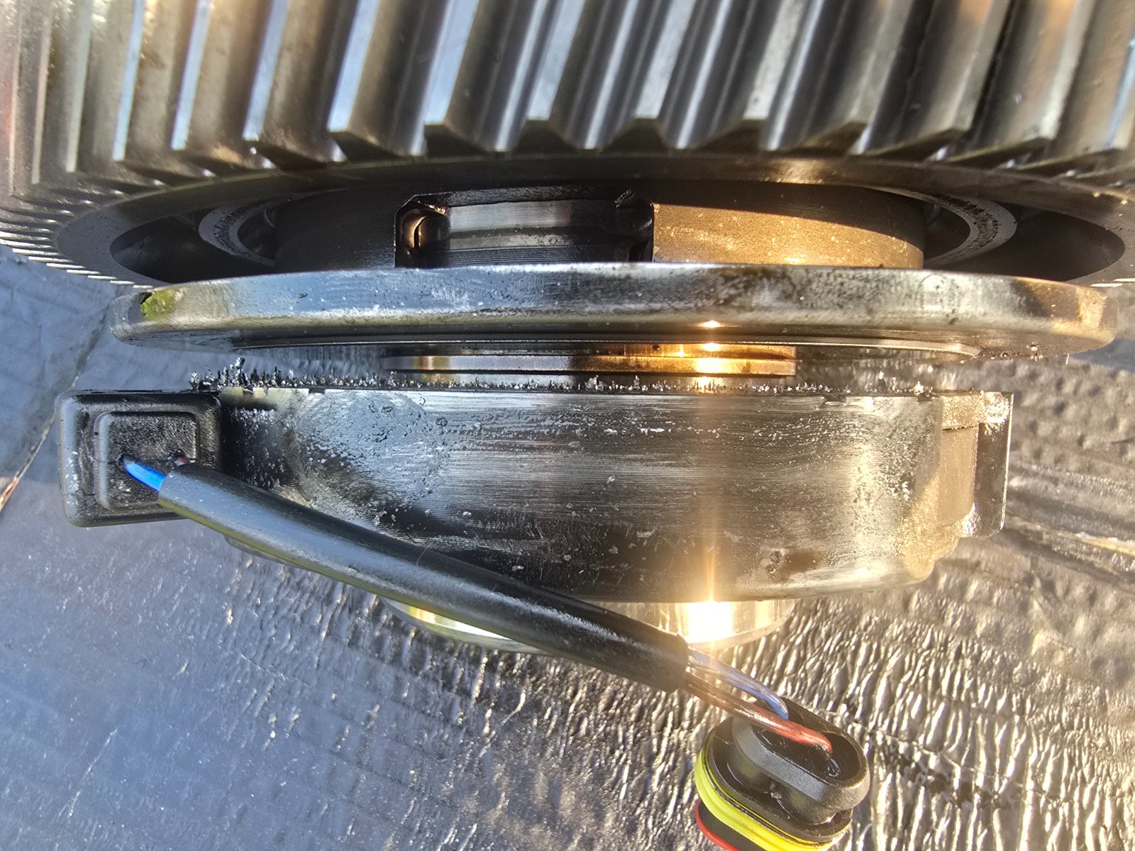

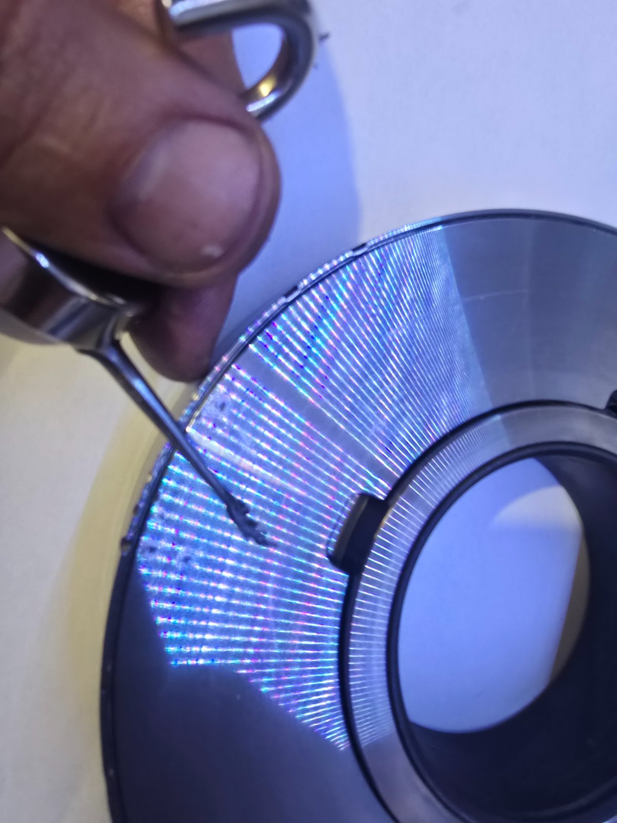

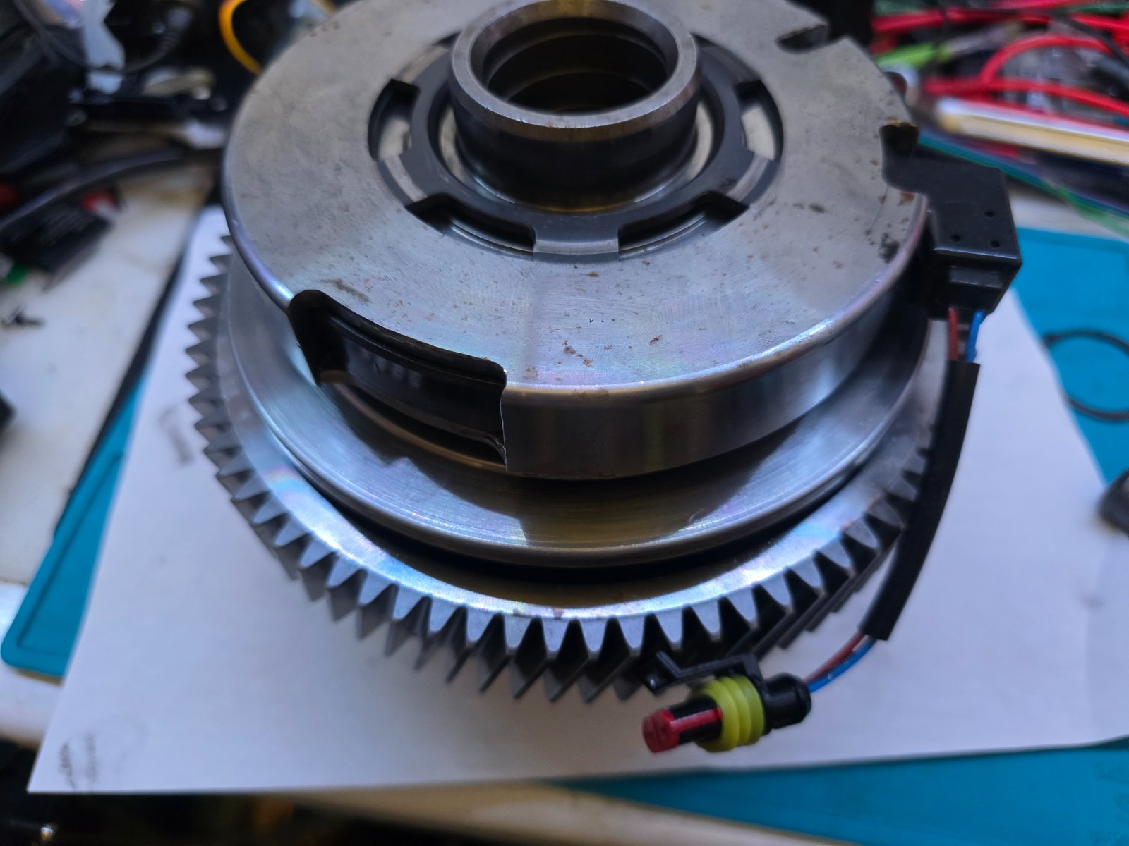

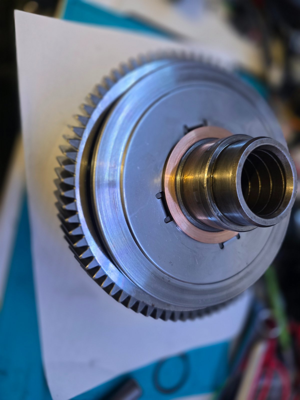

Here are parts of electromagnetic clutch:
1. Electromagnet and twizzers with strong magnet attached: Metal pieces removed from electromagnet: Clutch with gear: Copper ring that is placed between clutch and electromagnet: You have to take differential apart, remove bearings and clean everything very well. There are plenty of metal pieces (metal powder) in electromagnet and clutch. You have to remove as much as you can, if you see even one metal splinter you have to remove it. It can attach between electromagnet and clutch and clutch will not be able to work properly.
I'll make more photos later. Missing are: both cases, sensors, spacers. Tomorrow morning I'll mount new bearings. I'm heating bearings ( to 120C) in the oven and freeze whole night gears in the freezer. This way I can just mount them together without hammering bearings - IMO it's even better than hydraulic press. I can put them in place by hands.

Doom

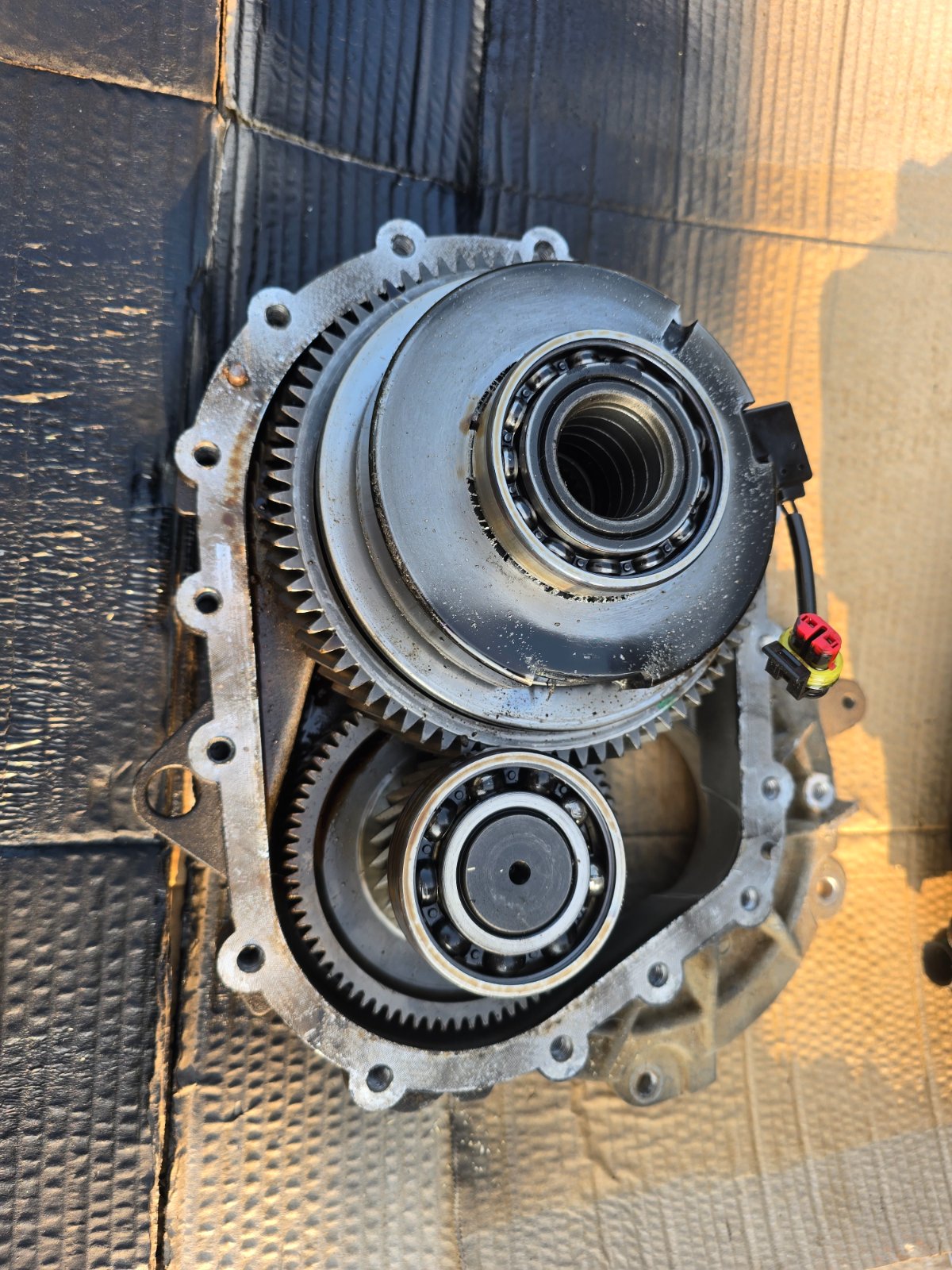

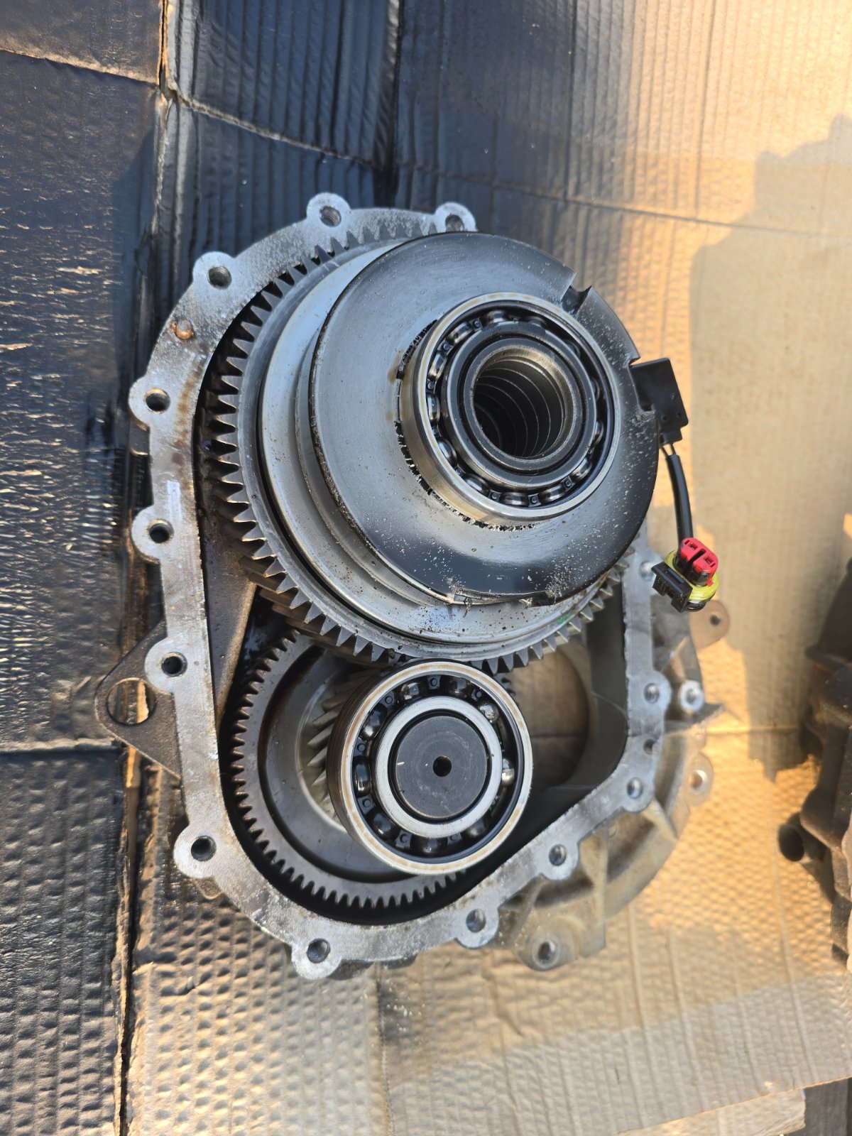

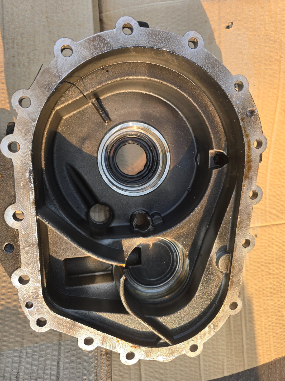

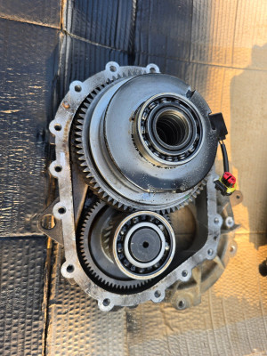

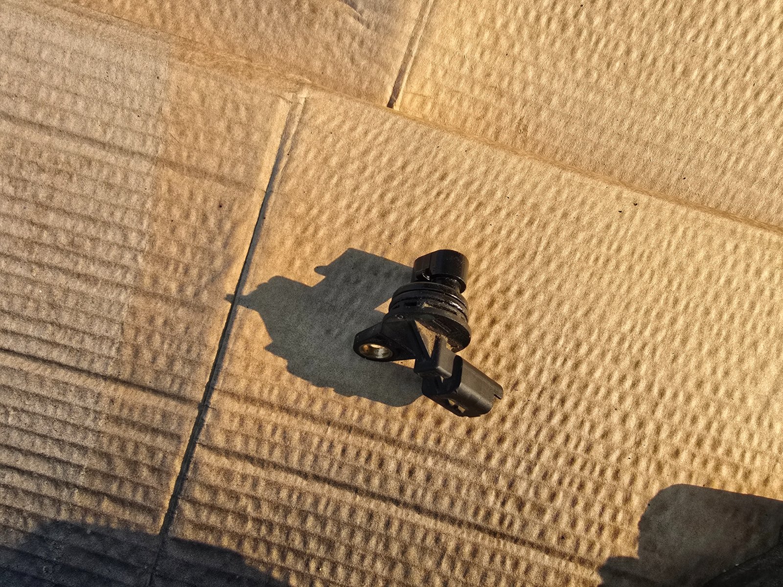

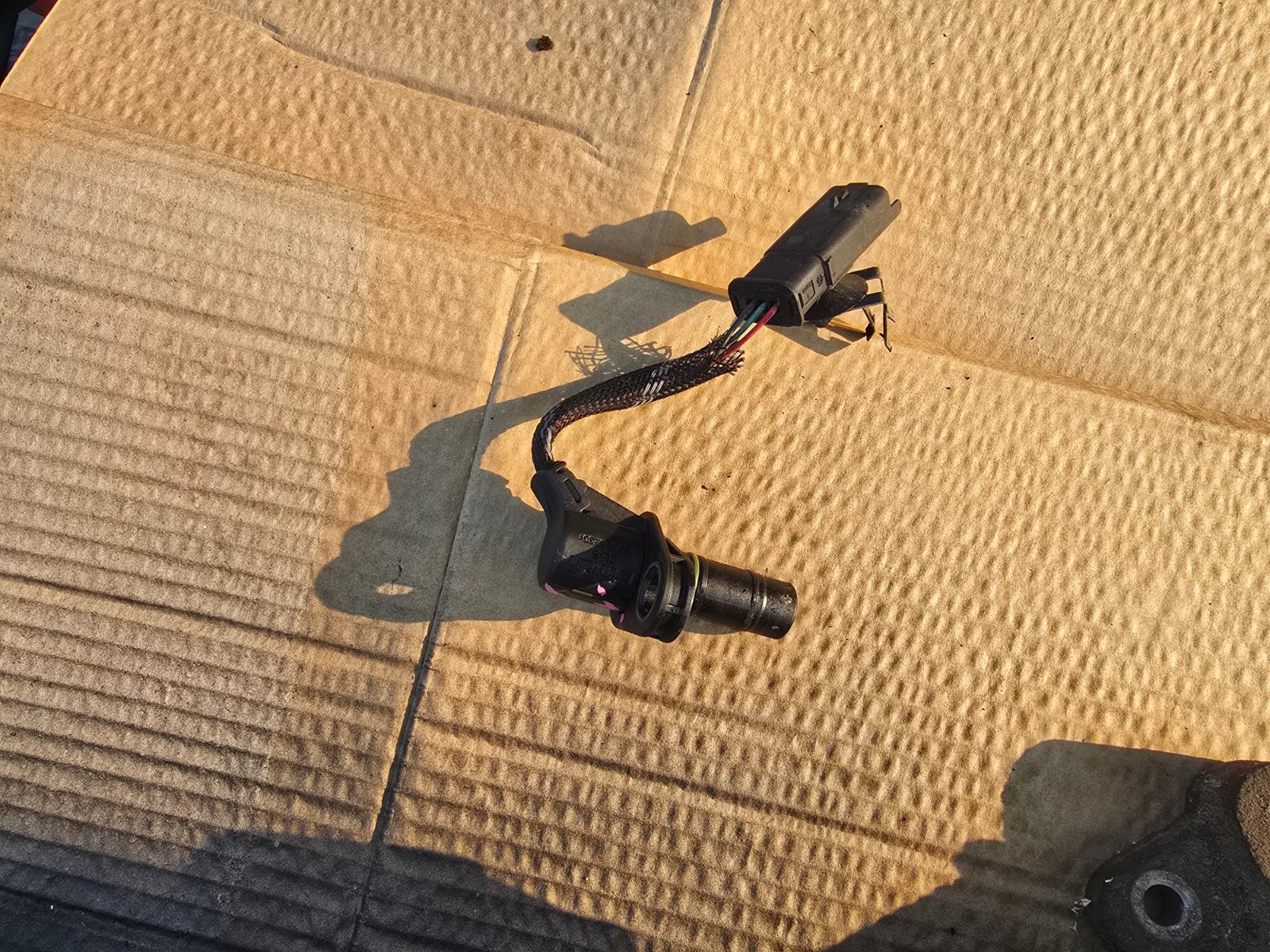

Part 2:
This is full differential with electromagnet adapter and clutch position sensor: Adapter: Clutch position sensor First view when you open the cover: Same: Cover itself: Bottom cover with spacers: Small gear: Here you see issue, broken bearing that was smashed: Bigger gear with electromagnet, clutch and a lot of metal pieces: Bottom side of the bigger gear: Here you see a lot of metal pieces between clutch and electromagnet. I'll add comments once I'll back home.
