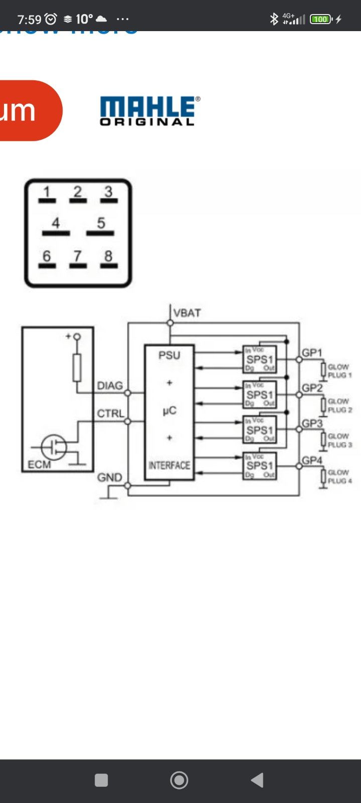

I found this drawing of the relay online. It shows a microcomputer inside the relay which I had guessed was the case. It appears it is more intelligent than we thought there is essentially two way Comms between the glow plugs and the controller. Well at least a method for bypassing the relay to ensure monitored power is maintained to the glow plugs.. It could be just for illustration purposes but it seems to have an interface between the plugs and the microcomputer. My connector isn't in great condition so I might cut it off and replace with a good used one I know this is not ideal but it could easily be the cause of the issue. One side of the slide is partially missing and so is part of the seal. Any opposing views?
Darren

darbuck wrote: 27 May 2025, 08:40 I found this drawing of the relay online. It shows a microcomputer inside the relay which I had guessed was the case. It appears it is more intelligent than we thought there is essentially two way Comms between the glow plugs and the controller. Well at least a method for bypassing the relay to ensure monitored power is maintained to the glow plugs.. It could be just for illustration purposes but it seems to have an interface between the plugs and the microcomputer. My connector isn't in great condition so I might cut it off and replace with a good used one I know this is not ideal but it could easily be the cause of the issue. One side of the slide is partially missing and so is part of the seal. Any opposing views?
Not so much disagree but more of a comment. The diagram shows each glow plug fed separately. Is this actually the case? It's more usual to have a single feed linked across from one glow plug to the next.

Hi Paul they are all individually fed yes. So the drawing looks accurate
