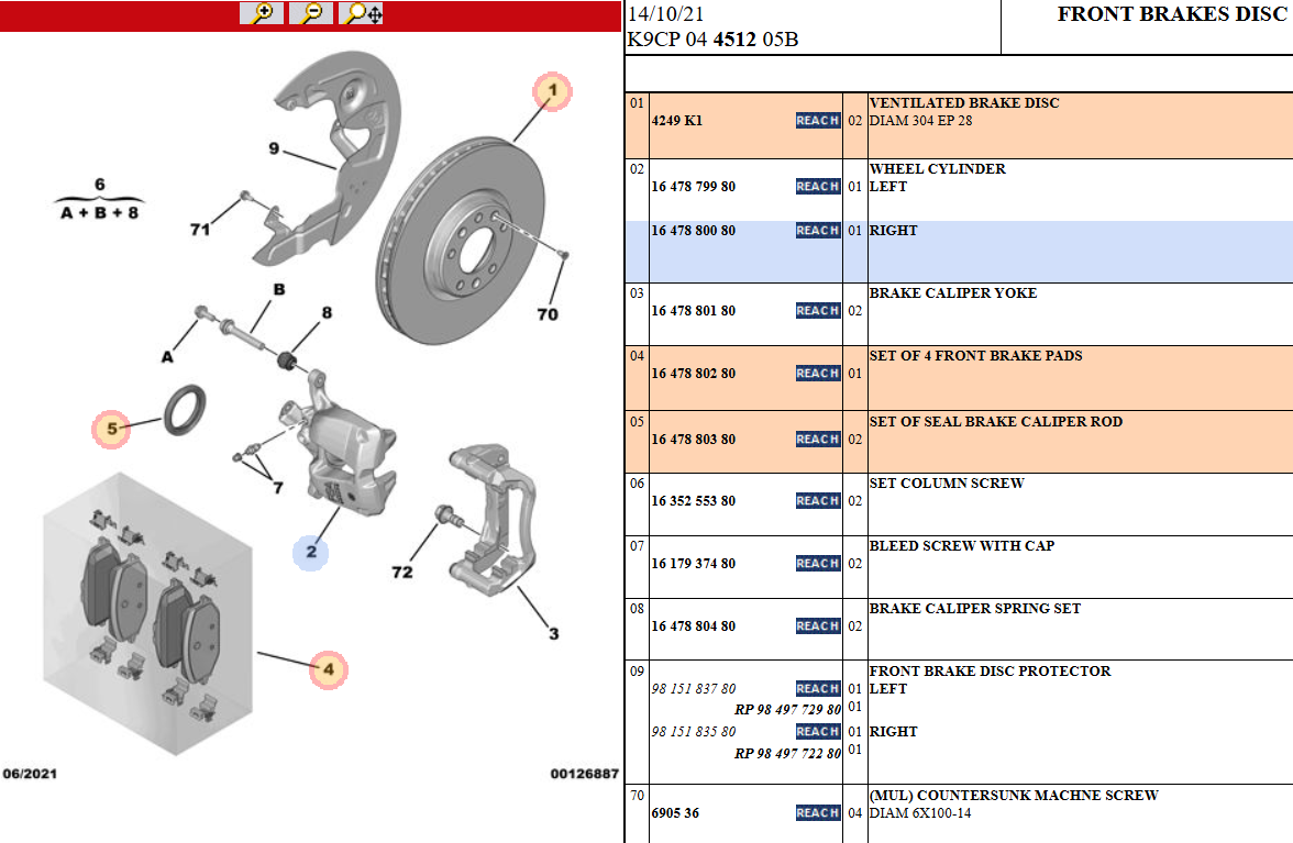

Re: Berlingo K9 front brake sizes
Looks like you have 304mm brakes
Part numbers as shown
Very good of you, thank you.

In case someone else is looking I thought I'd post an update.
I tried the pads for 304mm discs, unfortunately they didn't fit and I needed the 283 mm disc pads that had straight ends rather than hooked ends.
The correct part for me were equivalent to Brembo P61120
https://www.partsinmotion.co.uk/car-par ... 120-detail
I ordered the Febi version. The metal shim was different to OEM (the Brembo one above matches) but it seems fine.
