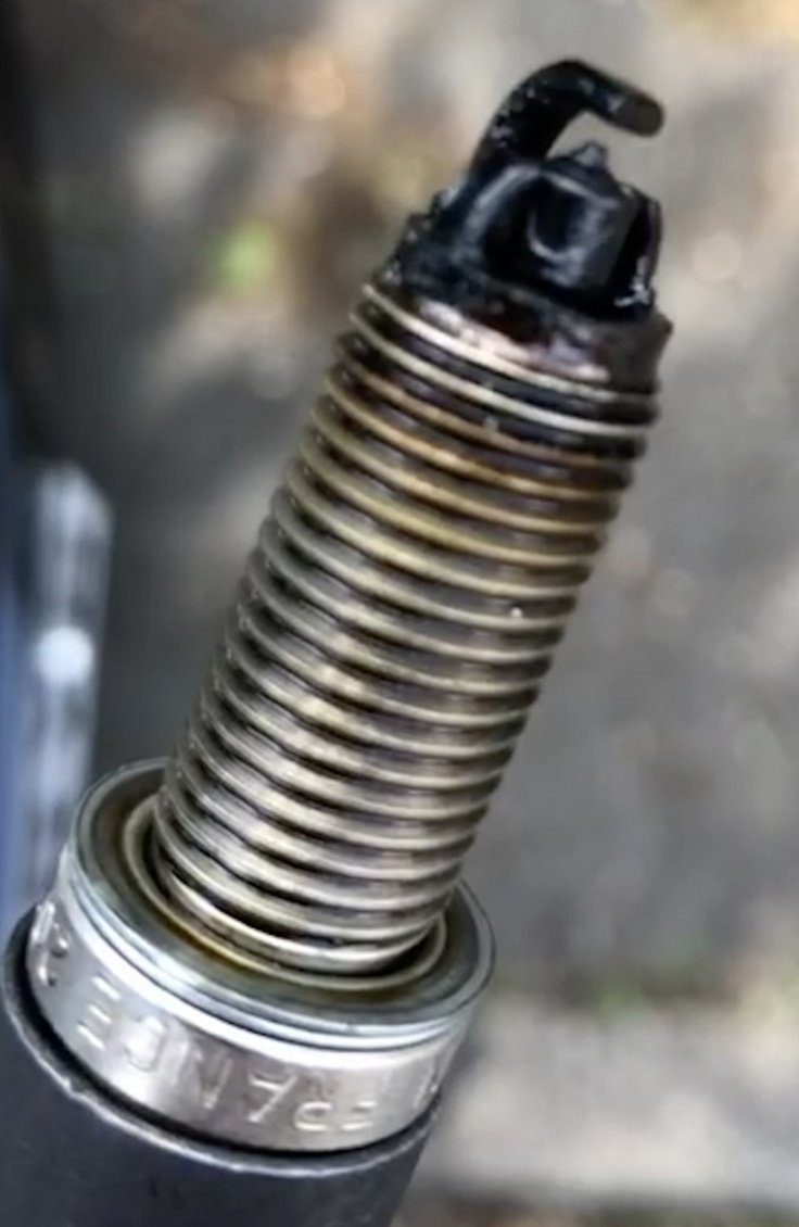

Here is a picture of the fouled plug (now cleaned and the car ran seemingly well after this).

You say the trips are short but how many miles is this ? Using your code reader, what is the engine temperature when it is warmed up - just to check the thermostat is working so should be around 90 to 96°C ?
What is the gap on the plugs, ought to be around 0.9mm ?
I could be wrong, but the fouling on the plug looks like oil - if so is the car using oil, is there any oil in the inlet ducting which could be from the engine breathing ? Cleaning the throttle plate area might help if it is fouled up. With a plug out, when you look in the cylinder does the piston look fouled up or clean ?

Re: 207 keeps fouling the plugs
Some trips are less than 5 miles each way. Some are going to be 10 miles. For a small city car, it's probably normal.PaulC5 wrote: 19 May 2025, 11:23 You say the trips are short but how many miles is this ? Using your code reader, what is the engine temperature when it is warmed up - just to check the thermostat is working so should be around 90 to 96°C ?
The gap on the first Bosch set was 1mm, the genuine Peugeot Beru replacements were 0.9mm.
It doesn't use much oil but the mileage is low. We did inspect the CCV membrane and it was like new. I will look for oil in the intake though and at cleaning the throttle body.
