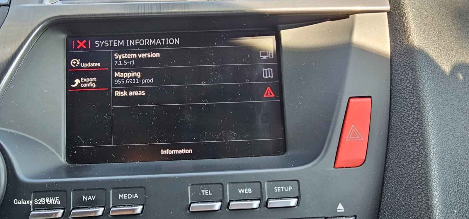

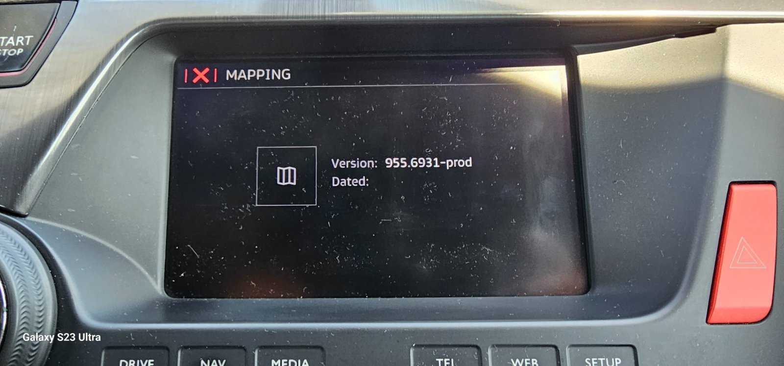

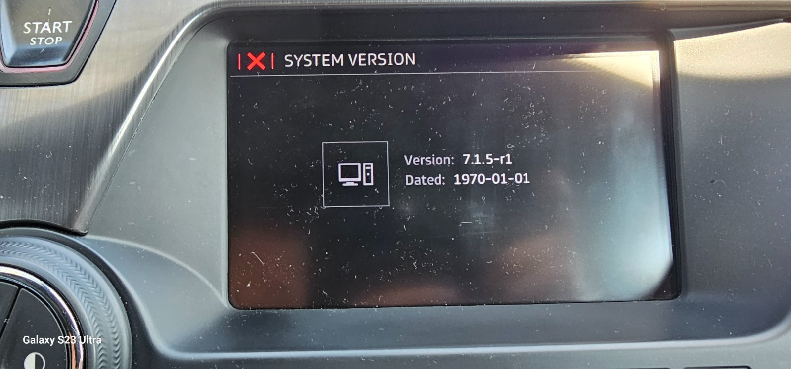

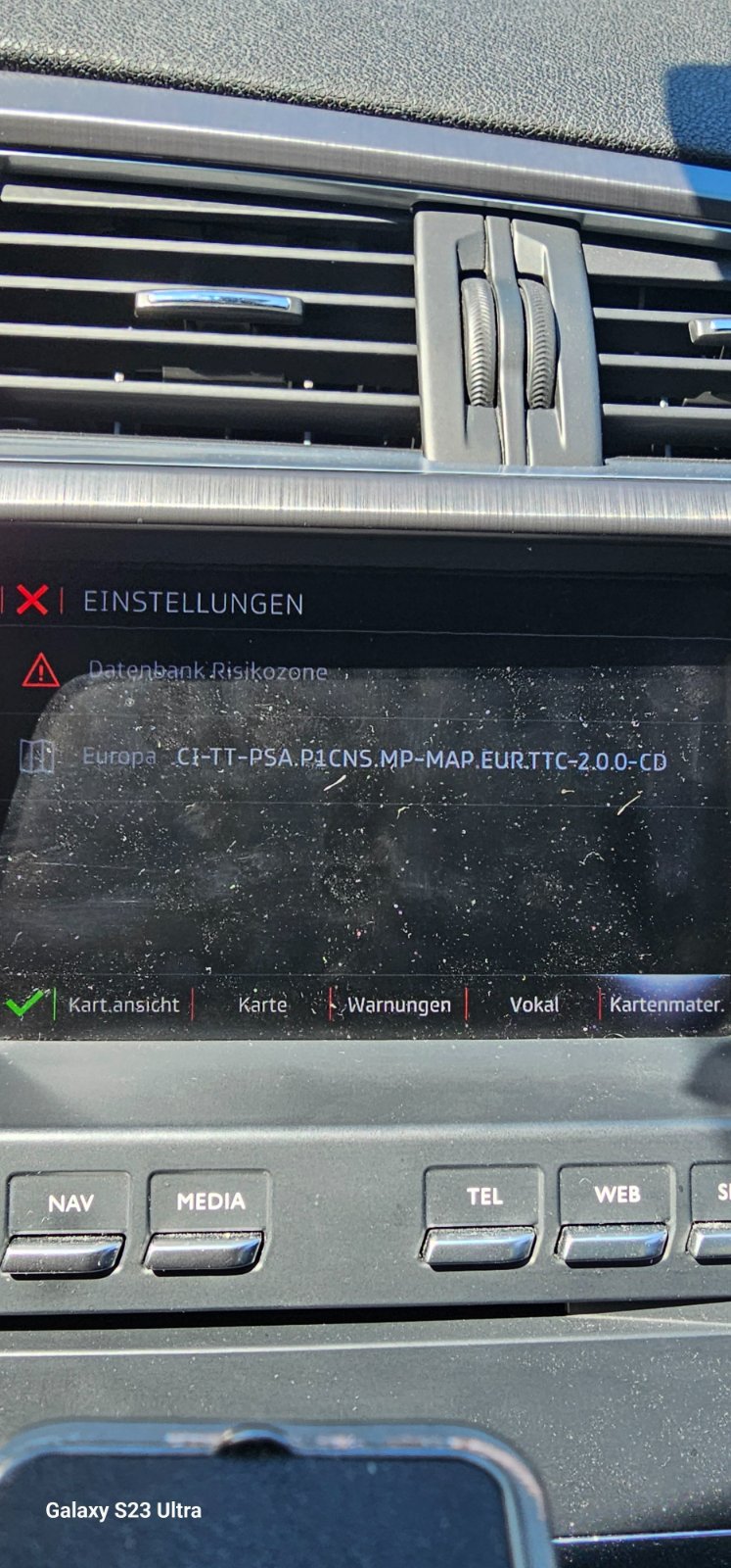

Greetings,
I downloaded the update to USB (formatted to FAT32 16GB) through the DS app. When I insert the USB into the car, I get the answer that the hardware does not match the version that is on the USB. The car is a DS5 Pr line 2.0 180hp produced on 09/08/2016

You have a NAC Wave 1 and it is possible that the certificates have expired and updating is not possible..
