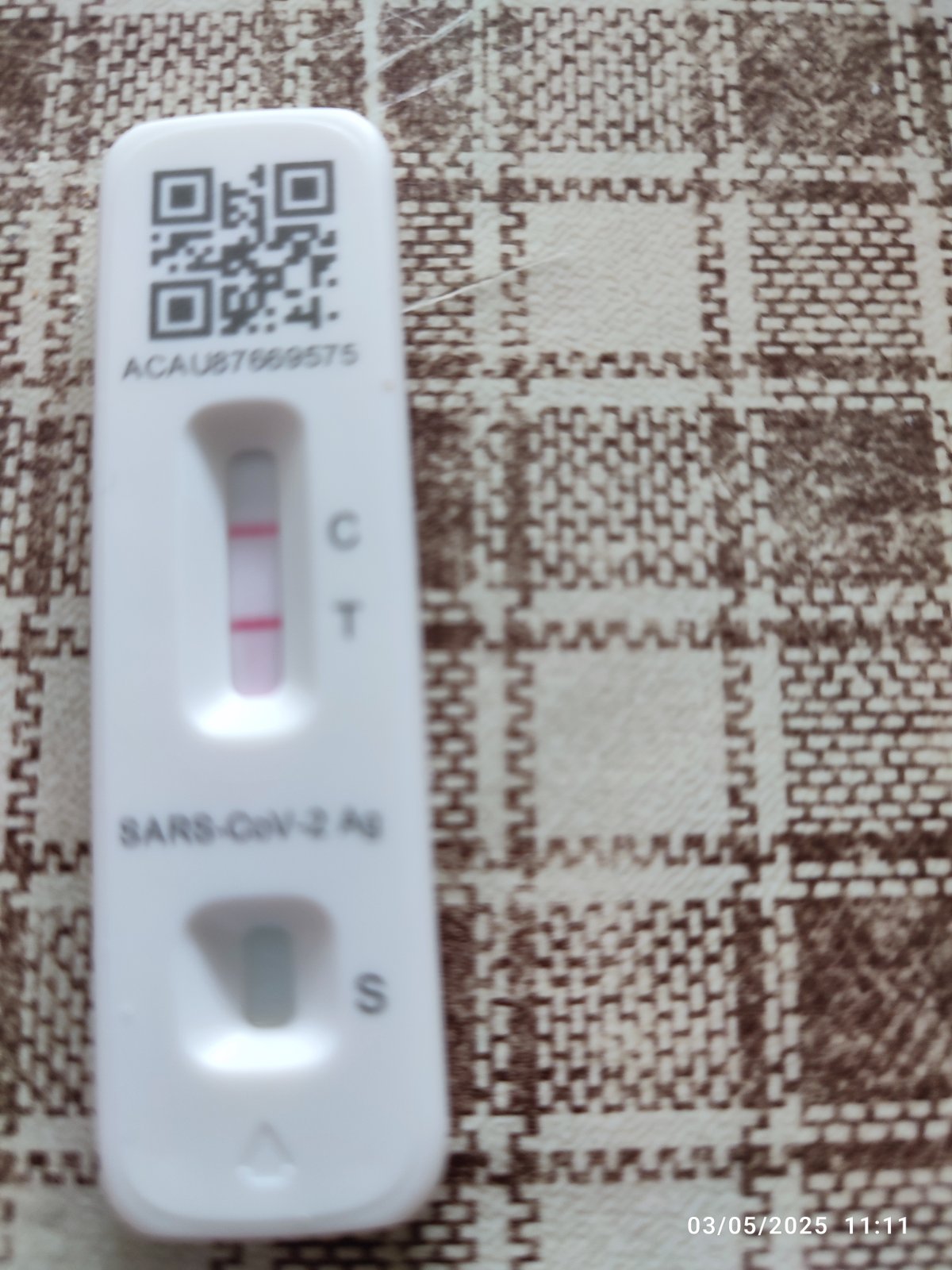

Just done a test explains the dose

How to you read those things? What does the 'T' and the 'C' signify.

The two lines mean you have it. The other ones on their own don't matter. My brother asked me the same thing Fortunately I don't have that trim level so I am safe on that front .

Hope you do not get it bad and best to keep away from other people.
If the test is done correctly the C line will show. If the T line also shows (no matter how feint) as well as the C line it is a positive result for covid.
We had covid a couple of years ago, had symptoms but it was a couple of days later the tests started to show positive so from this if we have symptoms we wait a few days before testing. This is one reason why it spreads so easily, tests suggest you do not have it until after a few days. That's how I got it off Mrs P, she had symptoms but her tests were negative for a few days by which time I had got it and then they were positive but too late to keep away from her. It was a further 7 days before tests started to show negative, gradually the T line became feinter until the next day did not show and then it was ok to go out again. Took me about a month to get over it. It was not long since I had radiotherapy so vulnerable and the hospital gave me Paxlovid anti viral pills, a bit like horse tablets. No idea if they helped but I did not end up in hospital. I was pleased my injections were all up to date and still are, I did not fancy succumbing to something from China.
