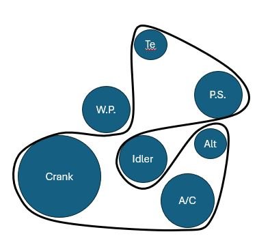

Just been out and checked and the tensioner is vibrating slightly, but nothing like in that video. That may well be because of where in the run the tensioner is located in comparison to the alternator though (sketch I used on the forum previously). I guess it would quite reasonably show up more on the bottom run after the A/C.
