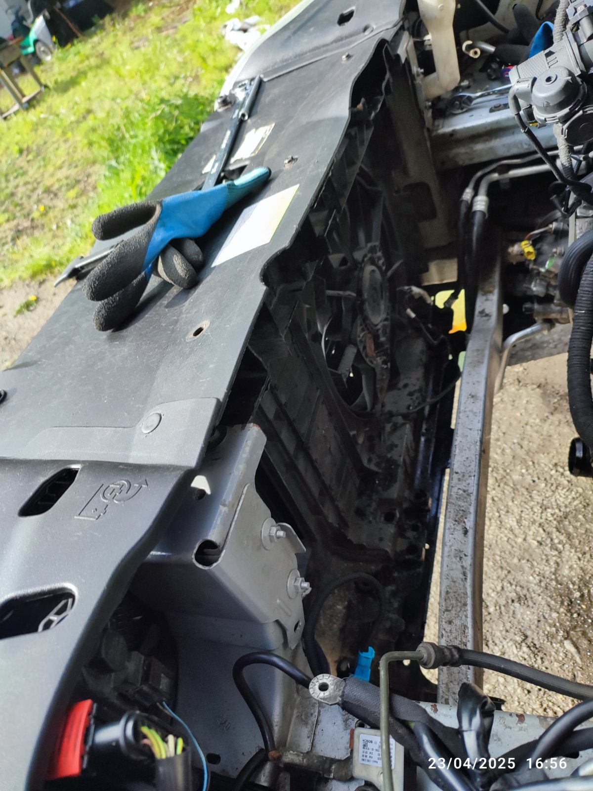

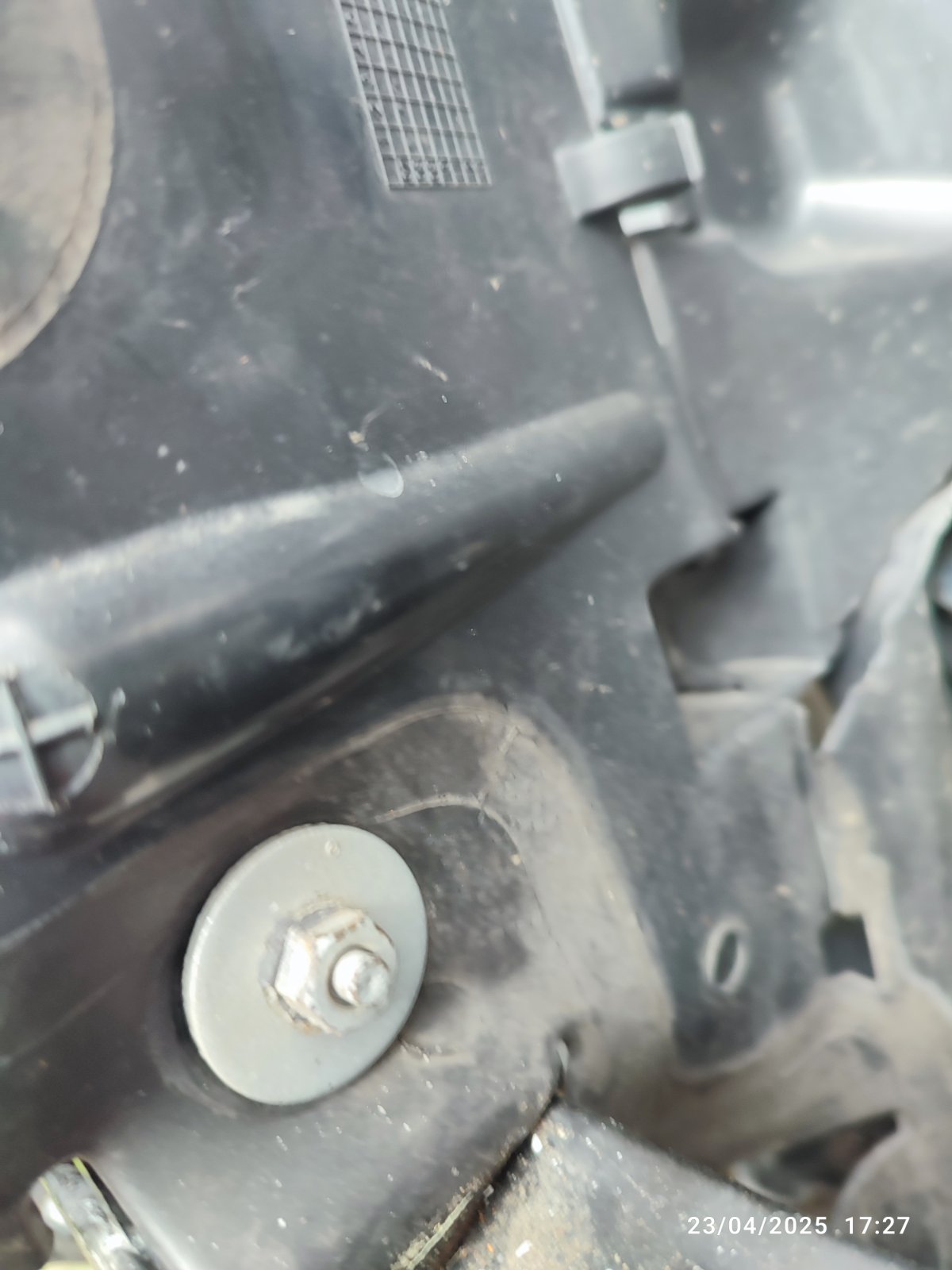

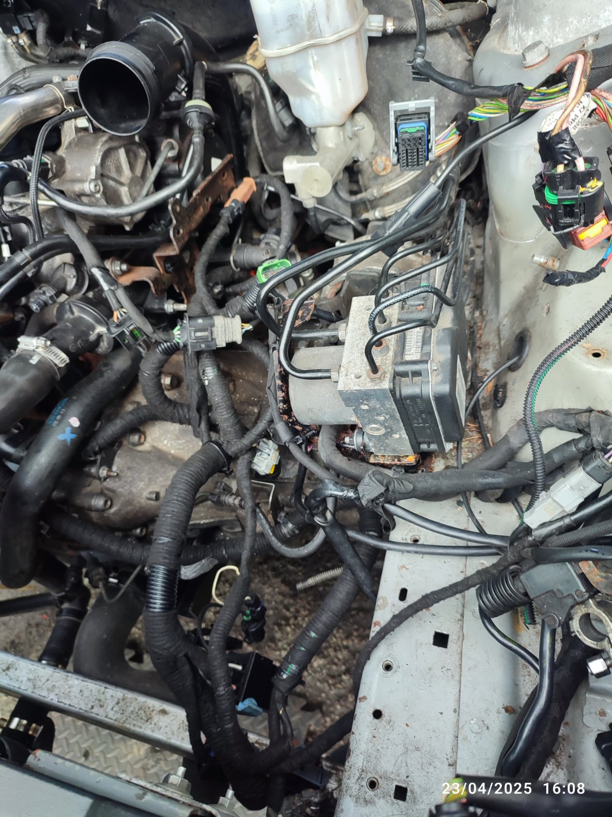

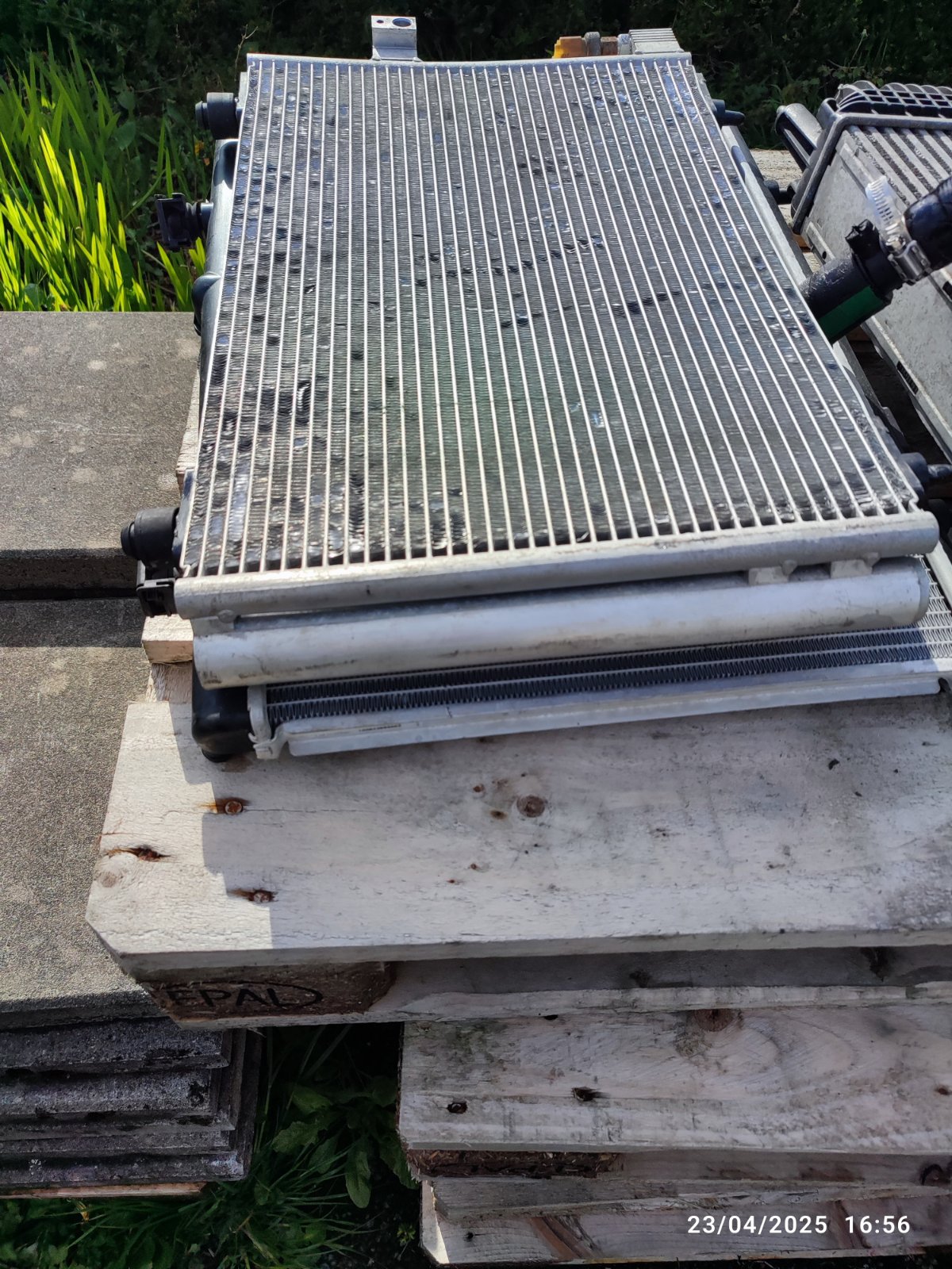

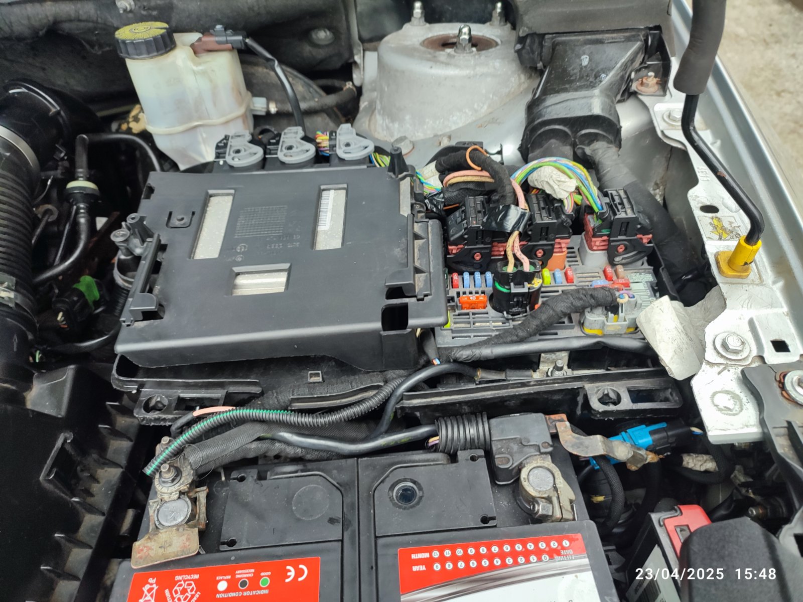

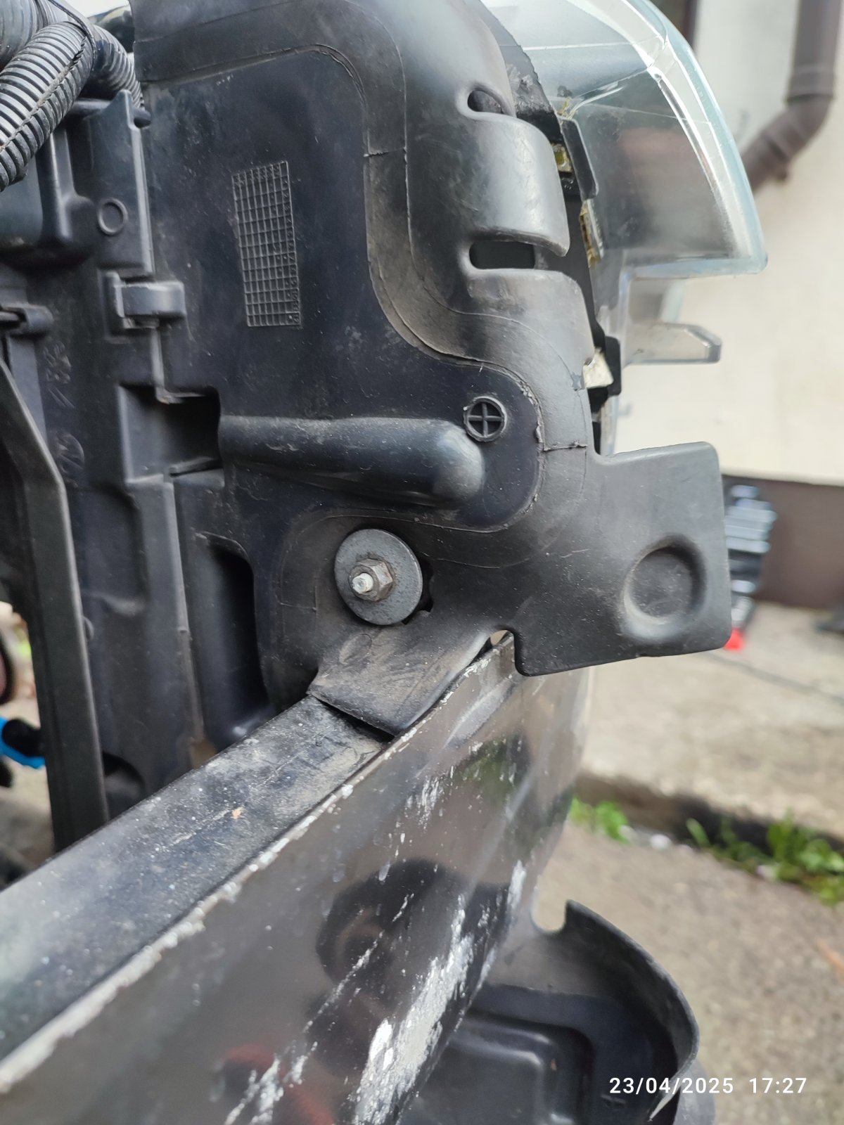

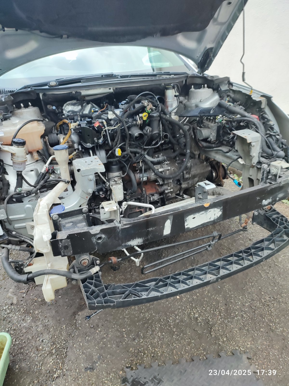

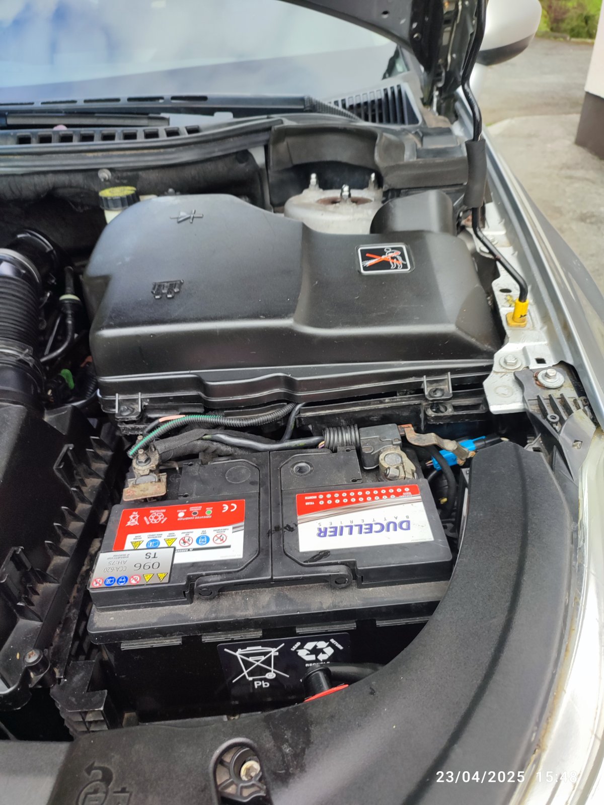

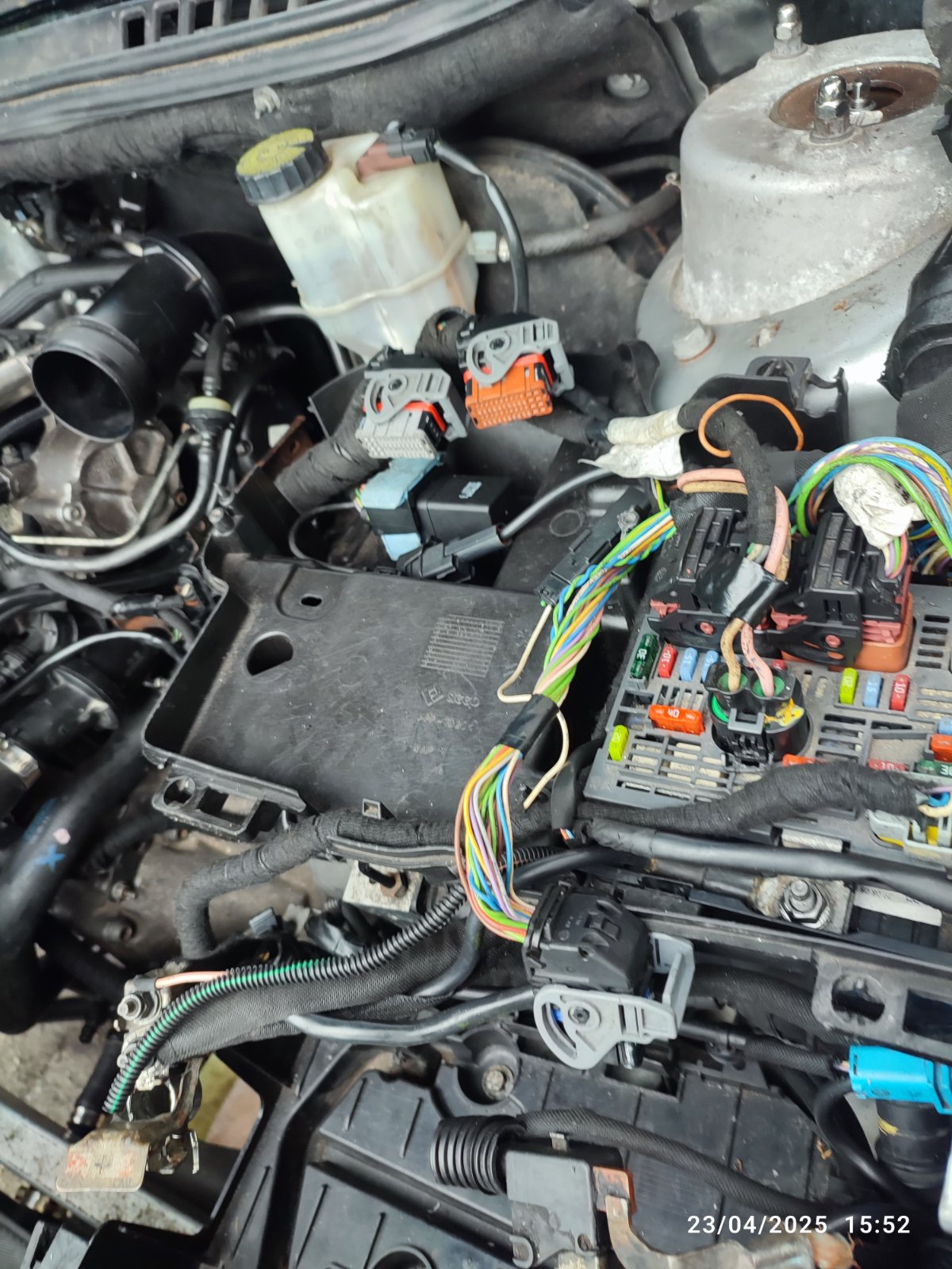

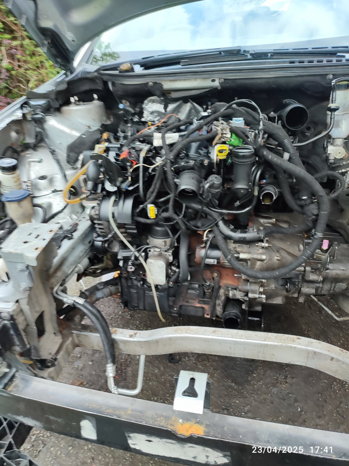

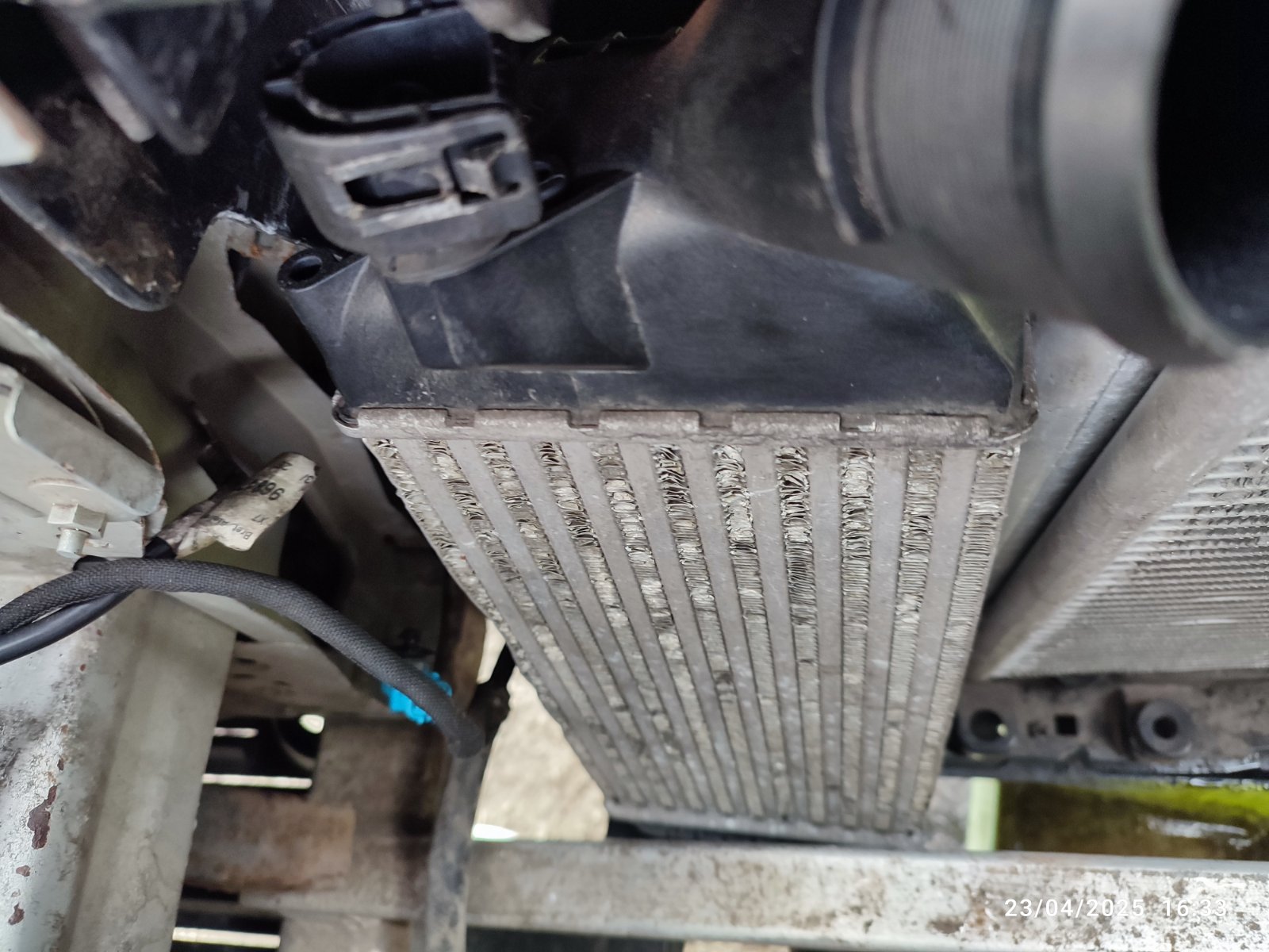

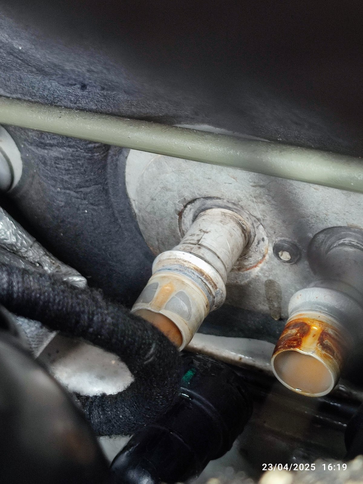

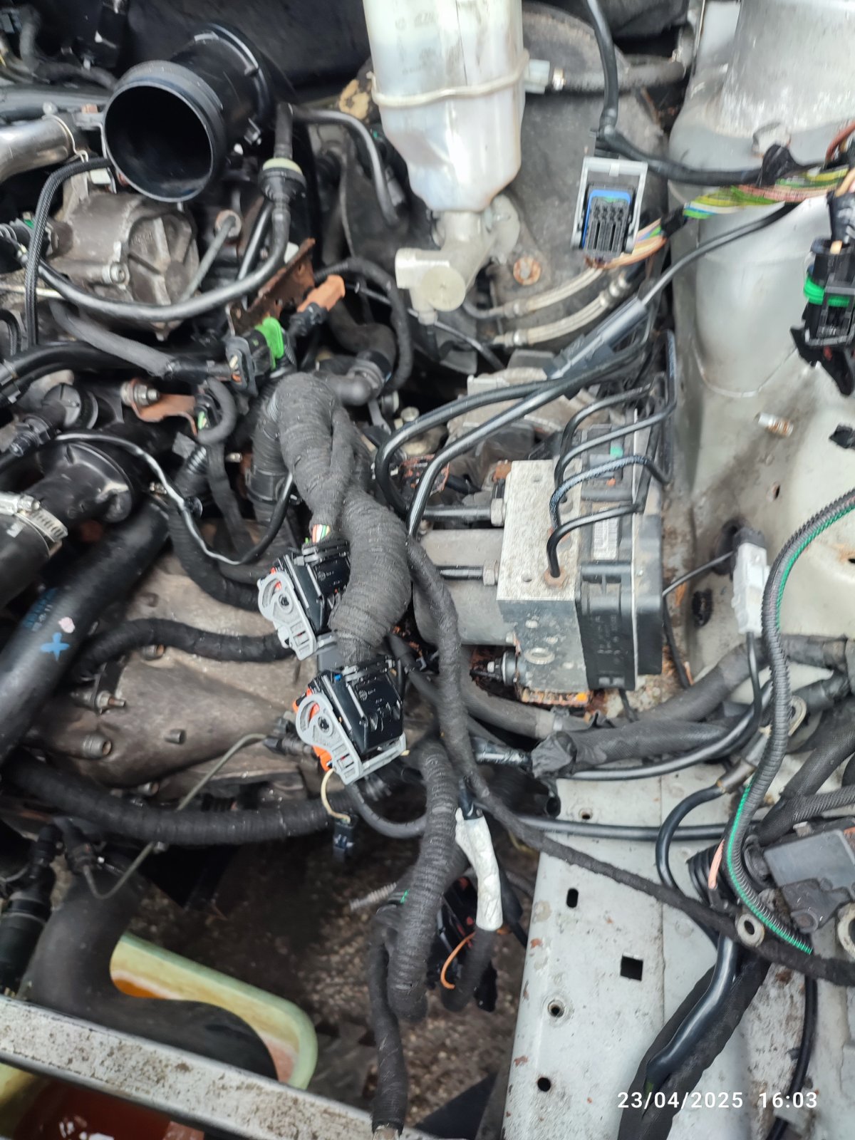

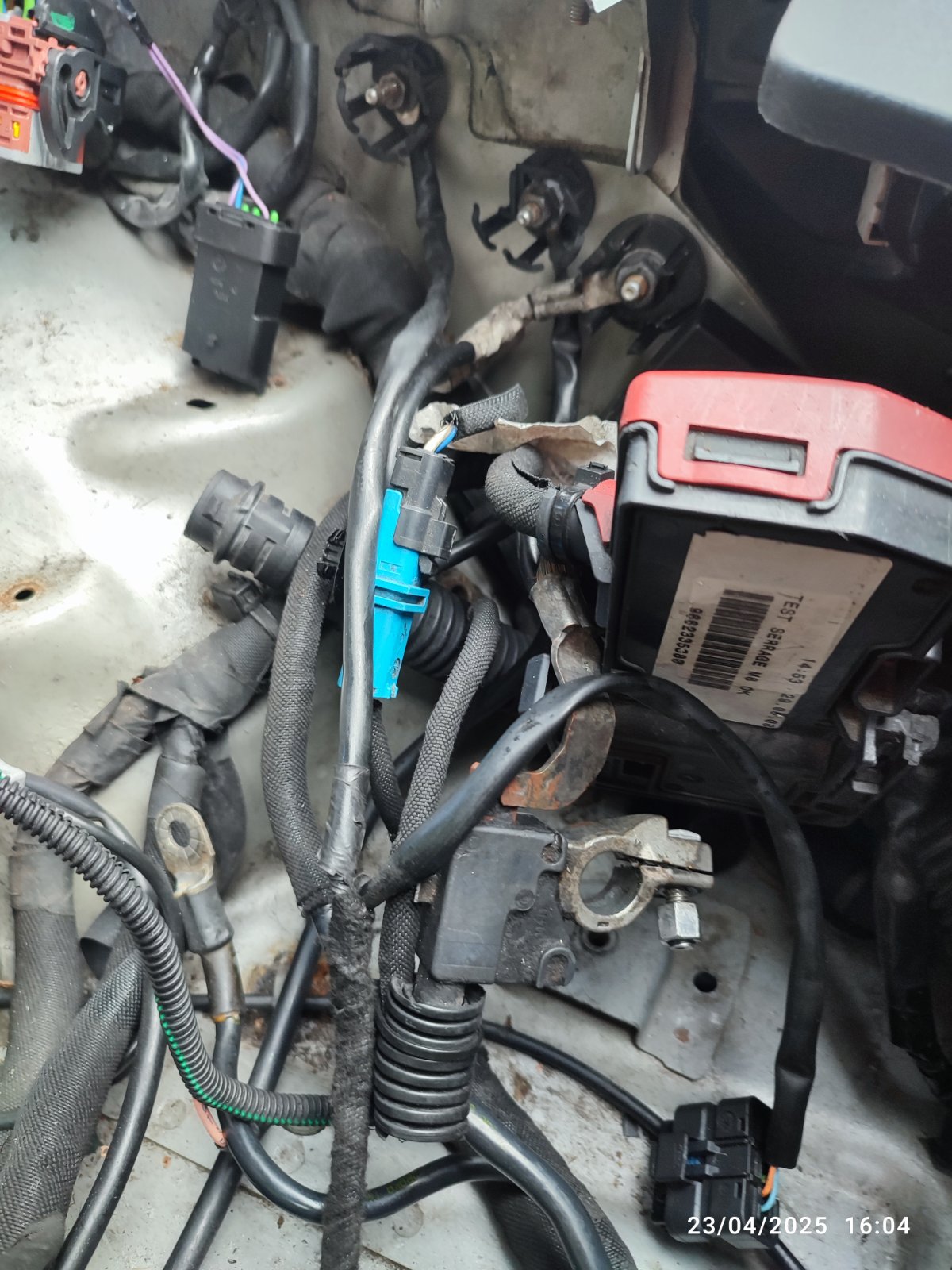

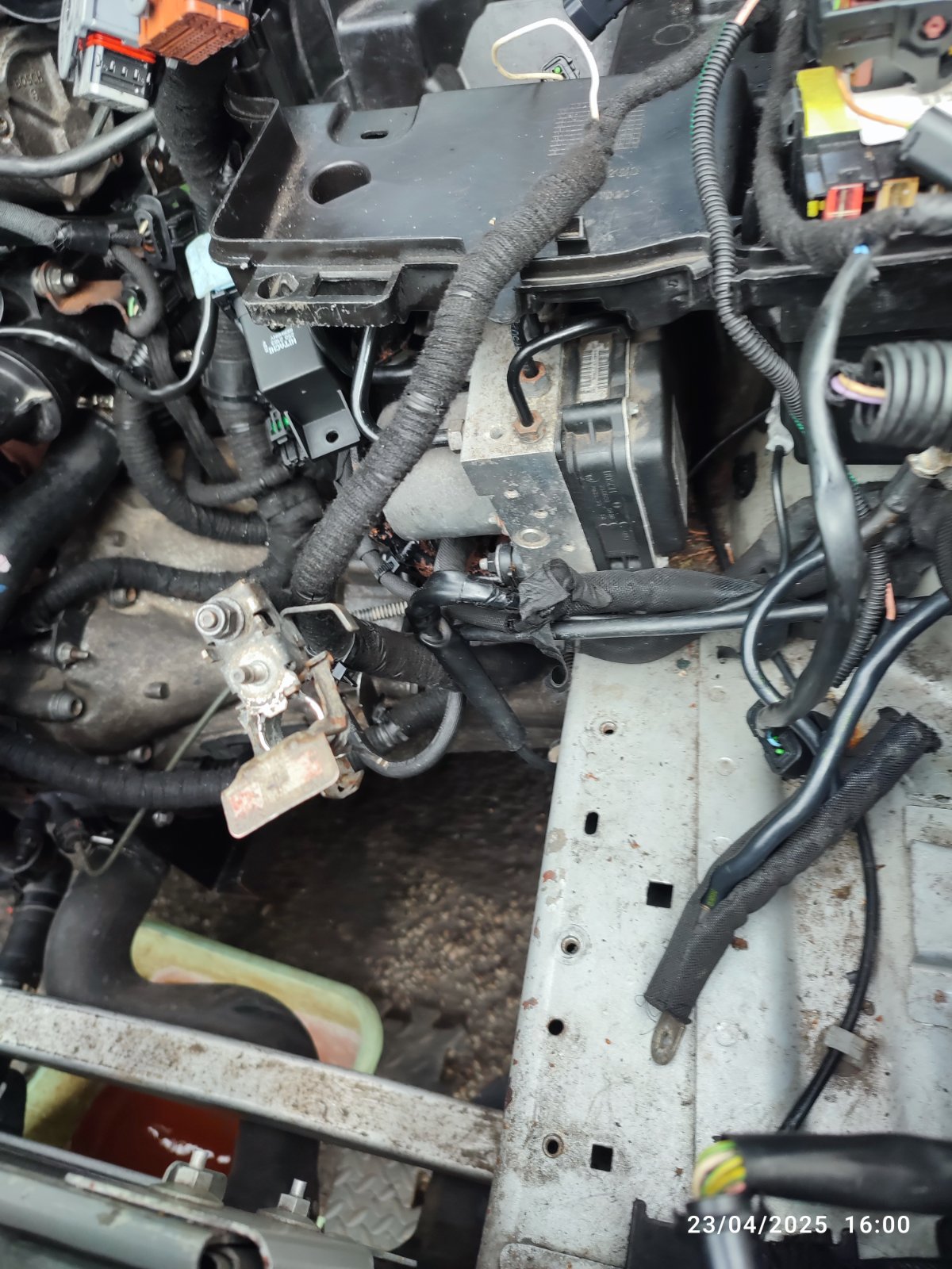

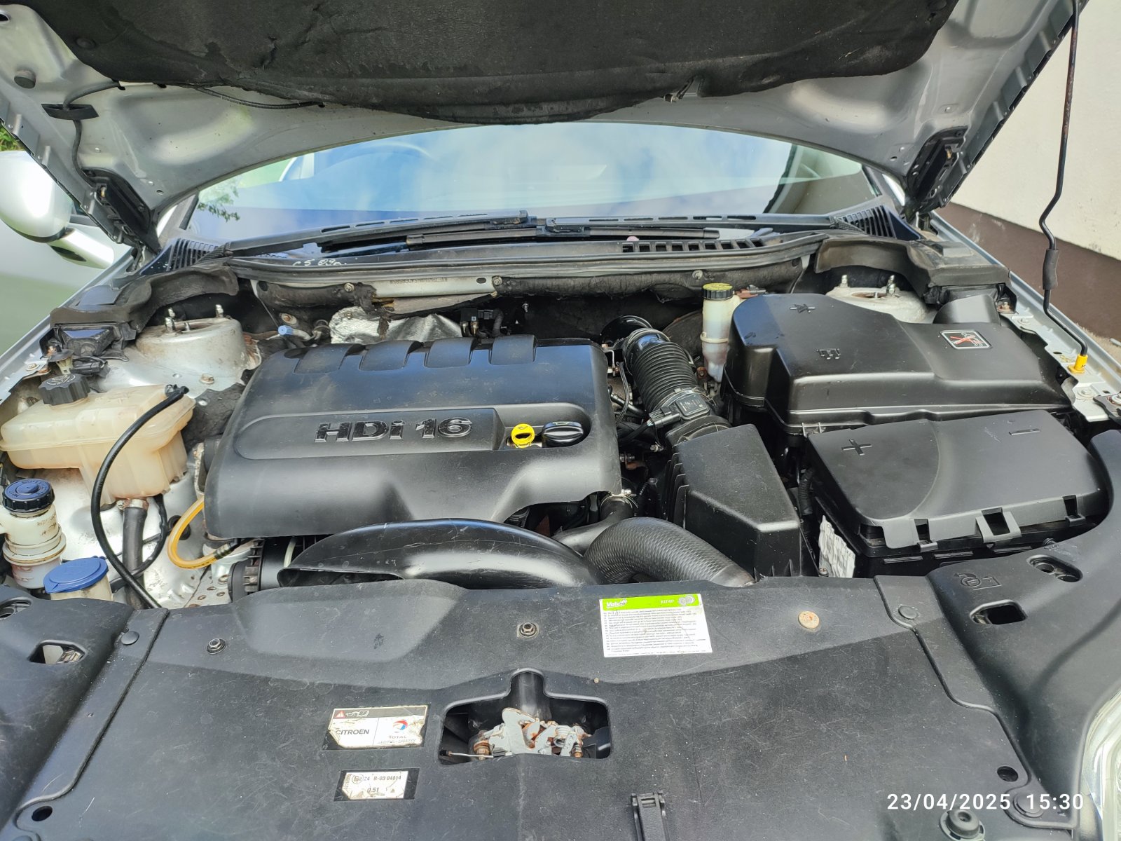

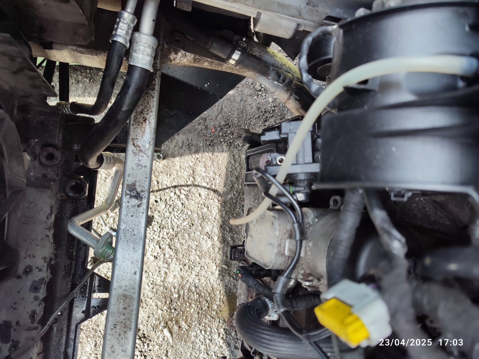

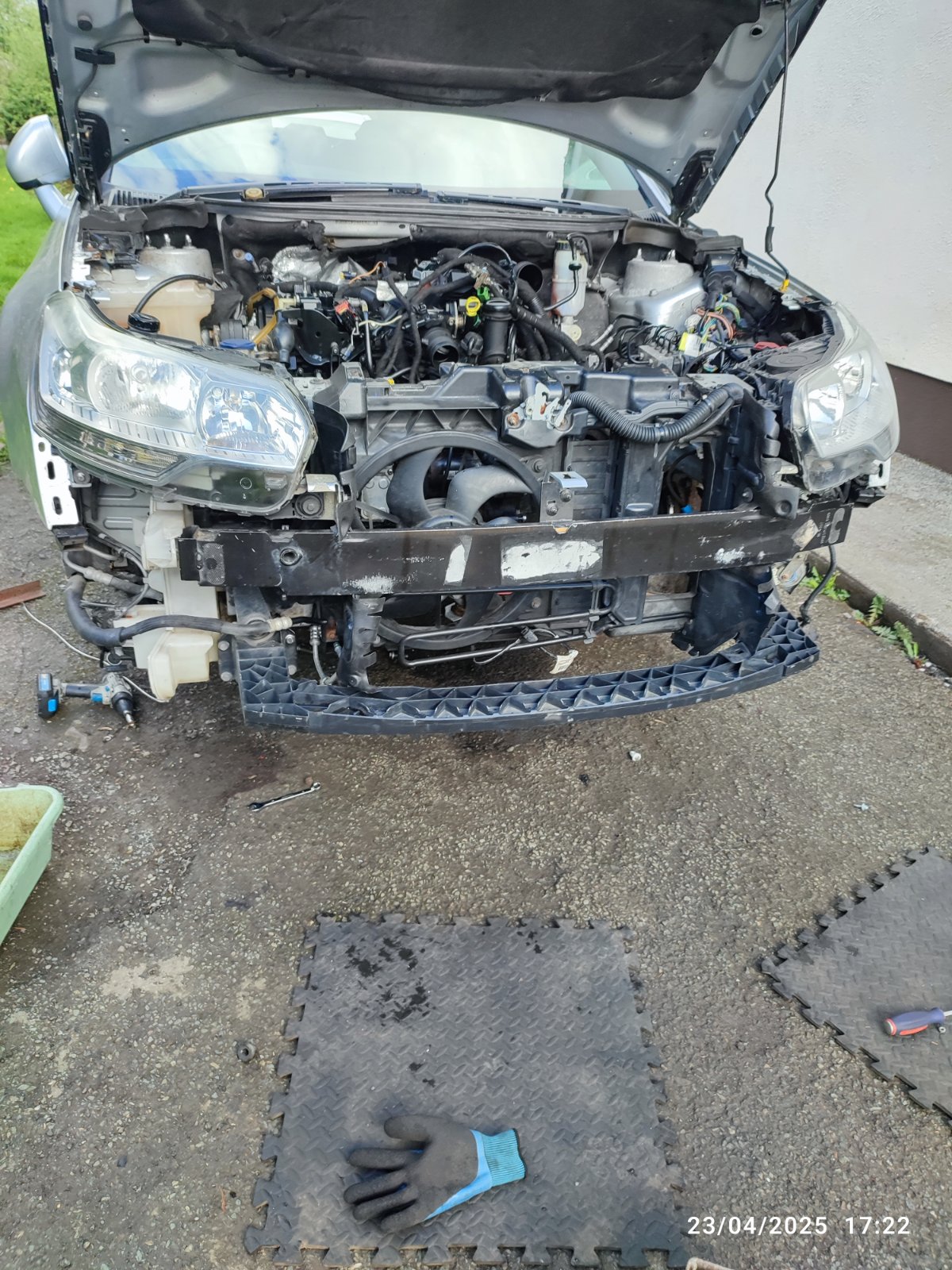

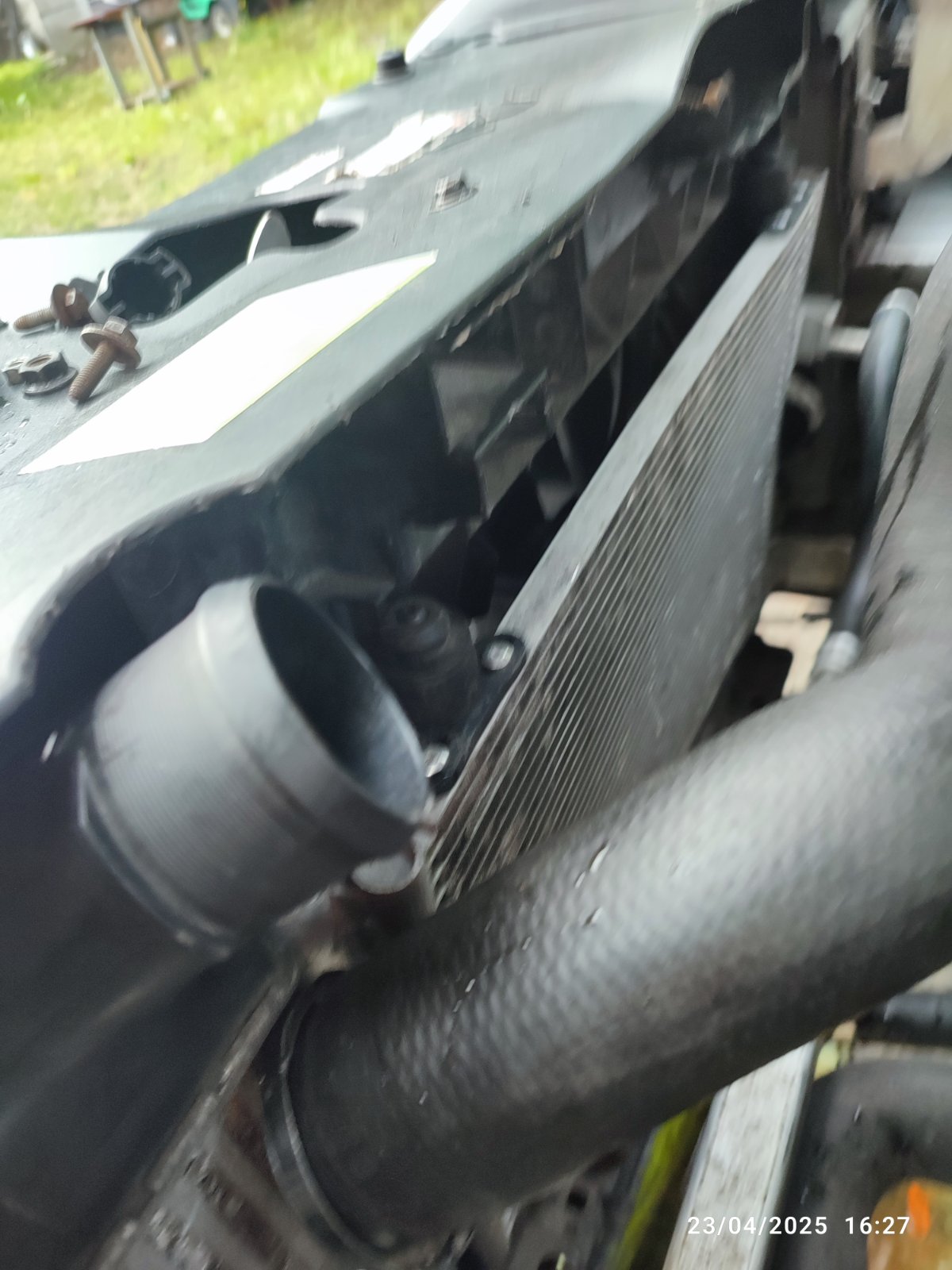

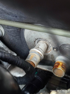

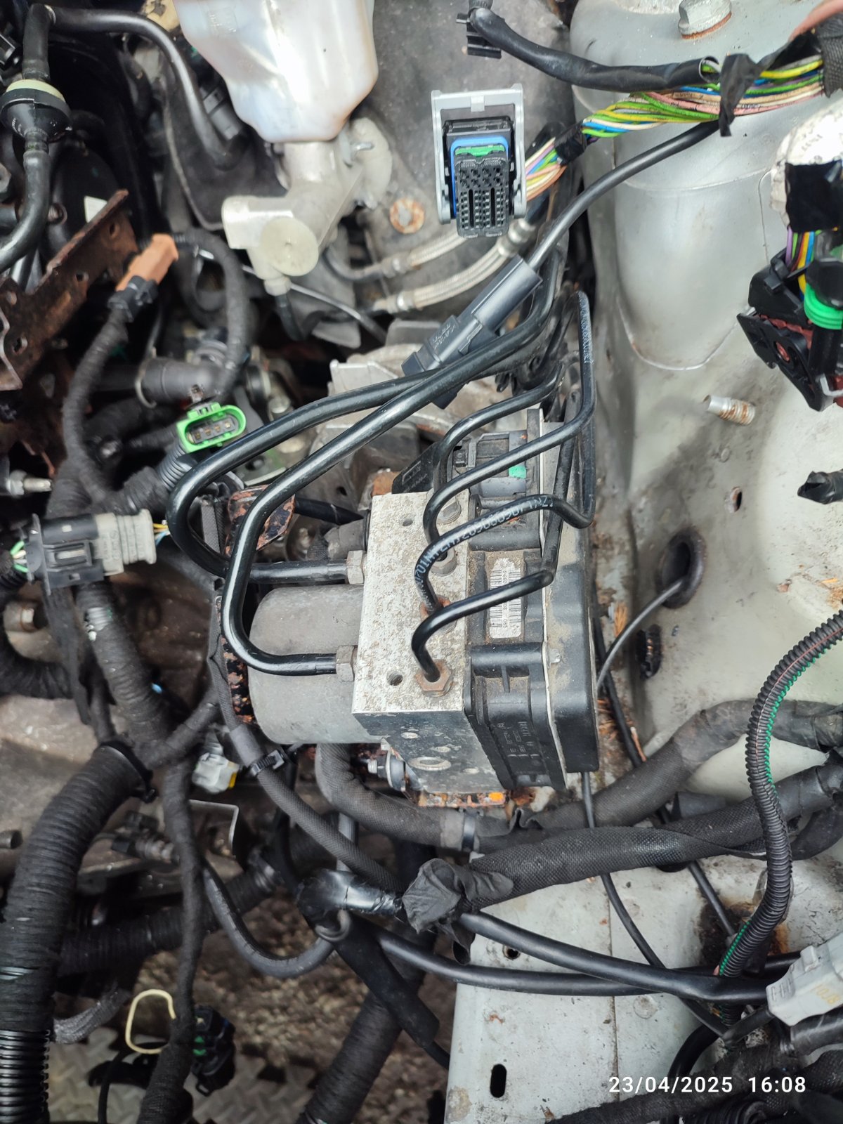

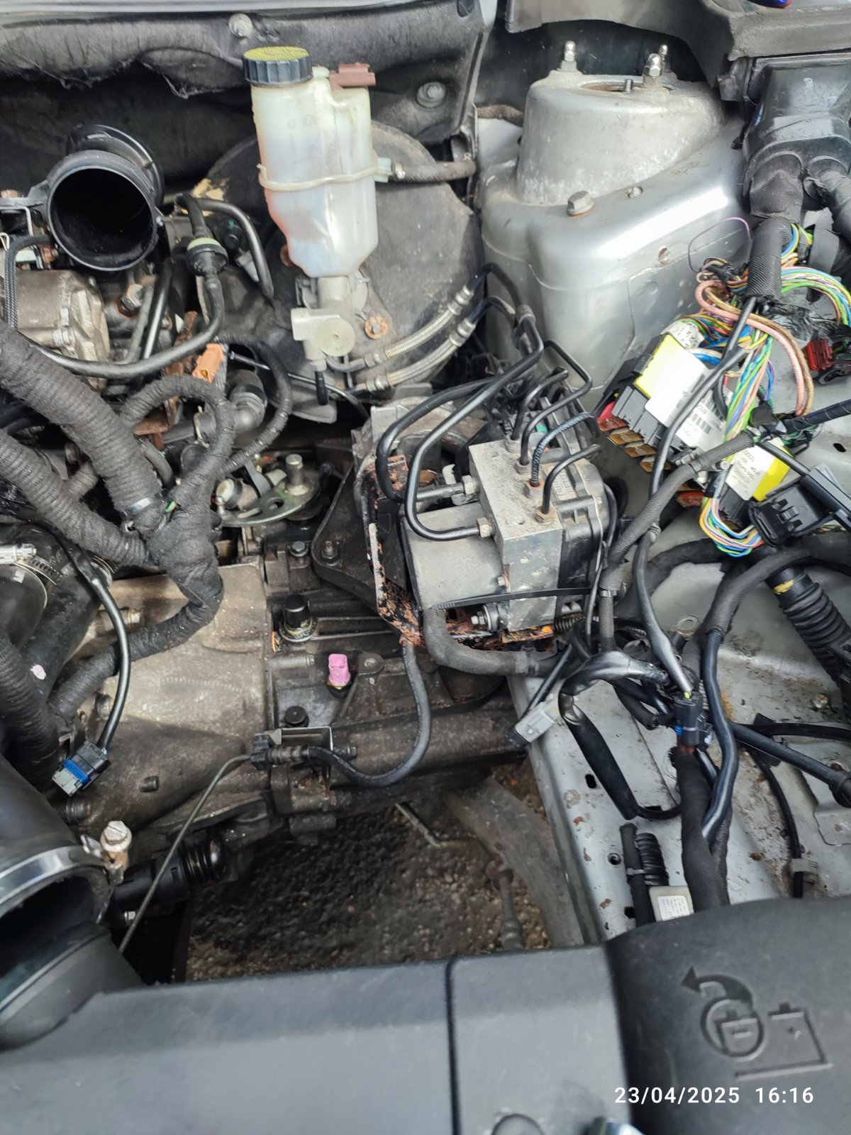

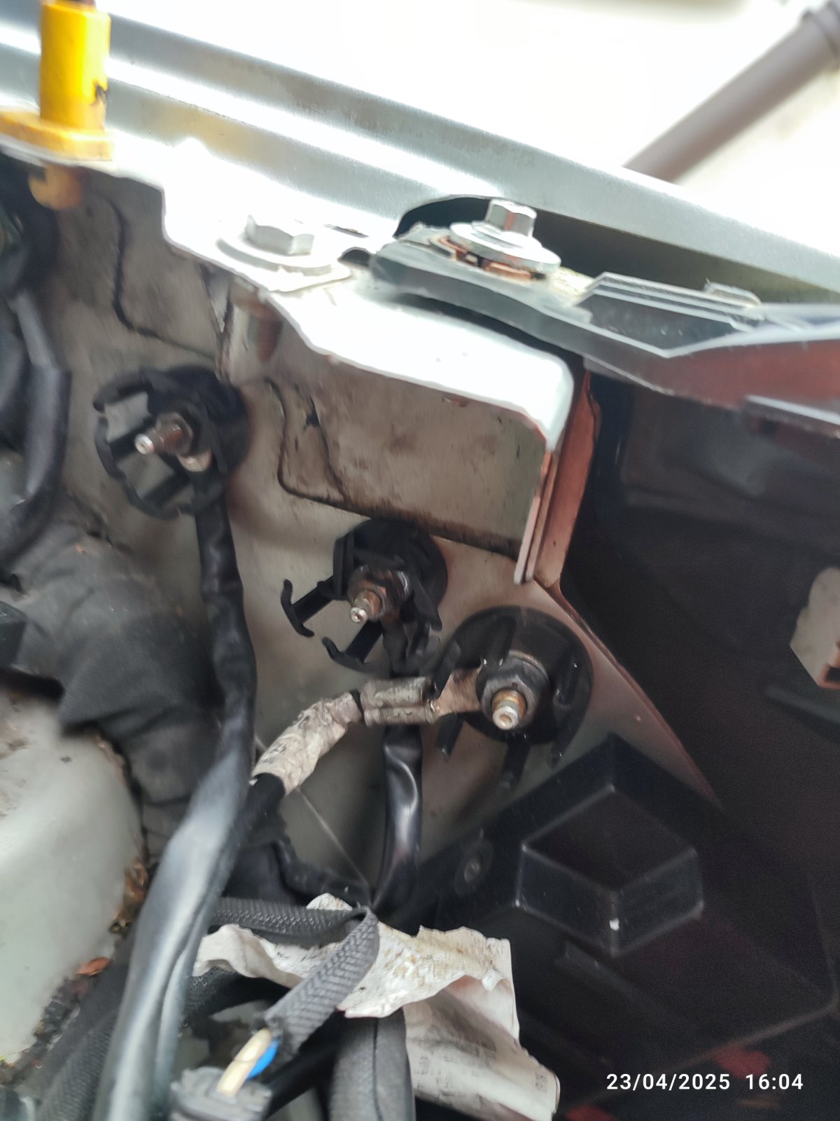

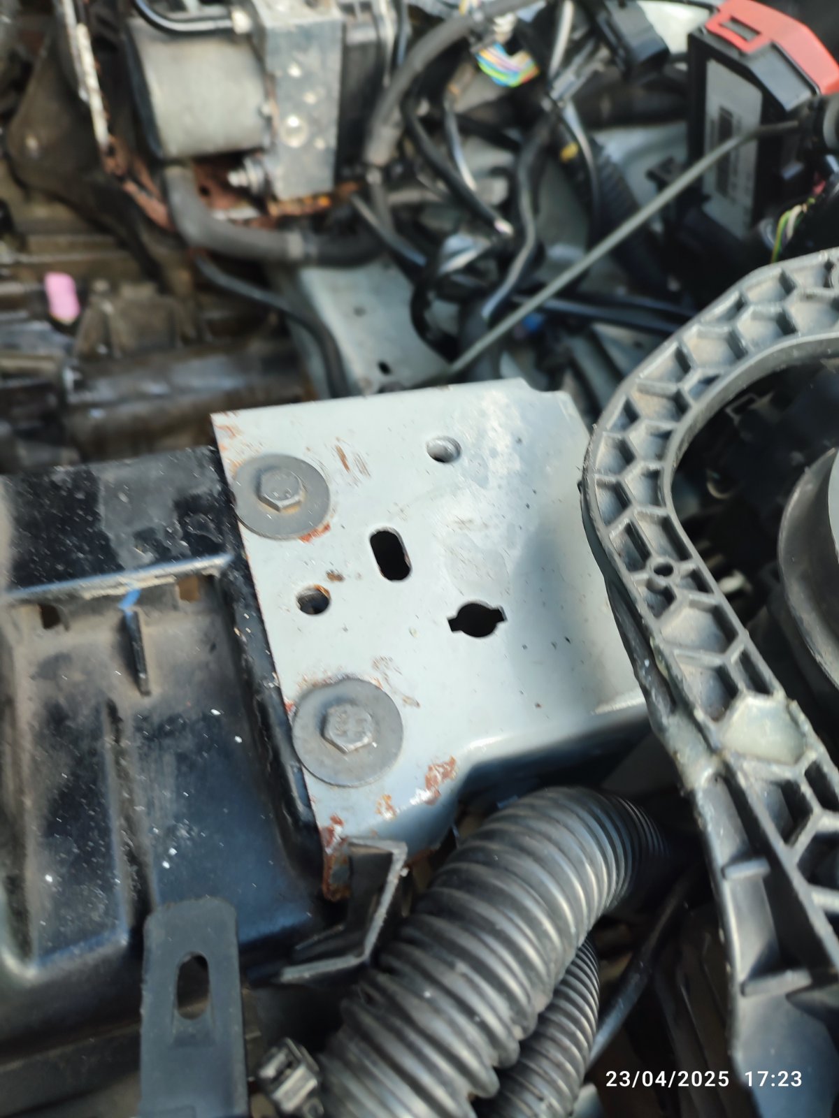

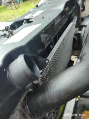

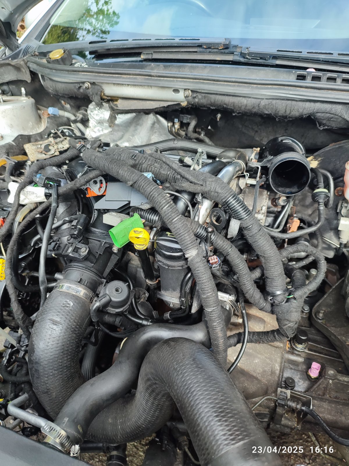

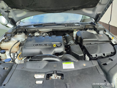

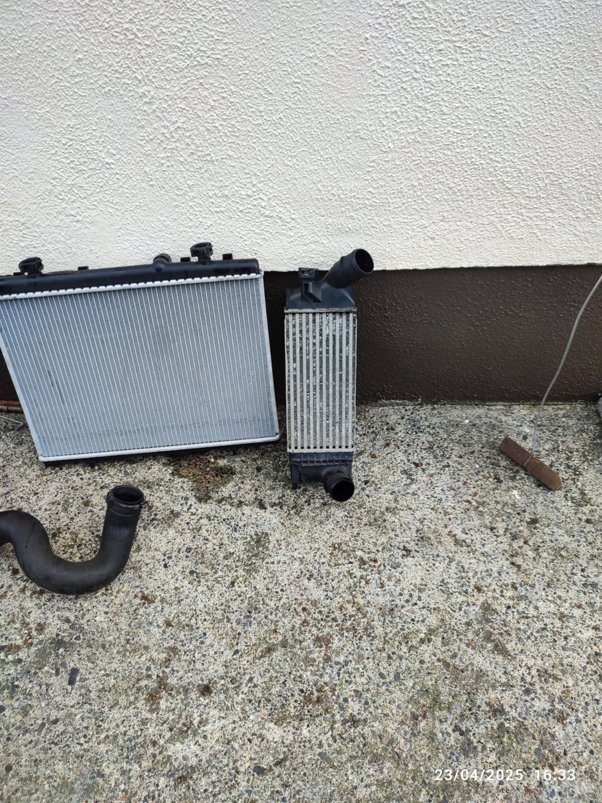

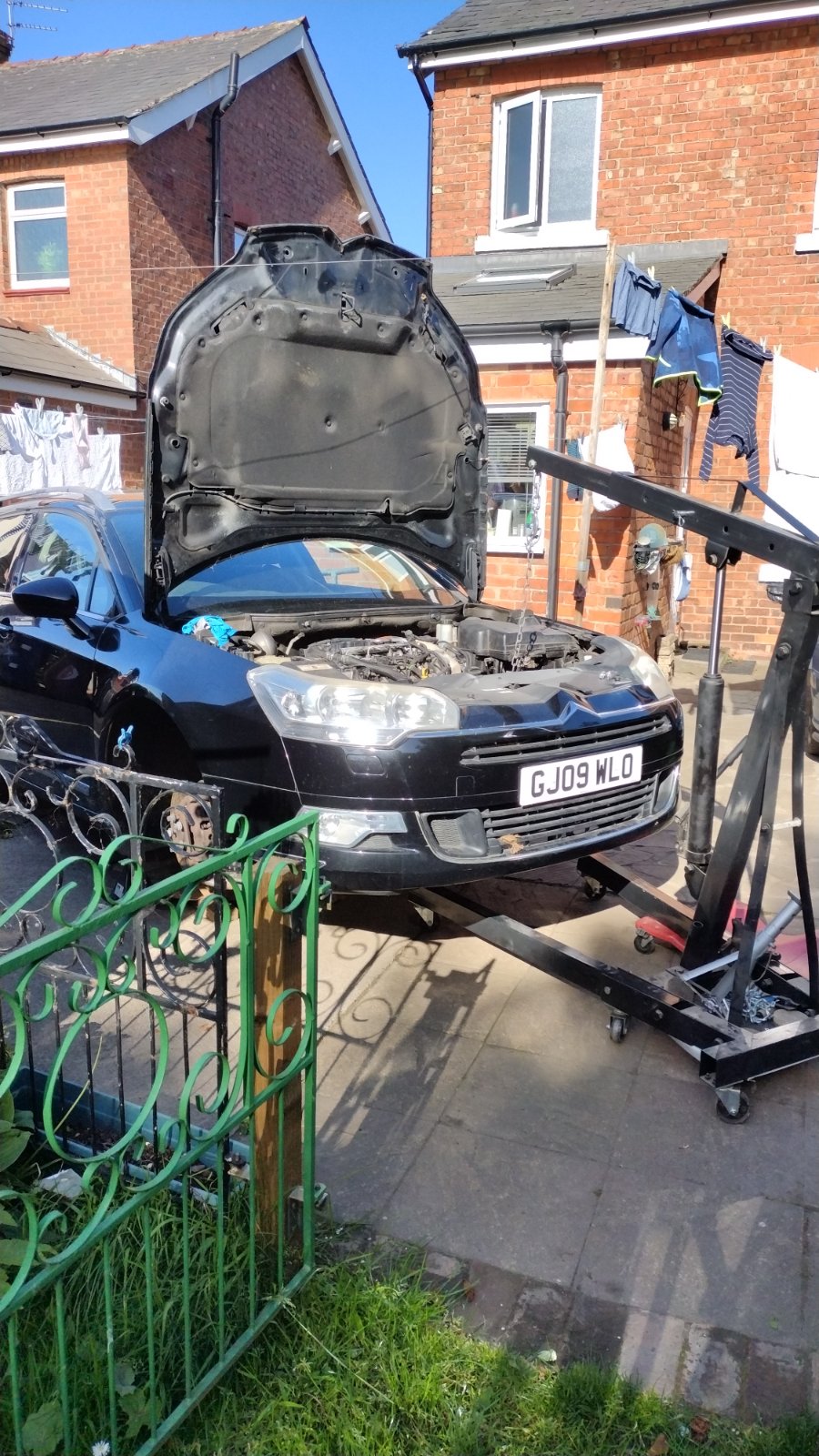

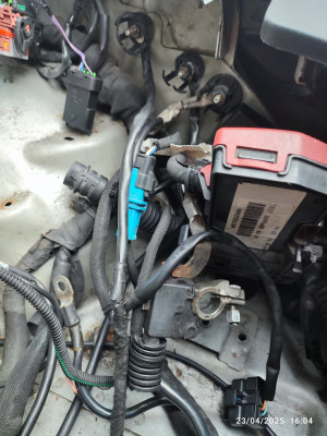

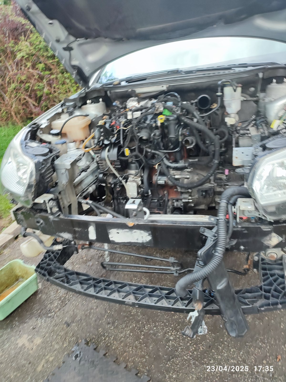

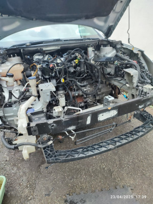

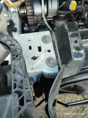

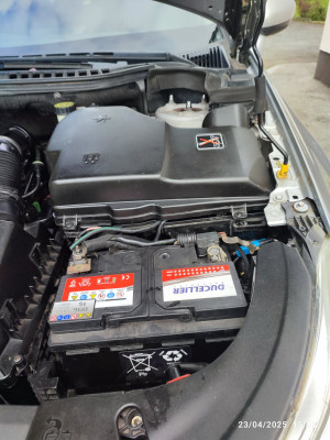

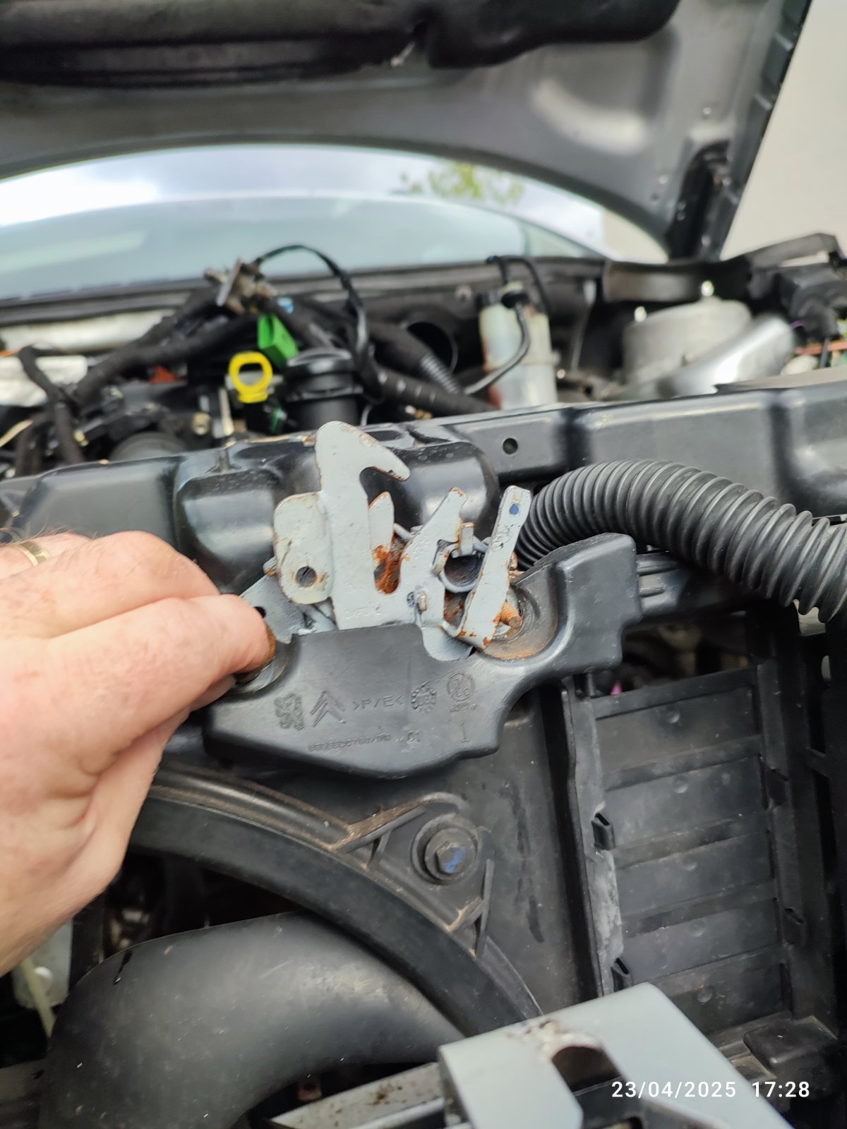

Ok so I have stripped engine and gearbox top side. I need to drain the gearbox, pull the shafts and disconnect the exhaust and gear cables. I will do this later this evening and tomorrow.i Have added pictures to show the steps I take to do it. I started at 14:30 and it's 18:00 so about 3.5 hors to get to this point.thats coolant in the basin. It's that pink stuff I find it gets very frothy.
Darren

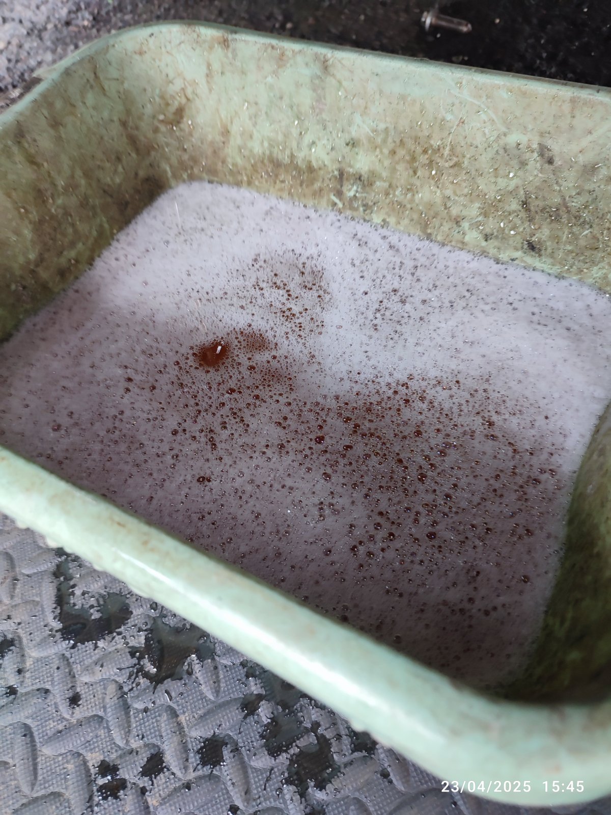

Re: Injectors misbehaving but trying to understand the numbers

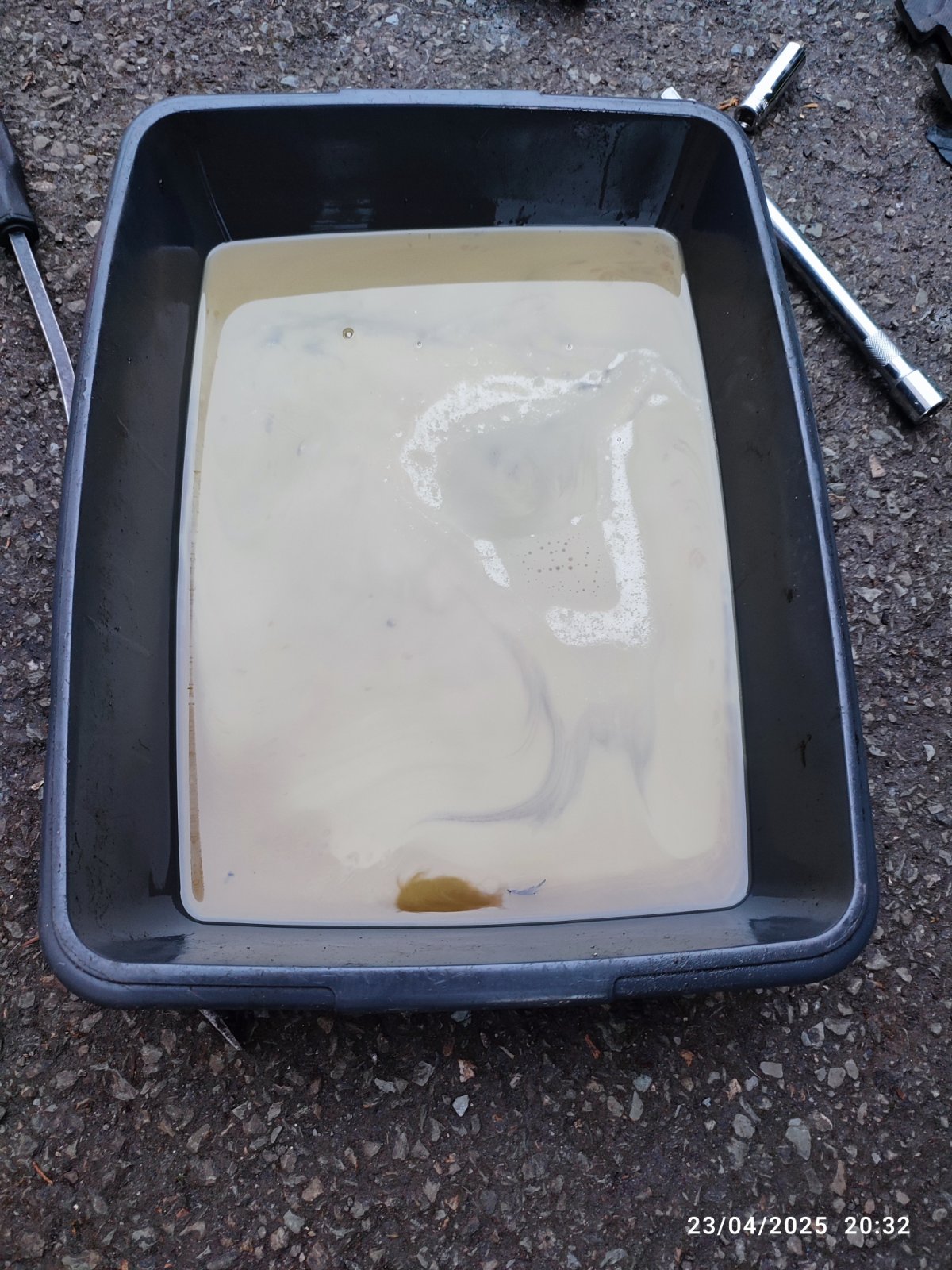

Well I just drained the gearbox and the oil is like mayonnaise/milk. I don't understand how water could have gotten into the gearbox as the car was complete up until a few hours ago and I only filled the oil the other day and it's not like the coolant system is linked to the gearbox.anyone ever seen this before. I'm changing the gearbox anyway but I don't want this happening again.
Darren
Did you leave gearbox breather/overflow/vent cap open and rain water got somehow into the gearbox ?

Hopefully "motivational" photos from when I had the gearbox out on mine.

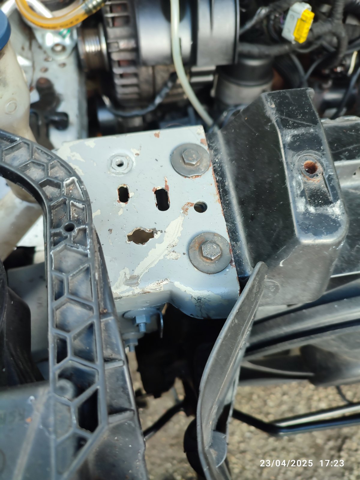

That (black plastic) bumper lower support and the (aluminium) support/crash bar behind it also comes out.
Engine crane (and long chain) let me take the weight and lower the gearbox down. Jack and piece of wood under the sump taking some of the engine weight - not visible in the photos.

No the cap was put back on as soon as it was refilled.
