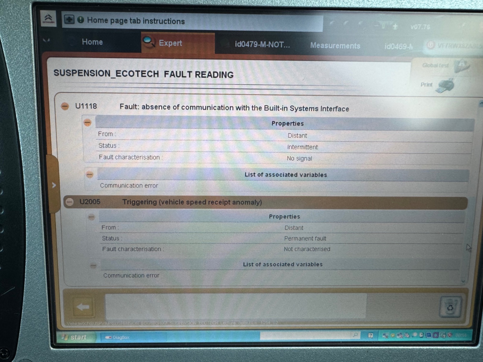

For what it’s worth, these are the faults stored in the suspension ECU

There's a permanent fault for vehicle speed, assuming this has variable PAS I imagine that's what causing it. Will it clear? Is the ABS light on? Possibly the wires you disturbed are speed sensor related, and the data is now lost somehow?

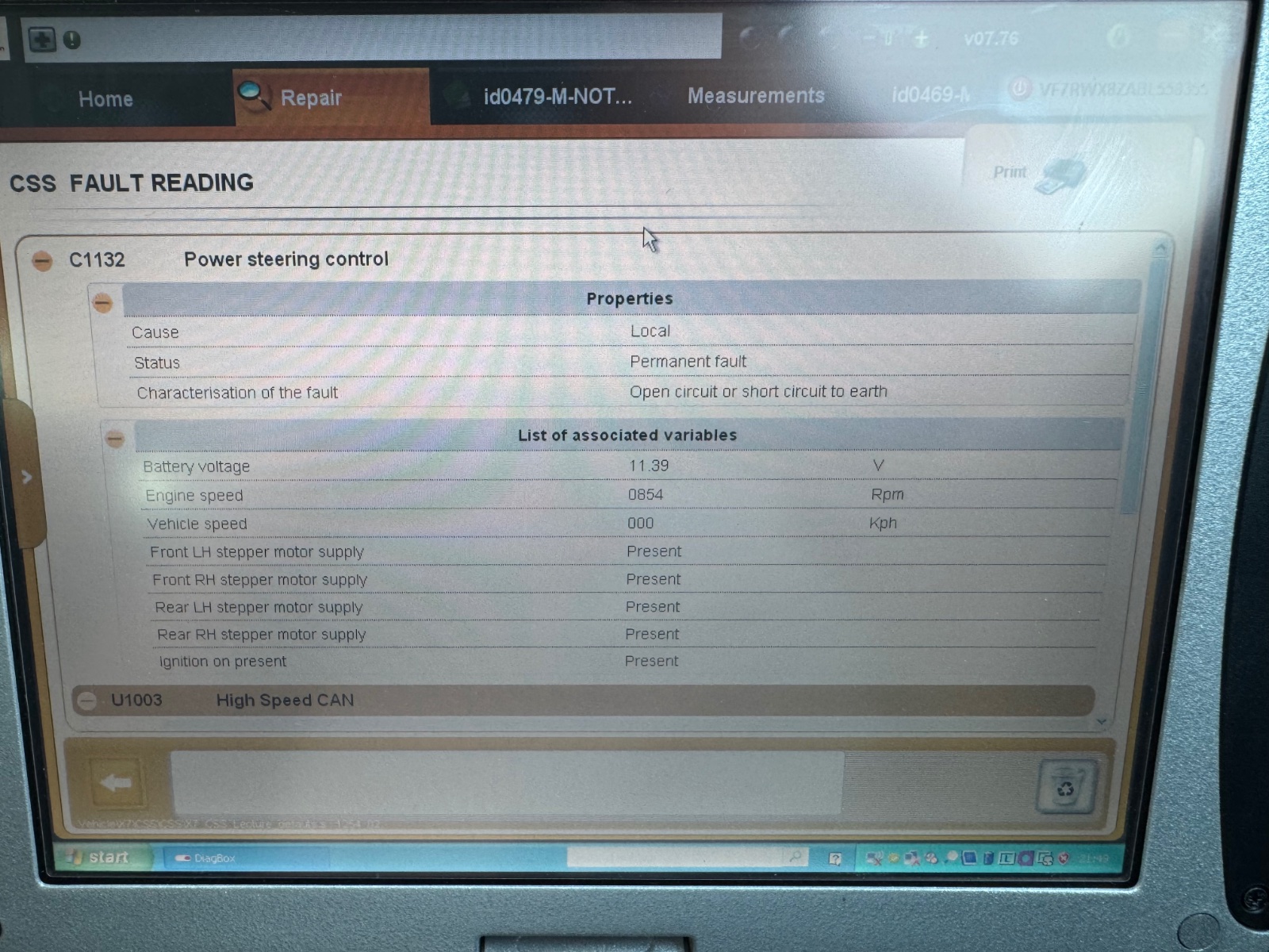

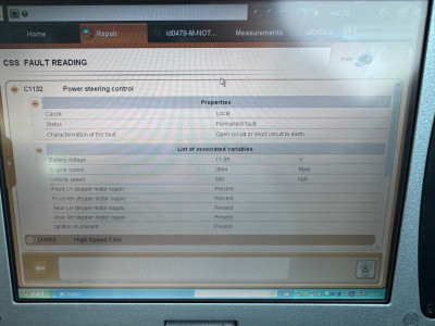

Finally the car acknowledges it has a problem…
Quite surprised that loss of power steering isn’t ‘serious’ enough for it to put a fault light on the dash, but hey-ho.
Iain
CX DTR T2 Safari (silver)

It's a bit strange, about the stepper motors, because this belong to the C6 with amvar system.
wurlycorner
Posts: 2194
Joined: 30 Oct 2012, 22:37
x 272
Re: C5 X7 no power steering
Unread post by wurlycorner »
Yes, I don’t understand the stepper motor references.
I can’t see anything on this forum for C1132 (code set criteria, causes, fault finding etc) or anything relating to the steering system in general (aside from the rack of course!).
Unless someone has access to that information please, I’ll have a look on c6 owners and see if there is anything helpful there.
Iain
