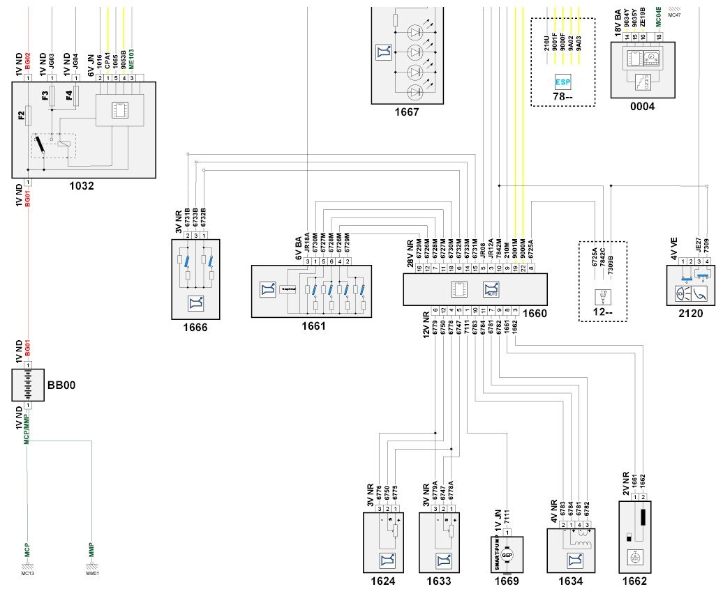

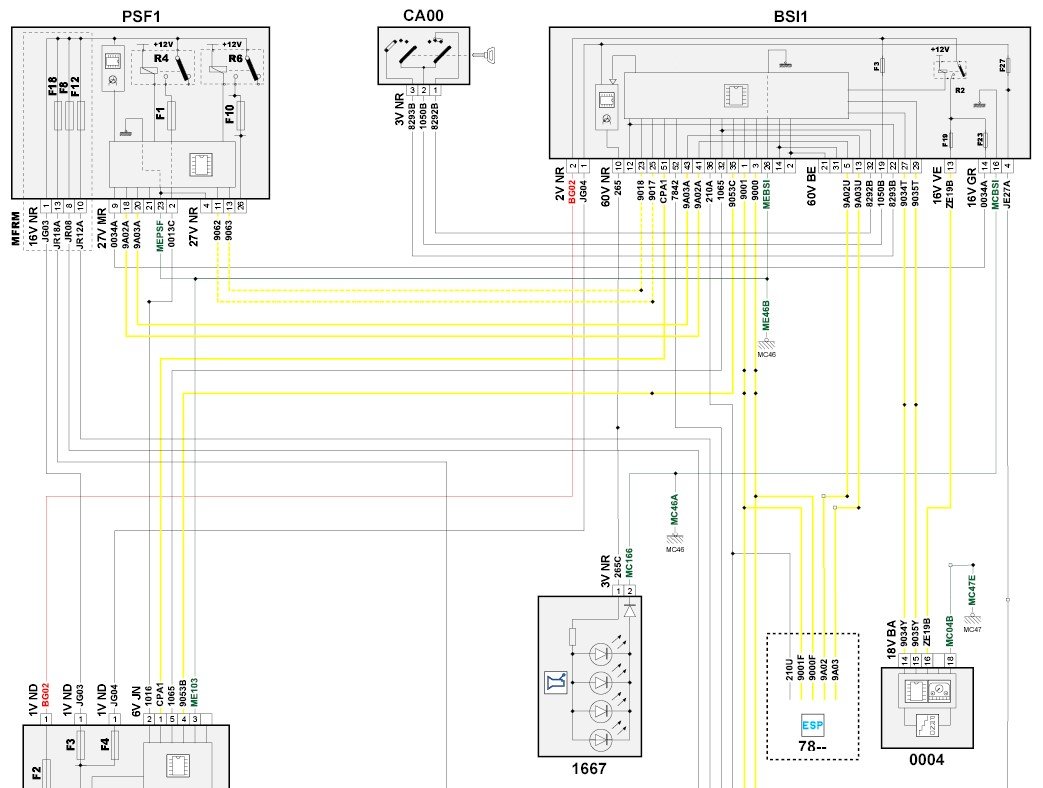

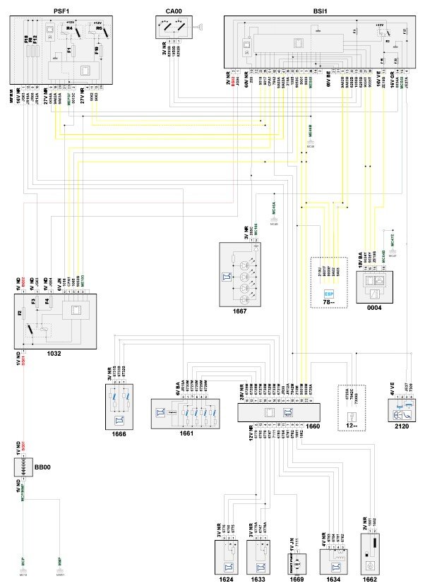

I think I have power or earth fault ( fuse wiring etc )
So can I get some help with wiring diagram
I got wiring diagram posted by wheeler for my berlingo ,it was for pug 405 which got me fixed but this gearbox is not the same no good
I would if possible like the correct diagram for this gearbox showing power, earths, can wiring

I charged full battery and had battery charger connected but still fault no communication when trying to program
Thanks for the proper wiring diagram will try to check it out and report back

Re: Citroen C4 B7) Auto /Manual gearbox fault
Well the news is not good, thanks to the wiring diagrams supplied I was able to check all power and earth supplies
Aii good ,wiring to selector actuator and clutch actuator no faults
I don,t see any reason for not program clutch / gearbox
