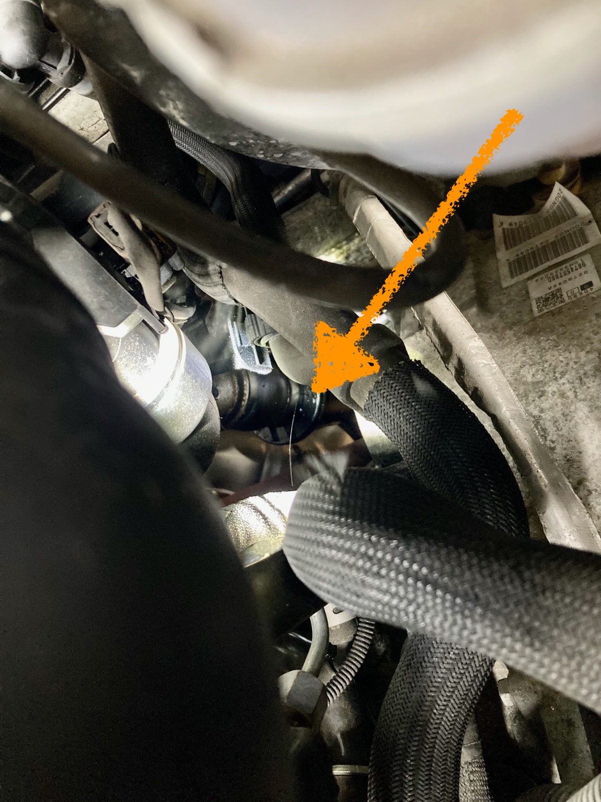

I've still not got round to the timing belt job, but noticed an oil leak I'd like to identify (and fix!). However, having looked from as many angles as the cold weather and a pair of "wish they were taller" drive on ramps will allow, I'm struggling to know what I'm looking at.
I've removed the plastic under tray, which was covered in engine oil and cleaned off as much oil from the engine and ancillaries as I can. I left it a few days and a few drips have arrived on the drive and more appeared on the bottom of a plastic pipe under the rear of the engine.
I was always told that you should try to find the highest oily place on an engine and that this would likely be the cause. The highest place I can really see anything oily is by looking down the back of the engine with a torch, from the top on the passenger side. A black plastic tube and bracket "seem" to fit the bill. But (!) I don't really know what I'm looking at. Is this some turbo air pipework? Is there any kind of oil trap or filter here that might need changed?
I took the attached photo with a phone and torch, so it's far from perfectly framed, I'm afraid.
As with all the problems I bring to our forum, I'd love some advice and opinions as to what is wrong.
(it's a 2.2Hdi engine in a 2013 Tourer Automatic)
Thanks in advance for any help!!!

I would give it a good wash off and see where it starts from, I usually use brake cleaner aerosol to remove external oil park it over a sheet of cardboard afterwards and you might get a direction from where it drips

Sometime Later!!!
Thanks folks for all your input.
Ok, I'm away in France and busy with work so much, I'm not getting the time and opportunity to get to the bottom of this. Sensing victory, the C5 is throwing a few new problems into the equation (like the Eolys - now fixed) and if I'm not careful, it'll become quite a list!
I have bathed the engine in brake cleaner and still can't find this leak! I keep the under tray off now, to help me grab a look when the opportunity arises. I even took it to Halfrauds one day, back in the UK, just to see if general knowledge might help. Hmmm. They offered to take a look free of charge, then argued amongst themselves, then told me I'd have to pay to have it looked at, then said they hadn't a clue anyway! I left, thinking that asking a passing stranger in the street might have been just as good.
So, I'm waiting for a friend of a friend with a 4 post lift and I'll try another look.
Just for my sanity though. Are there any oil recovery/ventilation/catch/pipes between the engine and bulkhead that are known to overfill/leak/split or fall off? I know I'm possibly getting in close proximity to the turbo (said in hushed whisper!), but a simple replacement seal or whatever would fill me with joy!

I know this is old, but just by way of closure.
My oil leak turned out to be from the crank case oil seal (at the automatic transmission end!)
I then noticed small coolant leak from around where I think the thermostat lives.
So I handed the job over to a nearby english mechanic on the "do it when you have time" basis.
A local French mechanic said he wouldn't touch it!
I also handed him the timing belt and water pump kit I'd bought and planned to do myself.
Six weeks and 1500 Euros later (don't work it out, its still bad!) I had my car back. He'd already sent me photographs of the engine on the workbench. As he put it. Once there are 3 jobs or more on an engine, he takes it out due to Citroen's fabulous access record. The cost included refilling with oil, water and aircon refrigerant.
So that aspect of the car is sorted. No more drips on the drive and the levels are staying where they should.
What next? Oh yes, the "list".....
