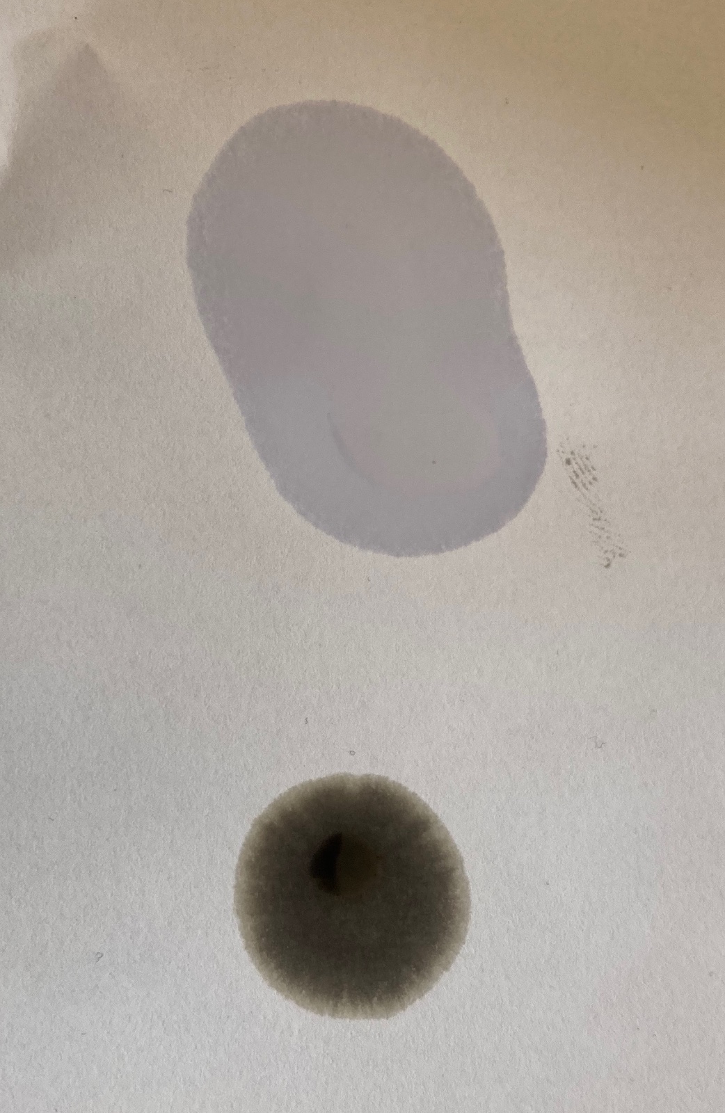

I've tried the highly scientific drip test on a sheet of paper (photo hopefully attached) and it's not 100% conclusive, what do you think?
I've added a drop test of some clean oil just to see how that spread and there's not a vast amount in it.

If you've ruled out coolant with the test kit, it really has to be diesel doesn't itArgos69 wrote: 08 Apr 2025, 13:40 ...Now, I know this was a bit below the last time I checked (I have a minor oil leak down the bulkhead side of the engine, so I check regularly-ish).
The oil smells and feels pretty normal to me.
Monitoring required to see how much the level rises, over mileage covered.
