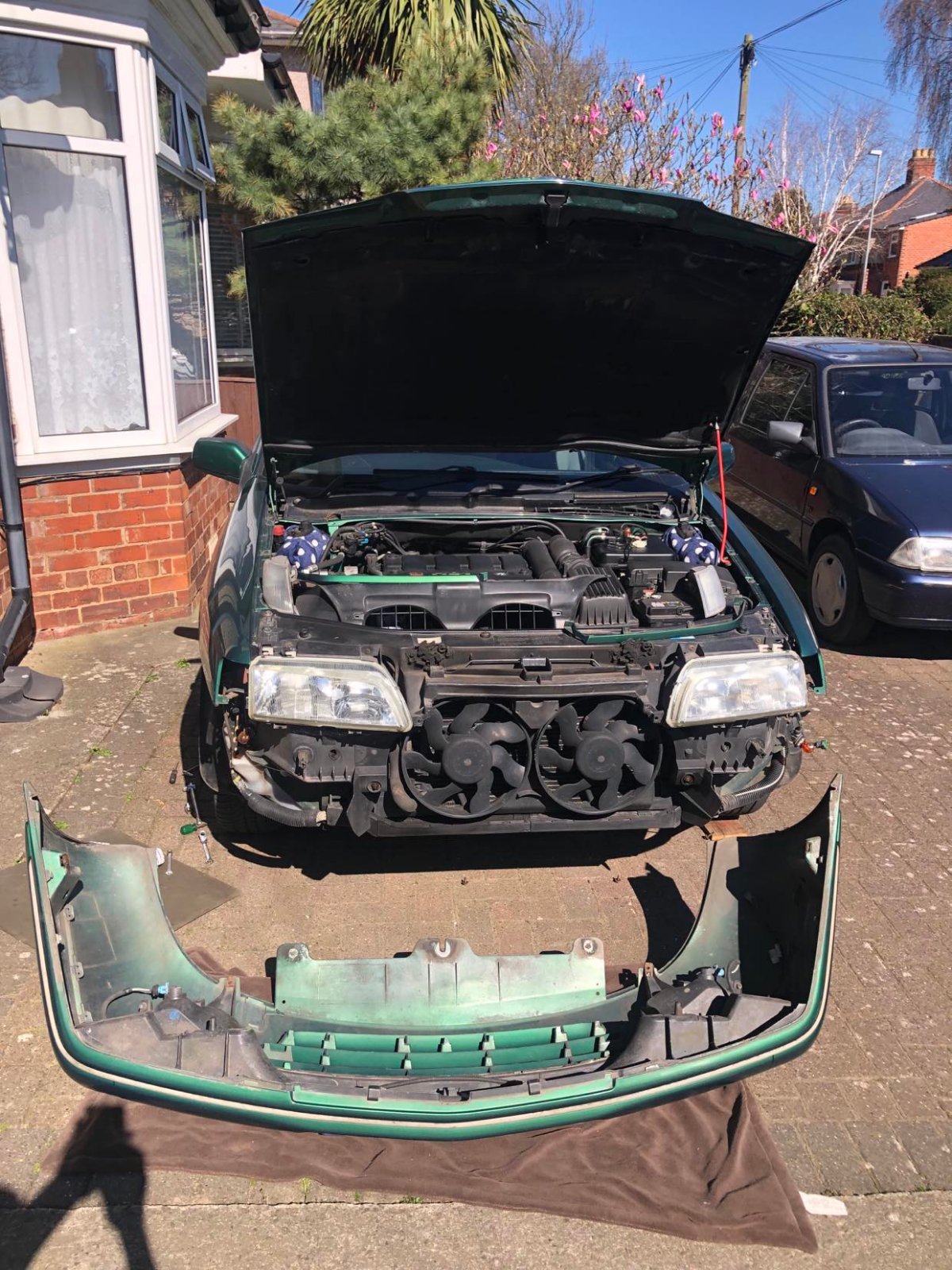

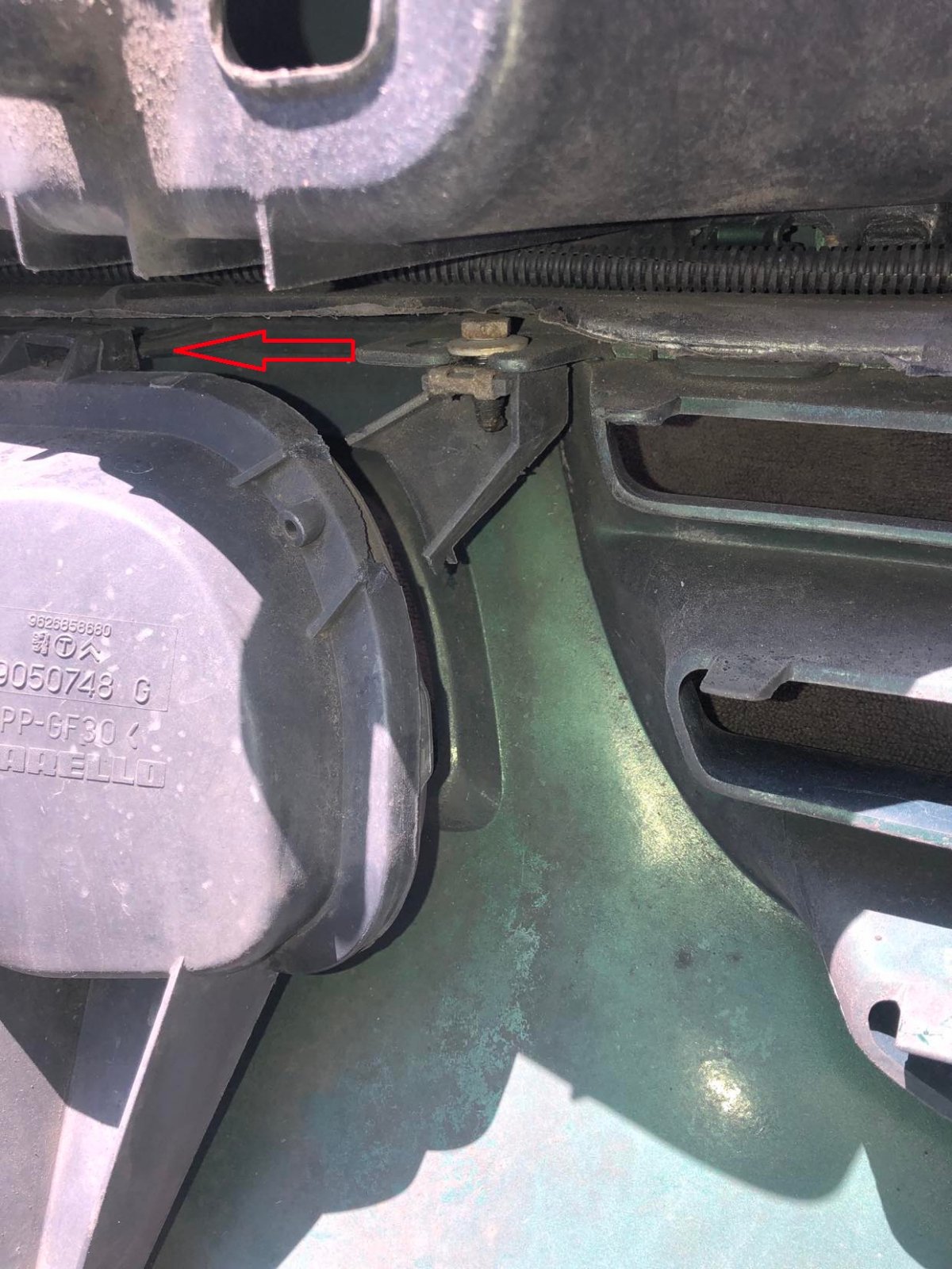

Well I thought I'd better make an effort to keep her looking pretty, the fog light wouldn't sit back in the correct position and I could see through the gap that the inner bracket was broke :cry: That meant having to remove the bumper ...
Skull's - Bumper 'popped off'

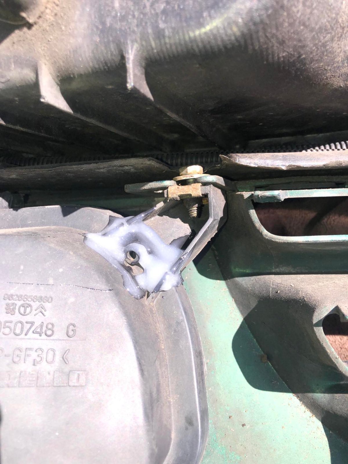

Damaged bracket after removing Fog Lamp fully to allow locating tab (arrowed) on bumper to be re-inserted squarely onto fog light slot/brackets - it needs to go on square before fixing and had been forced out of the central locating tab, which was why I couldn't realign the fog lamp without removing the bumper!!
Skull's - Damaged Bracket
Araldite
Skull's - Araldite repair

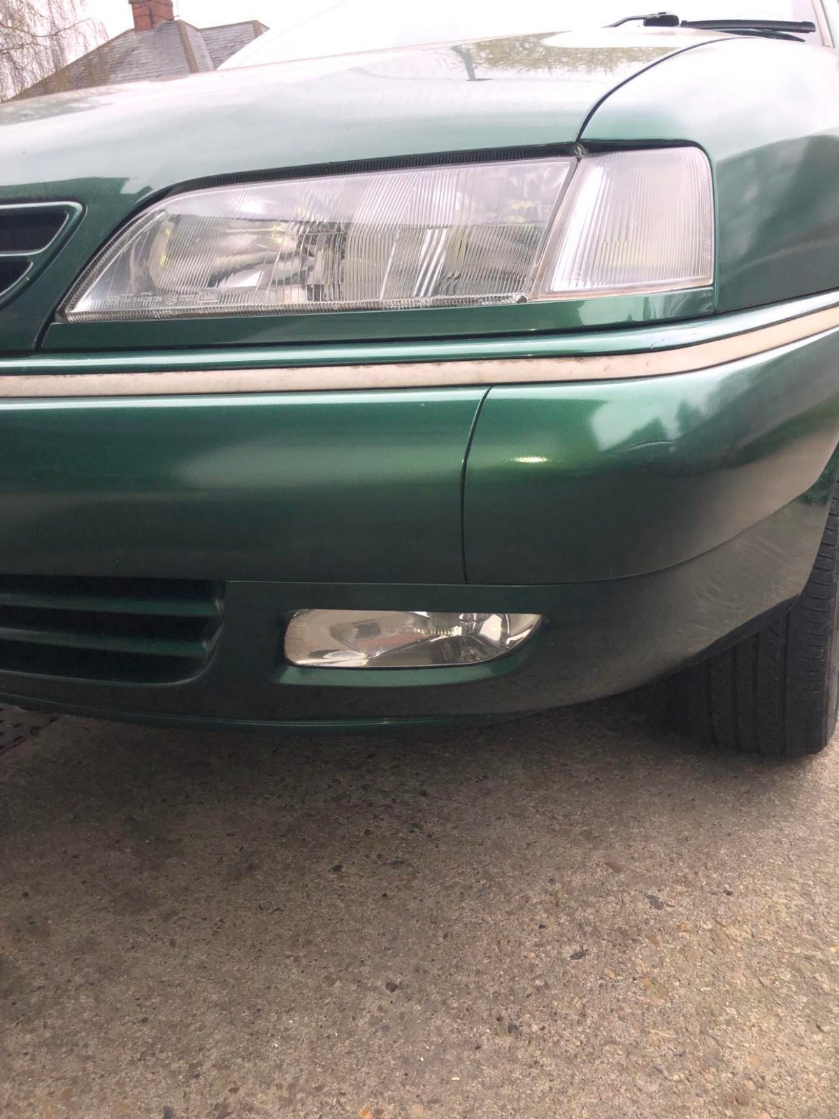

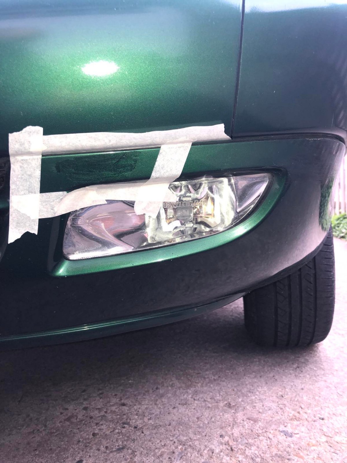

Fog light realigned and bumper 'popped' back on ... only 5 hours so far...paint needs a rub down and touch up ...TBC
Skull's - Reset Fog Light awaiting paint

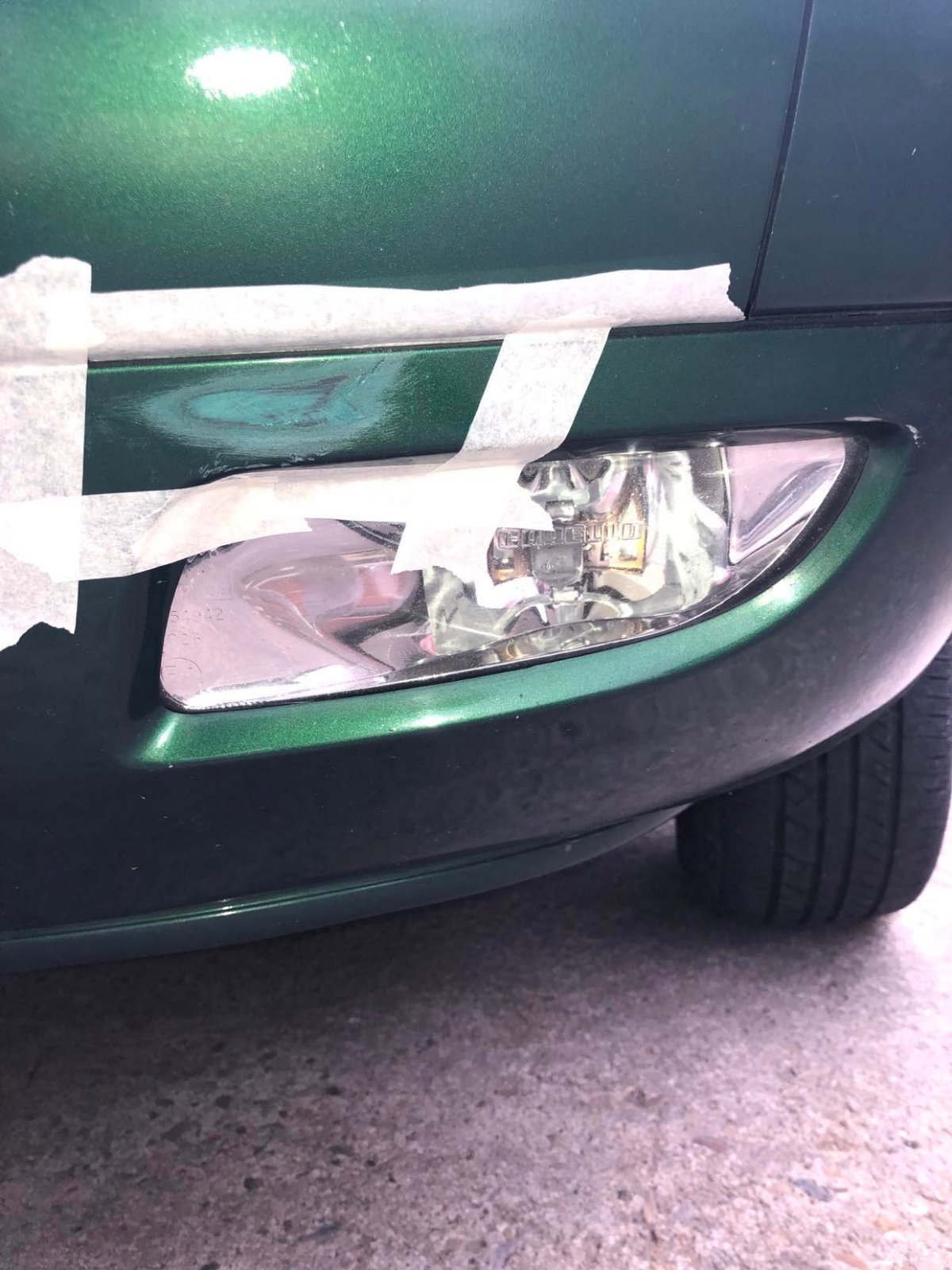

Rub down with 80 grit then 180 grit
Skull's - 80/180 rub down

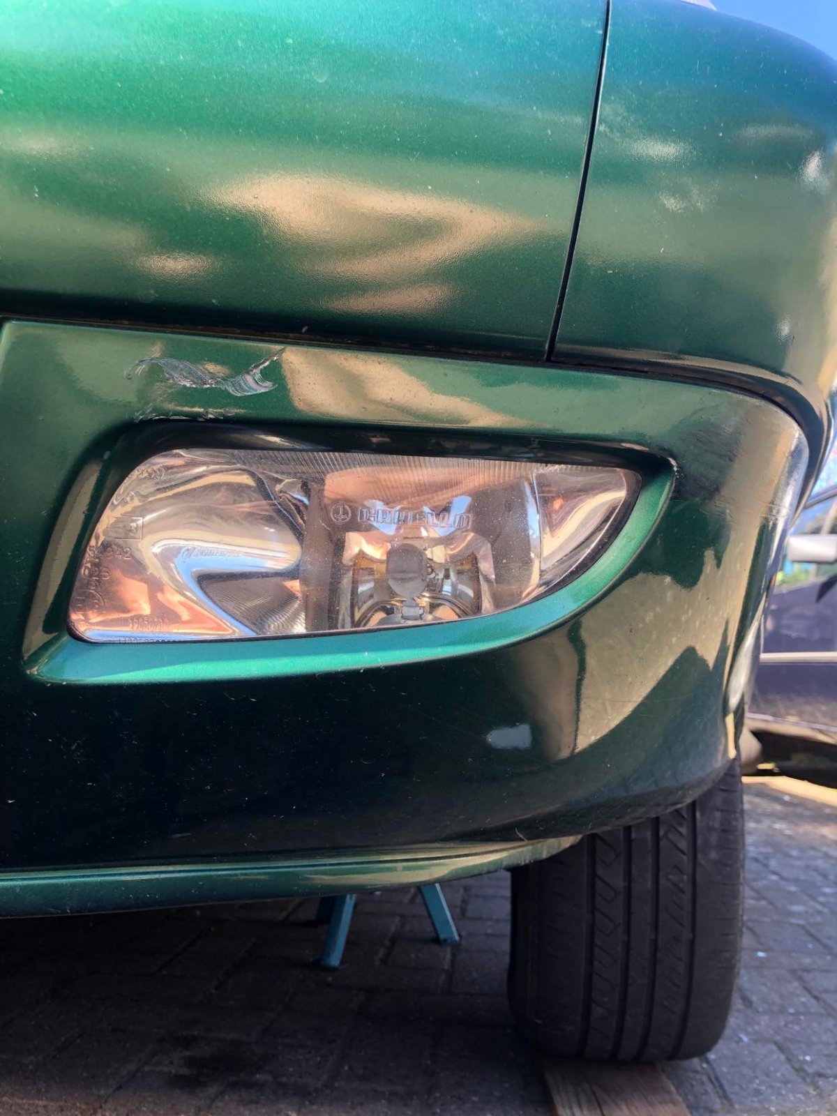

Brush touch-up
Skull's - Touch-up
Skull's - Touch-up

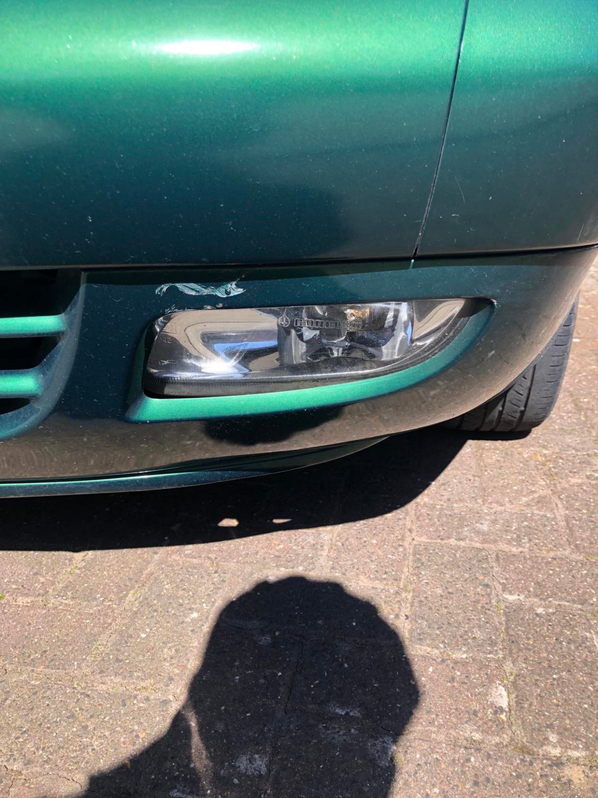

800 grit flat back between a couple of coats and I'm happy enough with that...
Skull's - Tidy enough
Nothing to see here :eye: :eye:
