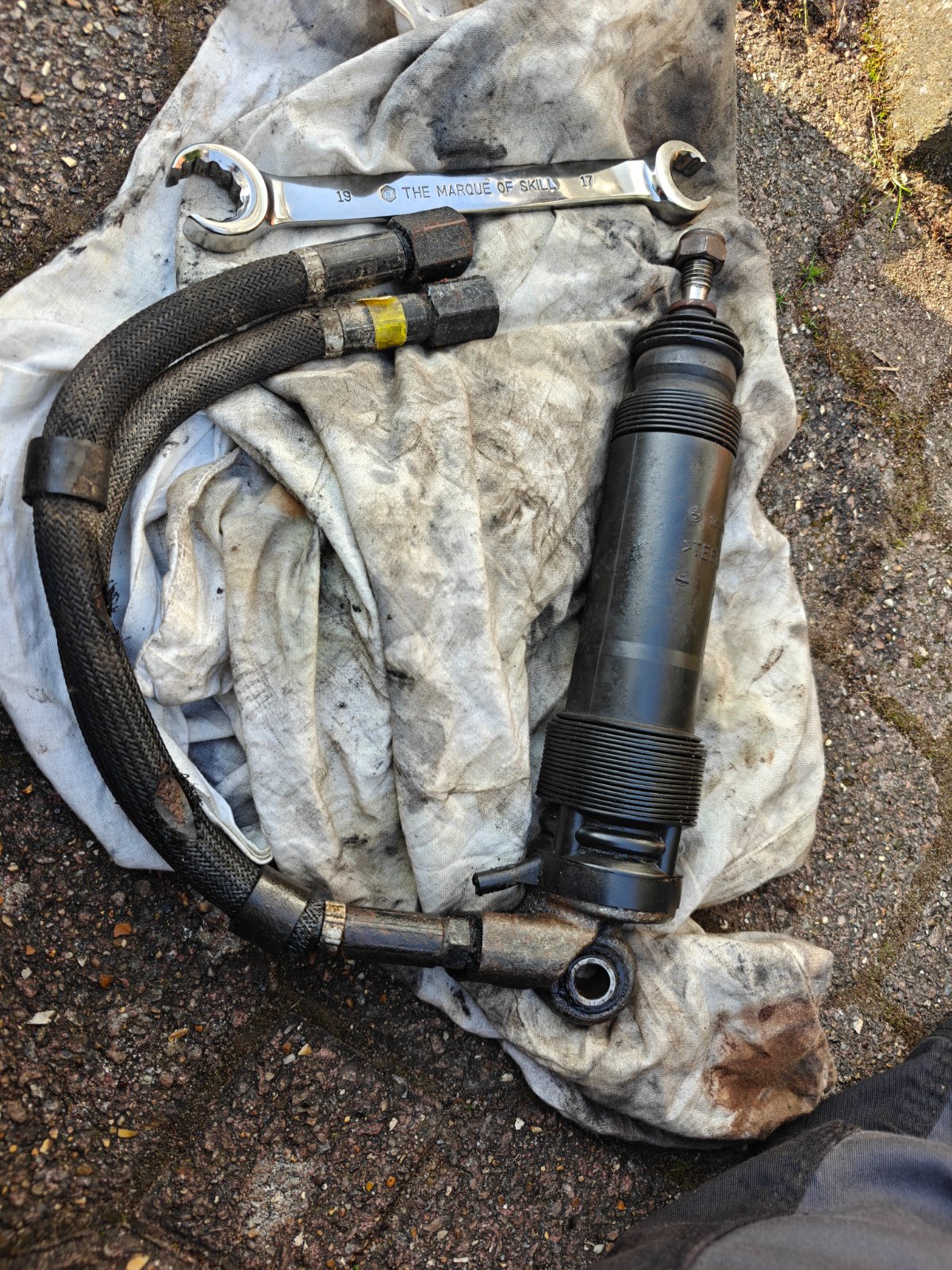

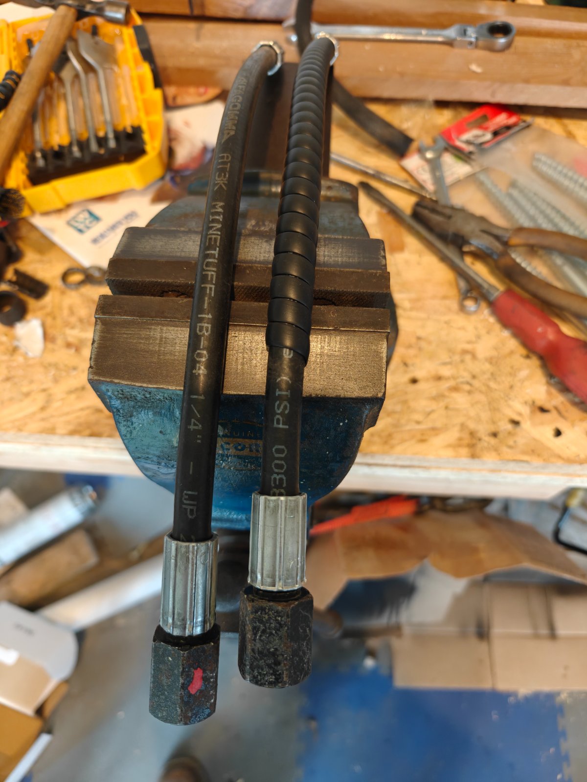

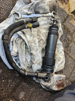

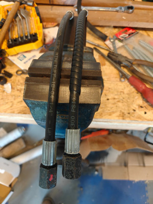

Very late update - life got very much in the way, and I didn't get round to sorting it before the wintry weather set in, so the poor thing stayed broken until a few weeks ago when I finally got round to pulling the rear ram out...
...taking the hoses off, carefully stripping the fittings off the end with a dremel...
...and taking them to a helpful hydraulic hose specialist (Nuneaton Hose and Fittings, in case anyone in the midlands ever needs such a place...). For the princely sum of £42 they cut lengths of hose of the same hydraulic spec as the original to precisely match the original lengths, and crimped the original fittings into the ends with new ferrules so they could be fitted back to the ram and the ram could be reinstalled. Perfect.
