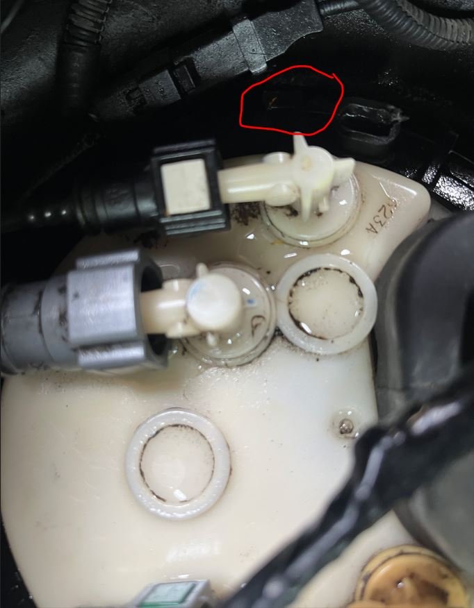

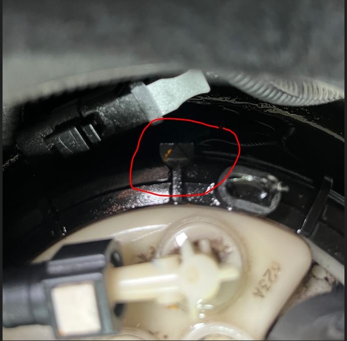

I had reason to take the locking ring off my diesel tank on the 407 estate.
When reinstalling, I noticed it had a arrow pointer but no visible marker on the tank body that I could see.
It looks about right as the ABS sensor holes are in the right spots, I can't screw it in anymore and no movement from the pump when pushed down.
Any ideas where it should point to ?

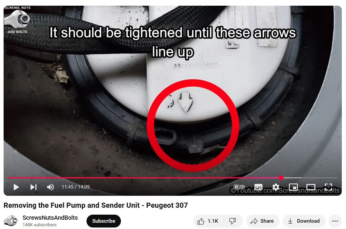

Courtesy of ScrewsNutsandBolts off Youtube
Arrows need to line up
