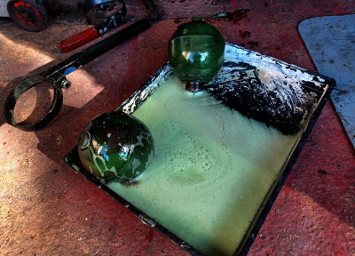

Taking stuff off and sticking stuff on .....

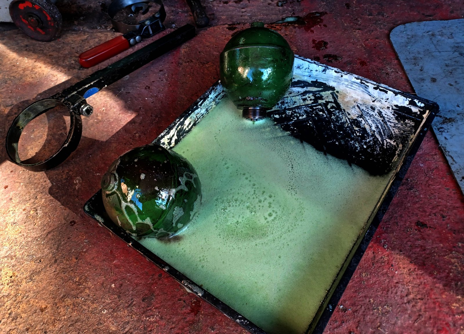

Strut spheres off so I can replace the piston concertina boots..........
Both (3 dimple type) front strut spheres test out @36bar

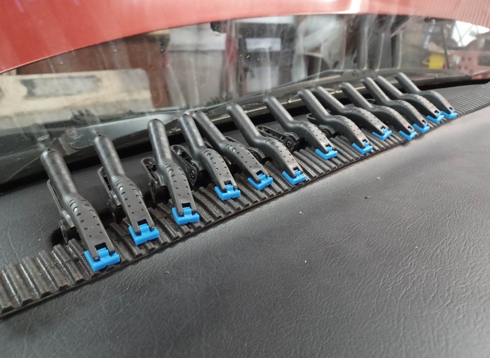

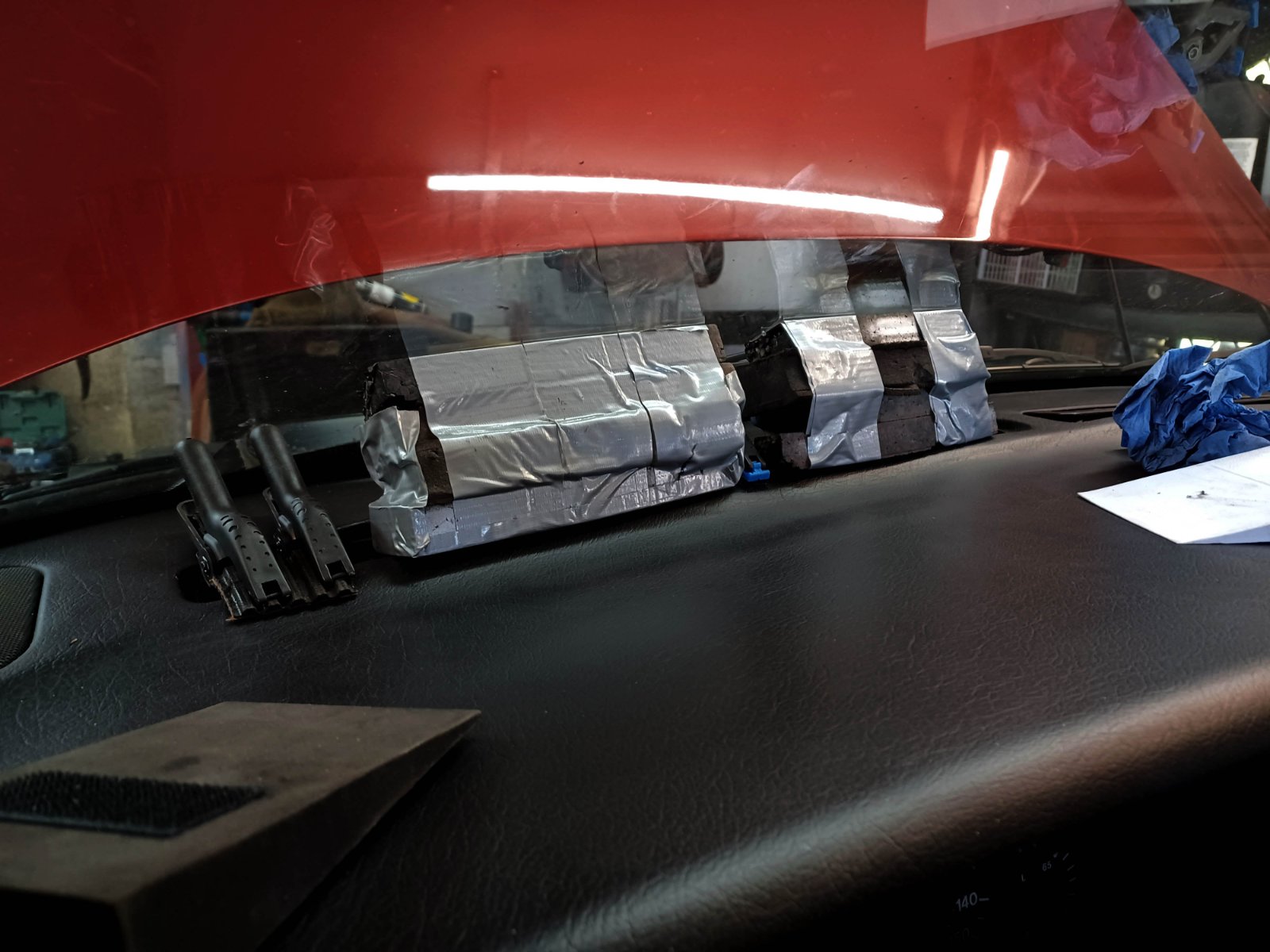

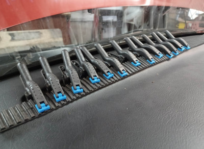

Dash demist air vents off and the delaminating bit of the dash being stuck down with 3M structural acrylic adhesive (DP8810N)
Two days clamped to "get it back into shape"
Adhesive applied, foam pad pressure
Hard foam blocks (bumper shock filling foam from an XM :) ) wrapped in gaffer tape to apply force whilst it cures, it says a few mins but I left it for 24hrs.

Re: I am an Activaist-v6 and a 2.1Estateerr
I take it your baragin basement 2-part adhesive gun did the trick ? :)
Posts: 11851
Joined: 28 Mar 2013, 21:05
x 2006
Unread post by Stickyfinger »
No, I had to mix by hand as the "Universal" mixing tips that "fit all leading adhesives cartridges"....did not fit the "leading" adhesive makers cartridges :)
x 3565
Perhaps you needed to glue the tips on to make them fit ?.... I hear 2-part adhesives are good for that 8-[ :-D

I have a FOAM party !!....rear strut spheres........
Everything is green at the moment....

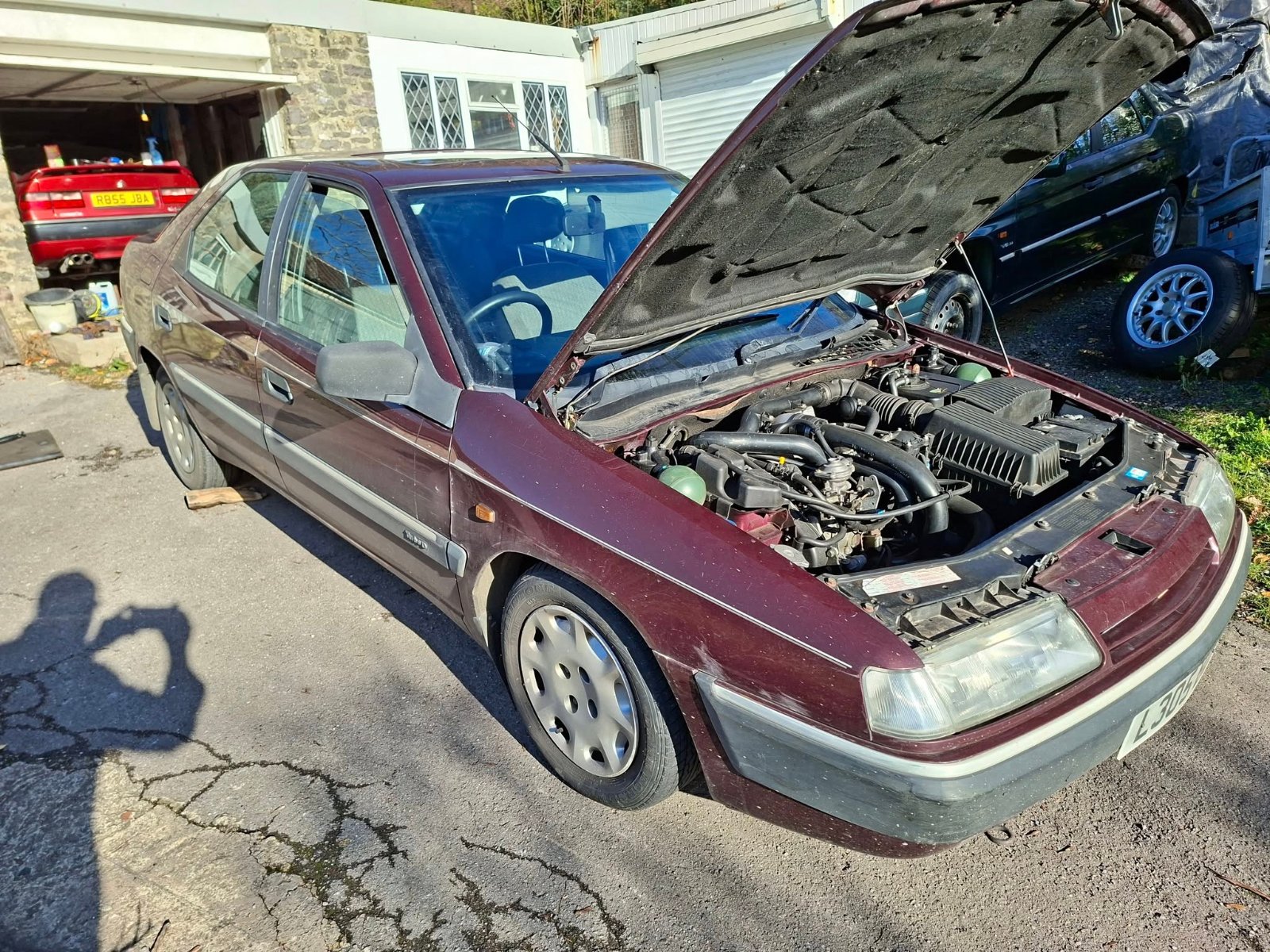

MOT pass on my Sinker hacker today.....1st year done on this old rescue....two advisories (he was kind to me :) )
Photo and assistance/Pre-MOT check credits to Jim

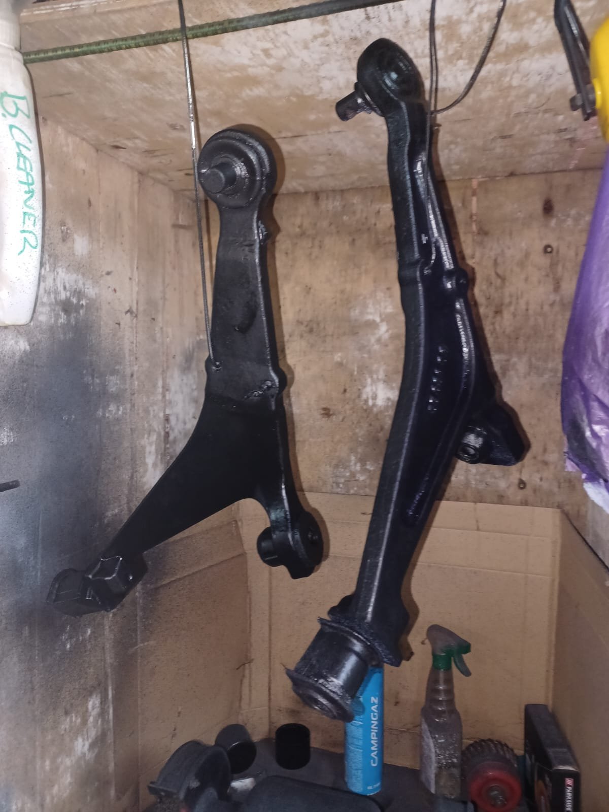

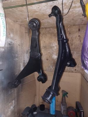

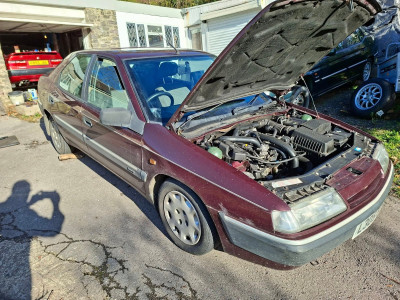

AX the white one) work started today.....
A pair of front lower arms refurbished, well painted :) as they came with good ball joint and some racer Poly-bushes already fitted.....
These were advisories on the last MOT ....as I have hardly driven Daffodil this year I am now rushing to get these done for the next MoT ....bugger !
