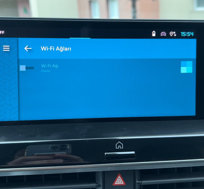

I own a C4X 1.2 130HP 2022. My problem is car Wi-Fi is not working and I can not check updates or use connected services. My dealer says they have no idea about the issue but I believe that it is not a hardware issue but software.
Is it somehow possible to activate Wi-Fi connection?
There is a Wi-Fi section in the settings but when I try to activate it it is not responding and can not activate Wi-Fi

You'll need to provide your VIN so I can see what your car has, but from the picture above, it does not look like you have switched it on - the bottom shows a slide and that needs to be switched on for WiFi

Hello Marc,
When I touch the switch-on slide goes to middle and there is an animation starts on the upper right but 1 minute later it goes off again and nothing happens. Wi-Fi is never on.

Re: C4X Wi-Fi not working
Ok, so your vehicle is not fitted with on-board WiFi, which is why you can't activate it.
In this case, you will have to tether you smart phone that has WiFi to the car. Once you have shared WiFi access from your phone to the vehicle, the car can then use your Smartphone's data connection for certain features.
Hello Marc,
Thank you so much for your answer. and the information about after-sales campaign, I will call my dealer.
What I was trying to do was using my phones mobile data so that my car can connect to my phone and so I can use my cars connected features. However this is not possible since I can not activate Wi-Fi and also there is no option for mobile data sharing in my connection settings. Only Bluetooth and Carplay can be chosen.
