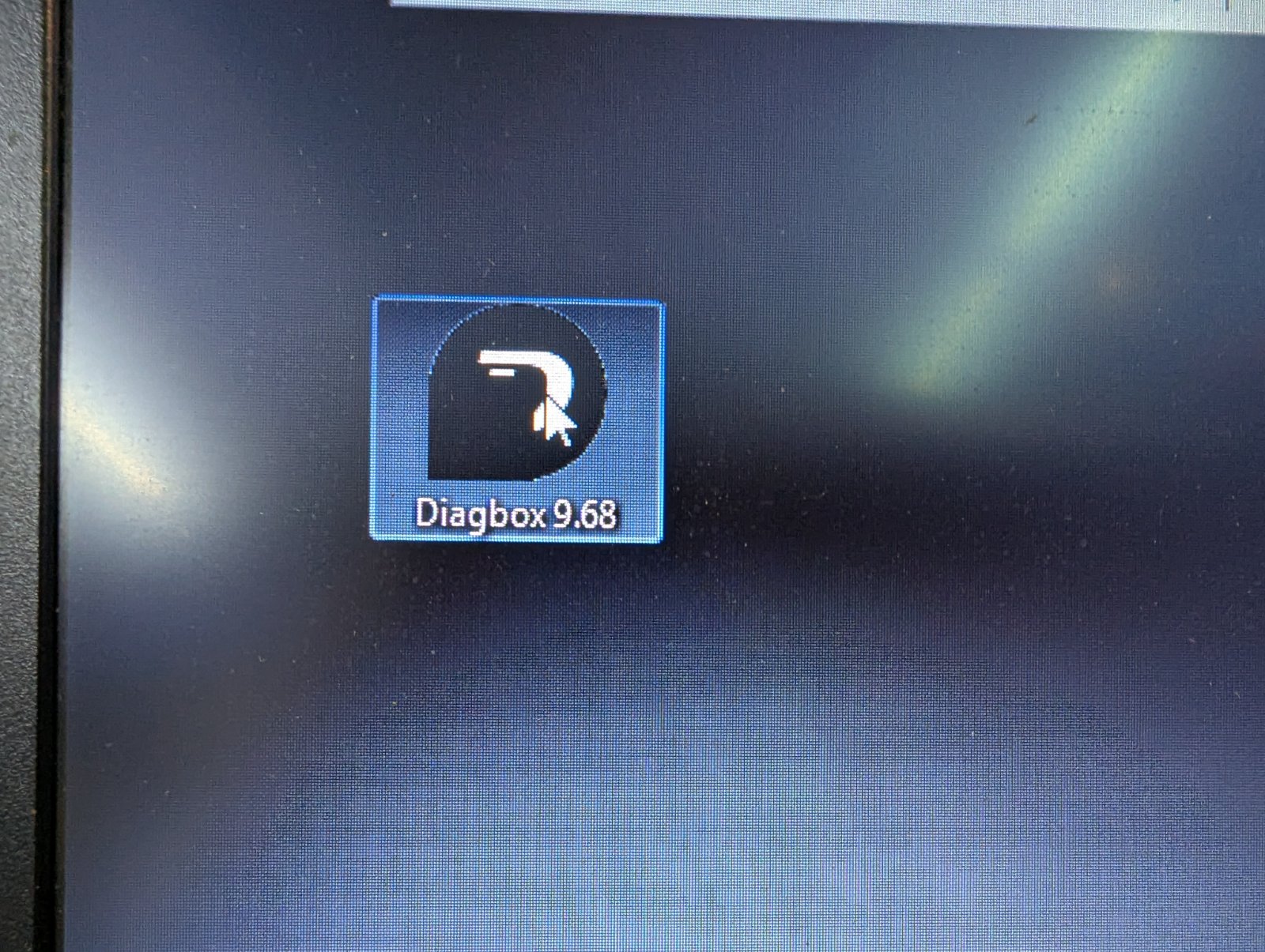

I will try to adjust the height of my CrossTourer via Diagbox, but when I try to follow instructions here in the forum (by GiveMeABreak) I struggle to find where in the menues I can find it.
¤ Can it be a problem that it says "Not recognised" for that module? I suspect this is because it is a CrossTourer?
¤ I belive I have a decent cable and software. Or is any of this obsolete and should be replaced/updated? Bought via the good offer here in this group to EasyDiagnostics.
Car is late 2014 C5 X7 CrossTourer, VIN:VF7**************[VIN obfuscated, can be read by forum staff]
