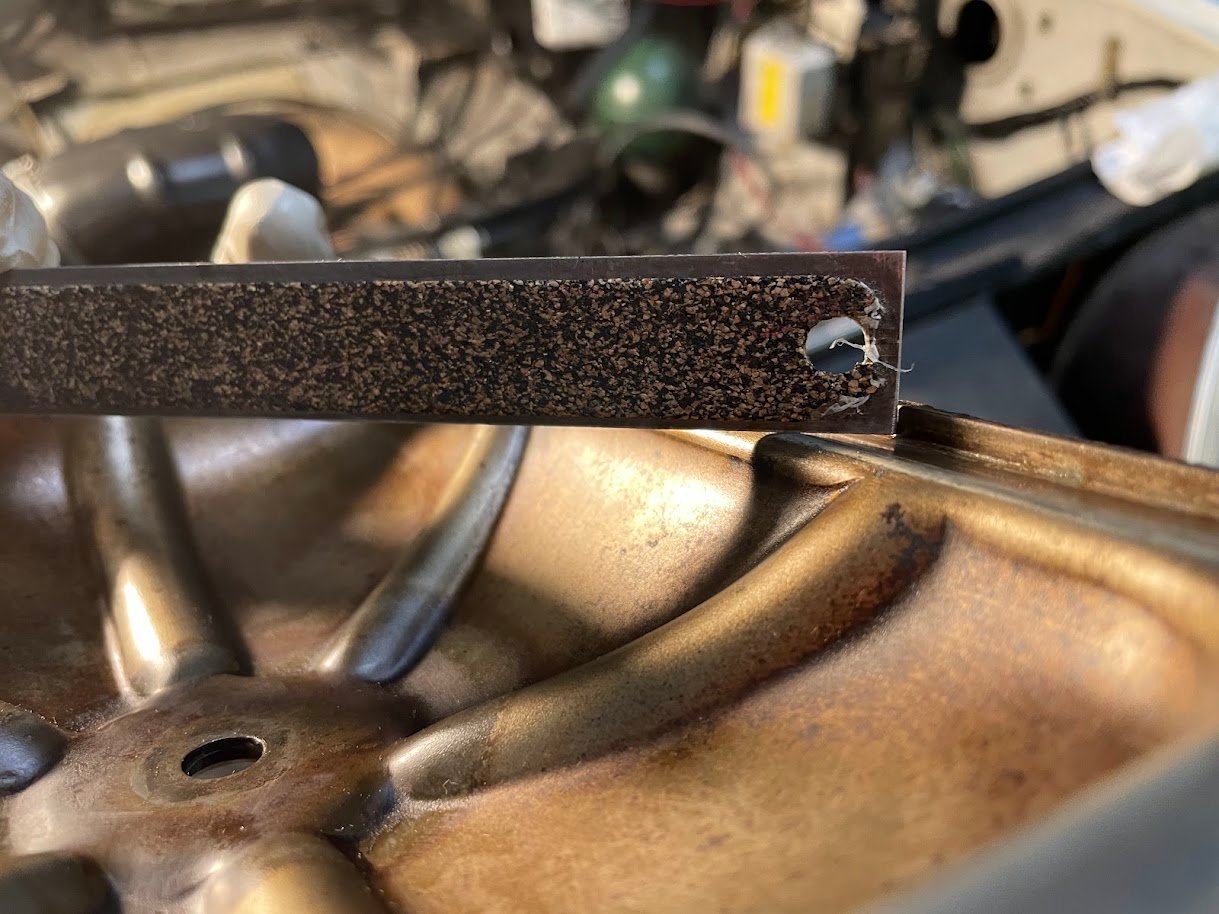

Re: Valve cover gaskets
The covers were dished in somewhat:
I measured the gap at somewhere between 0.5 and 0.7mm. I made up some thicker gaskets out of 3mm cork, stuck them on with the same compound, checked the alignment carefully. Still getting seepage from the lower edges ... confounding. Might just need new covers at this point.
Yes, that wouldn't help.
Three options;
Renew - expensive?
Fill with good quality silicon sealer to get a flatter surface for the gasket, and leave to set.
Take a hammer to the edges (gently and progressively and against a 'dolly' or anvil) to reduce/remove the distortion.
Three options;
Renew - expensive?
