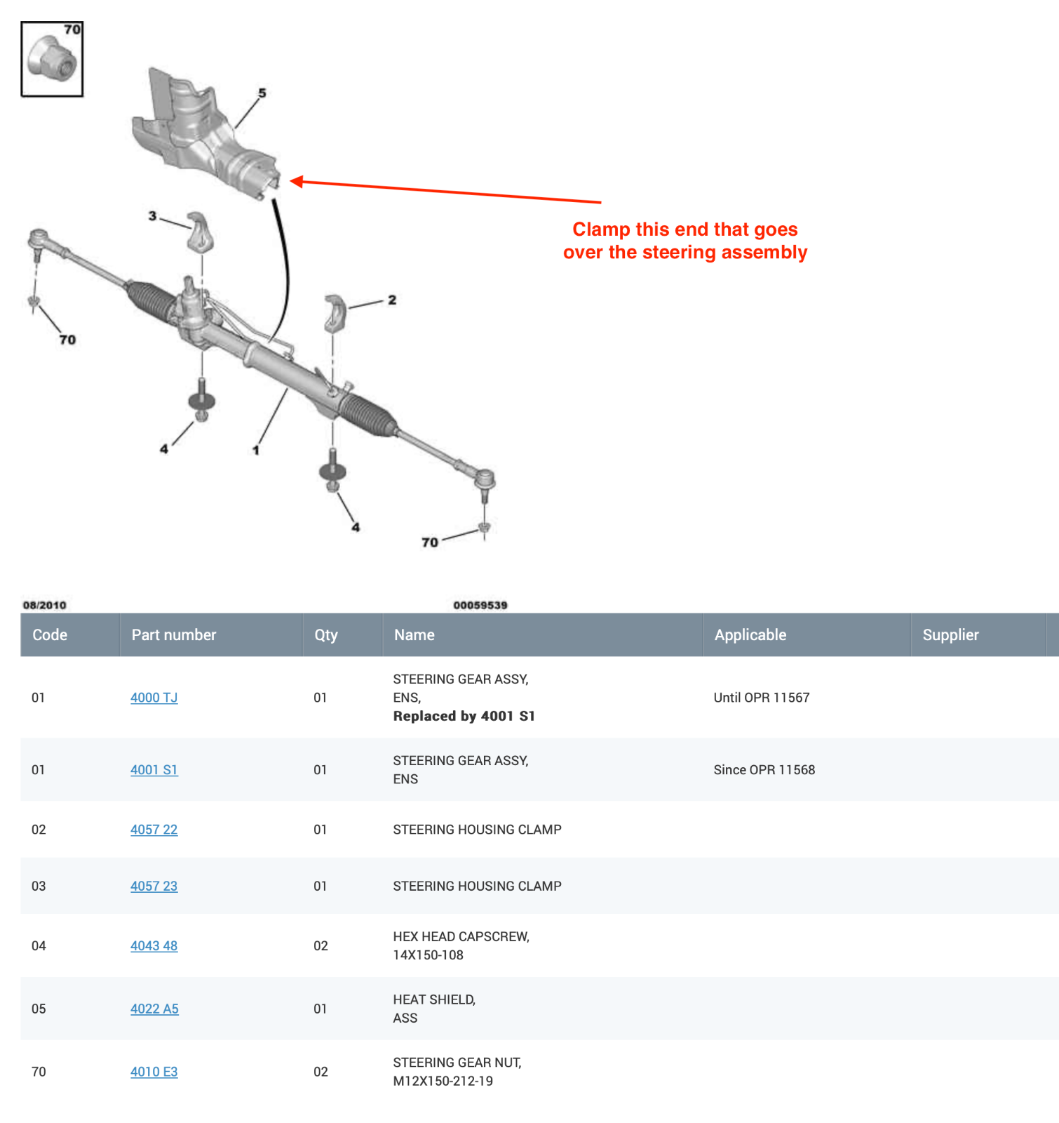

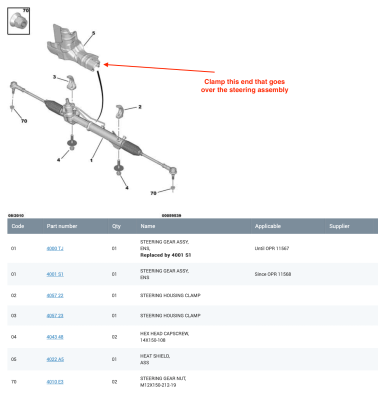

I've jacked up the front of the van and had a thorough look underneath. The only thing that seemed loose was a heat shield with a clamp that goes over the steering and then a small vertical bracket that goes over a lug on another component (not 100% sure what the component is!). I must have knocked this when replacing the anti-sway bar bushings, so I put it back on and in the right position. Unfortunately this made no difference...

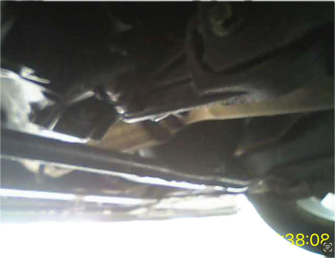

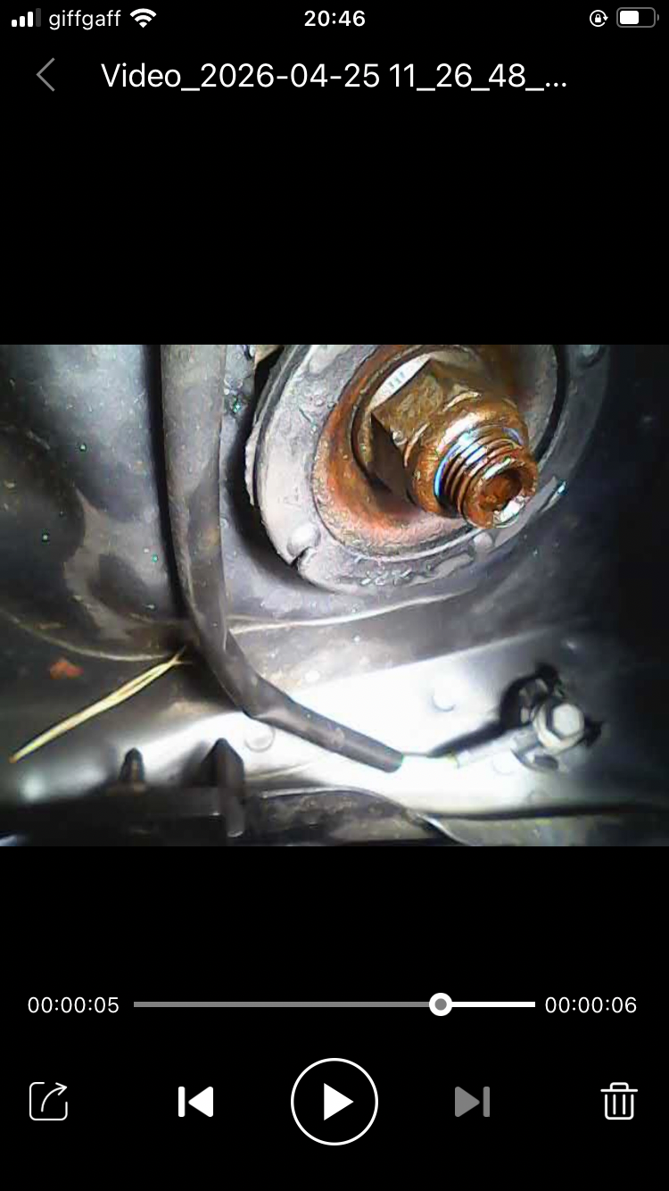

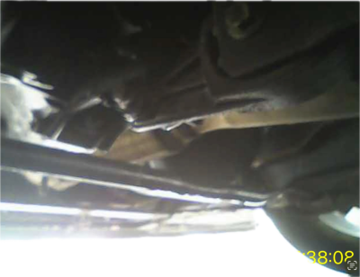

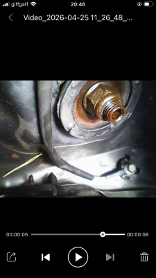

My car has passed MOT & clunking still there, tried using camera underneath while driving, had wishbone done handbrake even had camera where strut mount go & still clunking, I’ve been doing for 3 weeks and driving me insane
