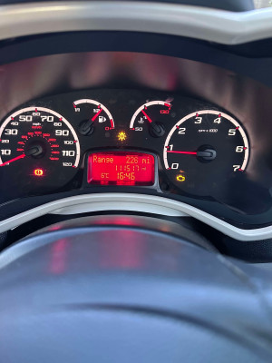

My Daughter's car has started playing up with EML showing @ 111,517 miles. No previous problems in the last 9 years.

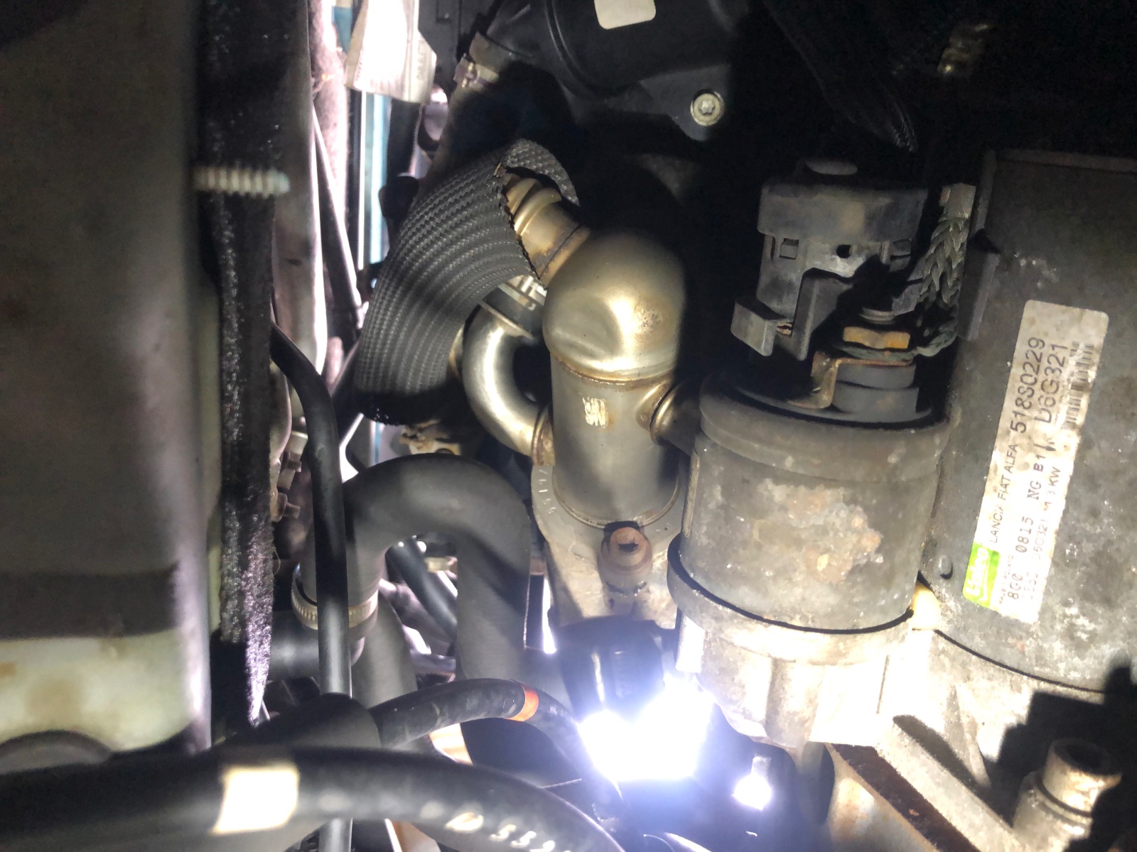

So far i've stripped out battery/tray/ECU and 3 T20 bolts on the end of the ERG solenoid but it wouldn't separate, a look at access to remove the EGR completely for cleaning reveals horrendous access that prompted me to re-assemble :rofl2:

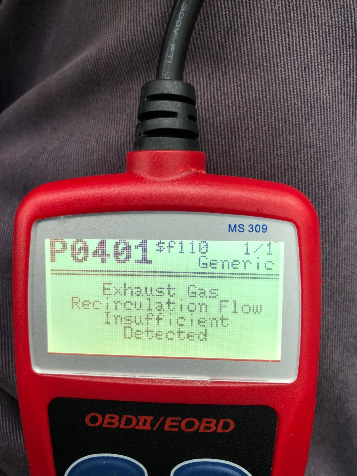

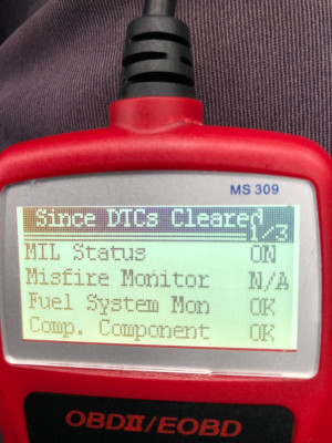

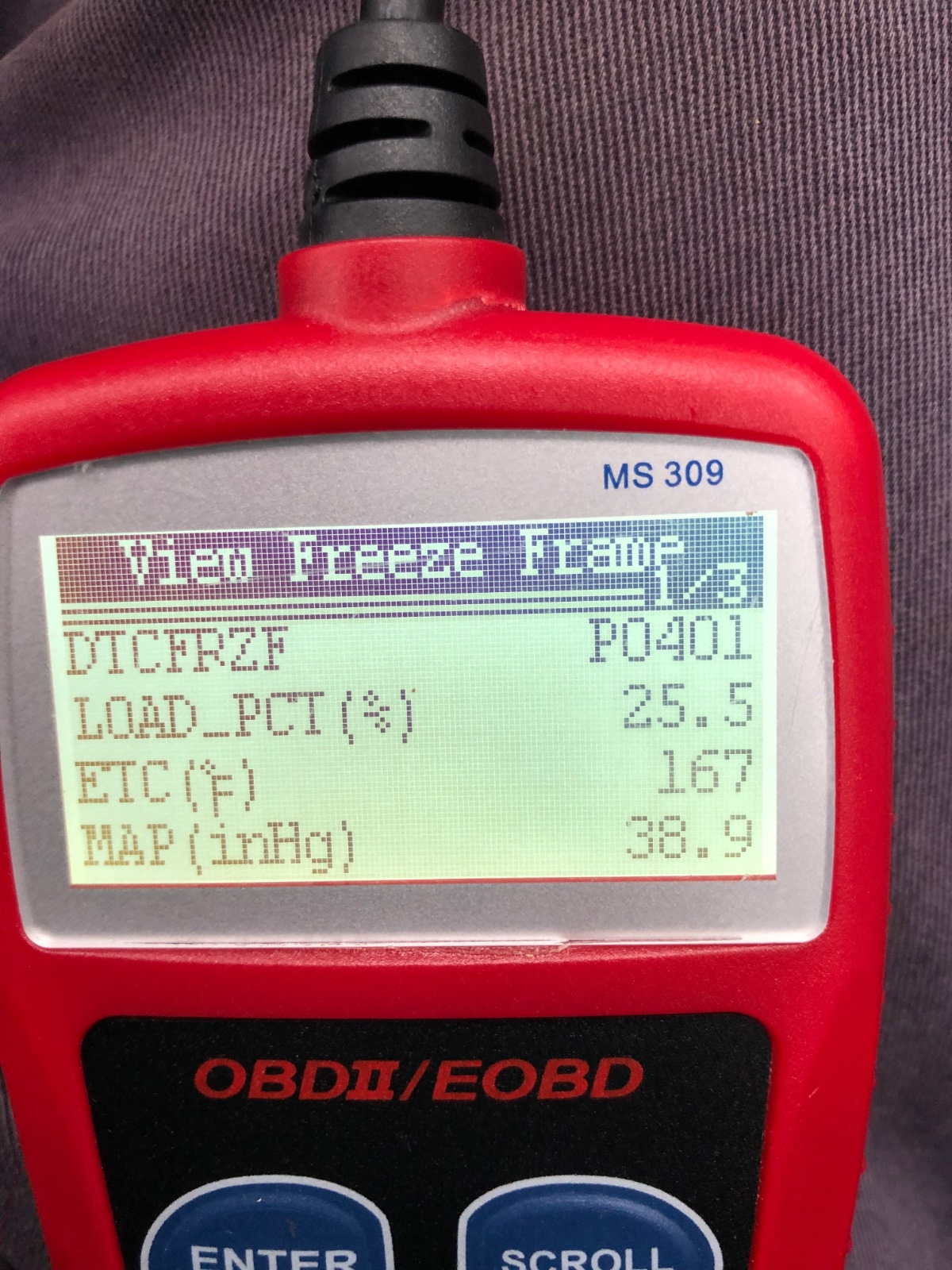

I borrowed a code reader and P0401 appears:
Skull’s Code Reader
Skull’s Code Reader
I cleared the codes @ 111,545 miles and gave it a hard drive, with instructions to do likewise, that was about 50 miles ago but a text message tonight - the light has returned.
A search of the internet resulted in no guides to removing the EGR - the most similar I found was a 2005 Fiat Panda on youtube.

I'm reluctant to try the aerosol cleaner method in the air inlet because the distance/route between an access point and the EGR area is too extended.

Can you get live data on the scanner? Might give a pointer as to whether it is the DPF sensor, or blockage in the EGR pipe. Probably not an EGR fault, as I would expect this to flag a position fault on the EGR valve.

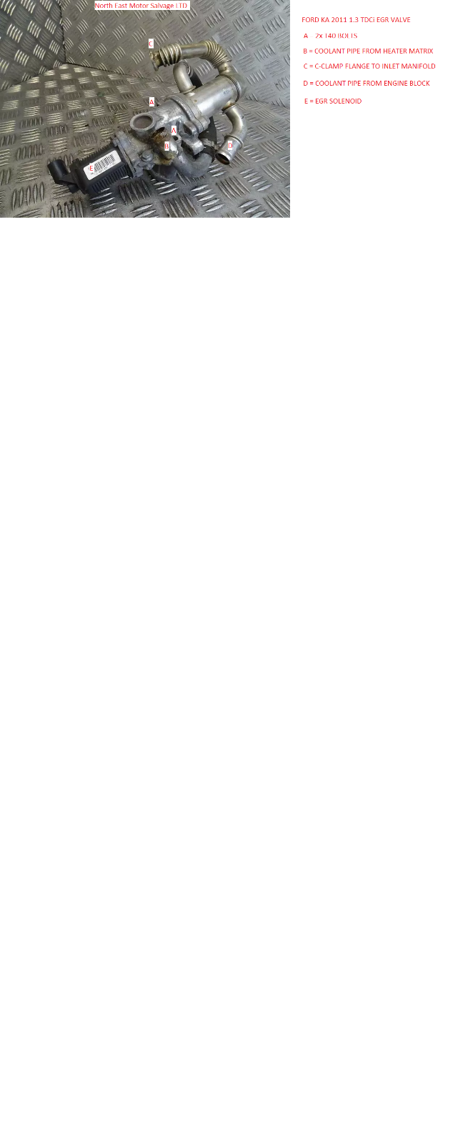

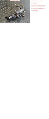

FOR REFERENCE
North East Motor Salvage LTD

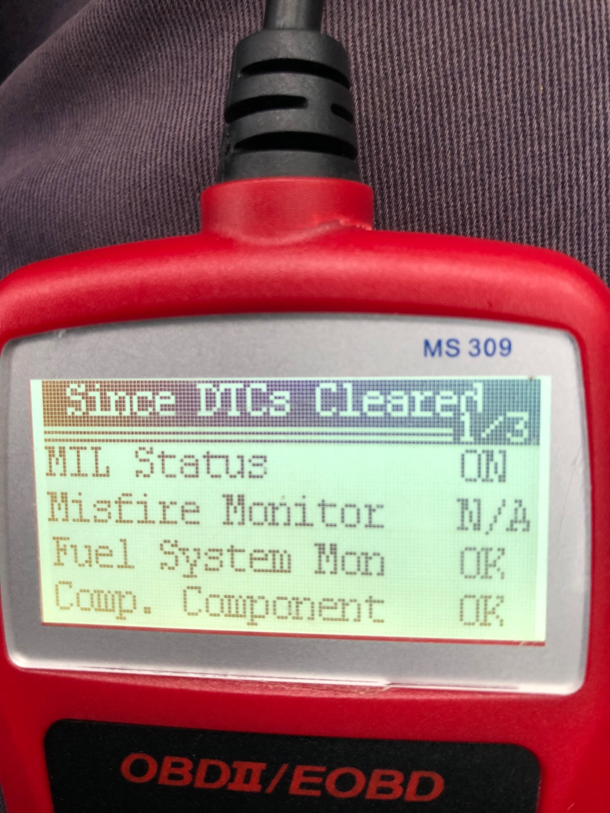

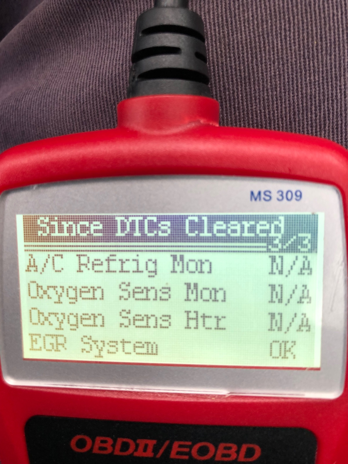

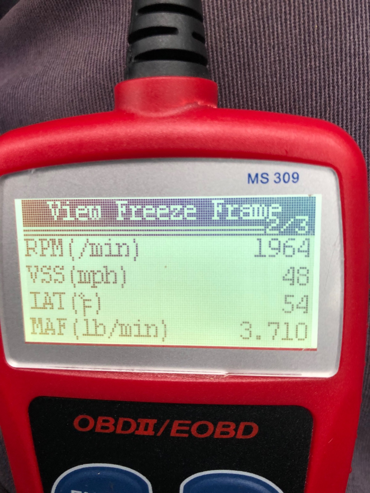

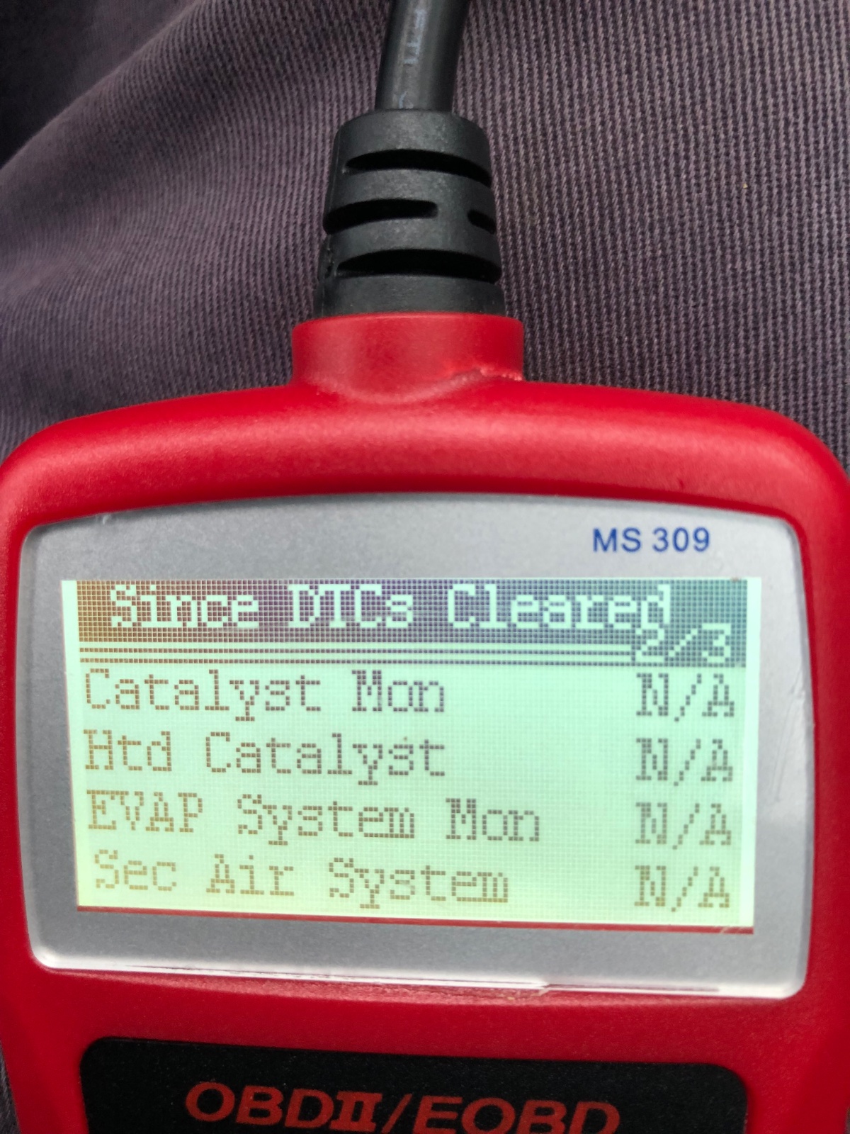

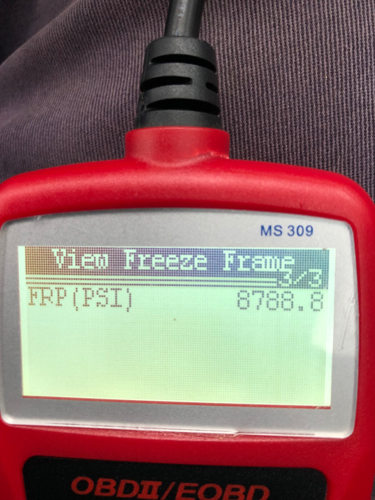

RichardW wrote: 21 Feb 2025, 11:10 Can you get live data on the scanner?
I have some photos of screenshots but don't have regular access to the car - just when it needs fixing :roll:
It's my first time using a code reader so I don't understand much ...
Codes
Codes
Codes
Codes
Codes
Codes
After I cleared codes ….
Code cleared
Code cleared
Note : MIL was off , on engine restart despite the reading …for about 50 miles
Code cleared
Code cleared
Code cleared
Code cleared
If they are any help RichardW?
