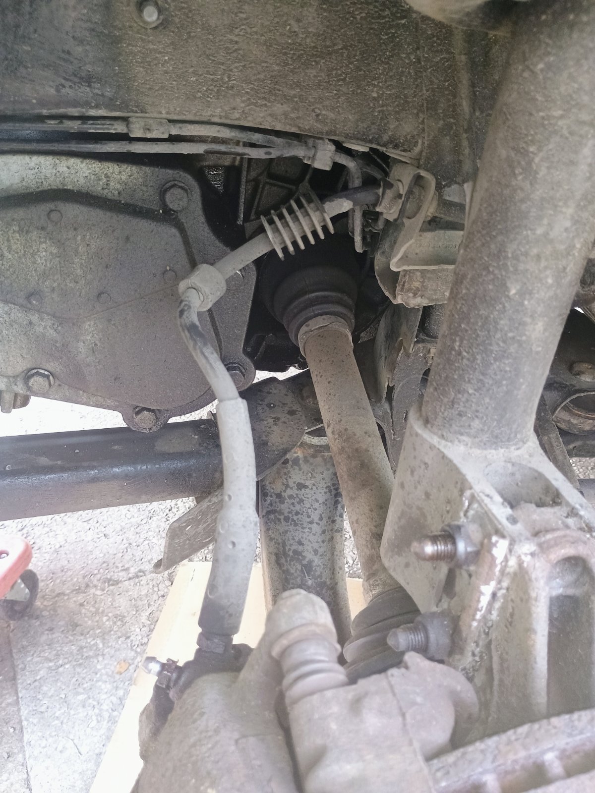

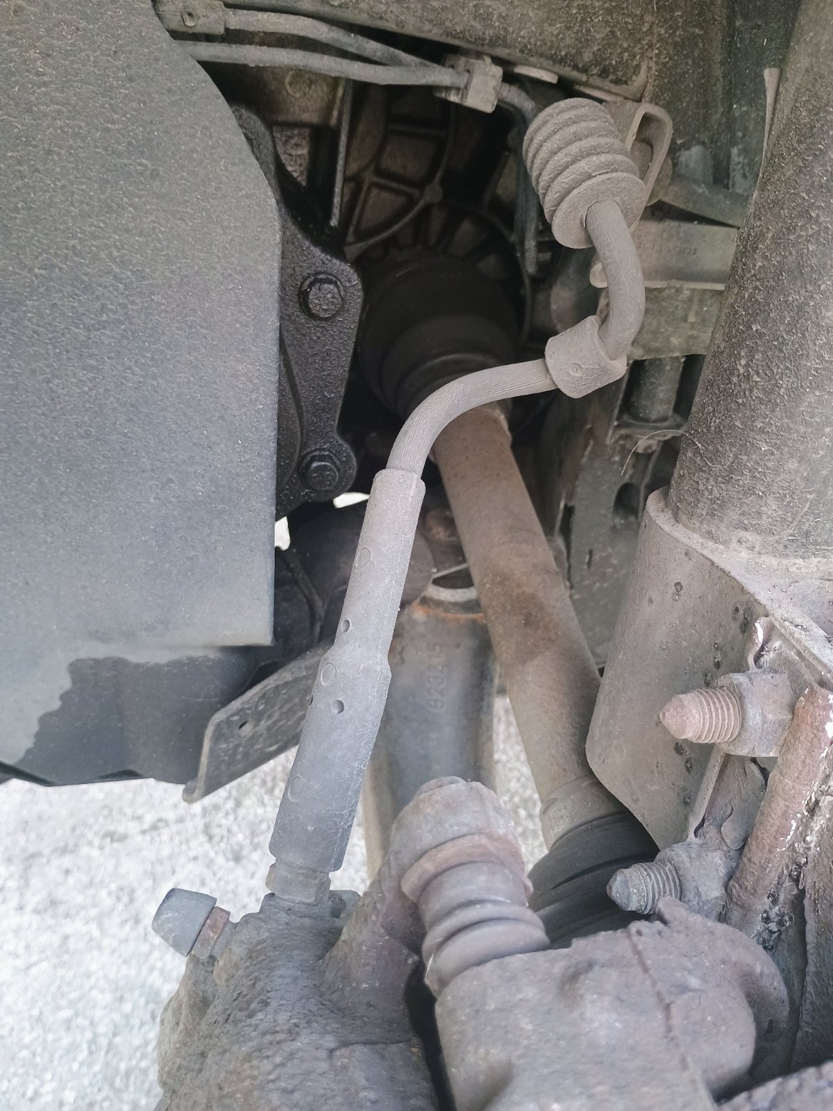

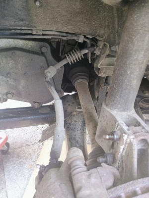

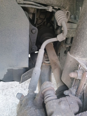

Grey 308 had MOT advisory for slightly twisted brake hose front left
Twisted
Twisted
Untwisted
Untwisted
Hose connection loosened at the bodywork end. Twist removed. Retightened.

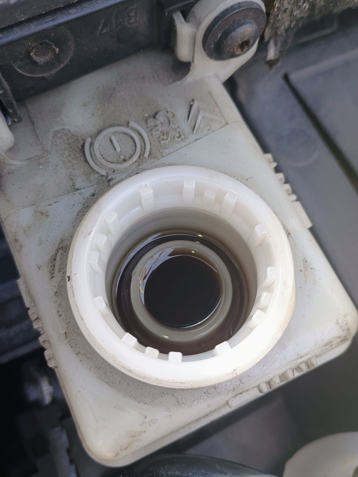

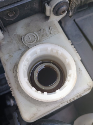

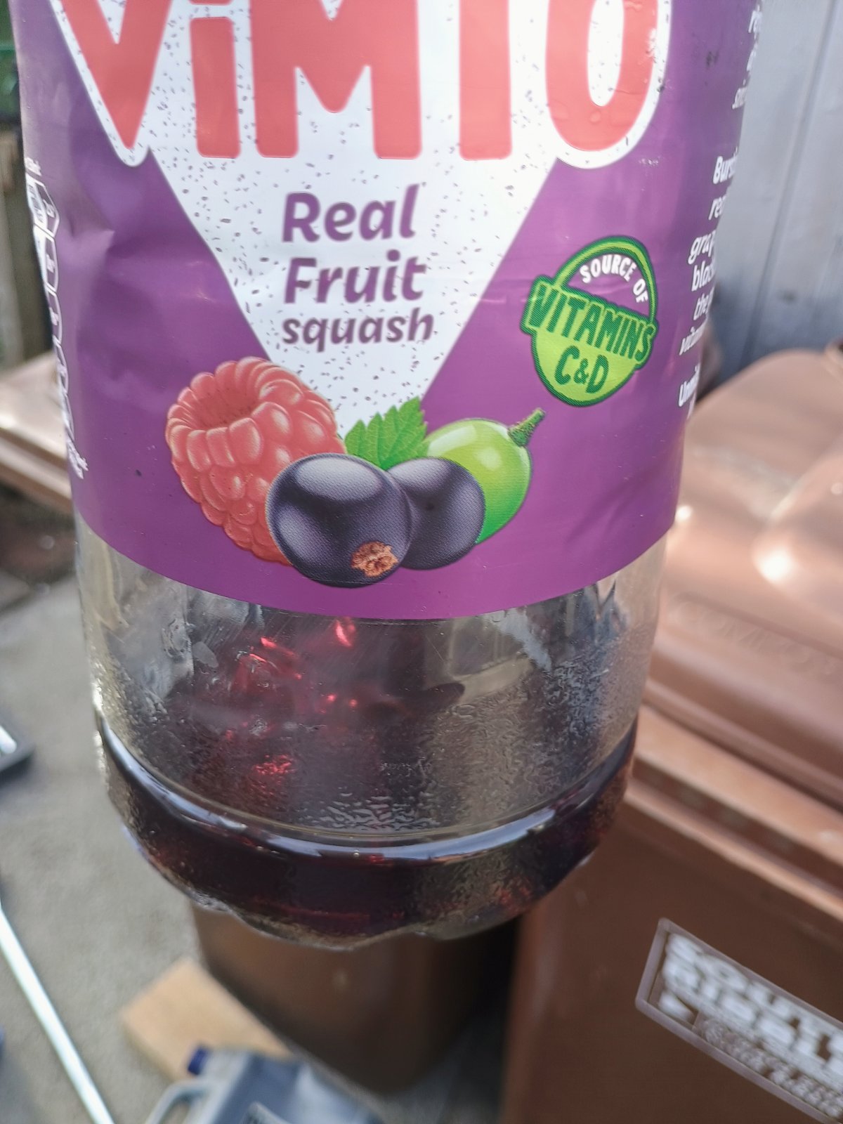

Decided to push a good squirt of new brake fluid through and I'm glad I did that's what came out was filthy black!
Contents of the reservoir before starting
Countrary to the labeling this is not Vimto!
Old brake fluid
Old brake fluid

Unread post by RichardW »
That's an interesting colour for brake fluid!!

RichardW wrote: 08 Mar 2025, 14:27 That's an interesting colour for brake fluid!!
Isn't it just!!!?!
Posts: 21244
x 8128
I reckon you could bottle that and sell it as a vintage burgundy to a wine buff who will never open it!! :-D

Unread post by MattBLancs »
mickthemaverick wrote: 08 Mar 2025, 14:37 I reckon you could bottle that and sell it as a vintage burgundy to a wine buff who will never open it!! :-D
Not much market for knock off Vimto then?

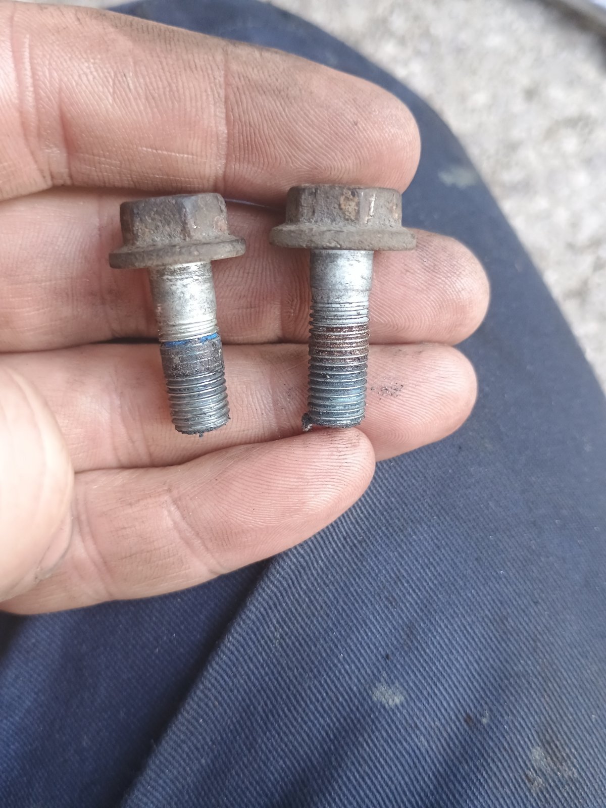

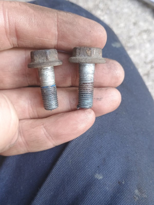

Brake caliper bolts: top one is 13 mm, bottom one is 12 mm head. Supposed to have loctite but nope it's copper grease instead.
Why does finding out how the car has been worked on in the past generally not fill me with confidence!?

MattBLancs wrote: 08 Mar 2025, 15:06
No fizz, you'd be sussed out!! :-D

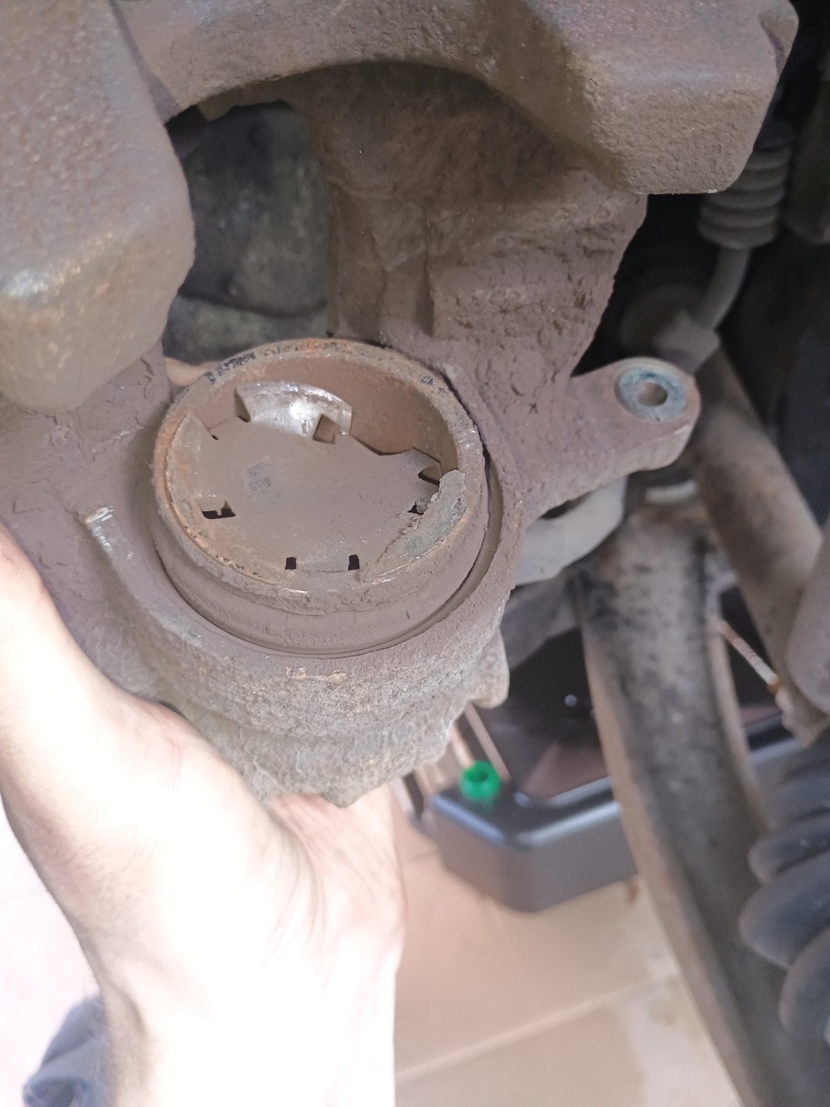

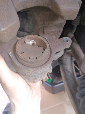

I guess this being in the right place is optional too!

mickthemaverick wrote: 08 Mar 2025, 15:15
I was targeting the cordial market, Mick! :rofl2:

Is that a shim plate that should be between the pad and the caliper? :)

That brake fluid was definitely better out than in Matt!
