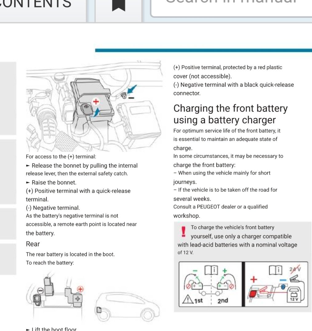

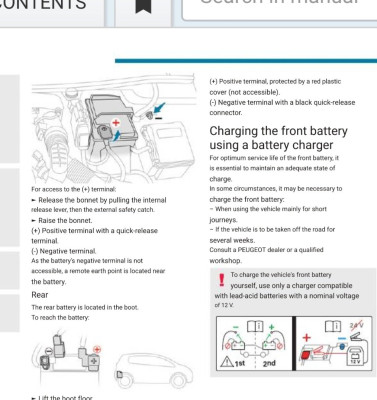

I may be wrong as I am new to the Hybrid drive train. However, if your car is like most other hybrids, you will have, a traction battery, a 12 volt battery in the engine bay and an auxiliary battery whose location varies depending design, for example,
  • Citroën C5X it's under the centre arm rest.
and I think
  • Citroën C5 Aircross is in the boot behind the trim.
  • DS4 is also under the armrest.
  • According to the 508 owners manual yours is located in the boot, under the floor (page 200)
These batteries are small, expensive and seem to cause a lot of Hybrid issues when they are getting 'tired'
