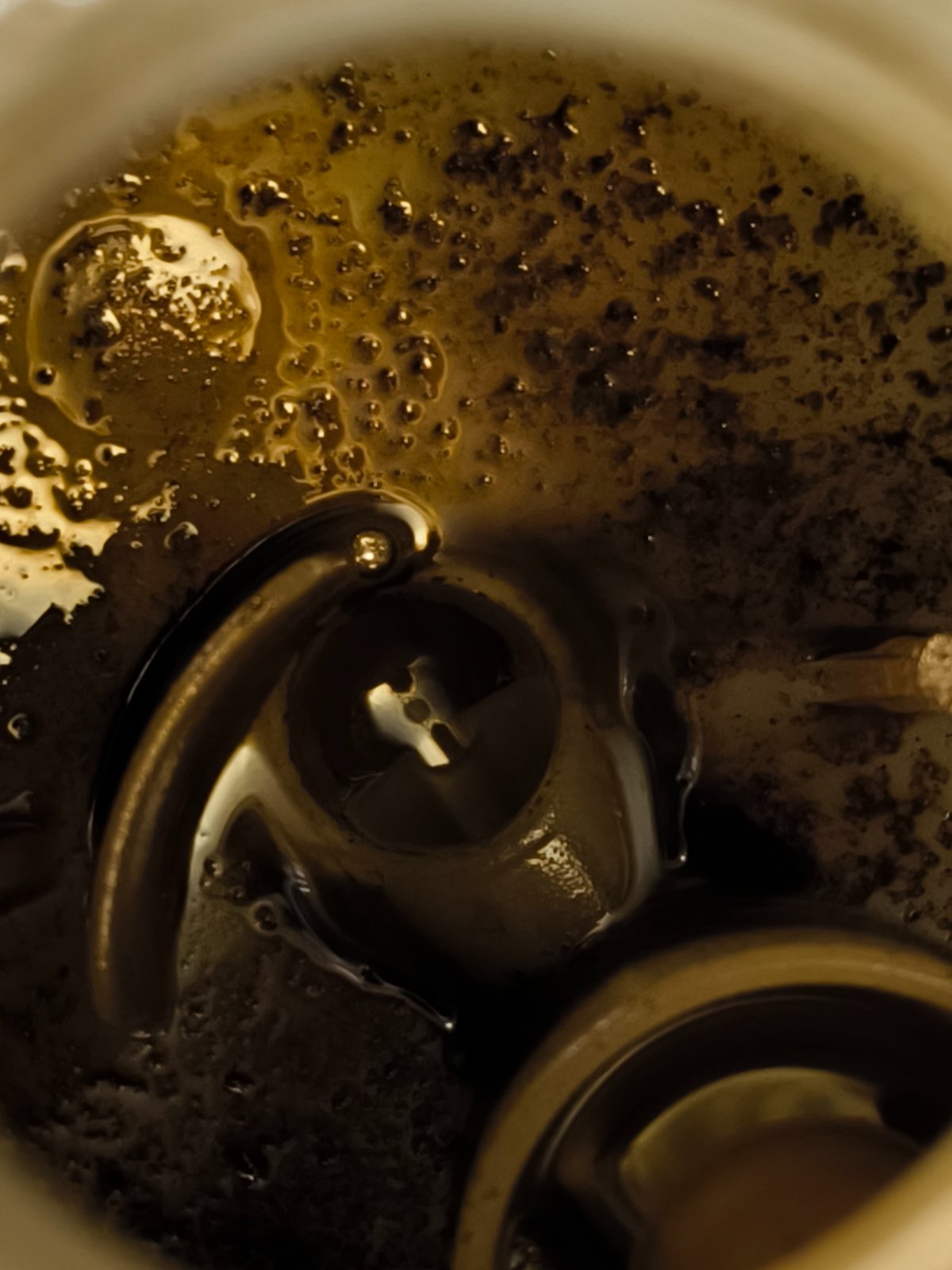

I just drained the coolant....I'll say it's the color I have lds in a citroen c5 x7. There's crap in the reservoir, I'm attaching a photo.

That doesn't look encouraging. I'd say that a good flush is well overdue.

Those grains are a tell tail sign of "Leak Sealant" having been used. That stuff (such as K_Seal etc) is well known for blocking heater cores & Oil-2-water coolers/Gearbox coolers.
