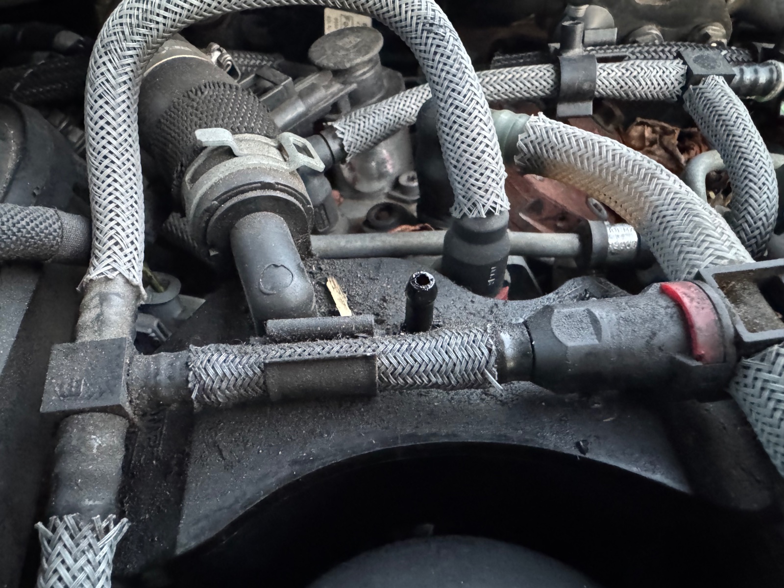

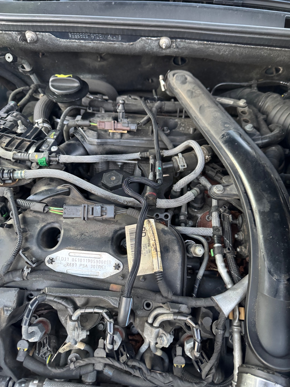

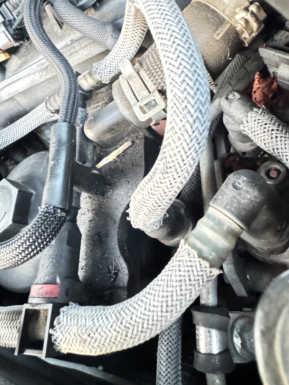

Looked at my cam cover breather on my 3.0 V6 today and it broke where it goes into the T-Piece (both sides).
It's because the plastic pipes have gone brittle.
With the aid of a pick, I managed to clear out the broken/brittle crap inside the T-Piece and then chop them back and force them back into the T piece as a short term fix, but that won't last.
I don't want to cobble together a repair with some generic hose that won't look right, they're easy enough to replace and not horrendous money (especially if buying the pattern part for half the price - though I wouldn't do that):
https://maltings4x4store.co.uk/inlet-ma ... C_-SsehmCy
But it seems to me this must be a common problem and they will go again?
Does anyone know if there's an 'upgrade'/mod available for them?

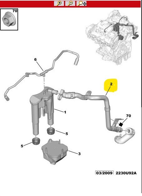

PSA part number is 118053 - and just to show how entirely arbitrary and utterly ridiculous/appalling PSA parts supply is... It is NO LONGER AVAILABLE from Stellantis; despite still being a current manufactured part available new, OEM, to Land Rover/Jaguar for approx £50 and after market options available from approx. £19.
I've ordered a Land Rover OEM part (which is of course FoMoCo branded!).
Item 6 in the PSA OEM parts diagram below (Stellantis west london emailed me the image when looking it up earlier).

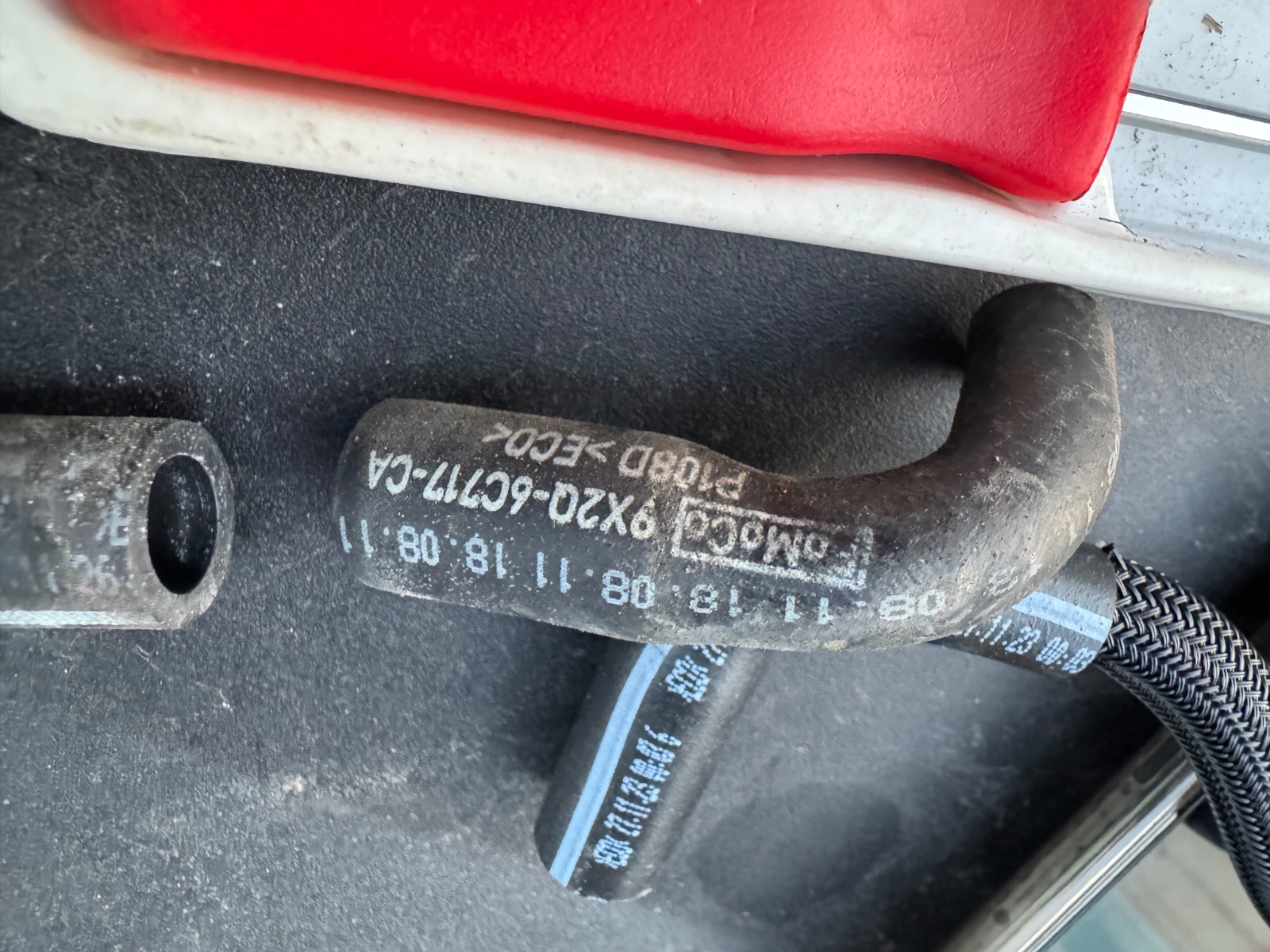

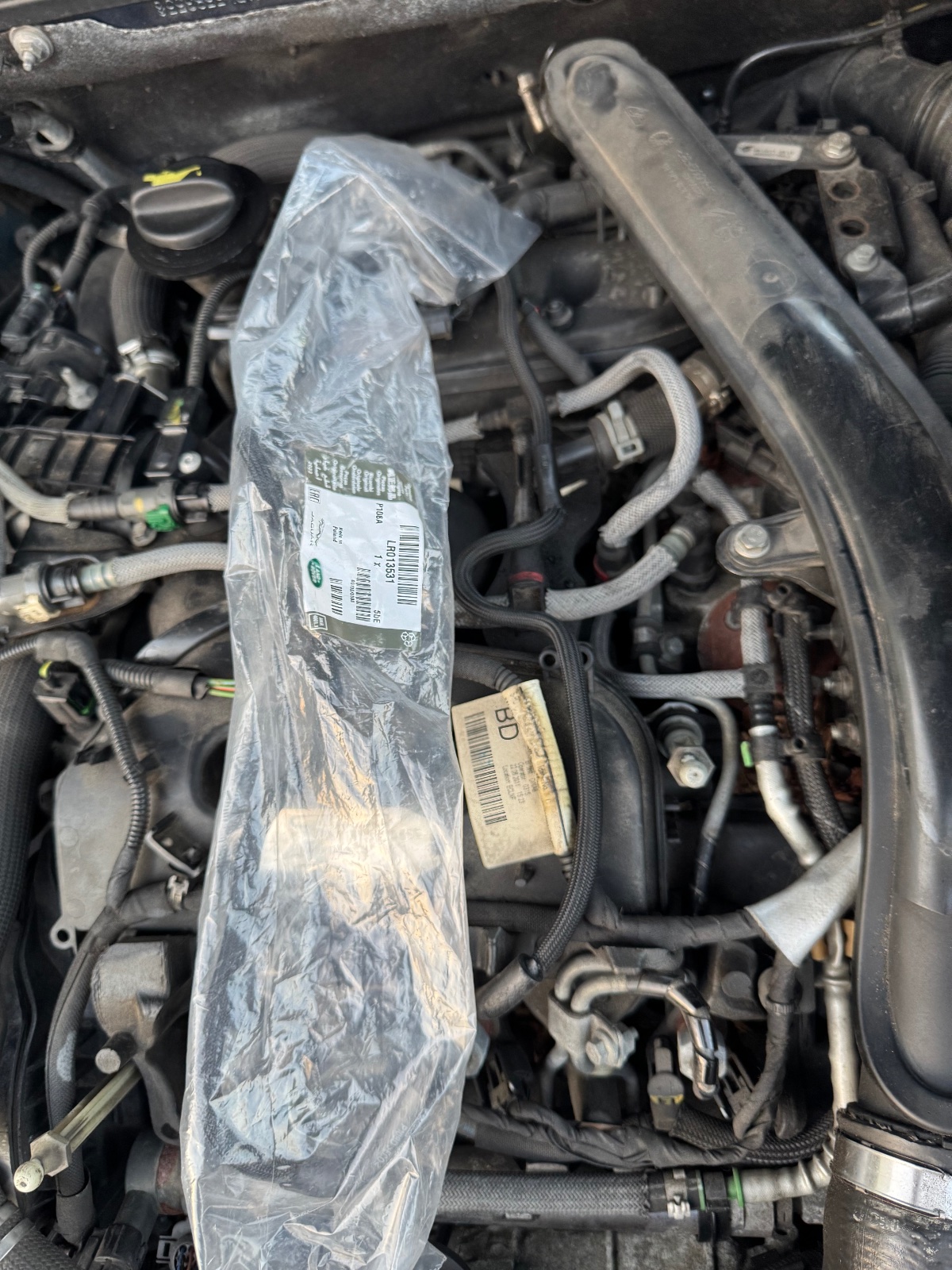

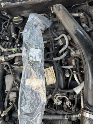

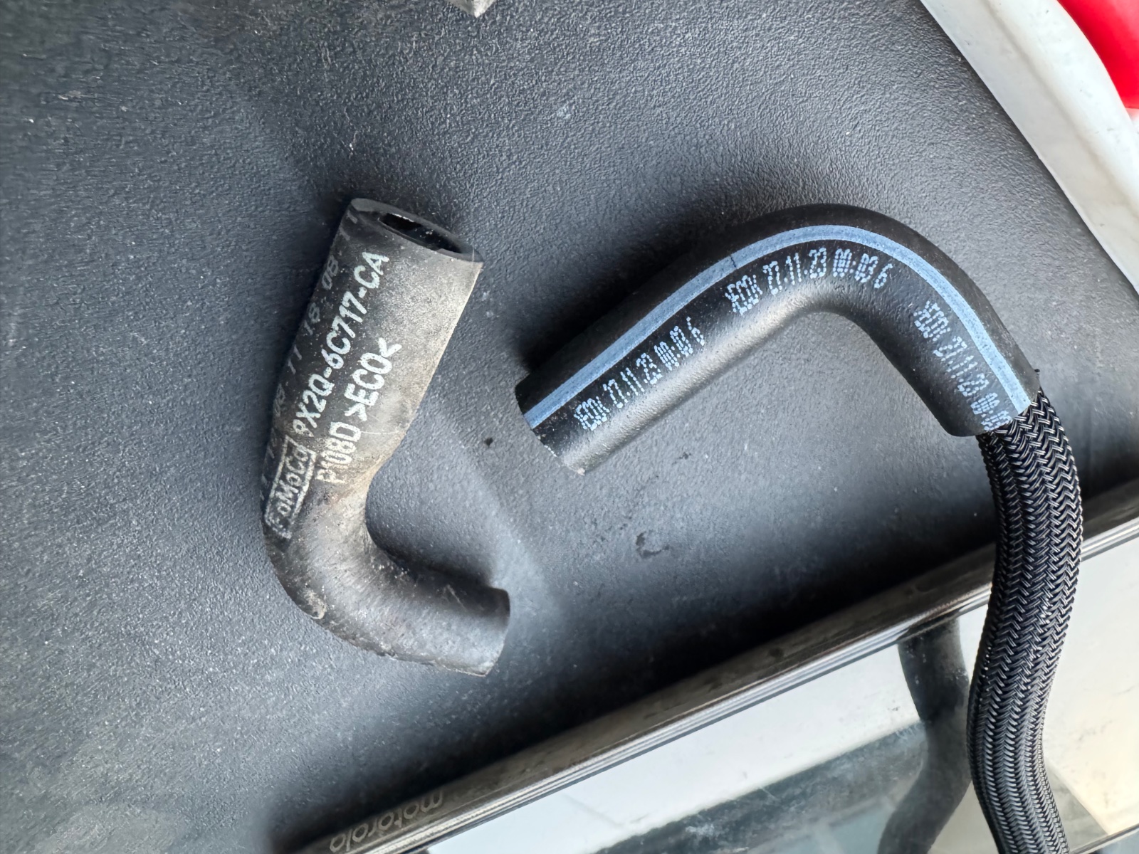

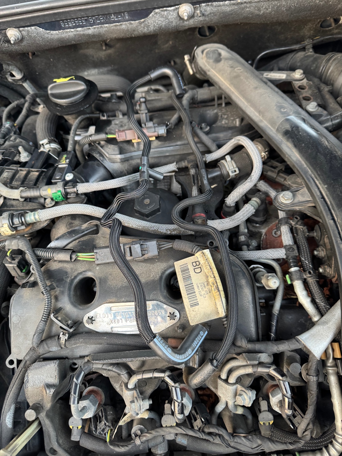

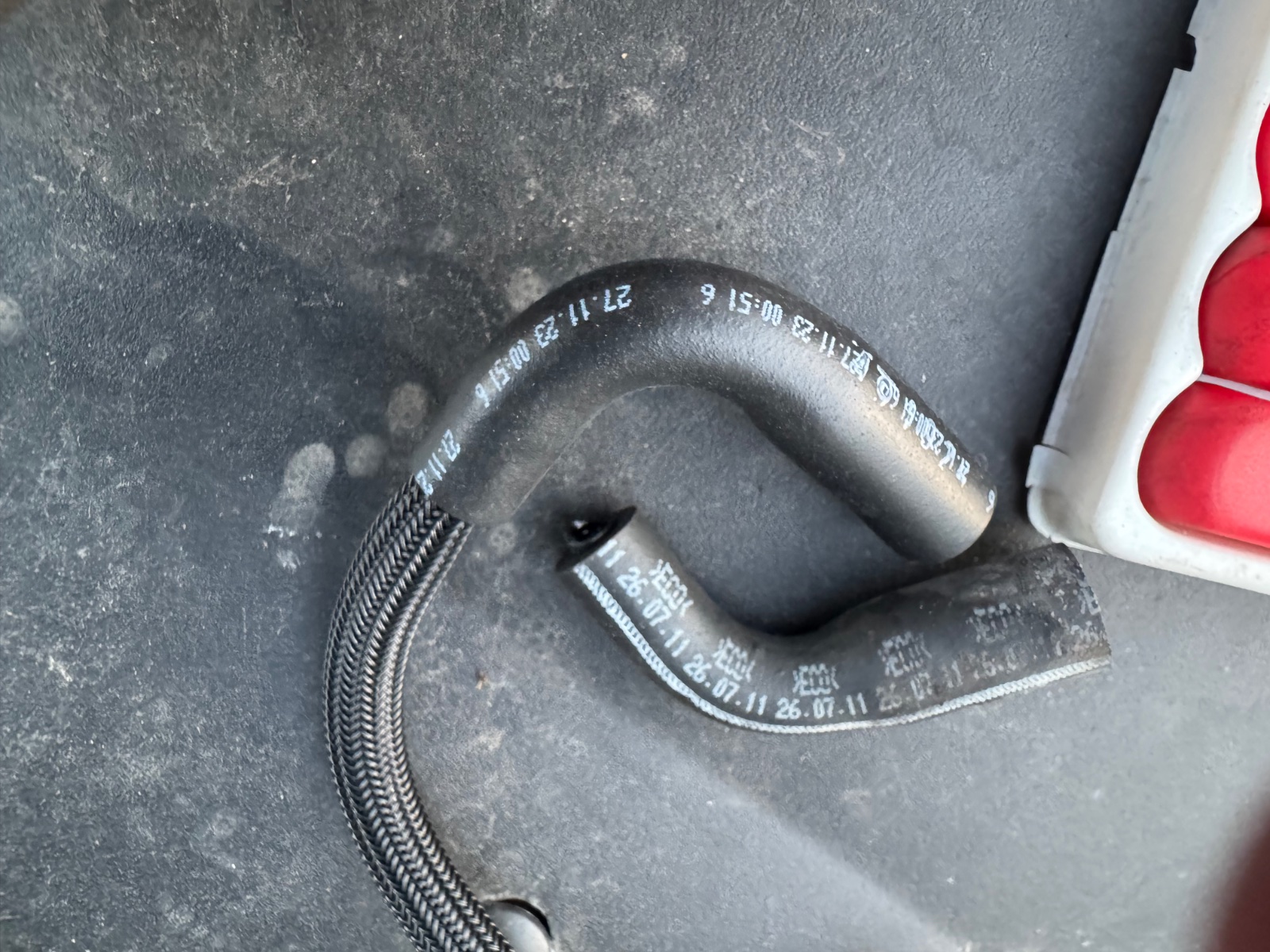

And replaced. The JLR part does fit.
New and old part side by side.

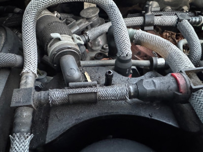

Connection to central catch can/chamber

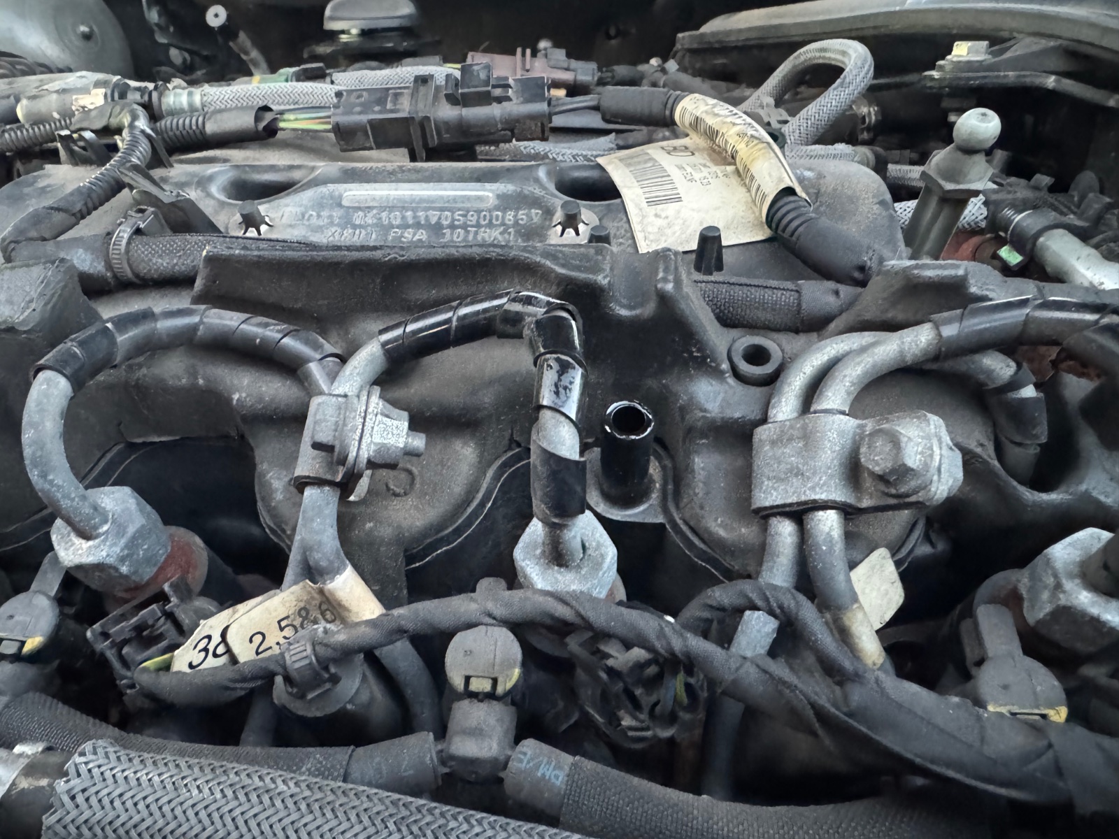

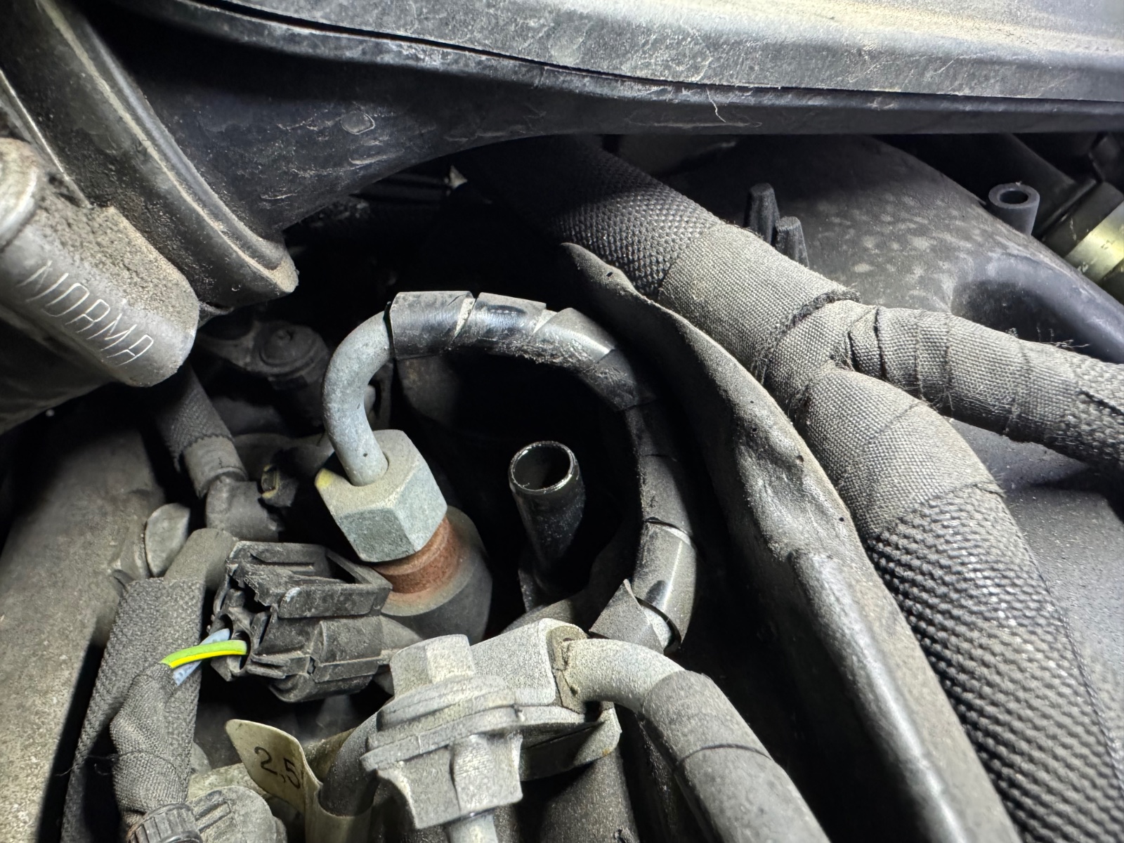

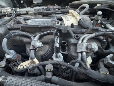

The three ports it connects to.
New one fitted in place.

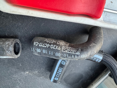

Part numbers on the rubber parts, new/old comparison.
