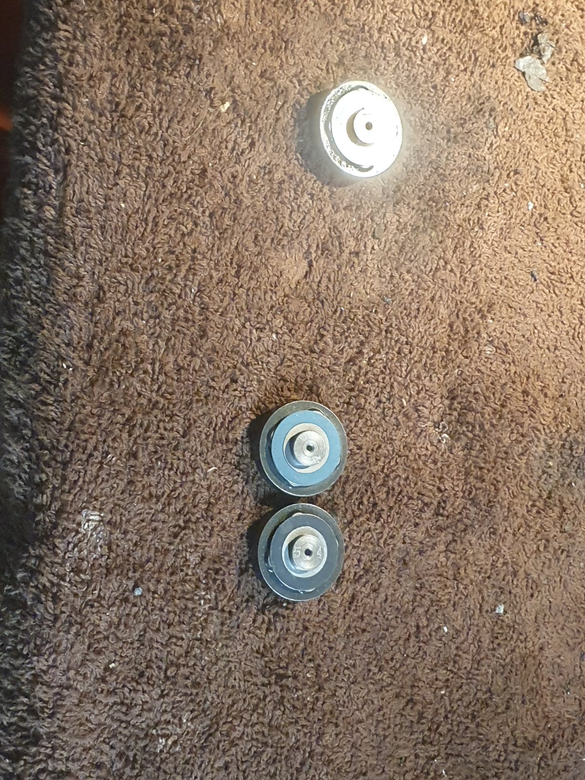

I finally tackled the job. I attempted to unscrew the rear firmness regulator electrovalve as outlined in the C6 forum but to no avail. It would not budge and it's in horrendous condition visually.
Fortunately I had a spare firmness regulator albeit a front one. I have already removed its electrovalve to check internally so i know how tight they can be. The only visible differences on the front one I can see are the lack of bleed nipple, instead there's a metal plug that unscrewed easily. The 2x damper valves L& R have a larger centre hole and would be unsuitable for the rear suspension. I feel the C5x7 rear suspension is at times underdamped in soft mode, especially noticeable on motorways. So any reduction in damping here just wouldn't work. Plan was to swap the damper valves over and everything should be the same.
So I removed the rear regulator pictured, and after quite an effort, removed one of the damper valves. This is when the fun began... the other damper valve retained by the 30mm hex Union nut would not undo. Using the longest breaker bar - the type for crankshaft pulley, driveshaft nuts, spheres etc... it wouldn't go and eventually the 30mm hex deformed. There was no getting it out. Stumped then. But no! I have in my collection some Hydractive Xantia and XM parts including damper valves. So all was not lost. The Hydractive 2 dampers have a 1,1mm middle hole. I measure the Hydractive 3+ rear damper hole as around 1,8mm. My thoughts were to drill the 1,1 damper out to suit the C5 but I only had 1.5mm and 2.0. Obviously i went for 1,5 so the 1,1 became 1,5 and that was the solution. All reassembled and pressurised and first impressions are good. Not only does it stay up as its supposed to but the ride is better with the firmer dampers. It's still very floating in soft mode but doesn't display that underdamped tendancy now.
One unexpected thing that did cause a problem refitting the front unit to the rear was the L & R strut pipes with their 16mm Union nut wouldn't seat in the 30mm damper retaining union nut and it took me a minute to realise these are actually different internally to rear ones. The fronts are designed to take a banjo union and so have a far deeper sealing edge. I repurposed one of the rears. But of course, the other rear was the wrecked one! So what to do! The answer came in the form of a Hydractive 2 part once more. The final few years Xantia had the same pipe fitting at C5s and so the 30mm union nut is actually the same... to think I was going to scrap those parts as well.. been in my 'hydraulic bits' box for years..
Anyway, a job that should've given a day I had to squeeze into 4h so I'm glad it's gone well.

Pictured here is the damper valves and the 30mm union nut that saved the day

Thanks Iain, it was blind luck that I had one single 30mm union nut rattling around in a bits box.
Still working well now. Only negative is that I'm not sure if the original problem was caused by a leak in the pilot valve that's operated by the solenoid or if the issue is with the slide valve that isolates the suspension sphere because both get replaced with the swapped firmness regulator. I believe it's the solenoid valve but cannot fully confirm.
