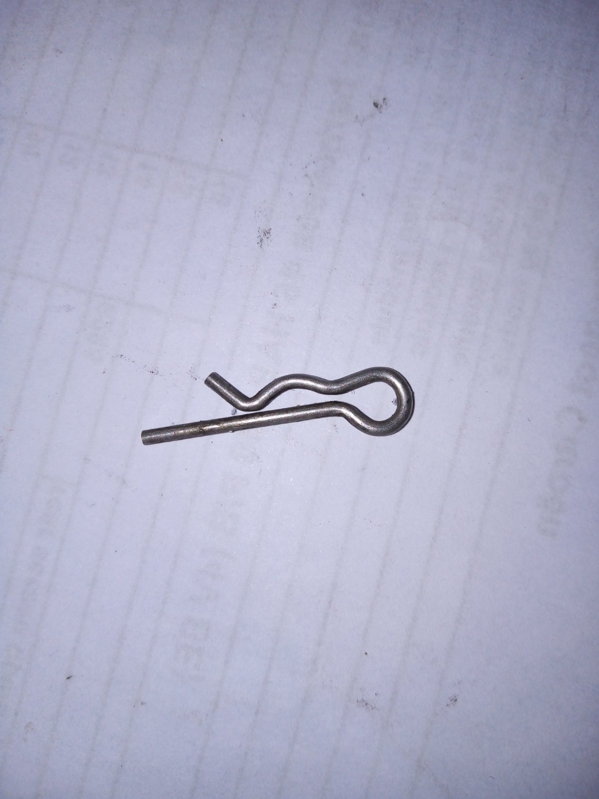

where does this bit go? 😂
ibog
Posts: 34
Joined: 29 Mar 2023, 15:04
Unread post by ibog »
help!! lol..
I was fishing around blindly looking for my engine speed sensor and I took this clip off something.. but I don't know where it goes!
it's from the flywheel/gearbox area on an RHY(dw10td) Citroen C5
may be on the berlingo or something else, they used that engine mostly in other vehicles..
it's mot ready apart from this, I'm scared to drive it anywhere though 😂
2003 C5 LX 2.0 hdi 90 RHY
2007 C3 1.1i TU1A (tbc)
2002 406 2.0 hdi 90 (retired)
1997 ZX 1.8D (rehomed)
1990 205 1.9 GRD (retired)
1989 205 1.8 GRD (rehomed)
Posts: 8186
x 2943
Re: where does this bit go? 😂
That's a pin to hold the brake pad pins/wedges in place not sure if it's used anywhere else but I've used them sometimes where they weren't supposed to be just for convenience.
Picture here: https://www.james-sherlock.co.uk/shop/r ... -clips-183
Unread post by wheeler »
They put the clip through the connector of the crank sensor plug to help stop it accidentally popping off.

ibog
Posts: 34
by any chance, could this be the locking pin on the gearbox that prevents changing from 5th to reverse?? 😬

wheeler
Posts: 7893
Joined: 21 Sep 2002, 19:07
x 1044
Nope, Almost certainly off the engine speed sensor connector as i said above. They fit them on the connector to stop the accidently disconnecting.
