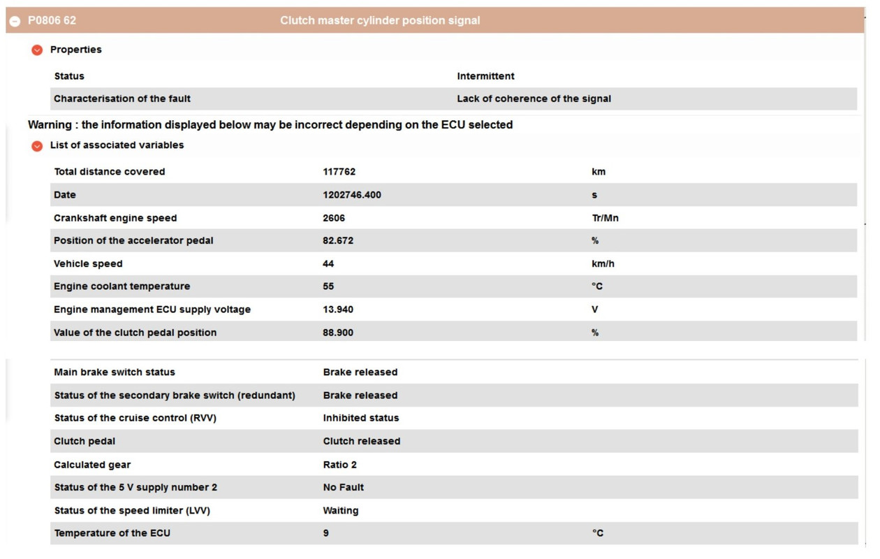

I have done a scan with diagbox and have found fault u1208 81 appears in the ESP module and it P0806 82 Clutch master cylinder position sensor appears in the engine ECU after this fault appears on the dash.

Here is the live data logged when the fault occurred on the Engine ECU:

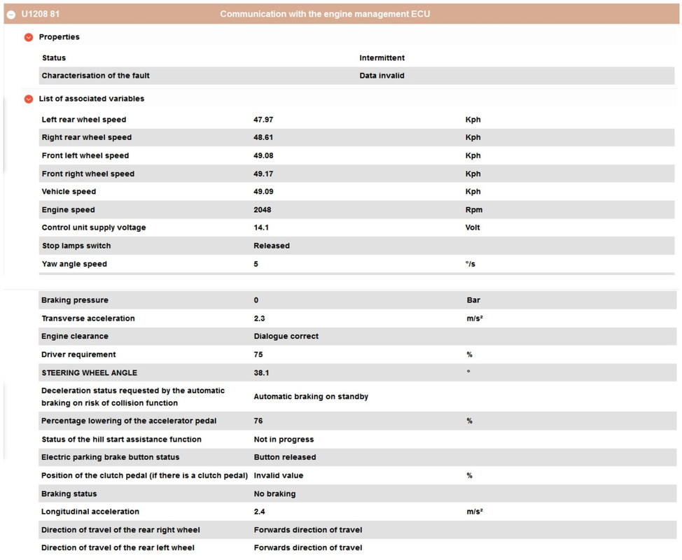

and on the ESP ECU
Under the ESP ECU its says 'Invalid value' under the Position of Clutch Pedal.
