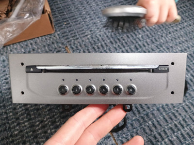

Yippee, my, err... What has arrived!?!

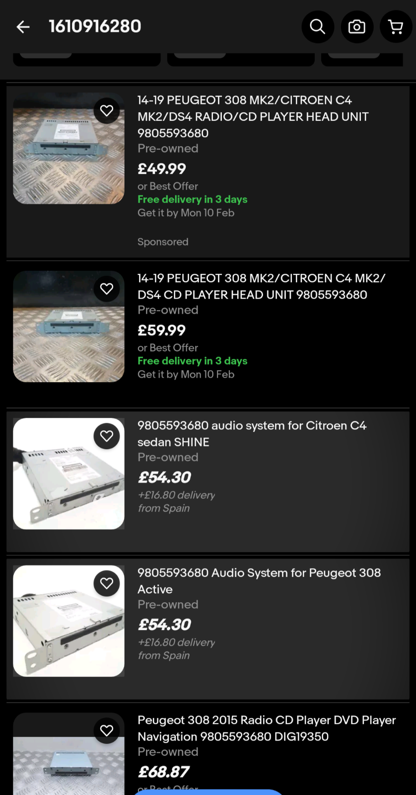

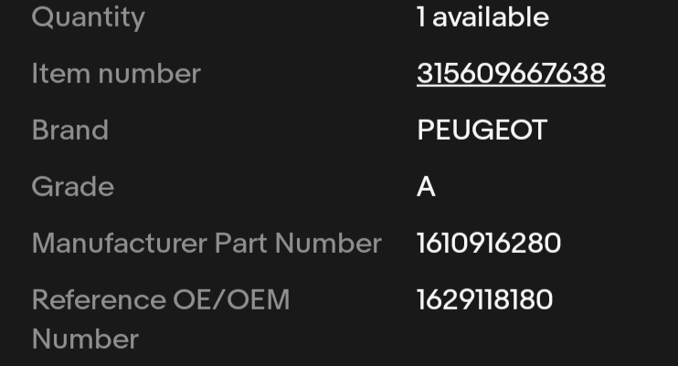

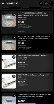

Searching eBay for 1610916280
Gives: In detail, for example top of the list. Item specifics states: But I'm not sure where this number is coming from!
Sticker on the item itself states: Which aligns with the number in the listing title:
Just for clarity: I've no poor opinion at all on the very kindly provided information from Marc on the parts thread.
But I am a bit befuddled, at what the link between the numbers is that the eBay sellers seem to be able to make!
This item, away from eBay makes the same leap between numbers too:
https://www.proxyparts.com/car-parts-st ... /15020362/
Going to sleep on it!

Had a quick look based on the alternative number and it's a bit weird what I've found.
Clear as mud!14-19 PEUGEOT 308 MK2/CITROEN C4 MK2/DS4 RADIO/CD PLAYER HEAD UNIT 9805593680

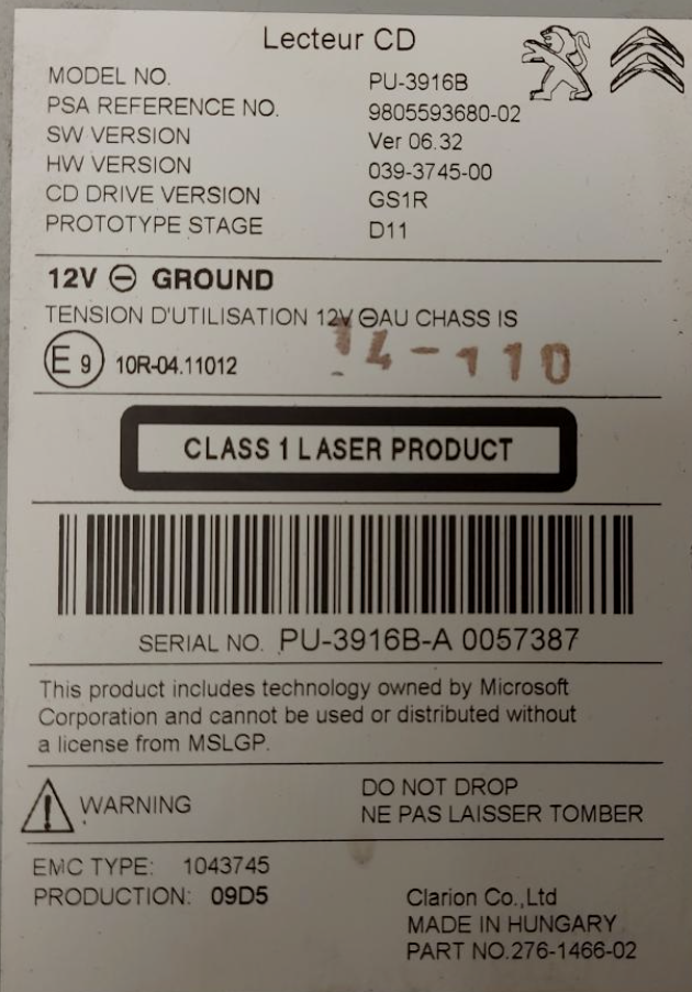

From the sticker on what I've bought (not arrived yet)
Other 308 hopeful upgrade, the CD changer, has reached Preston so that too might land with me today.
Hopefully it'll arrive soon and I can have a play. Dashboard panel has arrived, very well wrapped. Middle/face of the volume button is absent (was on the pictures) but will see if I can buy it separately/make something/pull it off the current panel. eBay reckons due today or tomorrow but also says "seller dispatching item" (i.e. not identified as entered the delivery network - Royal Mail - as yet)Lecteur CD
MODEL NO. PU-39168
PSA REFERENCE NO. 9805593680-02
SW VERSION. Ver 06 32
HW VERSION. 039-3745-00
CD DRIVE VERSION. GSIR
PROTOTYPE STAGE. D11-
12V GROUND

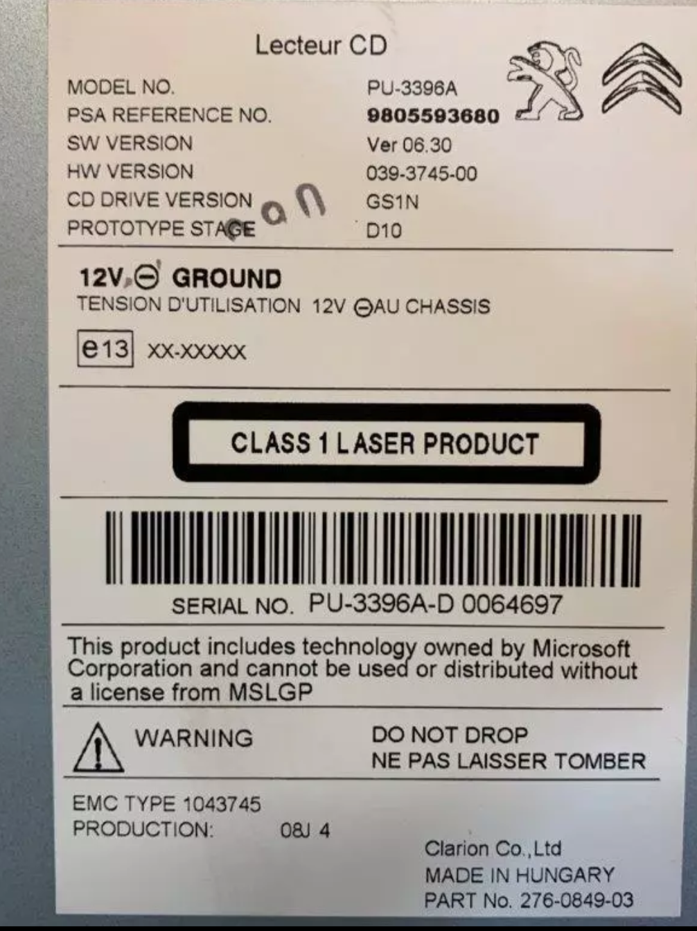

Hi Matt
Just got notified of this via quoting me.
From experience, I strongly suggest that you stick to the OEM recommended units for the SMEG system. Part and product numbers can become confusing, because Clarion (who make these) have their own model number (in this case PU-3916B). Although the PSA reference quoted on the unit is the same, the revision of the correct unit has a '-02' revision and later Prototype Stage (D11) revision.
This may be because of the later vehicle and Head Unit compatibility - but I can't say for sure, but they are different models, and all I can say is that why bother making another unit with a different model reference if they are identical?
Anyway, PU-3916B is the recommended one under part 1610916280 and as you can see has a different Clarion part from the one in your picture (bottom right corner of label).
As an aside, I'm emailing you the official installation guide PDF for the CD in case it helps.

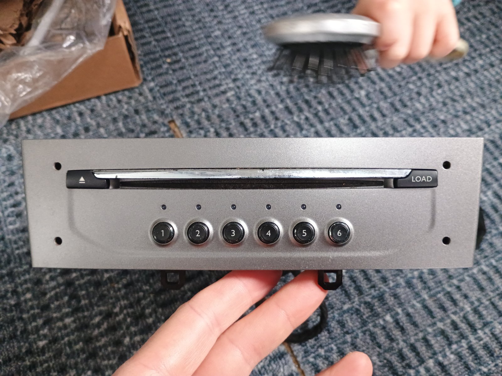

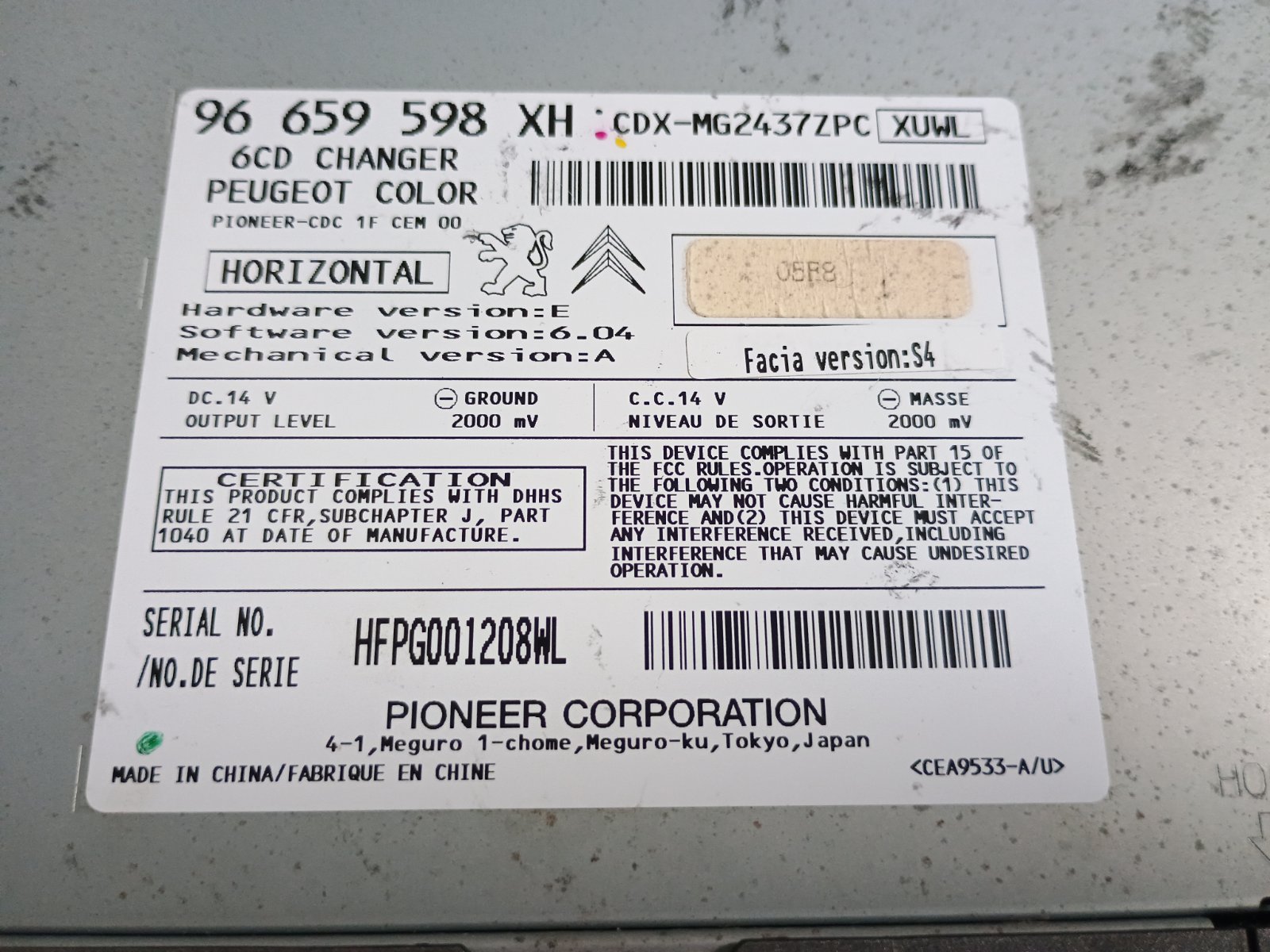

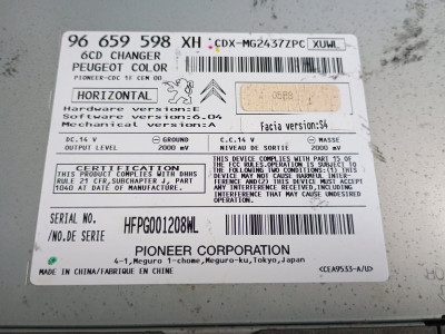

In other news, the CD changer, potentially to fit into the Grey 308 has also arrived. It's particulars are as follows:
Microsoft seemingly not getting any royalties from this one!
