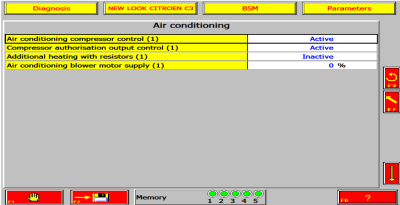

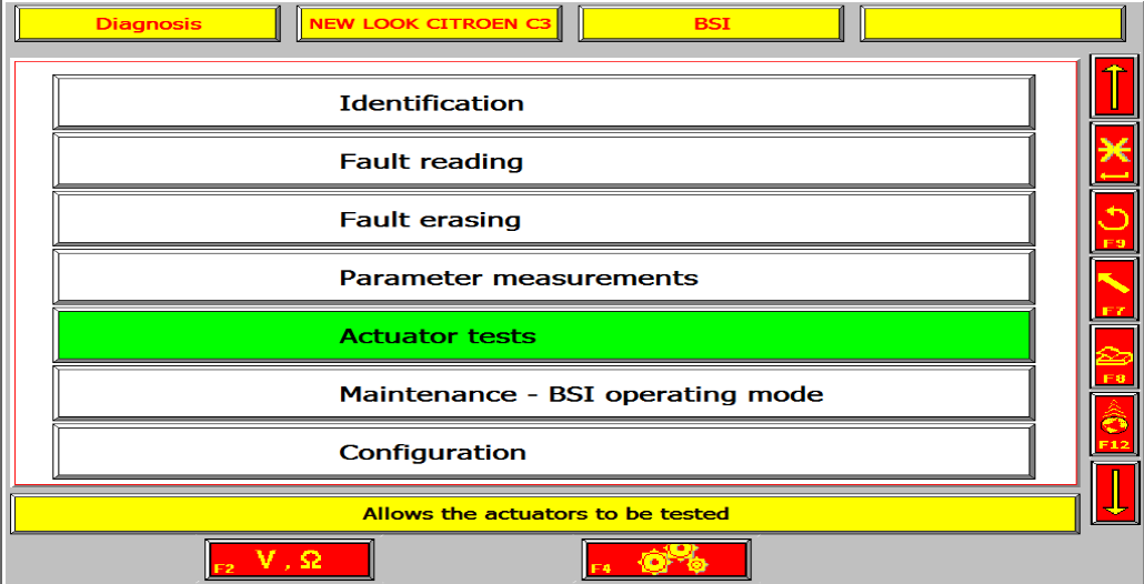

I then tried the Actuator Tests available in the BSI Diagnosis:
All tests were executed correctly, but nothing happened. The first time I tried with the engine running and Lexia showed an error stating that the test failed because it wasn't possible. I then tried with the engine off and the tests were executed, but the compressor did not start. I also tried both heating resistors but no noise was heard. No actuator test related to the A/C unit had a response, although Lexia states that the test was completed. Just to make sure the tests were working I tried testing other actuators like doors and wipers, and they were executed OK.
Afterwards, I started the engine and the A/C and, although the compressor was not running I went to the live measurements screen and got this:
So the A/C appears to be working, at least from the BSI's point of view, although the compressor is not actually running. Finally, I reviewed the configuration of the A/C parameters and got this:
I'm surprised and really at a loss. The BSI detects the A/C ECU, runs the actuator tests OK but the unit itself does not work. Could it be a wiring problem, a blown fuse or a faulty sensor?

Well this shows that there is nothing wrong from a control stand point.
So the alternative is a physical problem.
The suspects would be the BSI or BSM, (Sorry I don't have access to circuit diagrams for the "all CAN BUS" C3 so I'm not sure), the wiring, the clutch coil or the clutch adjustment.
The next test I would do is check for voltage at the connector of the compressor. If no voltage, it could be the BSI/BSM or the wiring.
If you do have voltage at the connector, this means it is either the clutch coil or the clutch adjustment.
At this point you could try hitting the compressor with mallet! With the A/C on and the engine running, tap the center of the clutch pulley with a rubber mallet (or the like) and see if it starts spinning. The clutch is adjusted in the factory with shims to get the correct gap. Over the years the clutch wears and may not be able to pull in.
Lastly it could be the clutch coil. Check for continuity using a multi meter. Check both ways (swap the leads over) as there may be a diode across the coil.

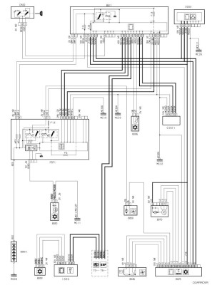

Re: Citroen c3 2008 No AC detected by Lexia
Here is the climate control A/C circuit.
8045 and 8085 are all in the one unit, the cabin fan speed controller. They are not separate bits!
8050 is the cabin fan.
8030 is the "sniffer" that I mentioned.
8065 and 8071 are the temperature blend door actuator and the air outlet selector actuator.
