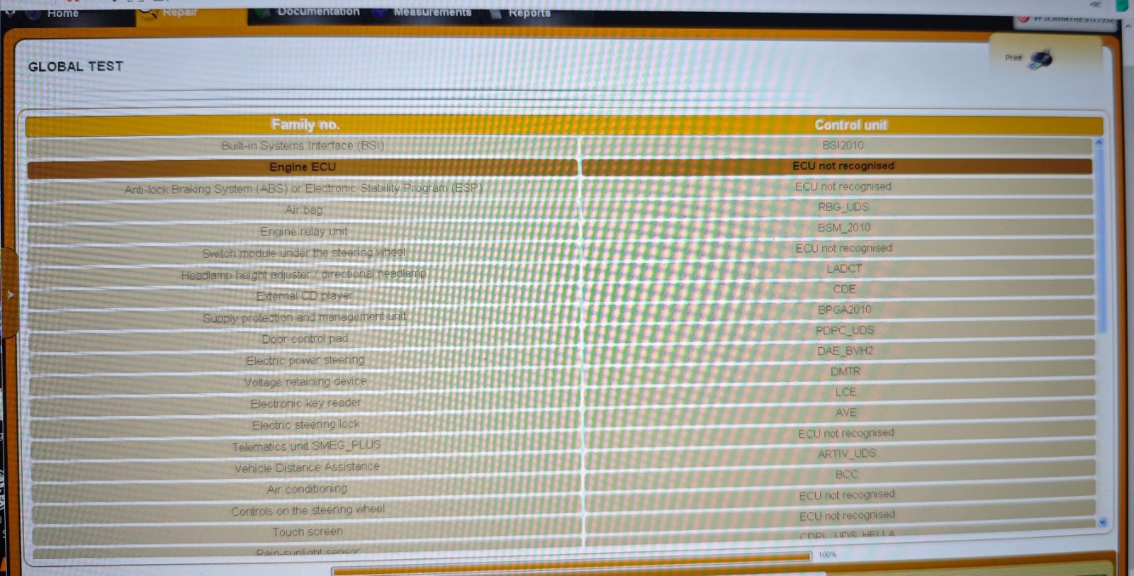

tried today with V07.57
I could change/configure data in other ECU's in the car with success like the BSI2010 ECU.

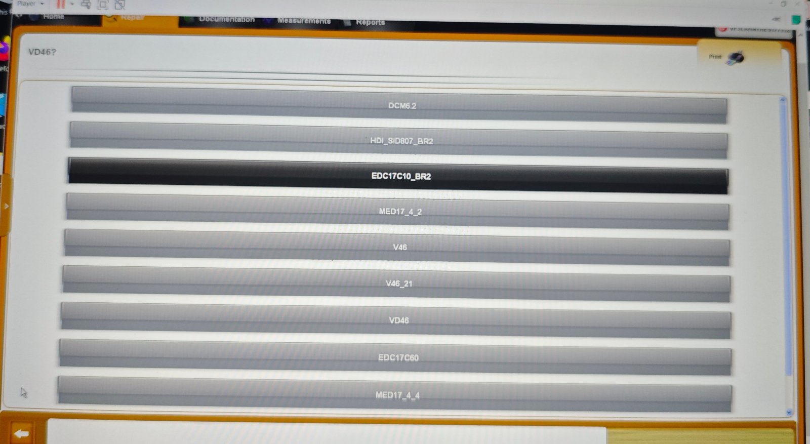

It did not recognize the V46, with unusual naming:
some of those modules it does an attempt to clear the faults, most of them report the no internet connection.
higher DB versions don't have this.

Re: DIAGBOX issues: No internet connection
Unread post by xantia_v6 »
The ECU not recognised is a diagbox problem, I have it on my 308 with EP6CDT engine. I find that If I manually select the ECU type then all operations are available (including ECU software updates when connected to a PSA server).
