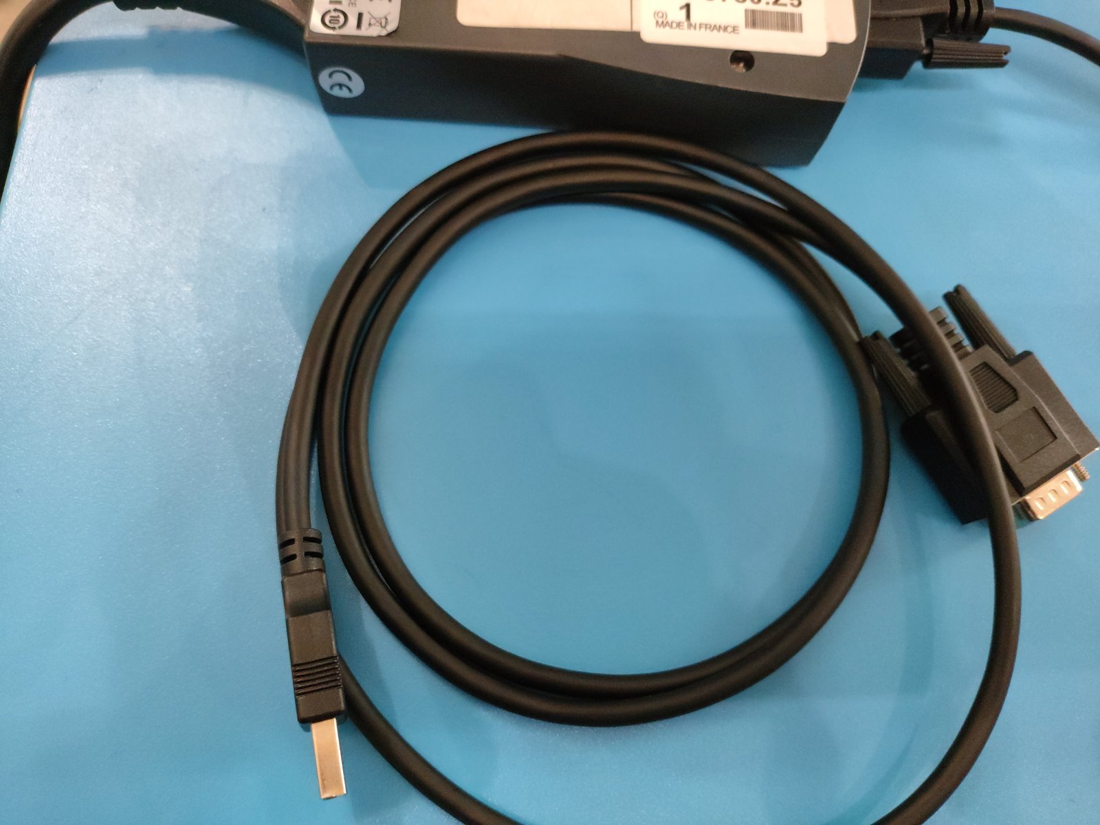

Update.

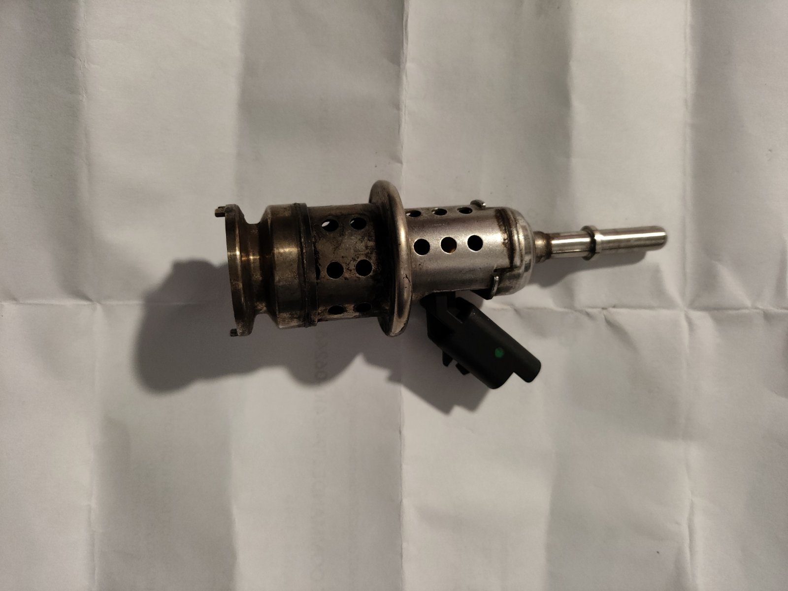

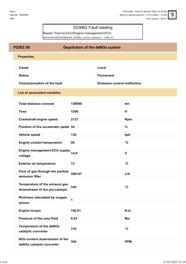

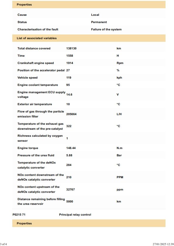

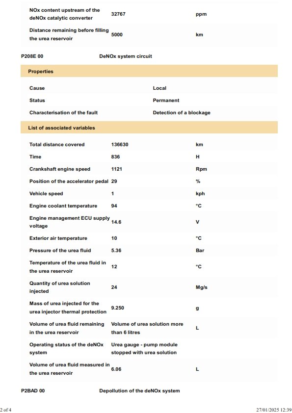

The usb connection cable was defect. That's why there was no communication with ECU.So there is no problem with Diagbox 9.168. I had a spare one cable and everything is o.k. Also seems that UREA injector is faulty even if i made a good clean and inspection with poly meter readings and applied 12 volts to energize it and everything was in specs. I did a test with diagbox and it was not "buzzing" so i suspect something is wrong with injector. I'll check the connection plug, because it was really difficult to reach and maybe is not connected properly.Otherwise i'll change it and see how it goes after resetting the parameters of depollution system and new injector fitted. From diagnostic form is obvious a blockage with P208E error. But pump is working with 5 - 6 bar so it seems there nothing wrong hopefully with the tank itself. In first chance i'll change the injector as i had already ordered it last time i saw crystallization around gasket.

Re: Urea fault, engine repair needed
Certainly looks like a fault with the injector - it could just be that it is blocked, easy enough to whip out and have a look.
Dead as a dodo.
Ohms was exactly right, 12.7, but no clicking. Replaced with a new one which is "buzzing" under injector test in Diagbox 9.168 ver. which with i'm very pleased. I've done under Diagbox realisation of Nox sensor, new urea injector fitted and filling of urea reservoir and added and Wynn's treatment.In next "coughing" from adblue sytem, i'll throw it to the garbage. I swear..
