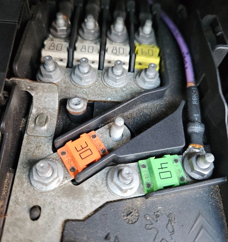

However, I noticed a missing nut here which is far from ideal:
I just wonder, while I'm kicking my heels at work today, whether the nut is an M7x1x8,3? Does anyone know? It'll look like this:
Would be great to confirm and order a nut today.

I don't think that's needed, there's no cable connected to it.

That nut is not fitted at the factory, the fuse is for some option that is not fitted to your car.

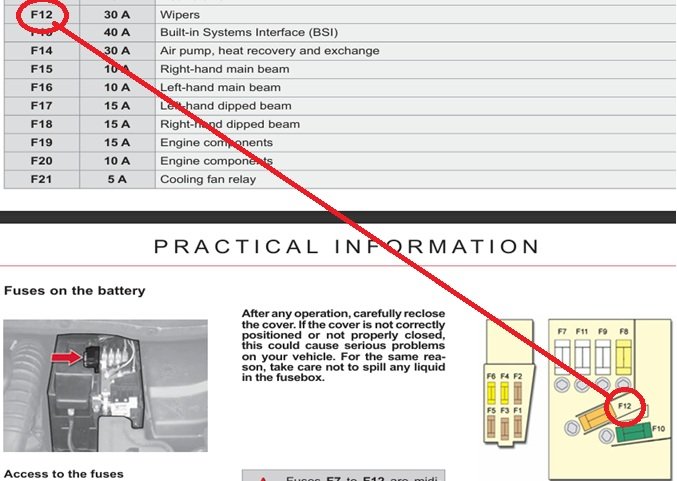

Thank you for the replies gents, appreciated. That fuse is F12 in the manual for "Wipers" and I definitely have them.

I am sure that fuse is never for the wipers, maybe there is confusion because PSA sometimes have 2 different fuses with the same number.

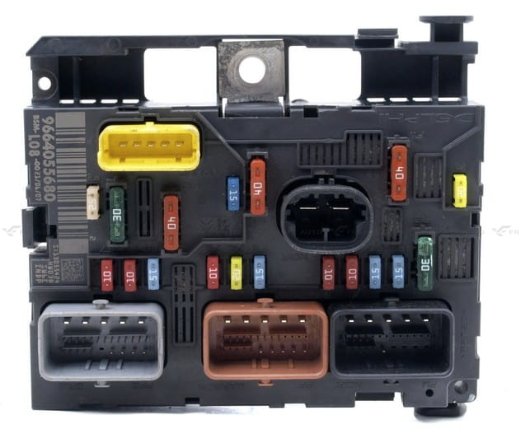

PSA have multiple fuse boxes: Several rows of fuses in the BSI (in the passenger glovebox), then there is the engine fusebox that contains another load of fuses and there may be one or more dotted about depending on options and equipment.
What you're looking at in your picture is not the engine fusebox - it is the Supplies Protection and Management Unit and won't contain fuses. The engine fusebox looks like this:
That is exactly the fuse box I have, I believe it's part number 9807028780.
I may well be looking at the wrong manual for a C4 Picasso but the one I have does state that F12 is wipers. Either that or I am misreading it somehow.

F12 for the wipers will be on the BSM that Marc posted a pic of. My 3008 manual suggests that F12 on top of the battery is the power supply for the EGS box when fitted.
