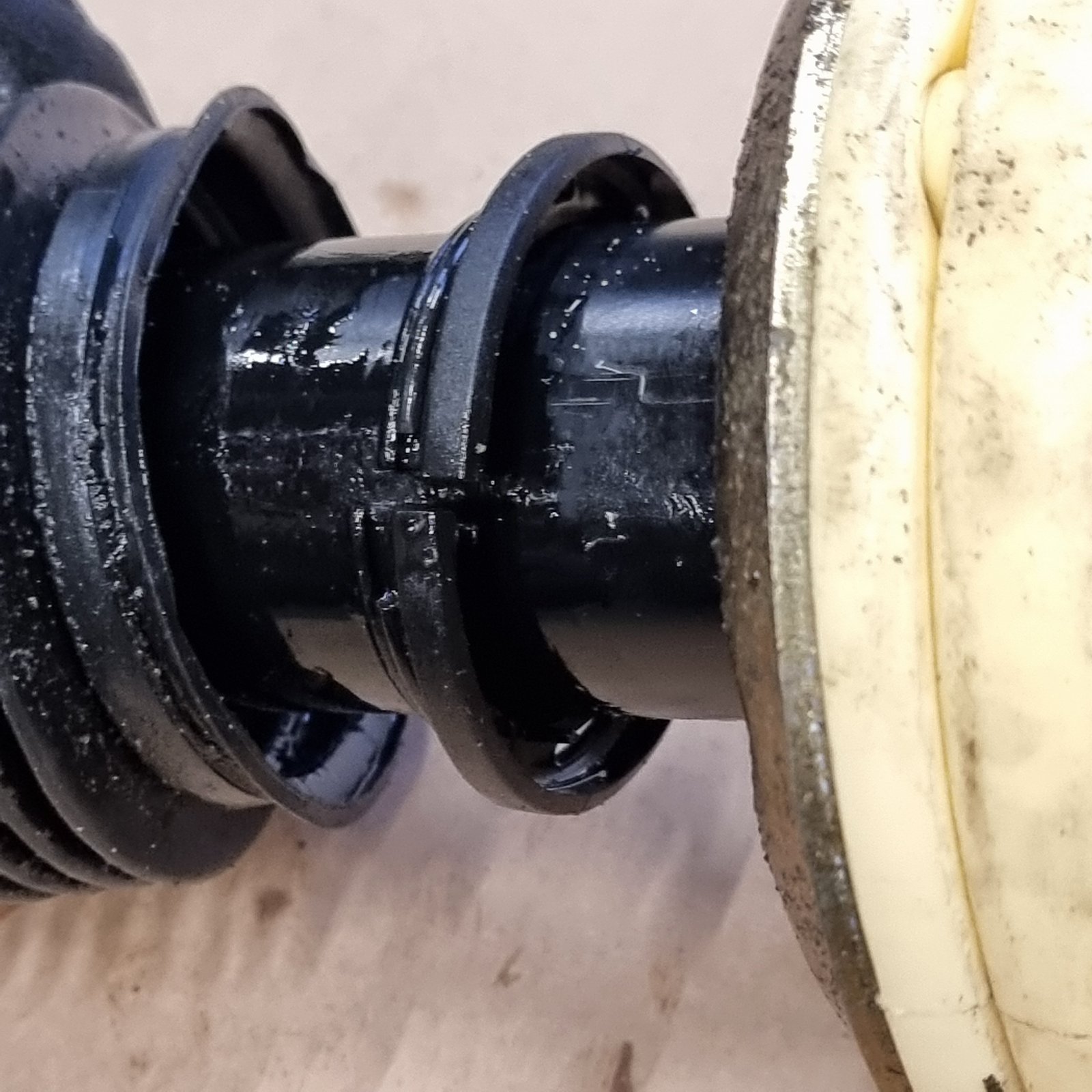

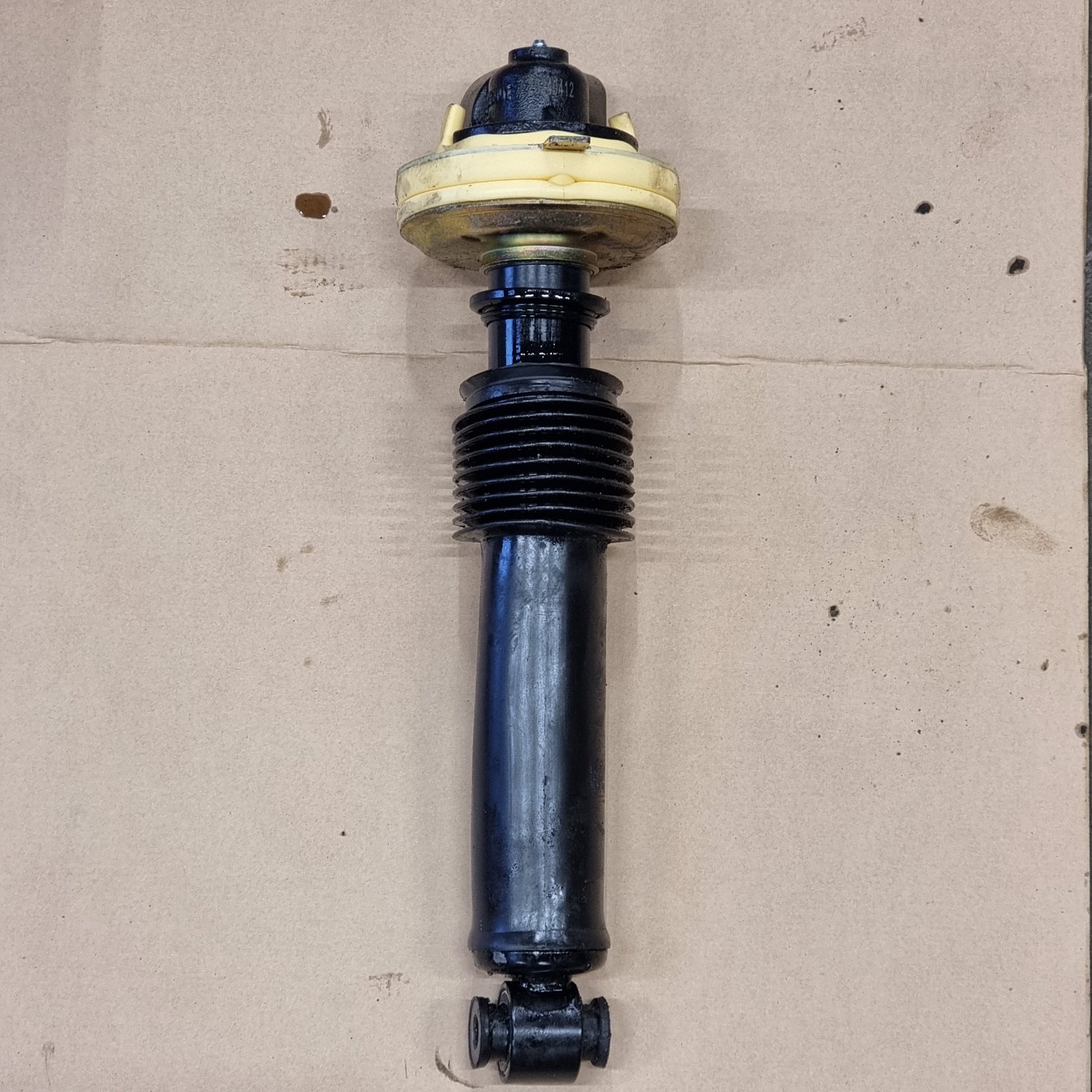

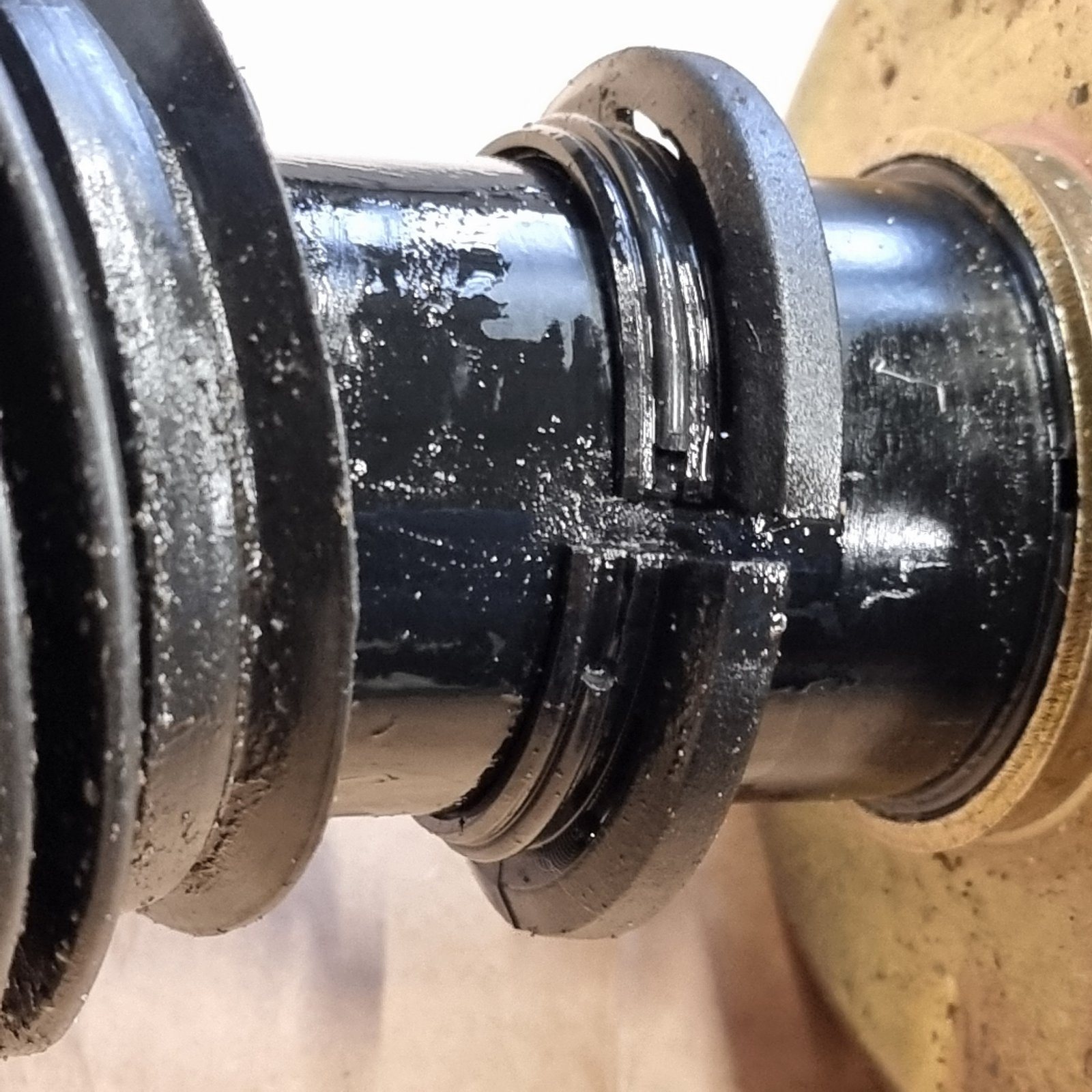

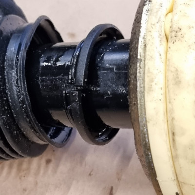

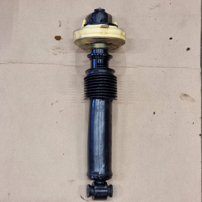

The problem was the strut indeed. Maybe a manufacturing defect (pictures attached), or the service didn't lift the car to the highest level.
However, yesterday I got help from a work colleague and I could drive the car! It feels good!
I have the new spheres in the box, but I guess I will wait a will till I will mount them on the car, as with so much going on yesterday, I still have to think and make courage to do that!
