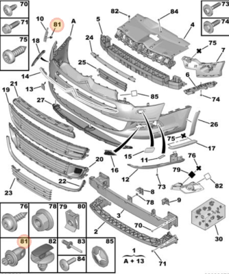

Trust Citroen to require a special tool to remove the bumper :roll: (backwards step from the earlier C5).
Do you know the part number for the clips that must be replaced, please?
Thanks
Iain
CX DTR T2 Safari (silver)
x 6954

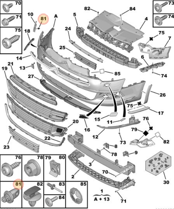

Re: C5 X7 - B1131 - RH Headlamp Communication fault
(81) Bumper Fixing Clips, part: 743712, £4.13 (should be a for a pack of 4), but don't quote me on that!

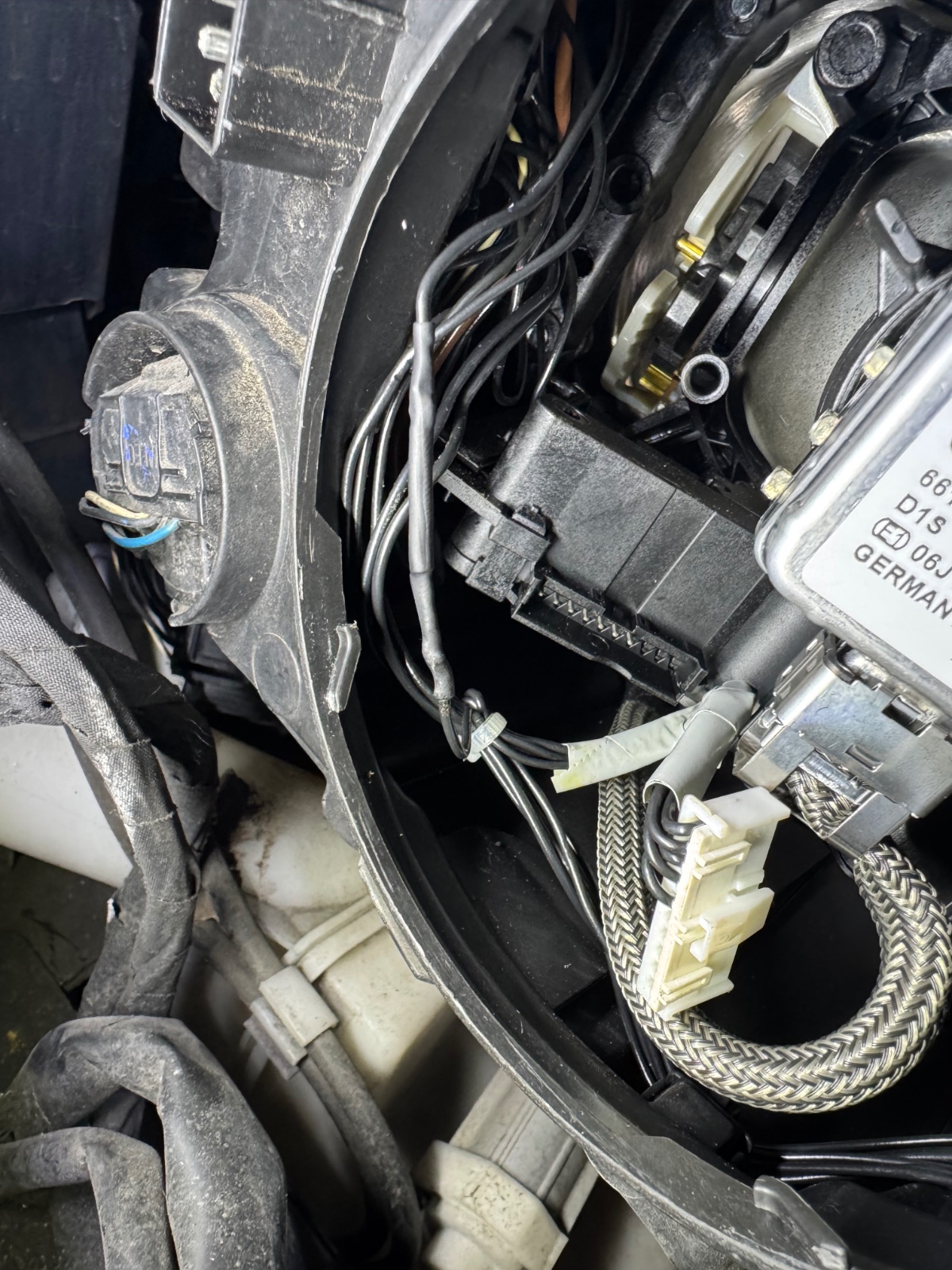

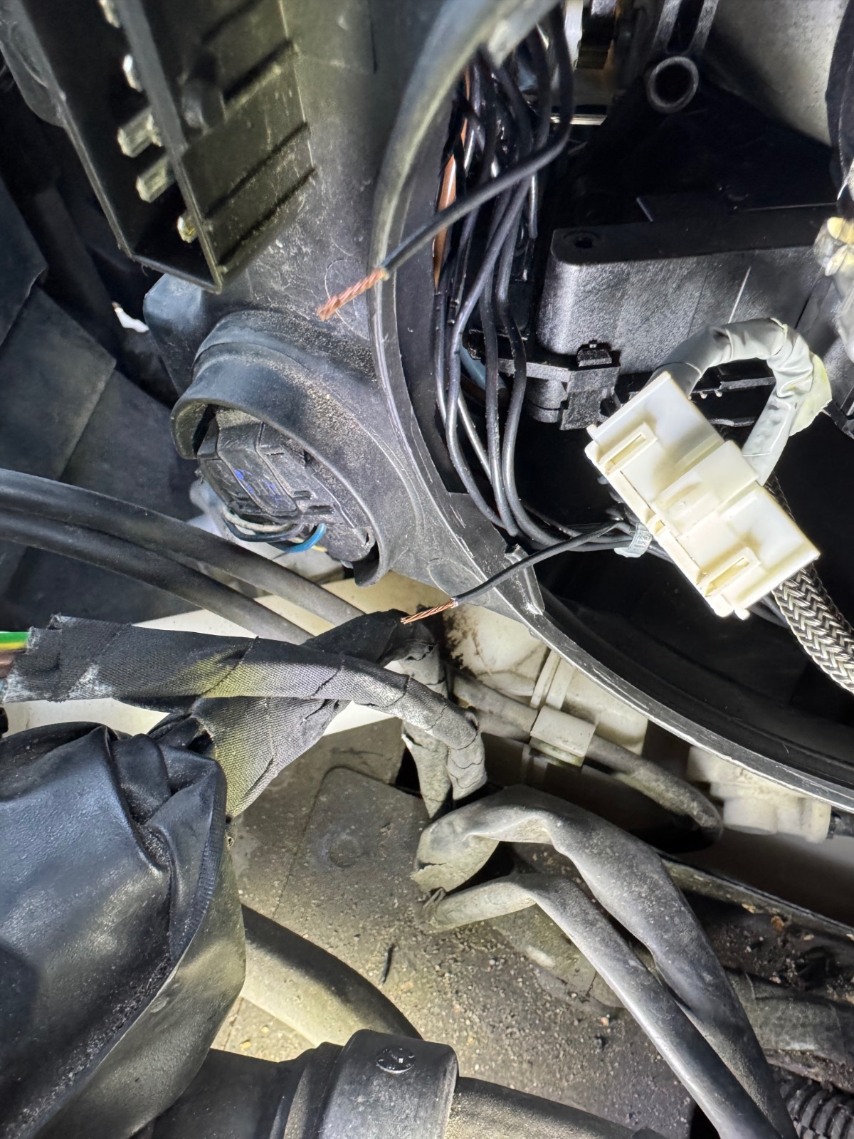

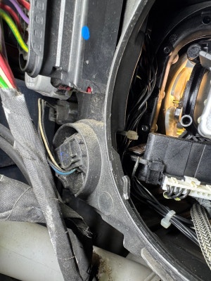

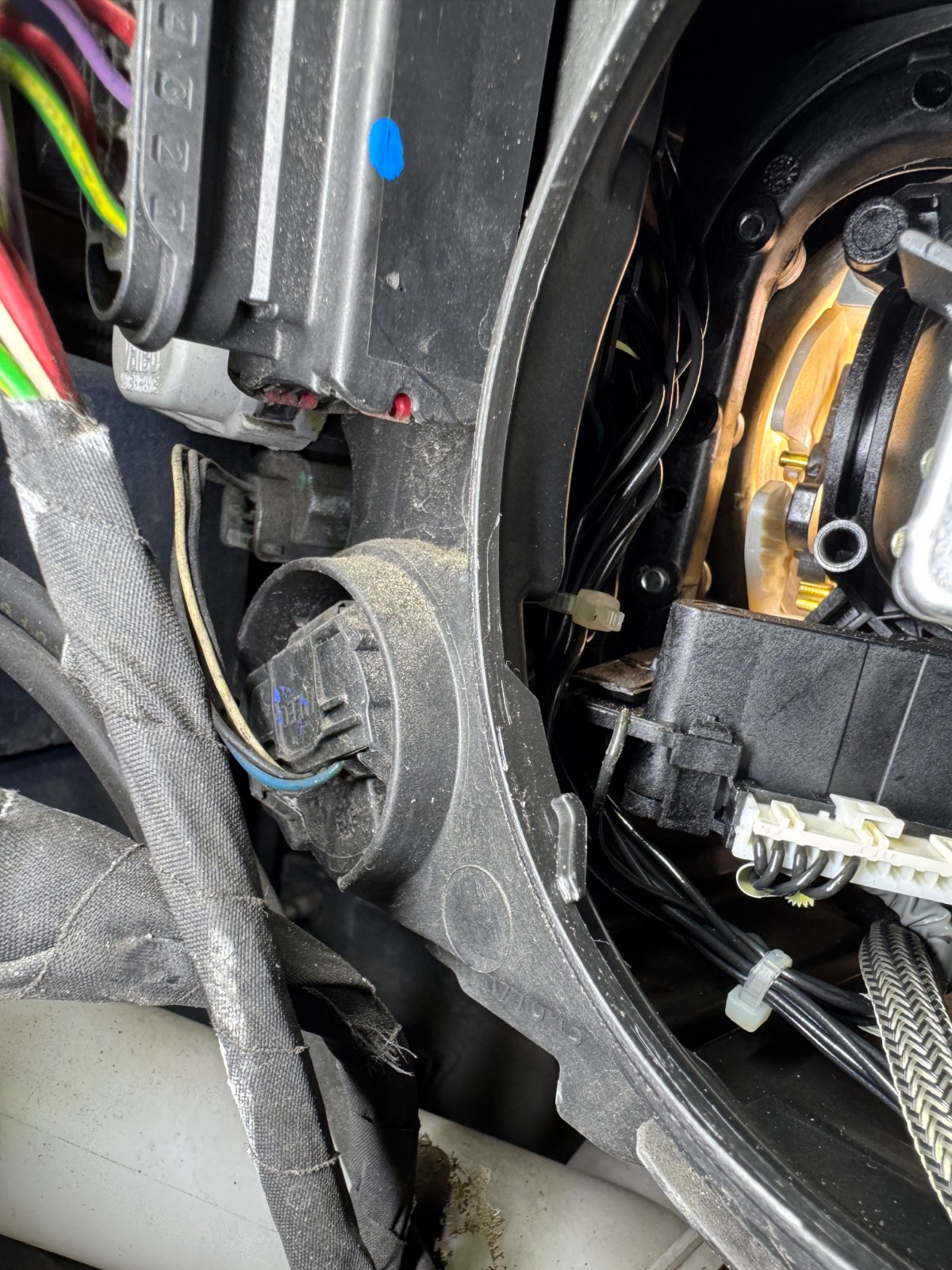

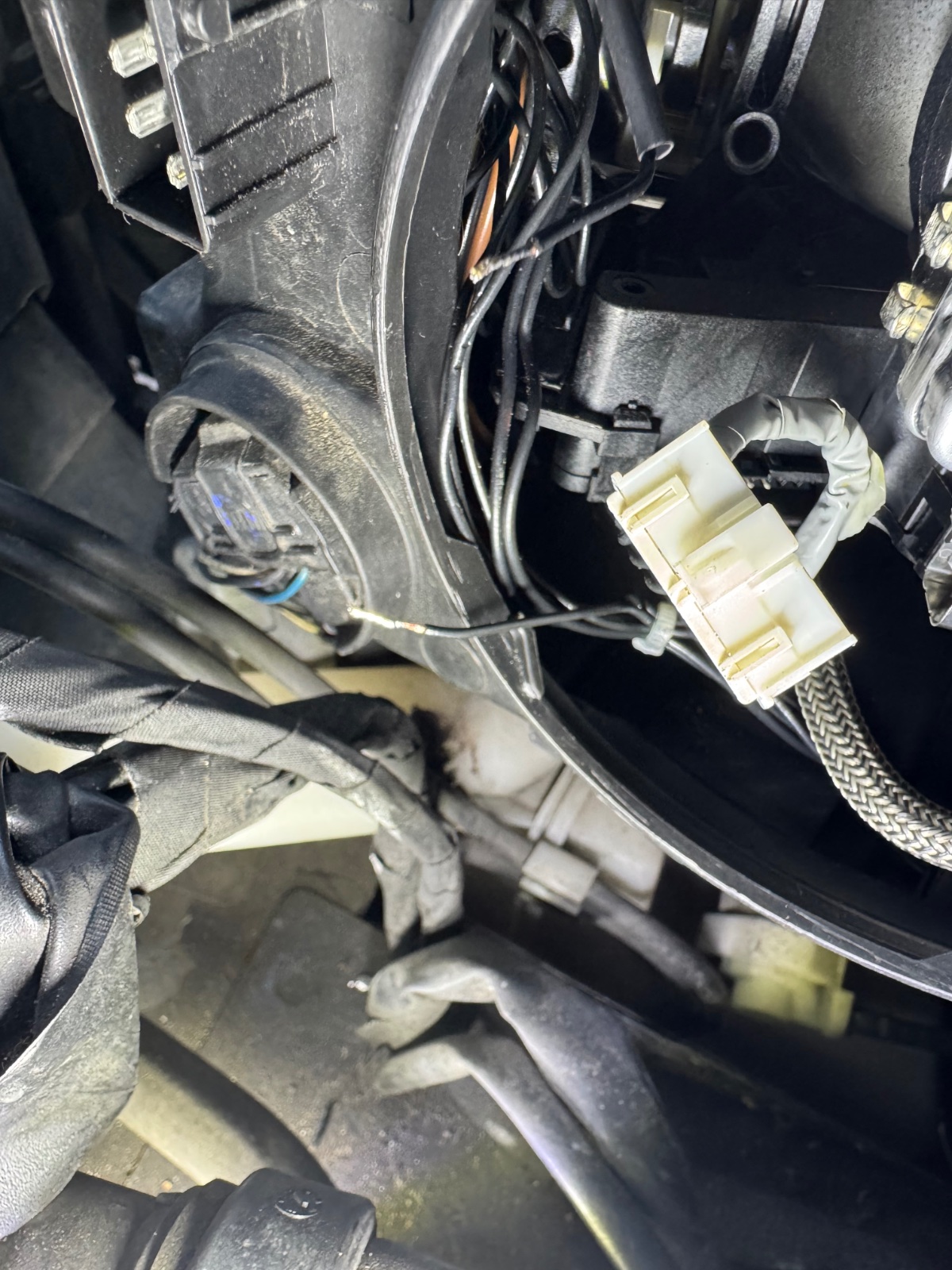

Update: Believe I have found the fault :idea: hopefully without needing to remove the bumper [-o<
Peering inside the headlight today I spotted it looked like the wires were perhaps chaffing on the side of a sharp edge/what looks like a metal clip… Reached in with fingers to pull them clear so I could look and see if the insulation was indeed chaffed and… Ping! One of the wires immediately broke.
Found this really late in the day (after going over lots of the rest of the car) just as I ran out of daylight , so no chance to repair - but hopefully this is a free fix!
Checked the other side and although it doesn’t look chaffed, you can see there is definitely potential to, so I thoroughly recommend all X7 owners with xenon directional headlights to check these, as a precaution.
Also just to confirm what the visible symptoms of the fault were (on mine at least) : the levelling function on the dipped beam on that side only, has been randomly continually hunting between max up and down.
I also have the dipped headlight light on the dash blinking (though don’t know if that normal for auto headlights???).
Iain

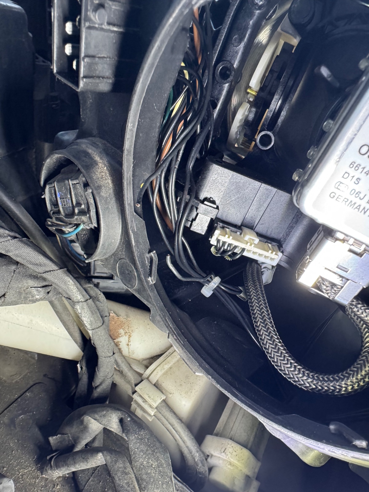

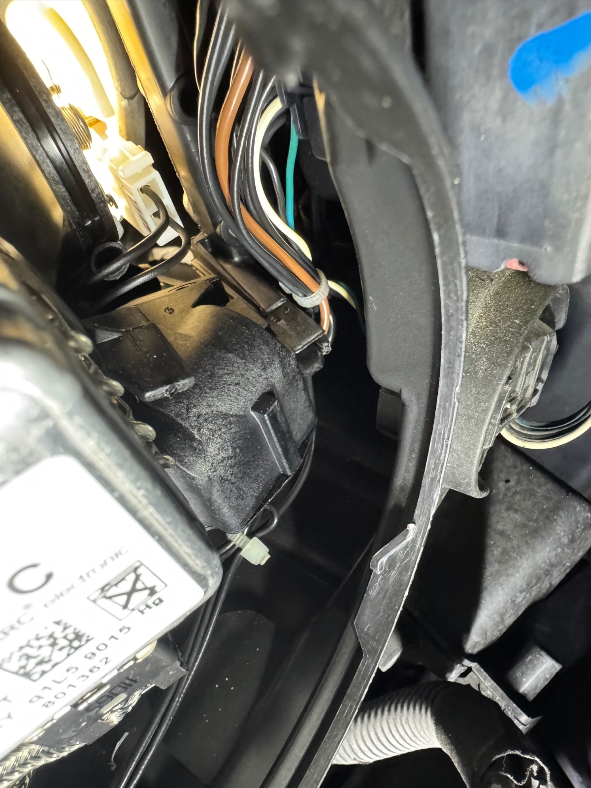

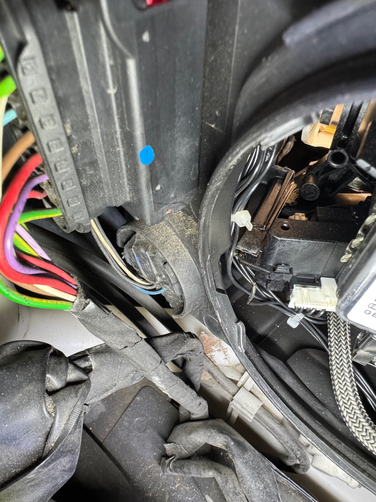

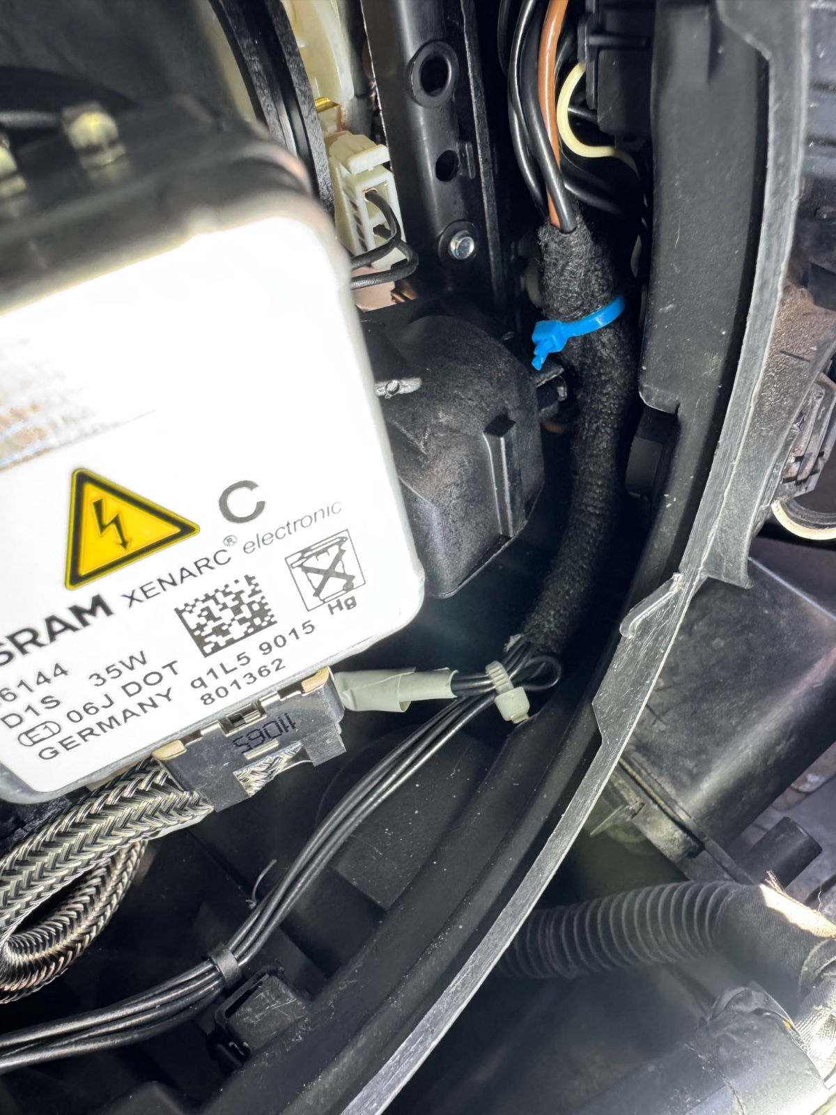

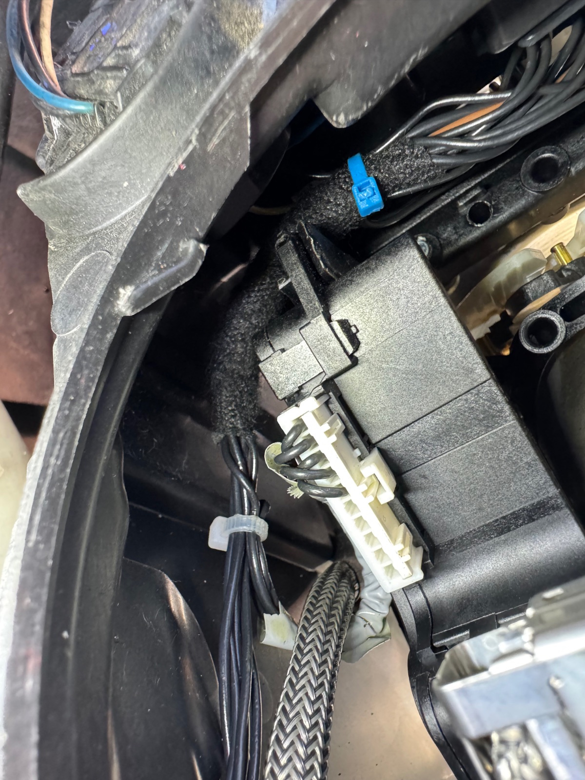

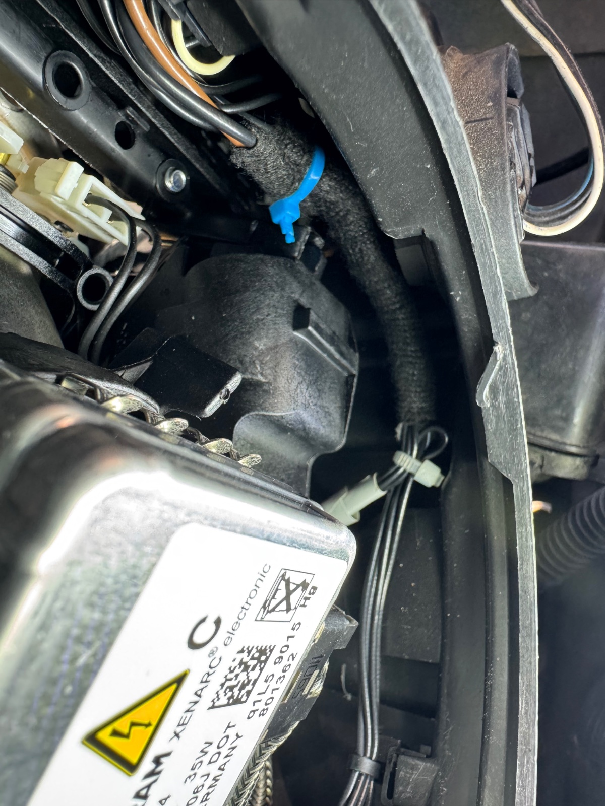

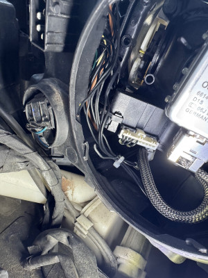

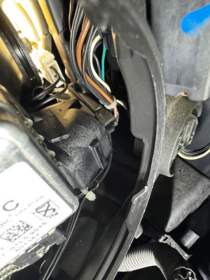

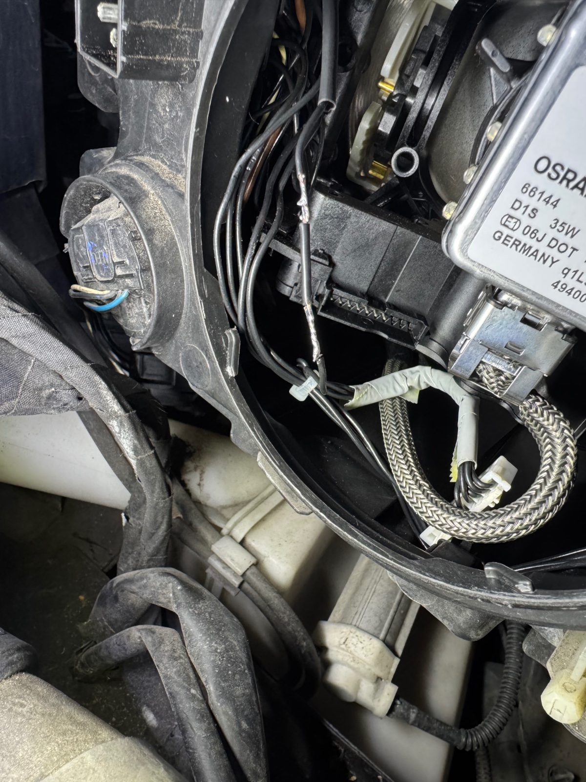

So just to close this one off - all successfully repaired.
I’ll let the pics do the talking - TESSA cloth tape to protect from any potential future chaffing (nb: looks in the pics like it’s tight up against the side of the dipped beam carrier, but in reality there is a slight space between the two).
I also TESSA cloth taped up the other side, as preventative (there was minor evidence of chaffing, but nothing through the insulation).
