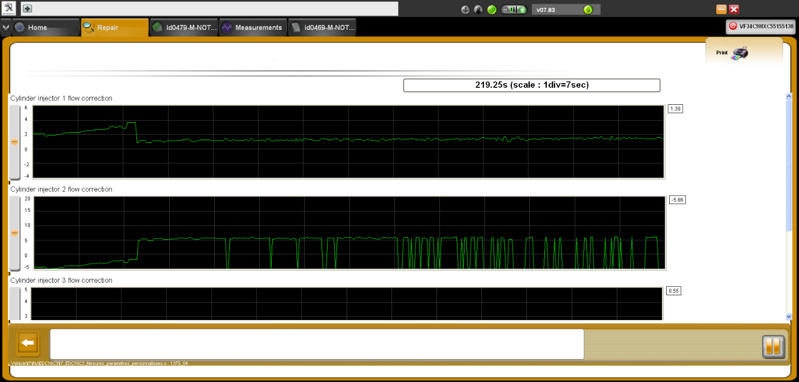

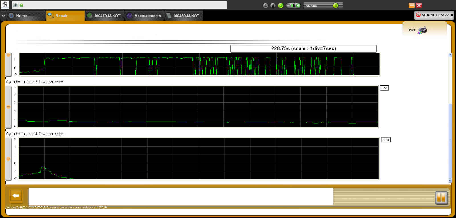

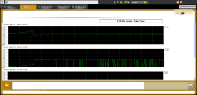

On a bit of a hunch, and after some googling, I've taken a look at injector corrections in Diagbox, and I think there's something wierd there. It looks like the ECU is struggling a bit with injector 2 ?
All others are stable lines, even if injector 4 is lower than 1 and 3 with a value of -2.
I'm tempted to grab a couple of used injectors and replace number 2 as it doesnt look right to me. Might leave number 4 for a while, as it seems pretty stable.
