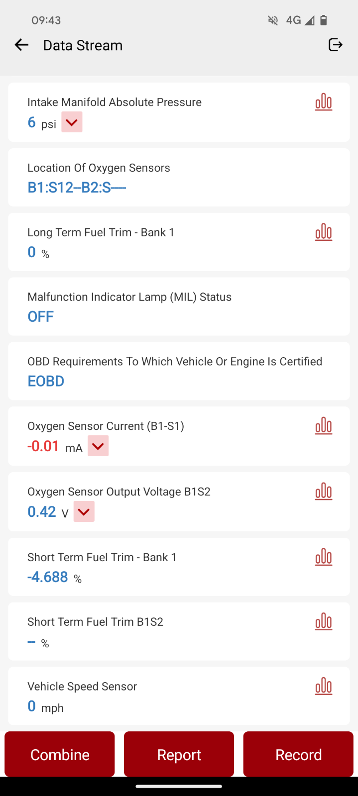

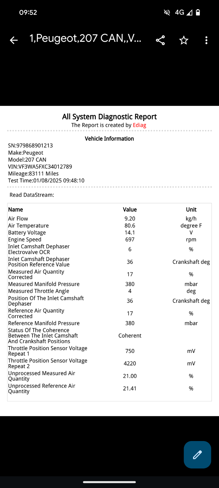

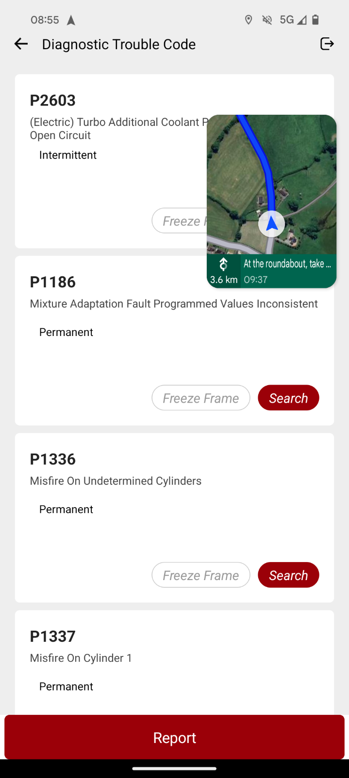

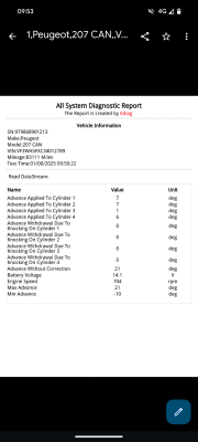

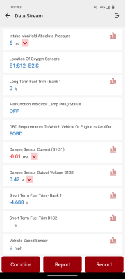

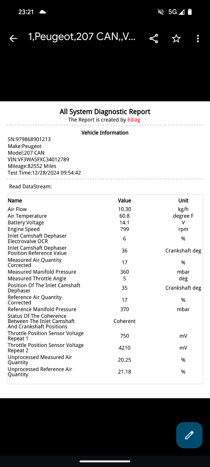

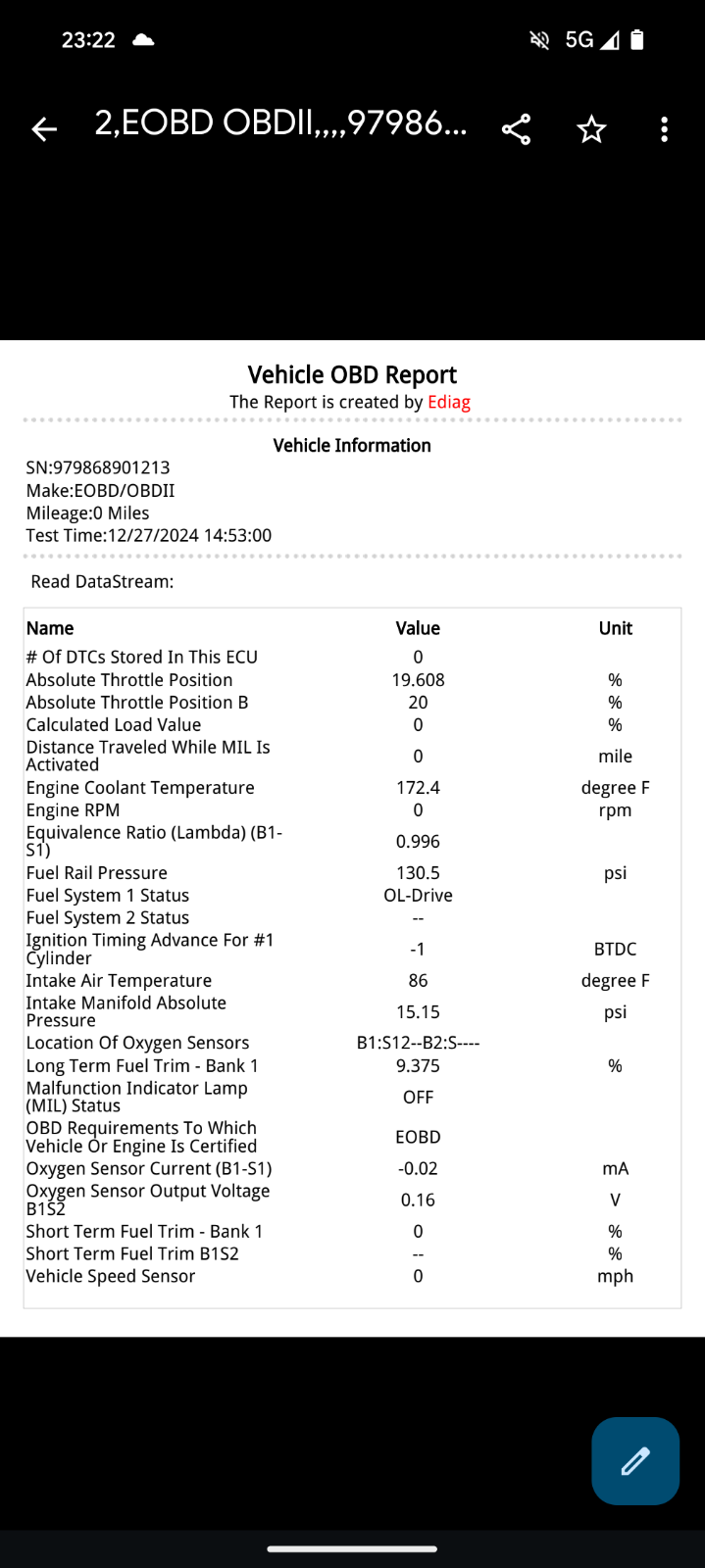

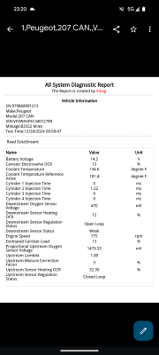

ImageHi, wondering if anyone has had misfiring problems with this engine? So far I've replaced spark plugs, coils, camshaft and crank sensor, once I clear the codes it seems to drive fine, happens more on cold start up but can happen when warm too, no signs of head gasket failing that I can see. I have attached live data. Was running lean but now I've put a new boost sensor on and cleaned the oxygen sensor the ltft has dropped down to just over 10% was at 21 🫠 was thinking of replacing intake and oxygen sensor but before I do I'm just wondering if anyone thinks there is any point or could it be timing? Codes I get are for misfires which can be any cylinder, sometimes get an air/fuel mixture code too, seems to be using a bit more fuel, no noises coming from engine

If you list the fault codes it might help.

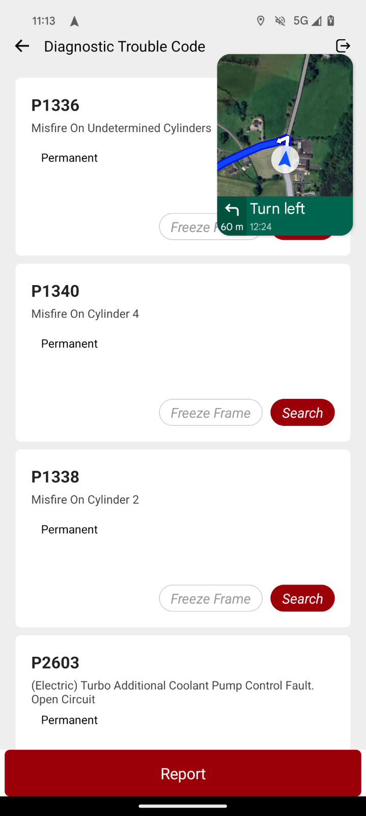

Will give it a read, I don't have a fuel filter unfortunately. I did buy one that apparently fitted my car then was told my car doesn't have one 😅 sorry thought I posted the codes I'll do that now

Based on previous reports, I would guess that your symptoms are more typical of a stretched timing chain.
I would suggest that you look at the diagnostics data, particularly fuel, timing and air trims to see if anything looks odd.

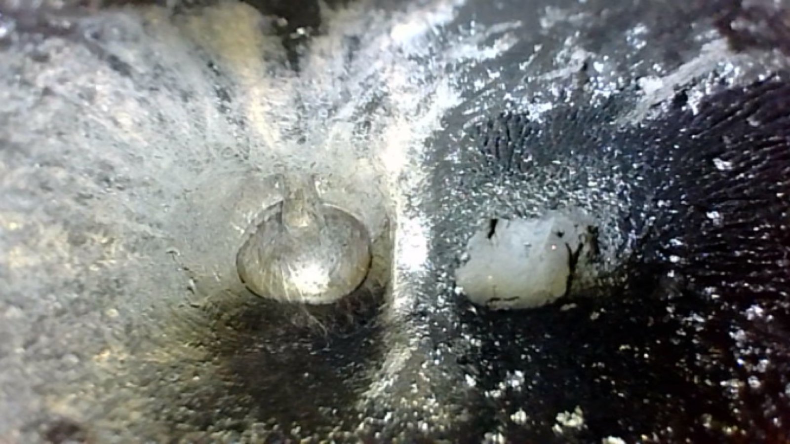

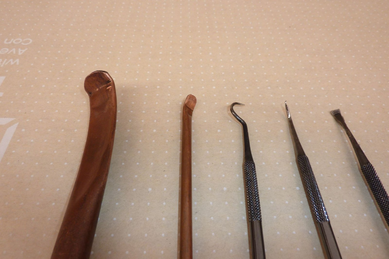

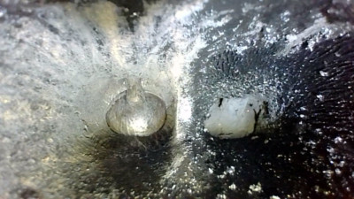

This was the state of my Citroen DS3 THP150 at 130k km. And it was not throwing up error codes but was not responding well to full throttle.
my own photo
my own photo

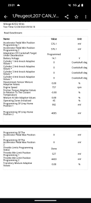

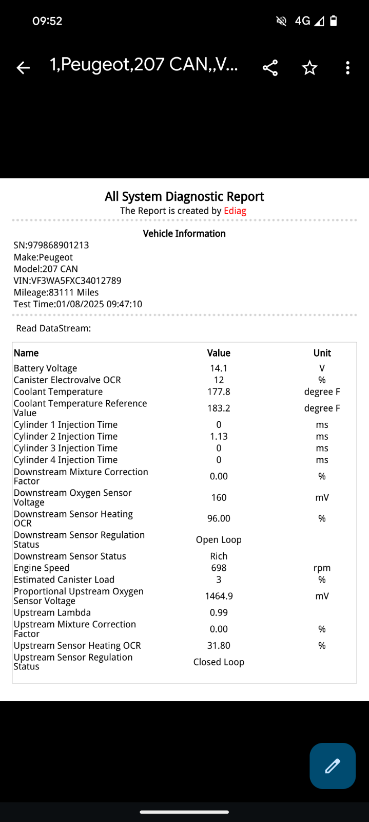

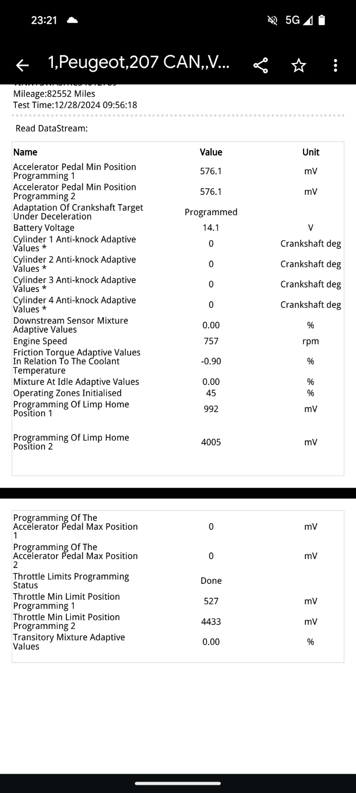

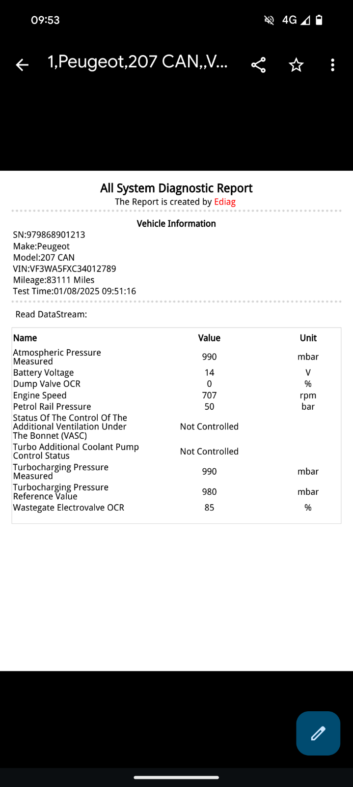

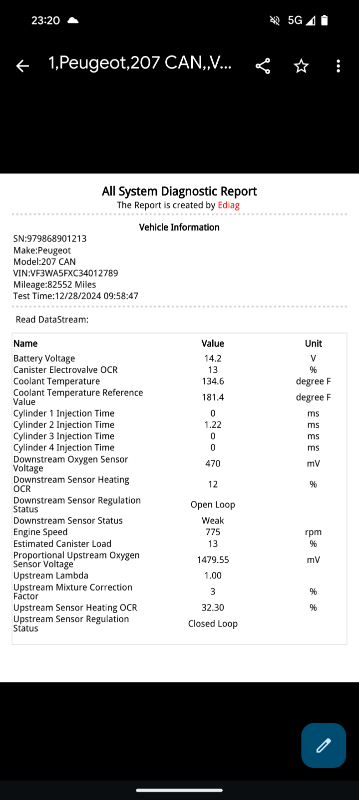

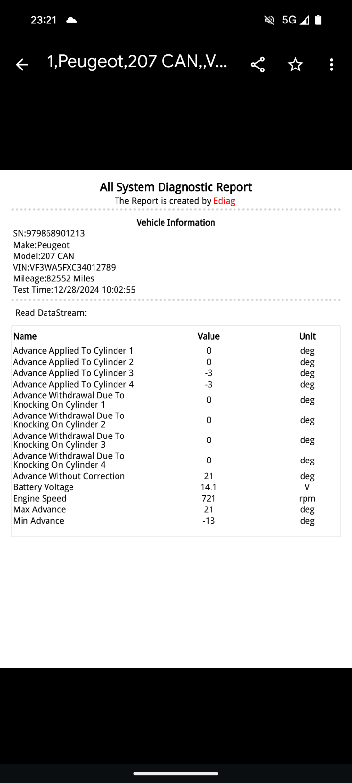

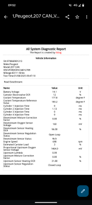

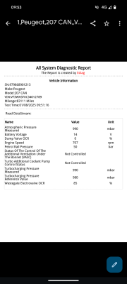

This is codes and readings from today, can't afford a new timing chain at the moment. Wrong time of year ha

You have coherence between the inlet camshaft and crankshaft positions which is encouraging for the timing, but it would be good to recheck the timing anyway. And how much extension is left in the piston in the cam chain tensioner.

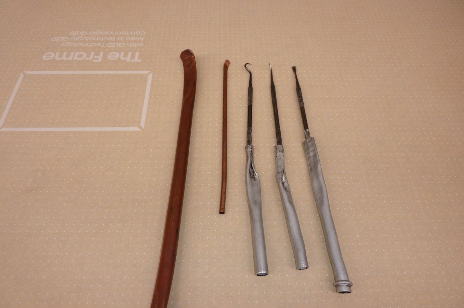

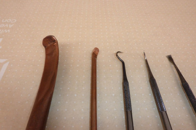

Cleaning the inlet ports and valves is a low cost labour intensive job if you do it yourself. Undoing the lower rear engine link and the upper RHS engine mount allows you to move the engine forward a bit to make it easier to work on the back of the engine. There is a tricky bolt below the inlet manifold that holds a support strut to the block. You may only have to loosen, not remove it, when you are pushing the inlet manifold off its studs? Having the engine cover off gives you more working room and also allows you to check that the valves really are closed on the cylinder you are cleaning. A cheap endoscope makes viewing much easier as well as a set of dental picks- see photos. The best scrapers are made from metal pipes flattened and bent at the ends with one end rounded off to suit the diameter of the inlet ports. You also need a tube attachment to your vacuum cleaner to suck up the debris you are scraping out. And depending upon your domestic situation you may have to buy a new bag afterwards if like me, you get odour complaints from other members of the household when you have sneaked the machine back inside. Once the bulk of the material is removed brushes and kero will do the rest. But there can be complications following carbon cleaning. e.g.
https://www.aussiefrogs.com/forum/index ... st-1814341

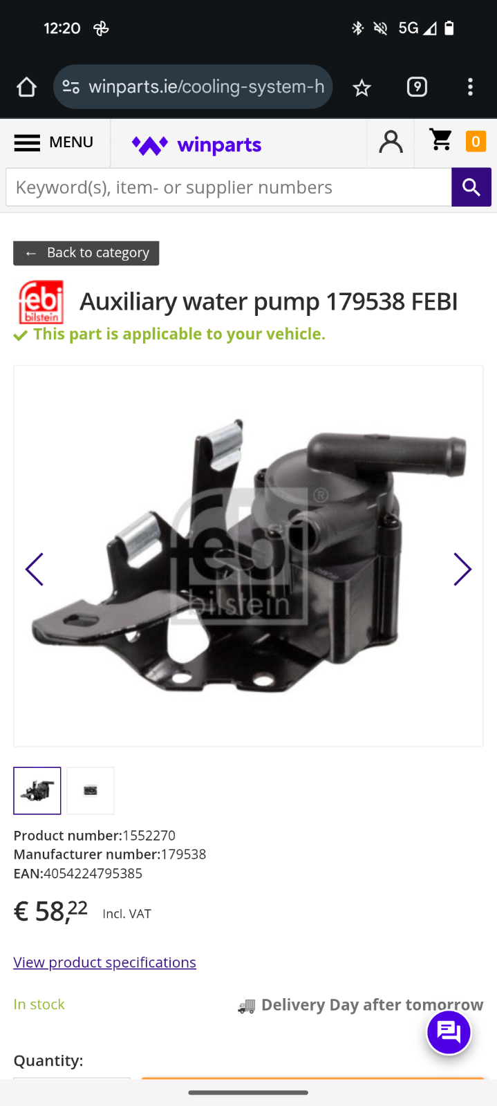

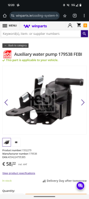

Thanks for the information 🙂 will go get timing checked end of this month when I get paid and if anything is wrong hopefully it's not a full replacement I need and it can be adjusted. I'll try find a video about the cleaning too, do you know if this is the right pump for the turbo coolant pump fault?

I’m not sure about the part being the correct one but if it has the right number of pipes there is a good chance that it is. Can be a bit awkward to replace but is your existing one running for 10 minutes after engine shutdown? You need a quiet place to listen or you can touch it with a long handled screwdriver held against your ear.

There are 2 variants with the same pump but slightly different brackets. If you get the wrong one, you can swap the new pump onto your old bracket. When these fail, they normally go short circuit and blow the fuse.

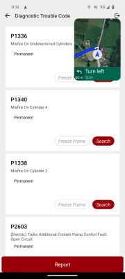

Do you know which fuse it is? The only noise after shut down or when I get the misfires is the fan, the pump failure code is the only other code that is coming up with the misfire ones. I've had a clean on the inlet valves but I still have the problem, I've noticed an oil leak around the banjo for the oil line to the turbo, got new banjo and washers coming tomorrow, could misfires be anything to do with the turbo? I'm at my wits end with the car 😅
