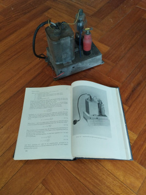

My late father and I have owned these two objects for more than 50 and 70 years, but this is the first time that they have been together.
The book is from 1952. How a 1950 era HT generator got to New Zealand (which never had 405 line TV) is a mistery. I know that there were some demonstrations of CCTV in the 1950s.

Philips 25kv EHT generator using 3x EY51 in a Tripler circuit. Remember them well, dreadful regulation.

I recognised that instantly! I had a similar one as a kid when I was given a 1950s projection TV using the little MW6-2 projection tube and optics requiring 25Kv EHT...Peter.N. wrote: 08 Jan 2025, 00:36 Philips 25kv EHT generator using 3x EY51 in a Tripler circuit. Remember them well, dreadful regulation.![]()
Peter.![]()
Amazingly I survived not killing myself with it
Mains-derived EHT generators are still very much in use today and almost every home has one in the form of a microwave oven. They continue to be lethal if mis-handled and many have been killed trying to fix a faulty one...

We had quite a number of customers with the Philips back projection set's Jim and I at one time had a Decca forward projection and that used the same unit. I don't think the output was instantly lethal as the available current was very low, so much so that you could adjust the focus with the brightness control!
The HT though was, if you recall it had two PZ30's giving positive and negative voltage rails that was 400v at some current, I never personally got bitten by one of those as they were the preserve of the other engineer.
They were very complicated though with beam suppression so that they couldn't display anything unless both time bases were working other wise you got a horizontal/vertical line or spot burnt on the CRT - expensive. Made fault finding difficult though, you really needed a scope to see if the time bases were running, I don't think we had one in those days.

Now that would have properly bitten!Peter.N. wrote: 08 Jan 2025, 11:01if you recall it had two PZ30's giving positive and negative voltage rails that was 400v at some current, I never personally got bitten by one of those as they were the preserve of the other engineer.
I think that's one reason I never managed to get the one I had going Peter, I was unaware of the beam suppression until much, much later!Peter.N. wrote: 08 Jan 2025, 11:01 They were very complicated though with beam suppression so that they couldn't display anything unless both time bases were working other wise you got a horizontal/vertical line or spot burnt on the CRT - expensive.
I kept the optics and tube for years and found them again when I cleared the attic of my parent's bungalow in 2005. I scrapped them and wish I hadn't now...

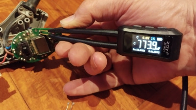

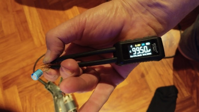

For my birthday I got a tweezer LCR meter. I wanted one for making in-circuit checks of capacitors. It measures capacitance and ESR.
It's first job was to check the capacitors in a bathroom fan timer module which was intermittently not turning off. It found that the 250V 220nF capacitor used for dropping the mains to 12V was down to 70nf,

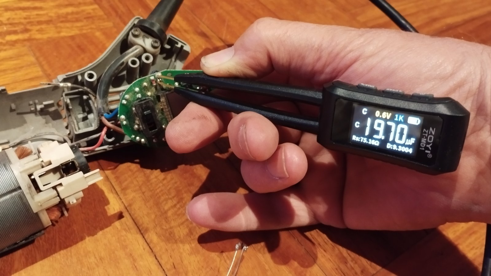

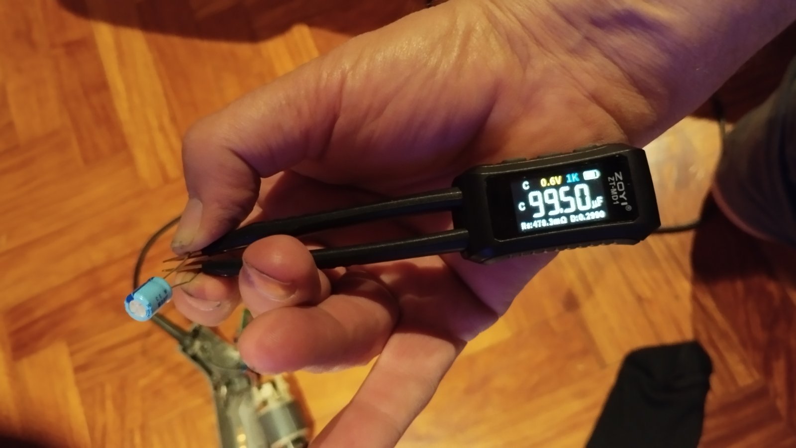

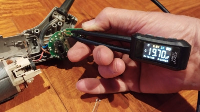

Today I remembered that I had a 240V Dremel which failed last year, just not running. I found 2 electrolytic capacitors on the control board, a 1?F which measures 770nF with 55? ESR and a 100?F which measures 19?F with 75? ESR. For comparison, a new cap from my junk box has an ESR of 0.5?.
I am very happy with this gadget.
