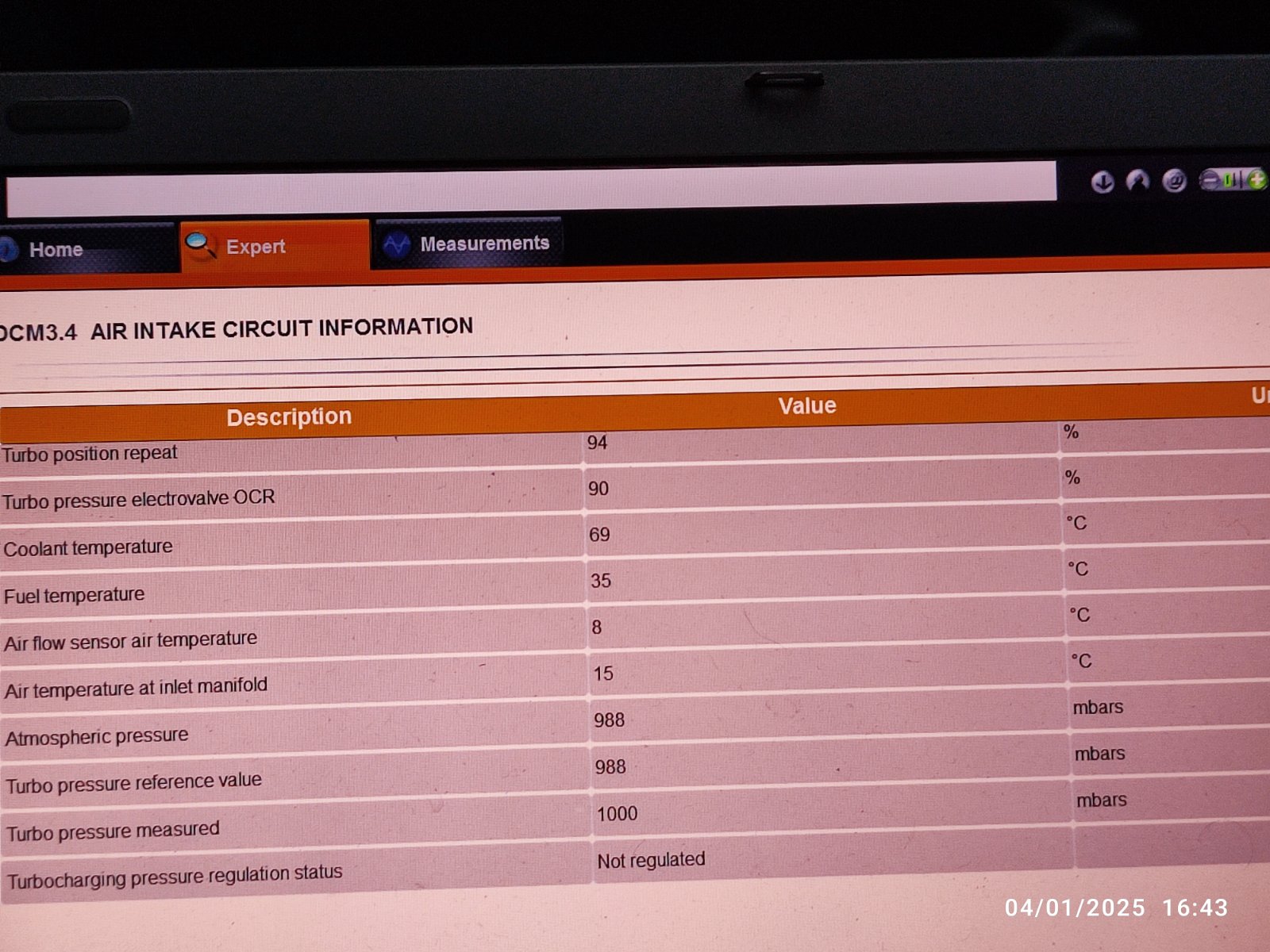

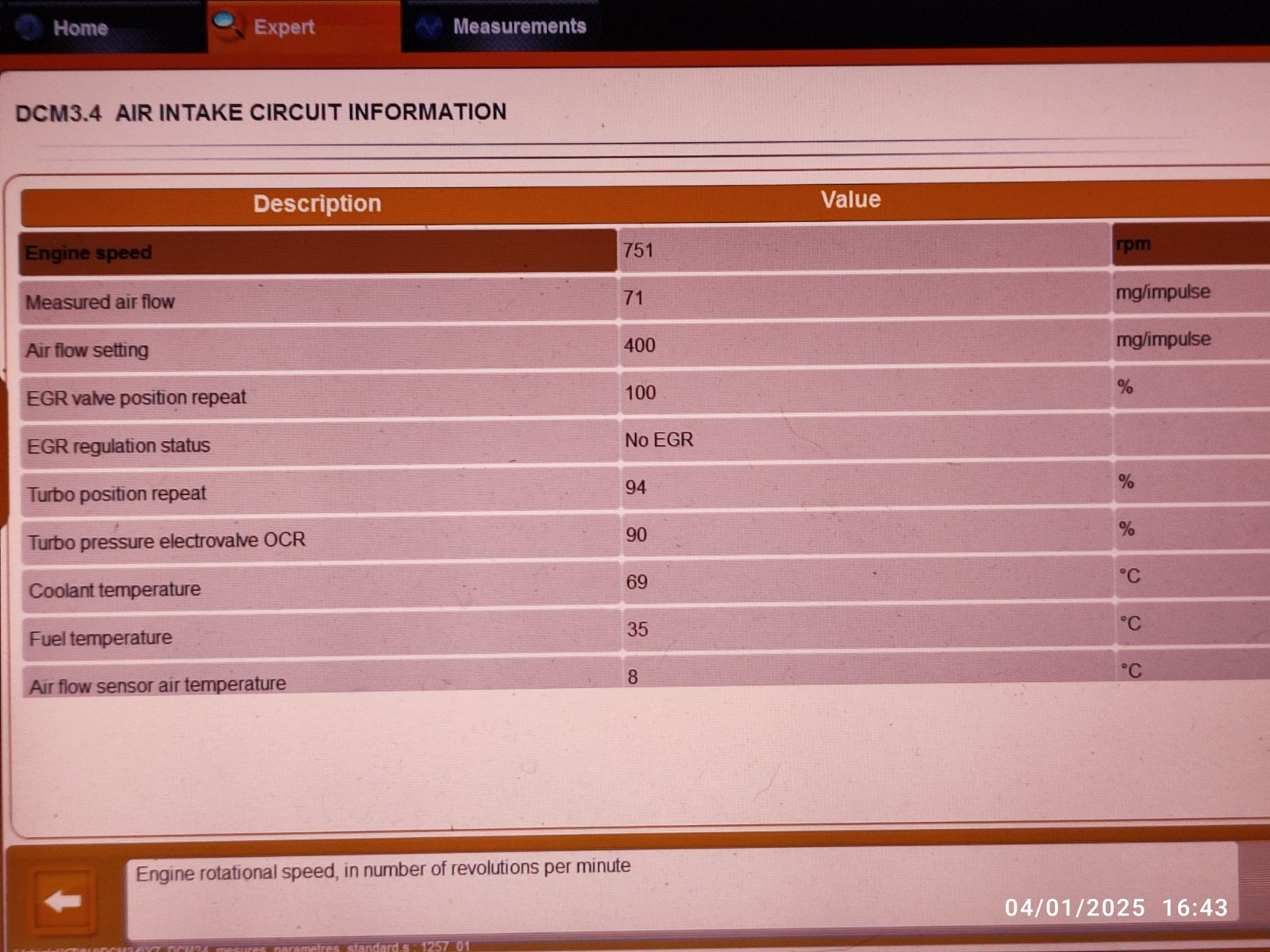

I'll have a look in a bit. I've never considered it as possible problem before this. It also says no egr I think it just means its not using it because it's not learned as such. Otherwise it has been mapped out but I doubt it. I will try actuating it after lunch. Just having a coffee and going to head out

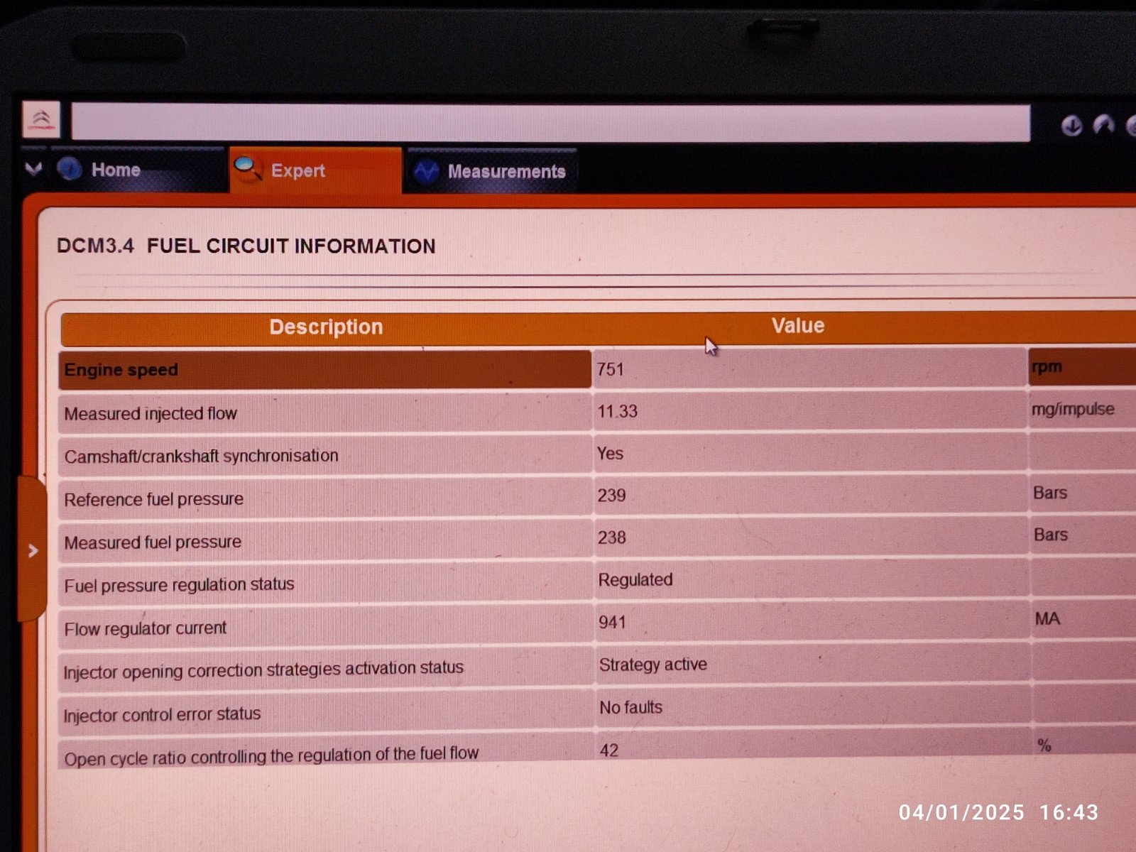

Ok so I have had a look and there is definitely air in the fuel lines.I can't really hold the phone steady because the engine is hopping so badly. I checked the fuel line on the 508 and it doesn't have this. I'm going to try and change o rings and see if it makes a difference. this is my fuel line to the pump.

Hi Matt I have had a look and there's no option on diagbox to actuate the egr which I think is strange.MattBLancs wrote: 04 Jan 2025, 13:12 As well as learn, there's also "actuator test" have you given that a go for the EGR valve? (Cycles it without the engine running so can hear it it's doing anything)

Hi all, I have noticed a few times not always that it says depollution system faulty when I turn on the ignition it goes away when I start it. I assume this is related to the glow plug p1351as there are no other codes.this on it's own is intermittent.
Back to air in fuel from the tank, I can see big air bubbles coming from the filter when I rev her. I think this is the problem. I am going to change the seals on the air and water vent on the fuel filter.

Ok so it takes 3 or 4 goes to start now so cold makes it worse. I tried blanking the egr for test purposes made no difference so not it. I'm back to fuel, had to be the air in the fuel. I'll have to wait until the snow goes away.

I threw more diesel into it and it started easier I can still see some air on the pump side of the filter and try to bleed it. It could be not purging the air correctly because of the fact it was low on diesel. I know I should have checked this earlier. I just went down a rabbit hole I do think there is a Comms issue with the egr though so I will need to investigate this further not today though. I might try bleeding it today but that will be about it.

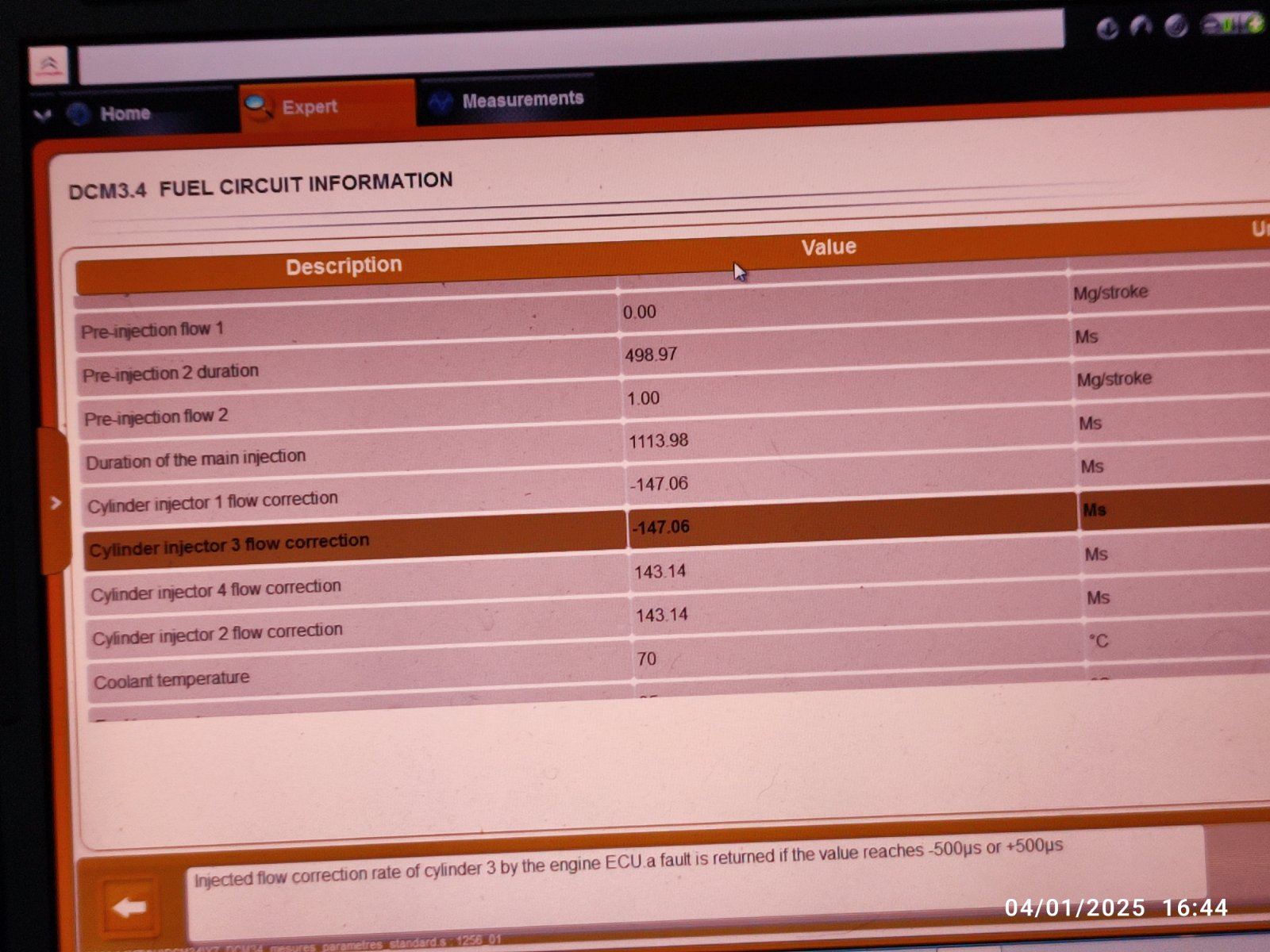

Ok so while running tests she finally threw some codes and said two of my injectors are stuck closed. I had these injectors tested and they passed apparently not impressed.

Re: Injectors misbehaving but trying to understand the numbers
Hi Darren, sorry been busy, just catching up.
No EGR actuator test= odd, was sure it was in there somewhere!
EGR blanked made no difference= I'd not worry about the EGR anymore at present, focus on other stuff.
Air bubbles seem thing to focus on. Don't think low fuel (unless literally near empty) would have an effect on what pulled down the the lines, it draws from the bottom of the tank.
Injectors reported as stuck closed= a faff, but could you swap the position two good for two bad, (clear, then) see if noew codes raised for the moved injectors = would help confirm if truly the injectors or it is something wrong with a particular pair of cylinders, just the ECU is flagging it up as being the injectors.

No bother Matt, I'm sure your flat out with kids and work as I said this is becoming a blog. I have 4 other injectors I might try one of them first and swap each of them out until I see something else. It sounds like stuck injectors when it's running. I also have an egr fault P0406 so egr is a problem too. I have direction though so I'm back to testing injectors. I keep hearing Einstein in my head "doing the same thing and expecting different results is madness" I'm half afraid to move the alleged good injectors as moving anything on this car seems to make it fail. I have a direction now at least. I will do a compression test first I think.

I'm going to try swapping them around first as you have suggested to see if it moves if it does I know its the injector. I will post up results. I found the leak off test in diagbox as well . The car will run the engine through various speed ranges to give a better indication of injector health.

Hi all, I threw three injectors one at a time starting it and it improved every time I changed one. She's running better than she has for a good while now I'm a lot happier that I changed the engine. 2 and 4 were bad and 1 was nailing badly so I changed it and it finally stopped hopping on it's mounts. The issue I have now is the engine shudders when I shut it off . I need to See if it settles now when it's cold. I will try it again this evening to see how it runs from cold. The egr started working again as well so finally making progress. I need to code the number 1 injector which should help as well. I've still to put the replacement rad in and the gasket and clip on the egr and rebuild the front. She needs a good clean as well. Runs clear now no bubbles.
