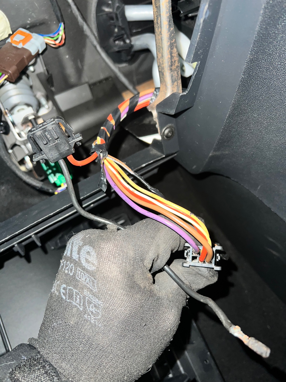

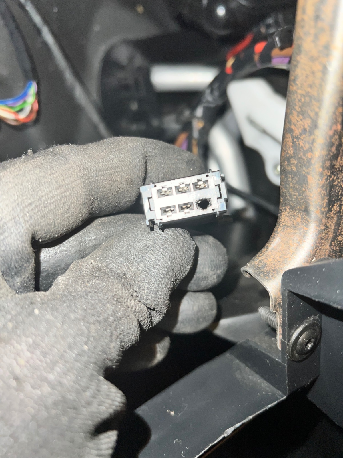

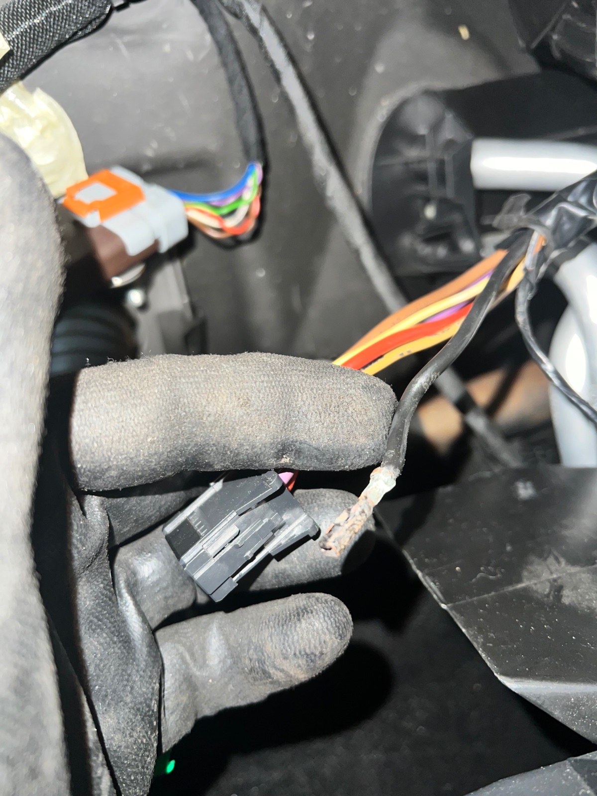

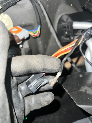

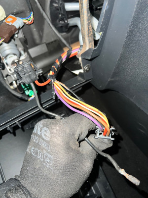

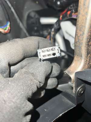

Please could someone help me with a wiring diagram for a CITROEN C3 SELECTION VTI 82. I need to replace the heating resistor and the loom plug as it has burned out. I want to know if I can replace the plug and wire rather than having to replace the whole loom?
Any assistance and advice will be very much welcome thank you in advance.
I have attached two pictures showing the plug and the wire I need to replace if I can.

Replacing the burnt wire and plug should be sufficient. In a pinch you could just cut the burnt corner off the plug and use an individual terminal of the same same size.

Thanks very much for the feedback. If I did want to replace the plug do you know if there is a tool that allows you to pull the wires out and not have to cut them.

Search "98172-1004" on Aliexpress.
Search "car terminal removal tool" on Aliexpress.
