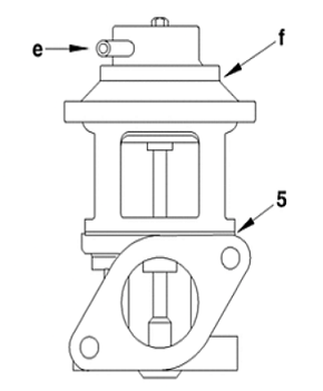

e: Vacuum inlet (gas recycling regulation electrovalve).
f: Pneumatic control capsule for the EGR valve.
(5) Exhaust gas recycling valve (EGR).
The gas recycling valve is shut when it is not being pneumatically controlled (vacuum).
Operating phases when the control vacuum capsule is supplied with a vacuum:
  • The gas recycling valve opens
  • Part of the exhaust gas is absorbed by the engine (air inlet manifold)

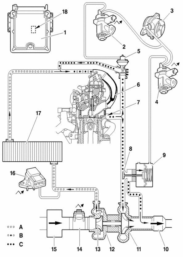

This may help:
Air circulation (as per arrows):
A: Air
B: Exhaust gas + Air
C: Exhaust gas
Note: The diagram relates to engines with a controlled turbo (injection ECU + electrovalve).
ReferenceDesignationPart number in the electrical diagramsRemarks
1Injection ECU1320-
2Recycling Regulation Electrovalve (EGR)1253-
3Vacuum Pump--
4Turbocharging Pressure Regulation Solenoid Valve1233According to specification
5Exhaust Gas Recycling Valve (EGR)--
6Air Inlet Manifold--
7Exhaust Gas Manifold--
8Boost Pressure Waste Gate-Vacuum-controlled
9Pneumatic Control Capsule For The Waste Gate (On Turbocharger)-Vacuum-controlled
10Catalytic Converter--
11Exhaust Turbine--
12Turbocharger--
13Air Inlet Turbine--
14Air Flow Meter + Air Temperature Sensor1310-
15Air Cleaner--
16Inlet Manifold Pressure Sensor1312-
17Air/Air Heat Exchanger-According to specification
18Atmospheric Pressure Sensor (Integrated In The Injection ECU)1320-
I have the diagram for you, but you'll have to wait as we've moved to a new server and we are still fine tuning, so I don't have access at present, but will pop it up when I can.

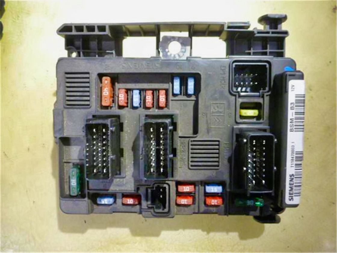

Here you are:
With the exception of the wiring codes, most of the component codes are indexed here:
PSA Electrical Diagrams - Wiring & Symbols Codes Index

My diagnostics aren't successful. It looks like no matter if I unpluged EGR solenoid and EGR throttle (diagram above lack of that conmponent) or CR pump 3rd pistion deactivator - fuse F15 keeps blowing. Some onlne threads lead to bad mass conector or losen cable, but non of them point specific element. Do you have a BSM pin out by any chance?
