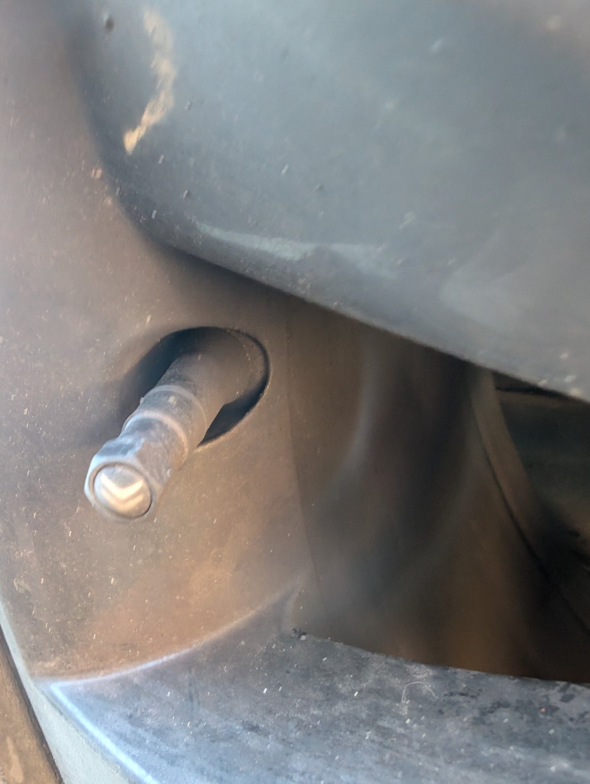

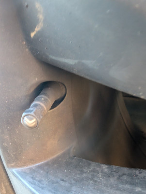

Have also attached pic of my valve which I believe someone said can tell if it's that system via that?

The fifth post down this thread (which is from GiveMeABreak) suggests that you have the indirect system. The direct system will have a form of sensor fitted to each of the standard road wheels (some are built into the valves, others are stuck on the wheel rim (and enclosed by the tyre). Marc has found that your system can manage spare and run-flat wheels, so almost certainly does not have a sensor on each wheel.
