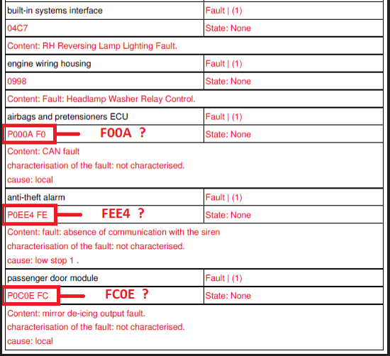

I was using iCarsoft CR MAX to read fault codes from Citroen C4 (year 2006). I noticed that some of the codes were quite weird looking. Reader gave me codes P000A F0, P0EE4 FE and P0C0E FC (see attached image).
I found a listing of fault codes for C4 and based on that and fault descriptions I think I was able to figure out that those given codes should be like this:
airbags and pretensioners ECU
P000A F0 -> F00A
anti-theft alarm
P0EE4 FE -> FEE4
passenger door module
P0C0E FC -> FC0E
For some reason only last four characters are "real code" and even they are mixed up.
I was wondering if anyone has ever stumbled on something similar when using these "generic" code readers?
F00A code indicates a CAN bus fault for the "airbags and pretensioners ECU". Does anyone happen to have a some kind of diagram regarding CAN network topology for the C4 (2006), or any ideas if there are any common denominators for those listed modules? I was wondering if a problem with a CAN bus could somehow cause these weird looking codes on the reader?

Thanks for the replies and information EdMar and Marc.
Originally there was a problem with an alternator and that caused a dead battery. There was a long list of different comms fail codes and others after I replaced the alternator and I think most of them were just caused by a low battery voltage as EdMar also mentioned.
These are actually codes that came back after I did a code clear. I cleared the codes after I replaced that alternator and charged the battery, took a short drive and read the codes again. I'm planning to do another check in a few weeks time to see if there are any changes. At the same time I'll try to check those mirror, washer and reverse light issues.
VIN is VF7**************[VIN obfuscated, can be read by forum staff]
Engine is NFU/TU5JP4 1.6

I got a confirmation from iCarsoft that those weird looking codes are caused by a software bug. They are looking into it.
