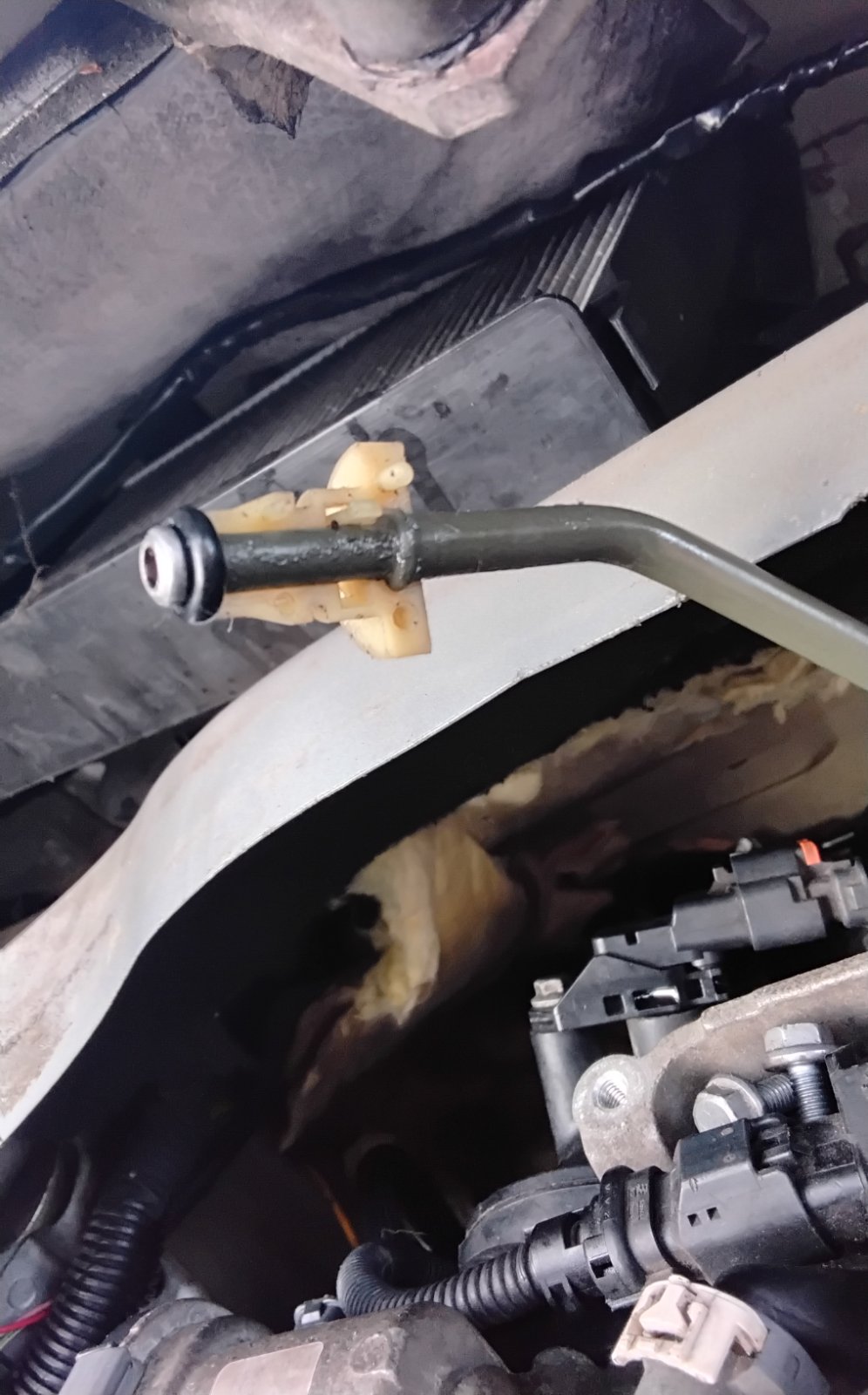

This is the larger of the 2 pipes on the clutch master cylinder as you can see some peeling going on of the pipe protection (green coating) I rubbed this all off so no high spots, maybe this was letting air in the system ?
Also a
in the mouth moment as the white clip came apart into 2 pieces but after a clean it went back together hugging the pipe. Plus a new o-ring was added to the end of the pipe itself then all popped & clipped back home into the master cylinder
