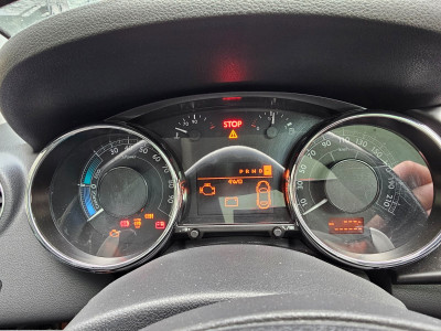

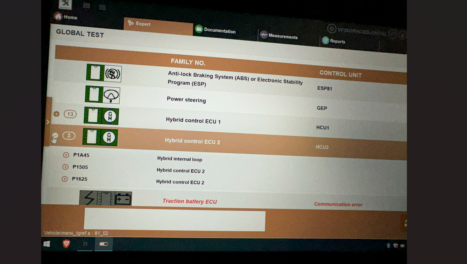

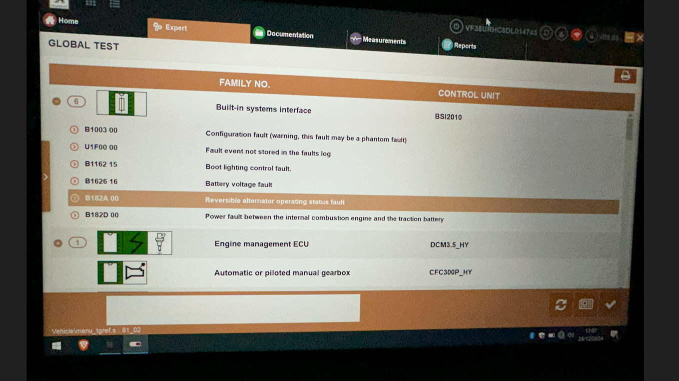

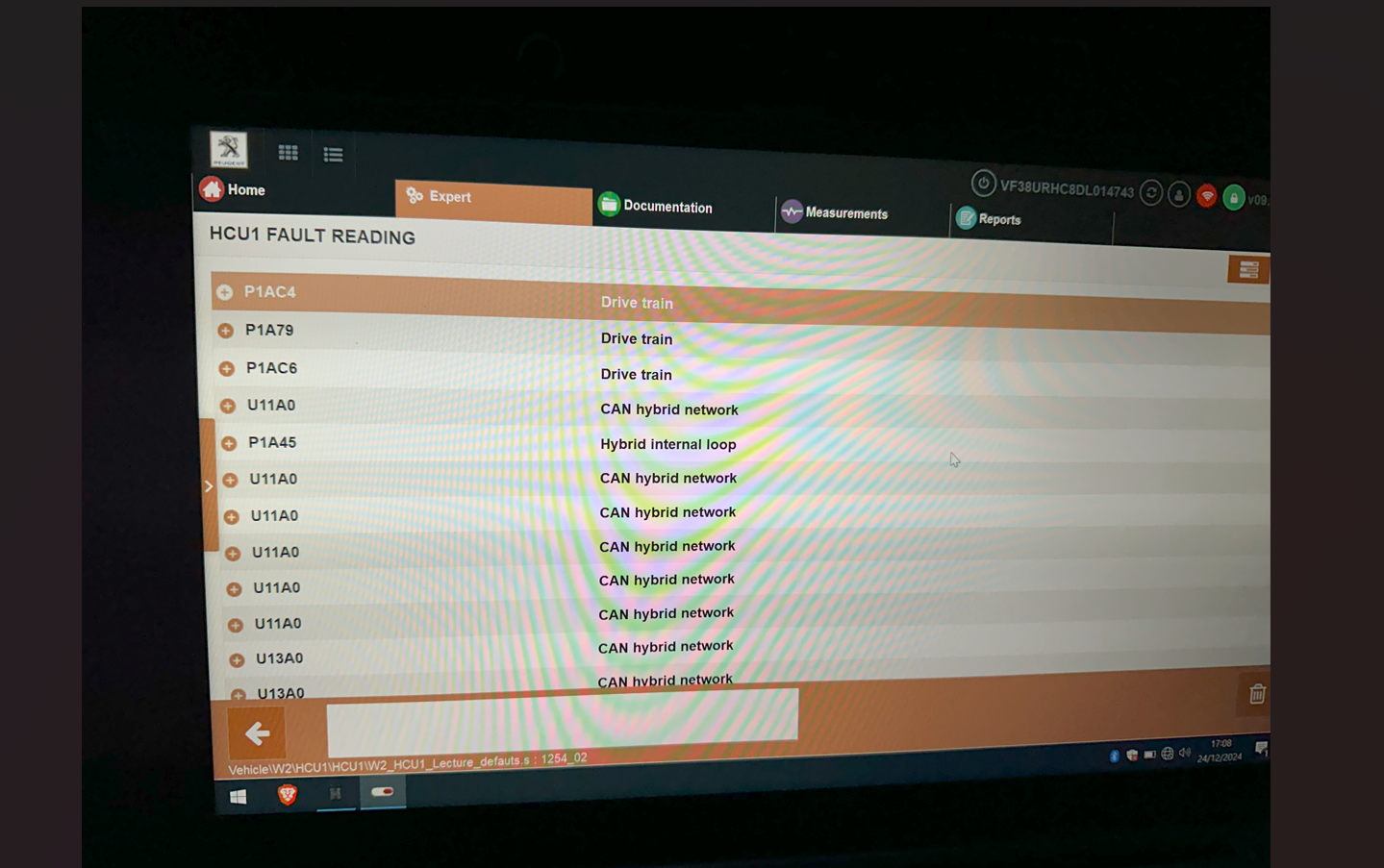

hello everyone.
I have a 508 RXH hybrid4 that just won't stay running. If I clear all the code with diagbox(9.85) and I remove the traction battery cable from the hybrid battery itselfe ,the car starts for a few second then dies and a lot of errors pop up.After the "small start" I cannot start the car again if I don't cleare all the code again.
These are the error that I need to clear every time in the attacment.
If somebody has any Idea on what to try I'm all ears . All those can errors makes no sense to me.
CAN high mesured 2.7V CAN low 1.6V.
Resistance between High and low 63 Ohm.
Ask me any question you have.

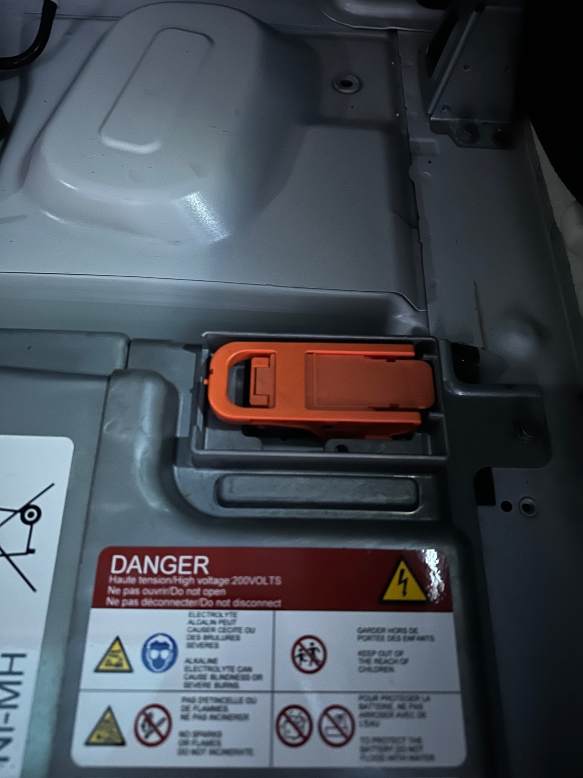

What if I told you that I just fixed the car? Almost one year of trouble. The main fuse for the traction battery: it was not fitted properly. I didn't know that you have to push down the lever part and then push it to le right! After that cleared all the code =car cranks half a turn and starts up like nothing ever happened and STAYS RUNNING.
I'm about to cry. Only god knows how many hour I have wasted searching for broken cable in the CAN network.
If you only push down the main fuse a million errors appears and apparently not even the engine is willing to run. 2 Peugeot dealers have worked on it,I'm jest disgusted. And a mechanic for over a month.
I will put a photo of the main relay for anyone that may have the same problem but it's pretti obvious for those who works on this tipe of car daily( not me I'm a carpenter).

Now you mention it, I do recall someone else having some issue with the fuse - I know that sometimes this has to be reset after the traction battery is disconnected - but glad you have it sorted and saved a few £s.

I tried recreating the problem on purpose , and I did it disconnecting the main fuse and refitting it in the incorrect way and the trouble has come back (engine fault service required), no crank.Also the TBMU gave me a code for a detected impact witch seems logical as the connector is not in all the way.
Than I disconnected the traction battery TBMU and cleared the codes. Trying to start the car it runs for 2 seconds than it dies , and all the CAN related problems appears obviously.
If I fit the main fuse correctly, reconnect the TBMU and clear all codes the car starts right up no problem.
BUT: This makes me think I have another intermittent problem with the HCU1 and HCU2 because the first time I remained stranded in the middle of the road was for an EPB fault. Obviously I completely disassembled the EPB and checked all the cable / assembly and everything is fine . I also bought another EPB ecu that is currently installed.No problem at all with bought of them since that time .
Trying to fix the problem I also disconnected the HCU1 and 2 and the EPB fault came back.
I really think HCU1/2 has become mad for some reason that day and launched a DTC that is permanent and the car was unable to run until that DTC was cleared.

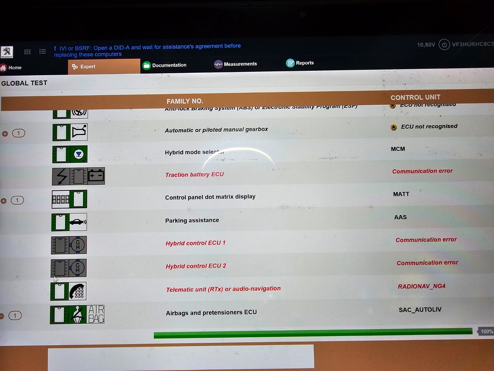

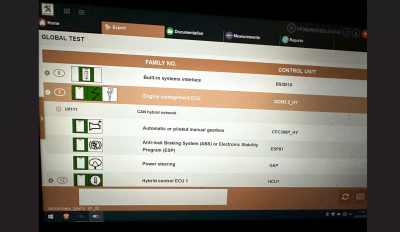

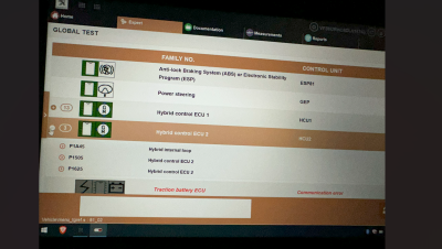

I deal in hybrid4s and they have lots of issues, I just re read the thread and was going to suggest the battery isolation switch, as in global test it was showing traction battery no communication, glad you found it but how did it work loose? I've got 5 of these in the yard all with issues relating to the hybrid system.
The battery contains its own ecu
Hcu 2 is the charger unit under the battery
Hcu is the reverse alternator
Hcu2 requires online telecoding if you replace it
Traction batteries are plug and play
Alternators need programing if replace for a second hand one they don't if it's your unit and you've just had the bearing replaced, alternator programming needs 20% Traction battery charge.

'I didn't know that you have to push down the lever part and then push it to le right! '
Seems like someone pulled the isolation link and just didnt get it locked in again fully,
Mr-white spotted it from pic of a global scan , 'no battery communication' sent him stright in that direction.
Bit like old Diesel mechanics know to check 'filters first', with high voltage drive sysyems confirming interlocks is a basic check.
Dealer techs should know this, I know there is a shortage of techs but better to wait for the like of mr-white , than get 'two dealers and an independant' miss an isolator not lateched and presumably charge for it?

Hello! Mr. White.mr-white wrote: 02 Jan 2025, 19:47 I deal in hybrid4s and they have lots of issues, I just re read the thread and was going to suggest the battery isolation switch, as in global test it was showing traction battery no communication, glad you found it but how did it work loose? I've got 5 of these in the yard all with issues relating to the hybrid system.

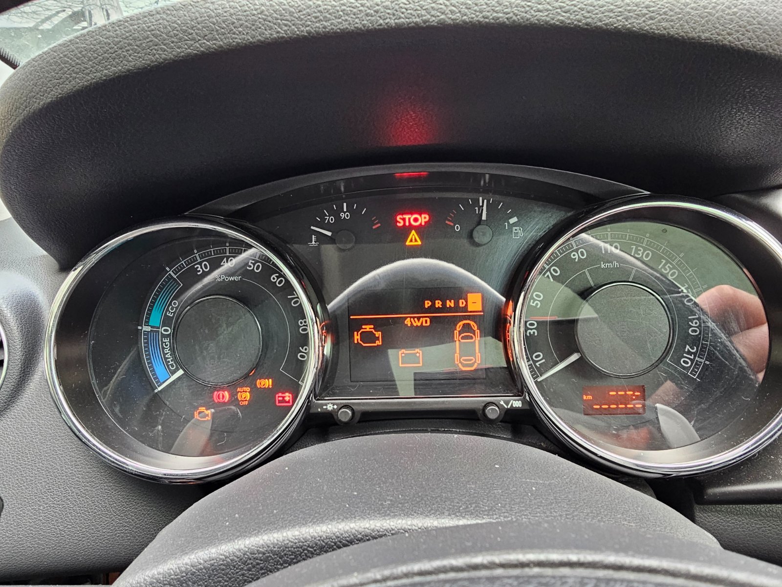

I have a 2012 pug3008 hybrid4. Main dealer software updates the bsi/engine ecu and now there's no comm with hybrid ecu, hcu1, hcu2.
Fuses all OK. After ignition, I can hear the battery fan blowing.
Dashboard shows odometer for a couple of seconds then goes ----------
Any idea where should I start?
