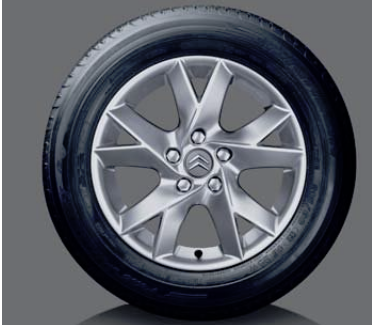

This is the guide for Citroen C5 X7 Alloys:
Note, if you are changing alloys, you must also make sure you check the settings in the ESP ECU, to ensure the system knows you have different sized alloys as this can affect the speed information calculated and can have a direct impact on the Automatic Gearbox and the ESP system.
Click to Zoom
Click to Zoom
| Citroen C5 X7 Alloy Wheel Fittment |
| Kara 16" | Iroise 16" | Persique 17" |
| Persique Dark 17" | Ionienne 17" | Baltique 17" |
| Atlantique 18" | Adriatique 19" | Adriatique Dark 19" |
