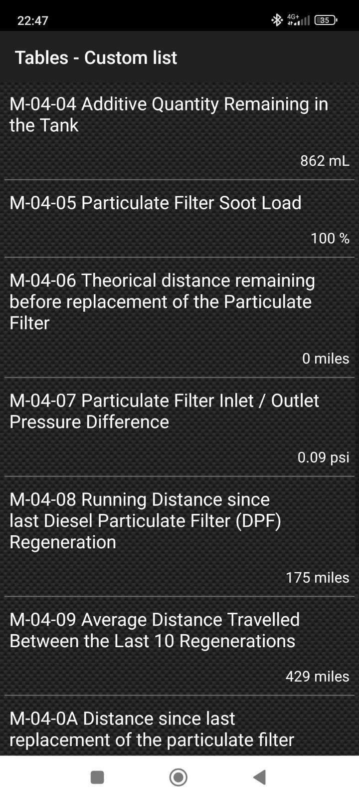

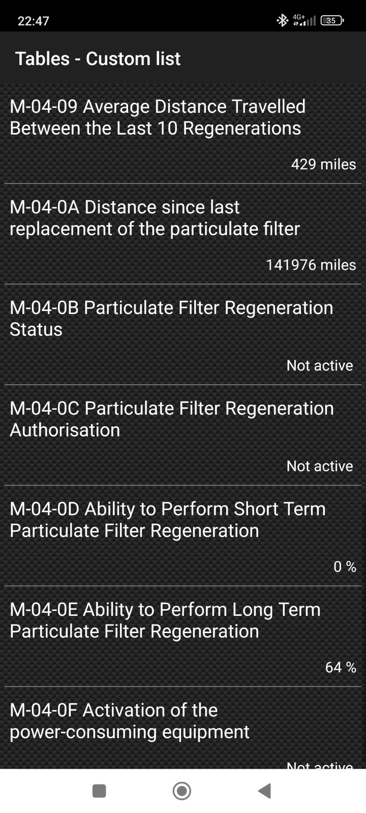

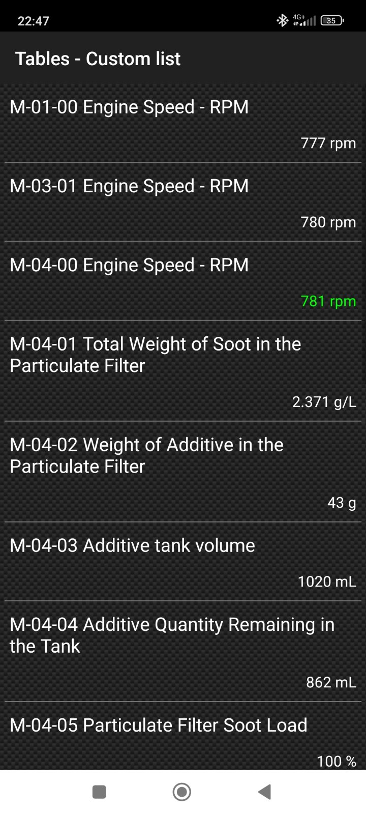

I have an ODB reader, and the software is showing what appears to be good figures for soot load, etc...
the one that appears to be causing the issue is marked as "M-04-06 - Theoretical distance remaining before replacement of the Particulate Filter" - which shows 0 miles.

looking at the readings, it doesn't look as though the filter actually needs to be replaced (to my untrained eyes at any rate)
