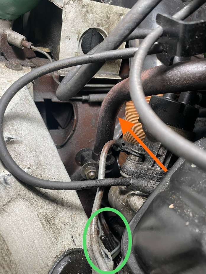

- Lowest point of the lower rocker covers. I did remove the left-side one for inspection at one point, but not the right-side one.
- On the "point" on the exhaust (lower) side of the cylinder head. According to gs-gsa-ig.de, that's from the oil return tubes. According to GSAmiService, that could be either the oil return tubes or the valve covers, but more likely the oil return tubes. This spot and the previous spot are hard to see without an inspection mirror, small camera, or getting under the car and looking through a tiny slot.
- On the lower surface of the distributor tower, and the lower surface of the fuel pump tower. The parts book and procedures show only a paper gasket at that end of the camshaft. Is there a seal under the distributor that can go bad? What about at the fuel-pump side of the engine?
- On top of the right-side intake manifold and right-side top valve cover. This could be drips from the air filter (I have the early grey box with the filter you have to oil). The exhaust crossover on this side seems to have been coated with oil somehow -- see orange arrow in image.

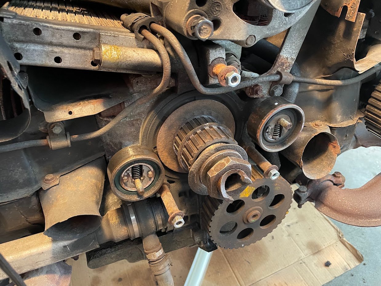

Engine is out, and apart. I discovered the seals had been changed in 2010, some 50000km ago, which doesn't seem that long. Most of them are still soft.
No drips from the oil cooler. The two main leaks I've found were the distributor camshaft seal and the lower valve covers -- the gaskets had come unstuck near the bottom.
