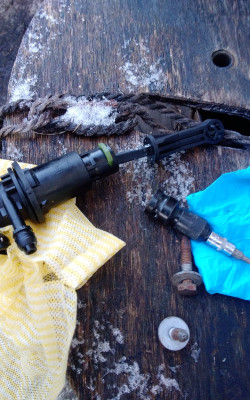

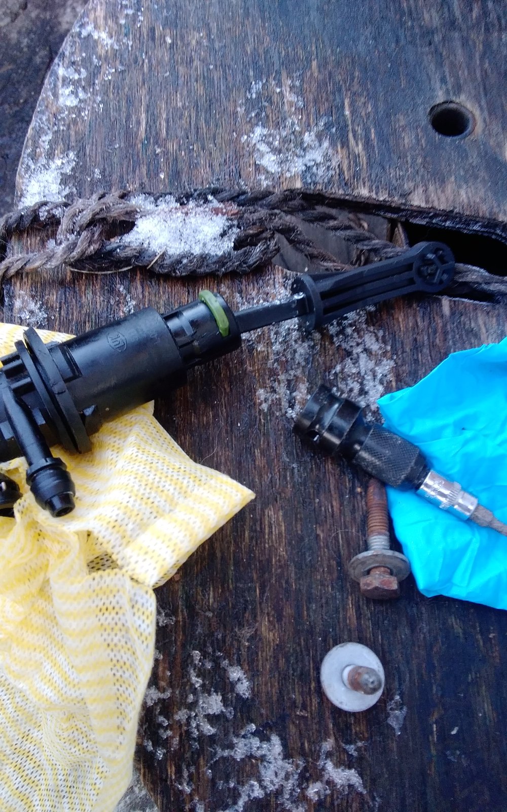

Hi Jim, ok, your in the car just started the engine, foot down 1st gear , pedal flat to the floor
Husky.
OnlineHuskyxantia
- Posts: 3939
- Joined: 30 Jul 2018, 22:11
- x 926
Re: Citroen c3 picasso
Or your in gear , getting ready to either pull up at the lights or other place you need to stop , push pedal down to go down gear , pedal wont come back up , car stuck in gear, turn off engine , pull car out of gear, then no pedal so cant use gear stick as no clutch.

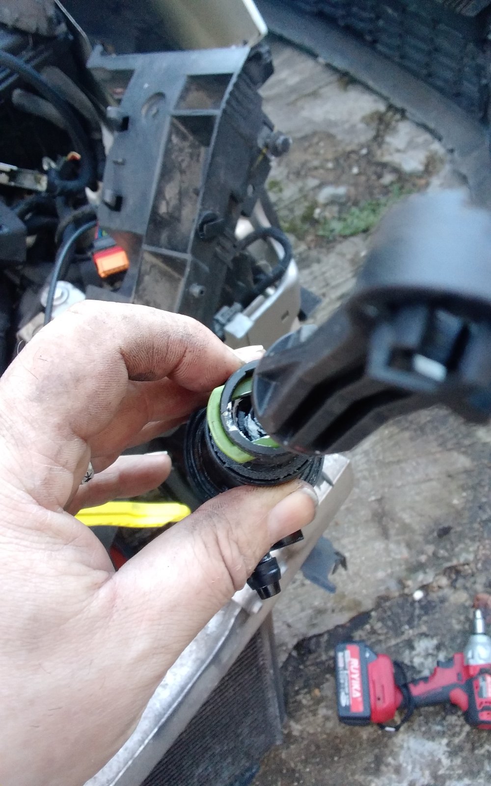

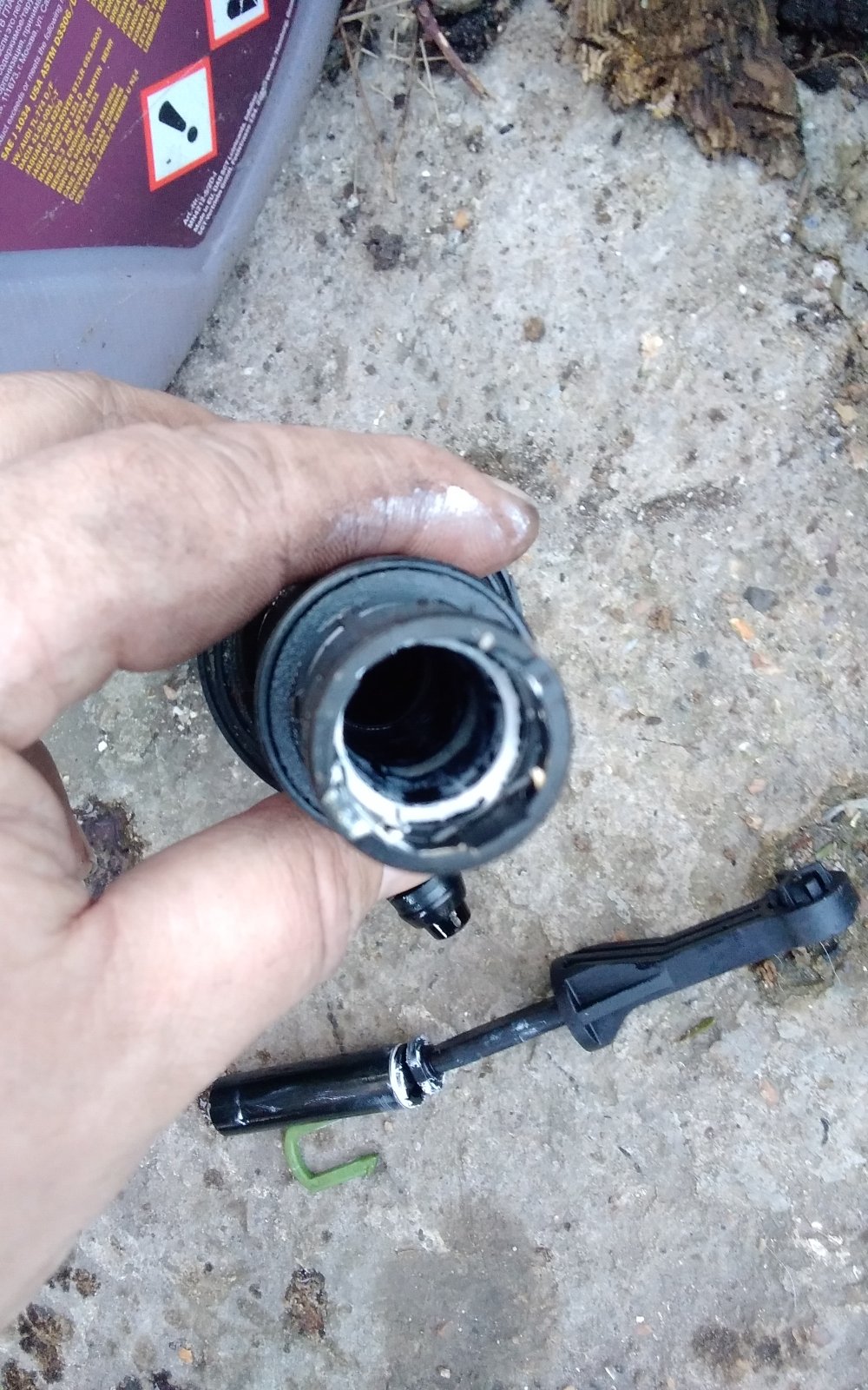

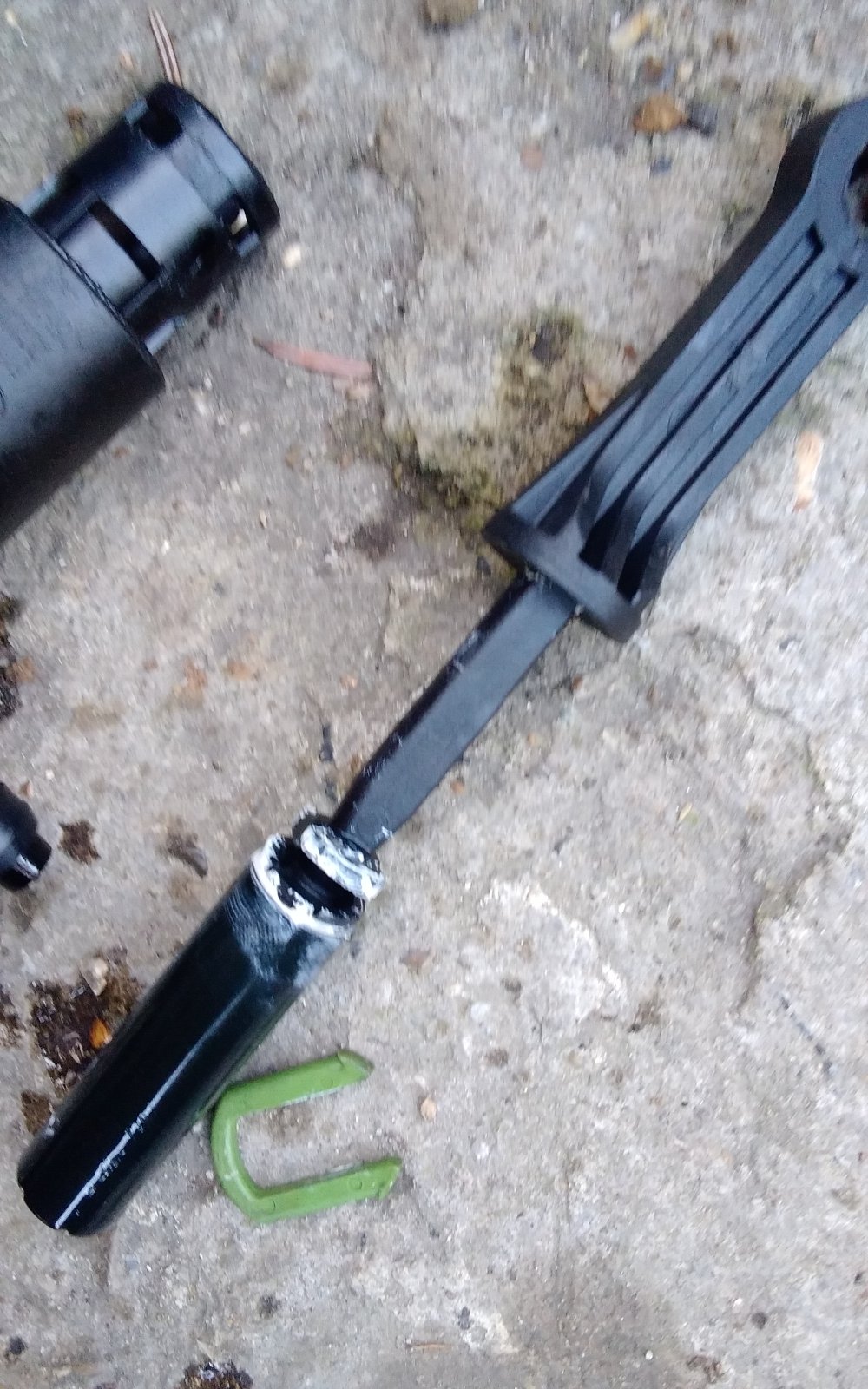

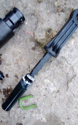

Oh Just remembed, the day before this i pushed the clutch pedal down to be greeted with a loud snap,clonk , sort of spring sound . Also yesterday i unplugged the master off the clutch pedal & worked the plunger by hand i felt it had an inch of pressure then , it goes , so doing that then gave me the answer , master gone again.
Anyone reading this for the first time , sorry abiut my spelling my fingers are like bananas , but .. the clutch master cylinder is connected to the clutch pedal, the slave is on the front of the gear box, geavity bleeding does not always work as i have found out , 2 man is good & the vacum method too.

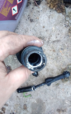

As for service part , dont think you can repair them looking at one i photographed not long after i got the car it looks to me as if they could do with a better type of seal , no wonder why air gets in.
