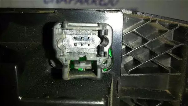

My 2006 C2 1.1 is equipped with a clock instead of a (typ A or typ C) multifunctional display. I´m planning to mount an original radio (RD4) + multifunctional display. Is this possible? The connection from the clock is different than the connection of the multifunctional display, it has different connectors.

Do you have a pic of the connector on the clock? I can imagine they would have used a different dash harness for a basic clock model.

The clock has a 6 pin connector (with 3 wires), the multifunctional display has a 12 pin connector (with 4 wires?), it´s a 1.1 Seduction, except central door locking (without remote control) and power steering, there´s not any luxury present

might be worth following the wiring harness for the original clock back into the dash to see if there is a connector somewhere that changed it from the 12 pin connector into the 6 pin.
